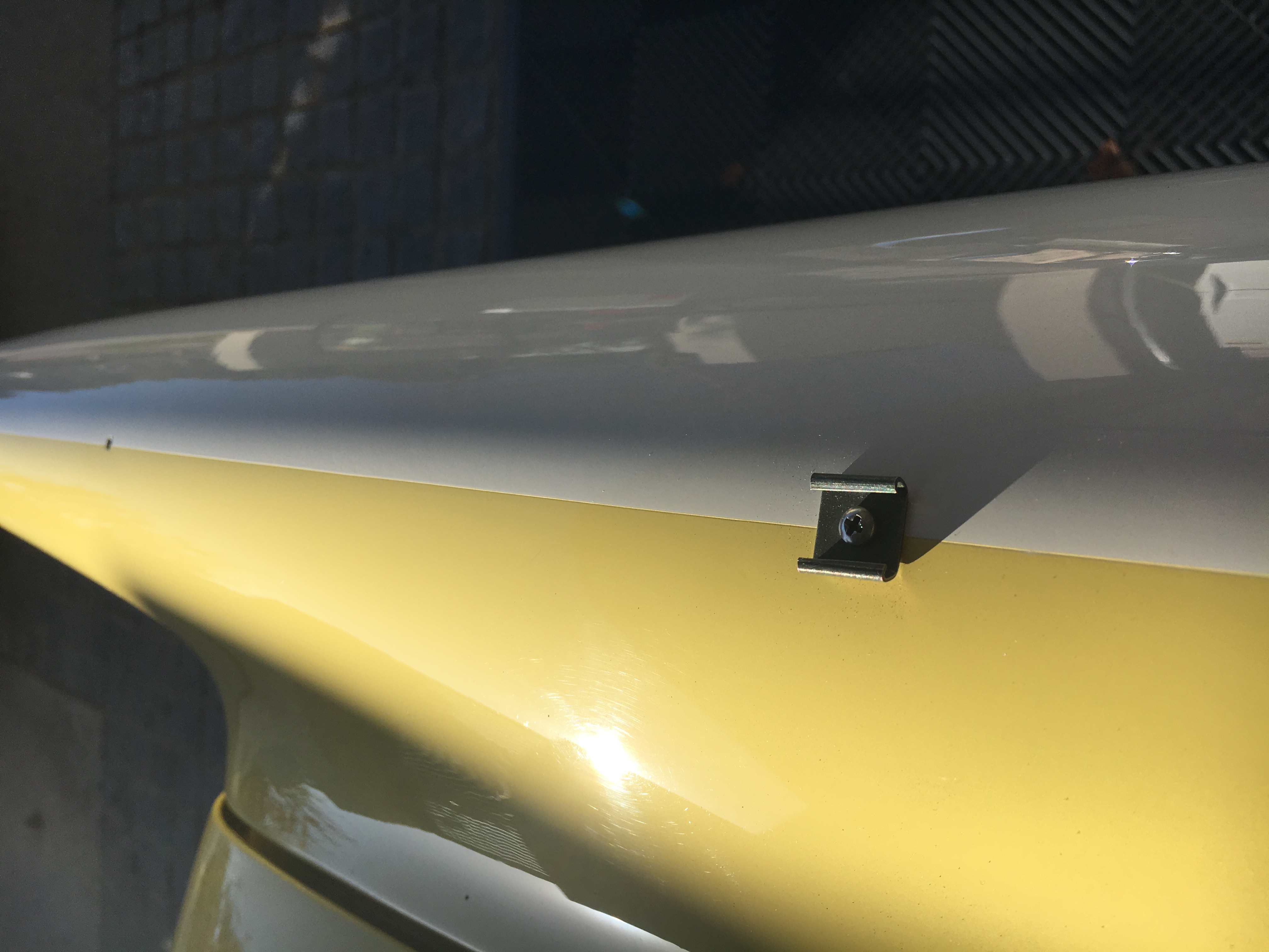

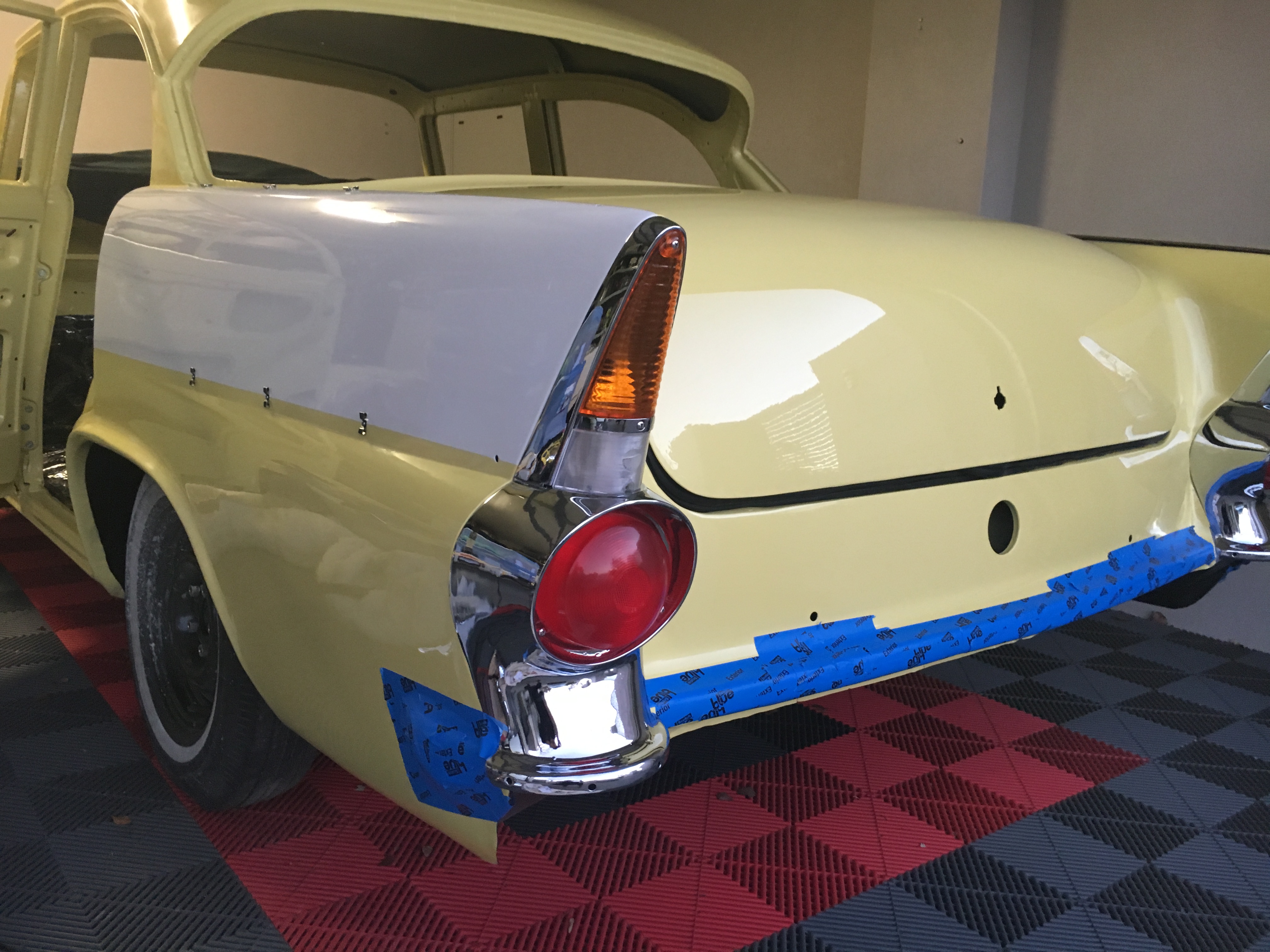

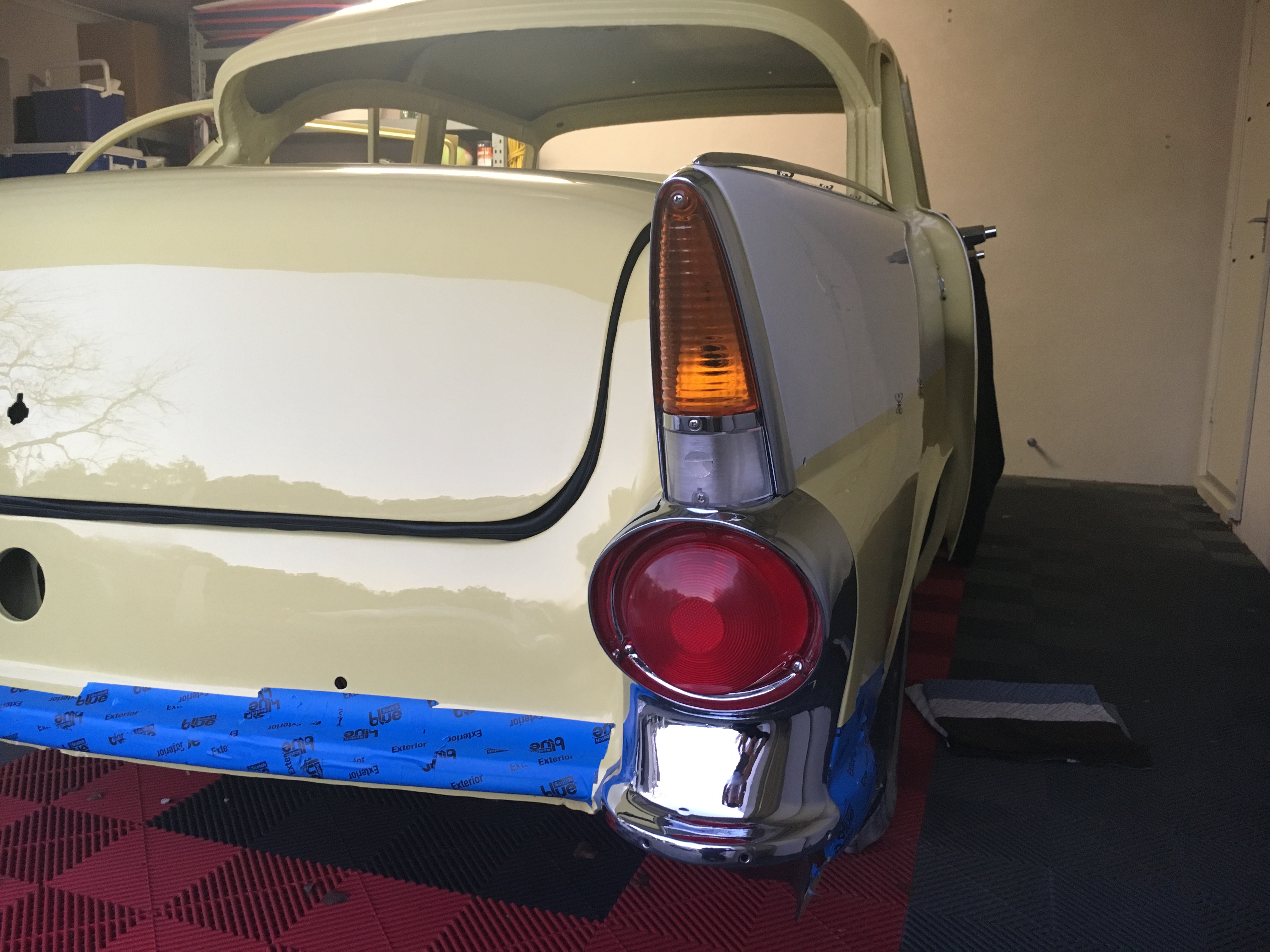

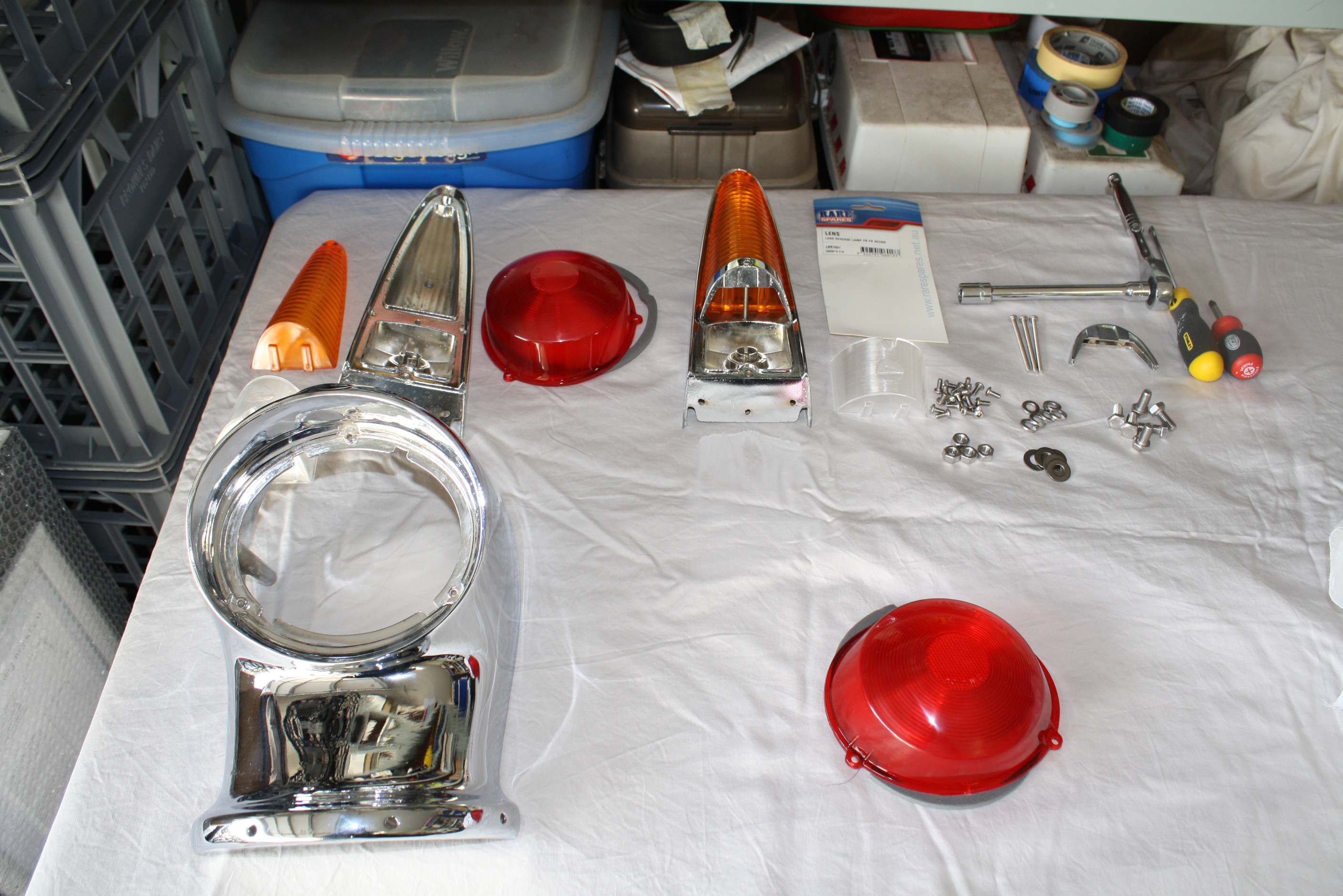

Well I finally have a freshly painted car and have commenced what is sure to be a long and arduous task of reassembly. I have decided to work from the rear of the car forward as I am still waiting on a couple panels at the front.

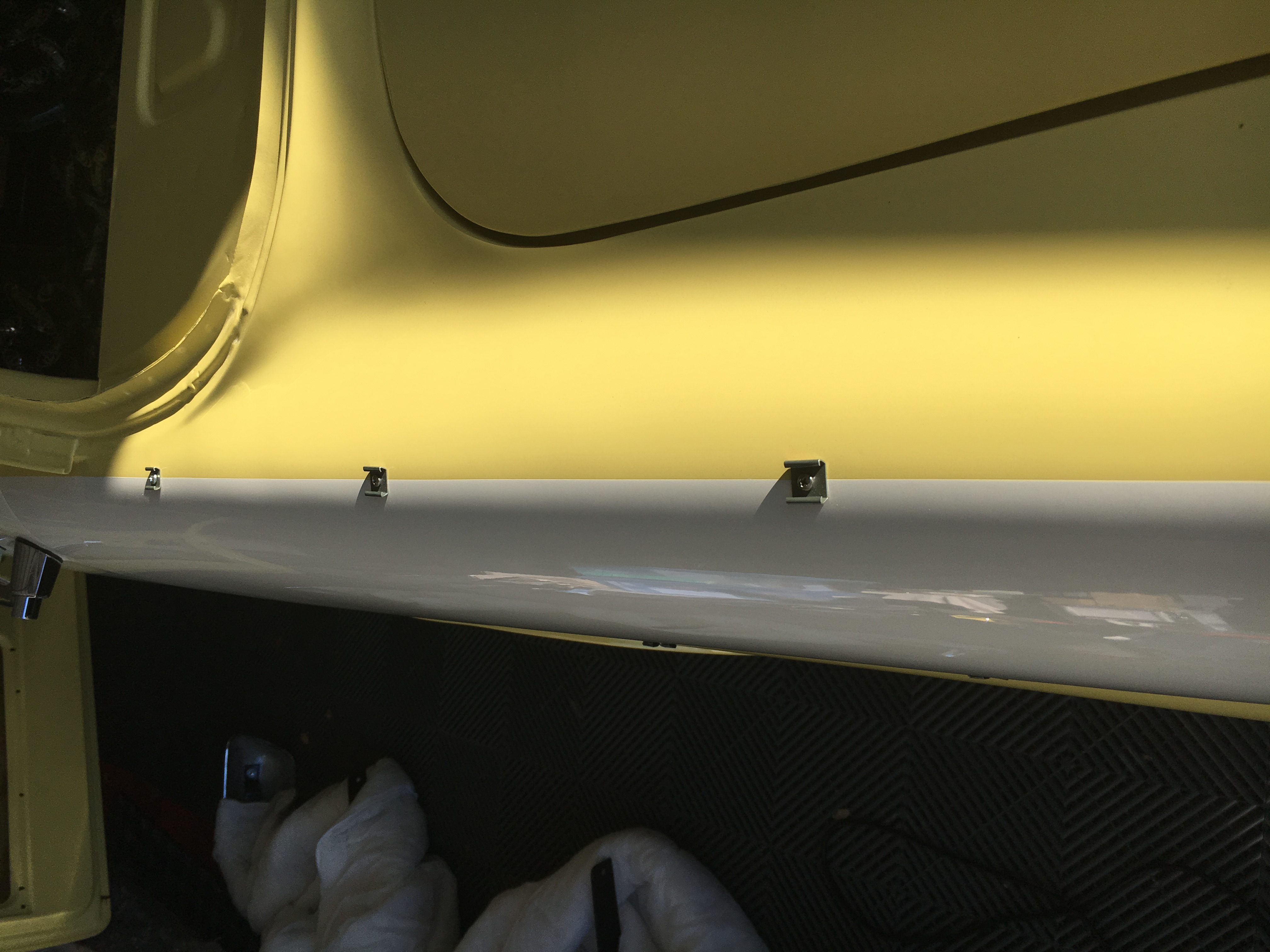

Rear tail lights are in, rear bumper is on (hit my first issue here) and have just moved on to the rear quarter panel top moulding (think it may be called the crown?) Anyway I have purchased some moulding clips from Rares that say they are specifically for this moulding but I am not so convinced.
The square threaded clip, which is for the very end of the moulding closest to the indicator lens, doesn't fit but I was able to trim it up and I'm sure I can bodgey something up to fit on the inside of the rear quarter to secure it. The other clips I'm not so sure?
Does anybody if the these are the right clips? How do you fit them to the moulding? Do they just push on? I have tried a few different ways but as you could imagine I'm a bit gun shy with brand new paint.
Any help would be much appreciated
gpi
Posts: 1131
Re: FB Special project
Post by gpi »
the one wth the thread slides into the stainless trim and you bolt it down (it may need to be trimmed to get it to fit in the channel), the others press on.
yes there is a technique to it so you dont damage the paint or stainless so best to get help

I believe Sam Crupi also makes the right clips for fb/ek - can track him down through facebook fb/ek enthusiasts group

Cheers guys, the "W" clips from Sam I have and used on the side moulding. The rear threaded clip I have trimmed up to fit the moulding and have used a small plate for inside the panel to hold the nut. Those other pesky little clips looks like they are going to be a bit more of a challenge.

Tail Lights in
Tail Lights in
Tail Lights in
Tail Lights in

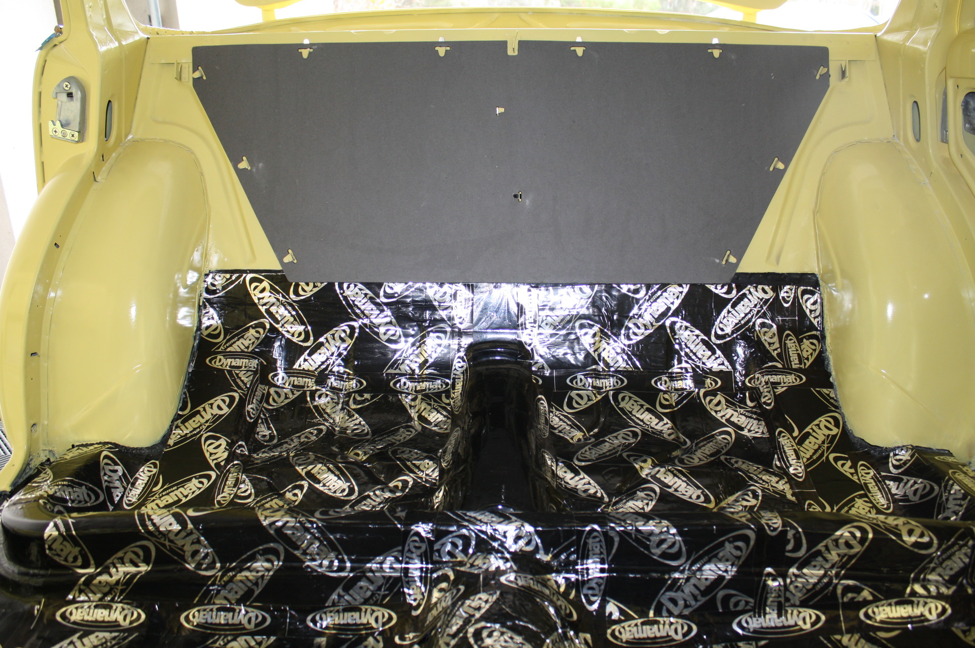

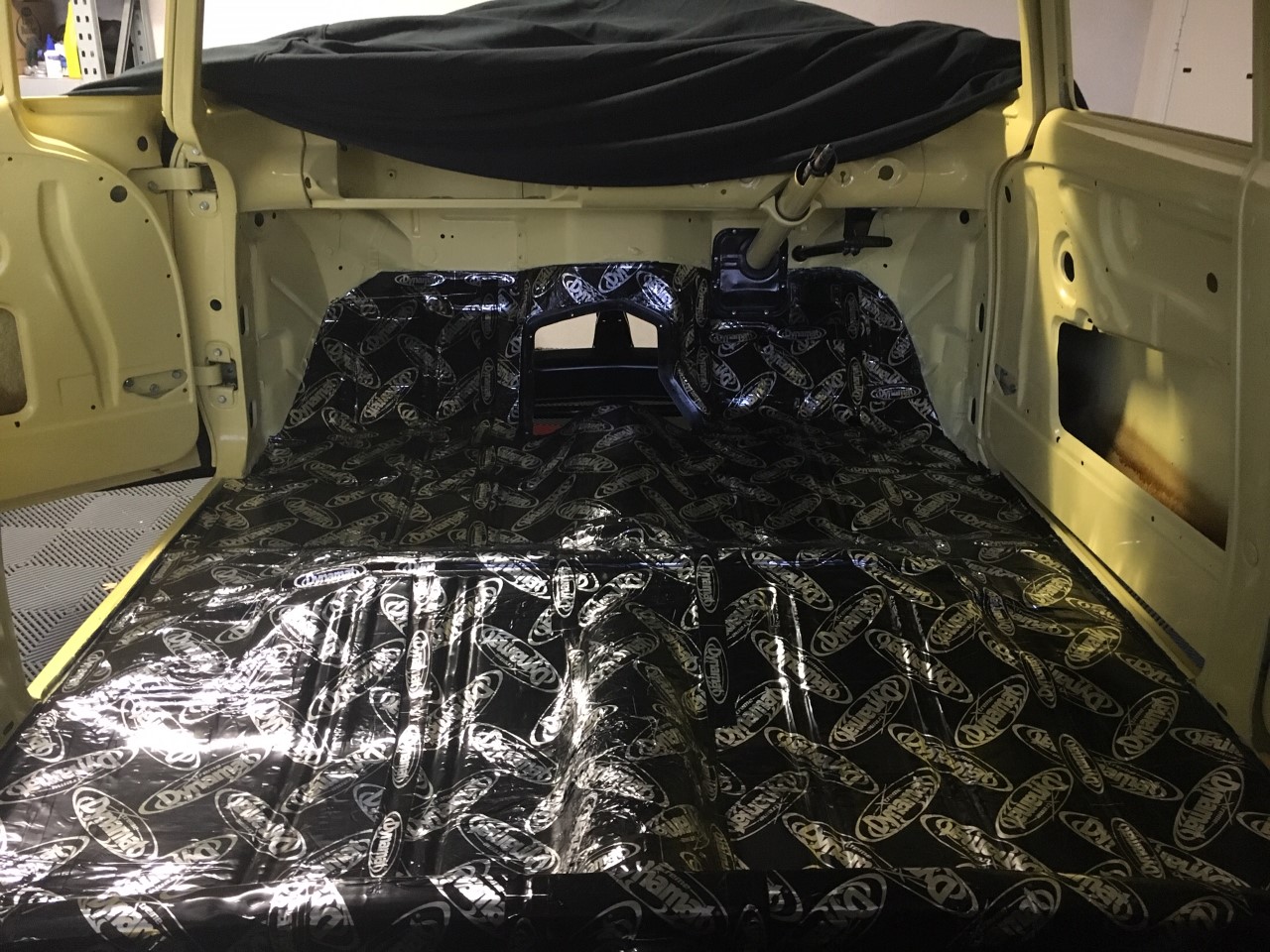

Dynamat finished
Dynamat finished

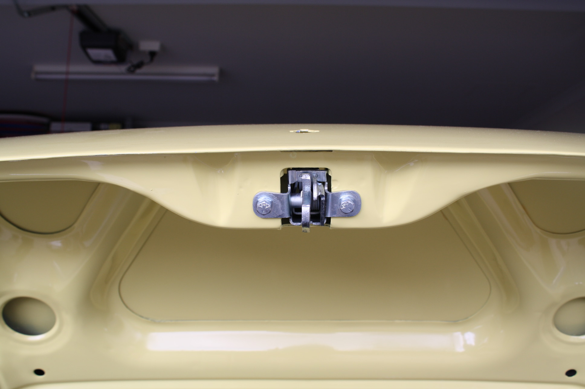

Boot Seal temp fitted

EffBee wrote: Wed Jul 17, 2019 10:13 am Does anybody if the these are the right clips? How do you fit them to the moulding? Do they just push on? I have tried a few different ways but as you could imagine I'm a bit gun shy with brand new paint.
Gpi is right, the side clips push on. Fit one edge (top is easier) then roll the other edge on. Use a long run of the blue painters tape (one strip on the top, one on the bottom) but only just push the tape onto the paint, and only just enough to go under the mould. Once the mould is in place, it can be hard to get the tape out if the tape was really stuck on.

Cheers Harv, I'm going to have another crack at it this arvo after work. The blue painters tape is definitely going to be my best friend throughout this whole reassembly process I think :thumbsup:

Tail lights fitted
Boot seal fitted (hopefully the right way)

Dynamat to rear seat complete and boot divider fitted
