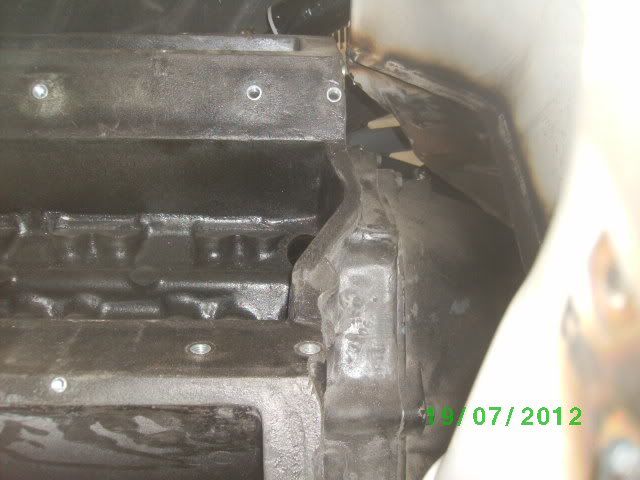

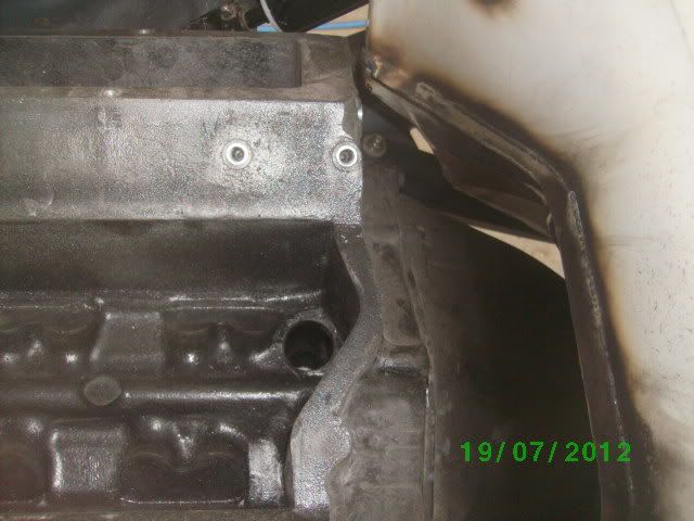

Harv wrote:Yep, Doller's right on the money. The original steering column floor plate puts the steering column too close to centre for V8's - I had to make a custom floor plate for my SBC too. It's still pretty tight on that back exhaust port (the CRS headers go almost vertical once the gas leaves the flange plate).
Harv.
When I first setup the green car I used the motor that I will eventually fit into this one and reworked the steering column plates for that setup.......it was set up with a hr type front end.........then I heard about about the frontend that Southern Chassis Works were producing, no bump steer ,small turning circle, coil over setup and awesome looks ,So off I head down to see Heath and ended up coming home with one .....the motor sits about 20mm lower with the SCW frontend so puts it right over the rear exhaust port .....looking at it today , and not a problem....you guys are correct drop it down a little more and across to the right and with luck it will fit .......the headers I have are the CRS ones Harv...............wouldnt mind a set of them stainless ones Heath has just fabbed up .... and yes it will still be a little tight ......but thats the way I like it ..huh huhh

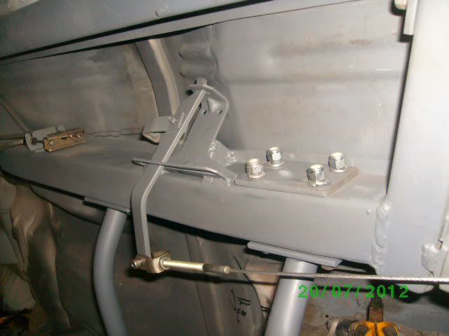

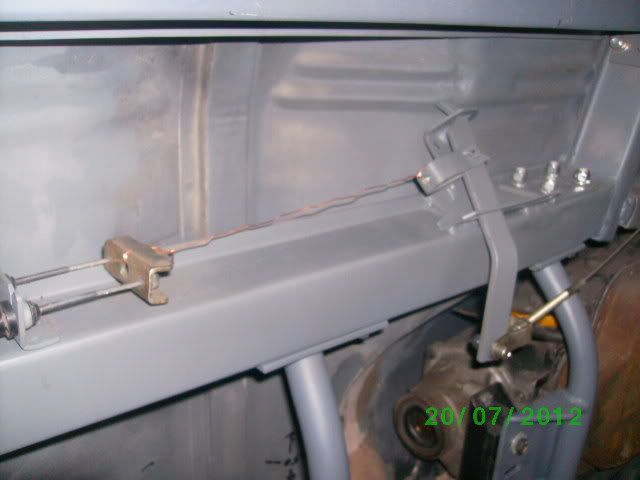

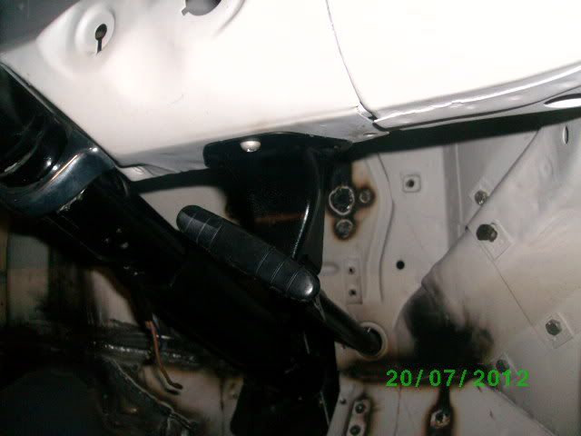

Got into the shed at the weekend got the handbrake sorted ...used the standard FB handbrake pull lever....I tried using 1 straight cable from the lever to the rear cables but it was too hard to activate... I reckoned it needed some leverage
.... so found a handbrake setup from the donor car and cut off the cantilever hand brake mechanism from the cross member and reworked it and welded it into place on the new chassis rail to activate the FG F0rd handbrake setup on the 9'' diff ...nice and easy to use .......got to get 2 new cables made up to suit .......The guys at Auto Cables .Yarrambat ..Phone 03 94361260 ...can make any cable , very quickly and at a very reasonable price ...They made the first cable ...used thicker cable, supplied and fitted the ends and got it to me in the mail the next day ....great service ..

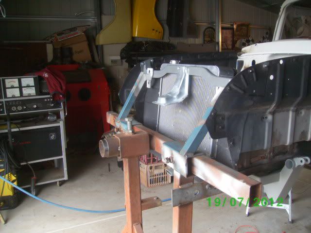

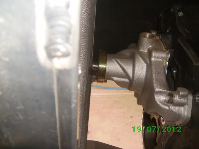

Fitted up the Desert Cooler aluminium radiator ...had to trim the sides of the radiator panel and cut out 30mm from the radiator cross member ......result is 20mm clearance between radiator and water pump shaft ..can probably trim another 10 mm from the water pump shaft ......the engine has approx 20mm between the right hand bank and the fire wall ...overall very pleased with fit .......Started on the steering column by moving it back 20 mm into the interior giving me some clearance to the steering shaft and extractors just got to move the column down and across 20mm and its a goer ....next weekend finish and hook up the steering .....

Hey fingers nice fit up with that radiator. :thumbsup: Lucky your not running rear mount thermos
I had to make a new radiator support wich got me 20mm clearance, trim 10mm off the sides of the thermo shroud to sit it closer to the radiator and also cut that extra 6mm off the water pump shaft, Then had to cut out the back of the bonnet latch and redesign that so it didnt hit the top of the ally radiator :roll: :roll:
