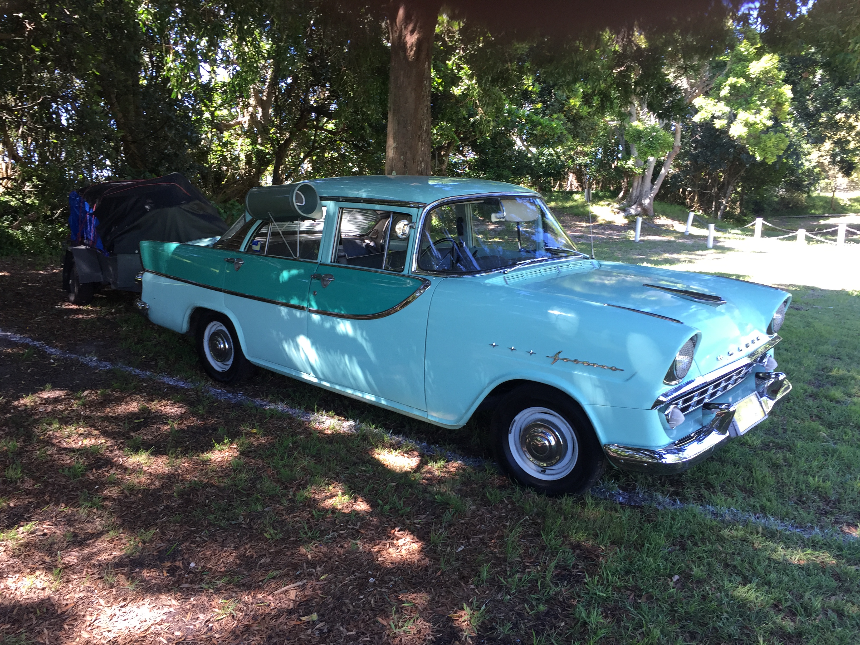

Brett027 wrote: Tue Jun 28, 2022 9:51 amI'm not keen on having such a big amp draw from electric. Thinking, thinking....
Ultra-low current version :mrgreen: :

by Brett027
Thanks Harv. Nothing like a bit of lateral thinking...
