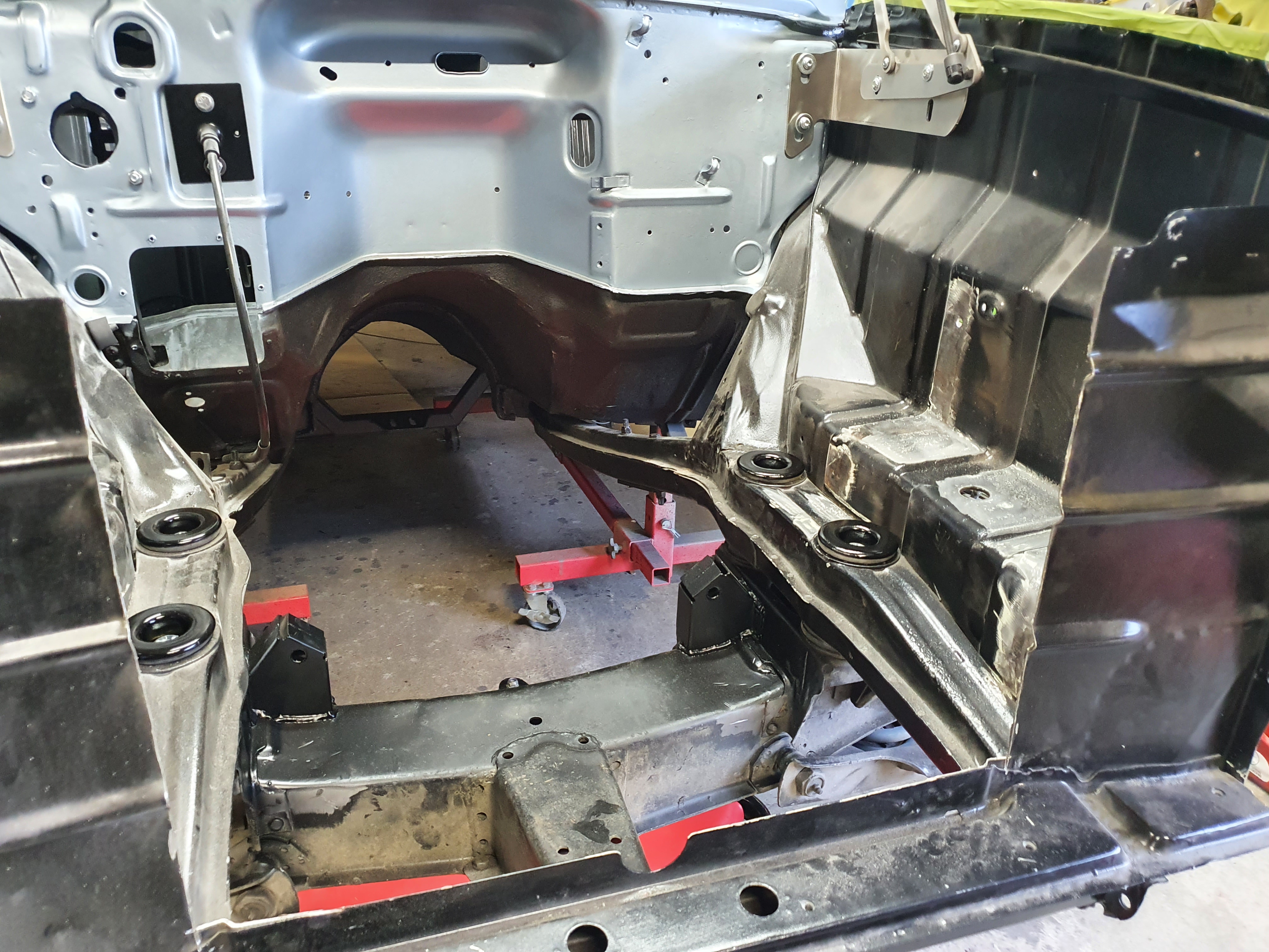

Front suspension crossmember bolted back on today ready for blank engine and gearbox to go back in to work out firewall mods needed for the tripple CD175s, and gearbox linkages. Battery box gone and replacement crossmember no1 tunnel brace ( 5mm x 50mm flat) installed.
Radiater support mods underway as well.

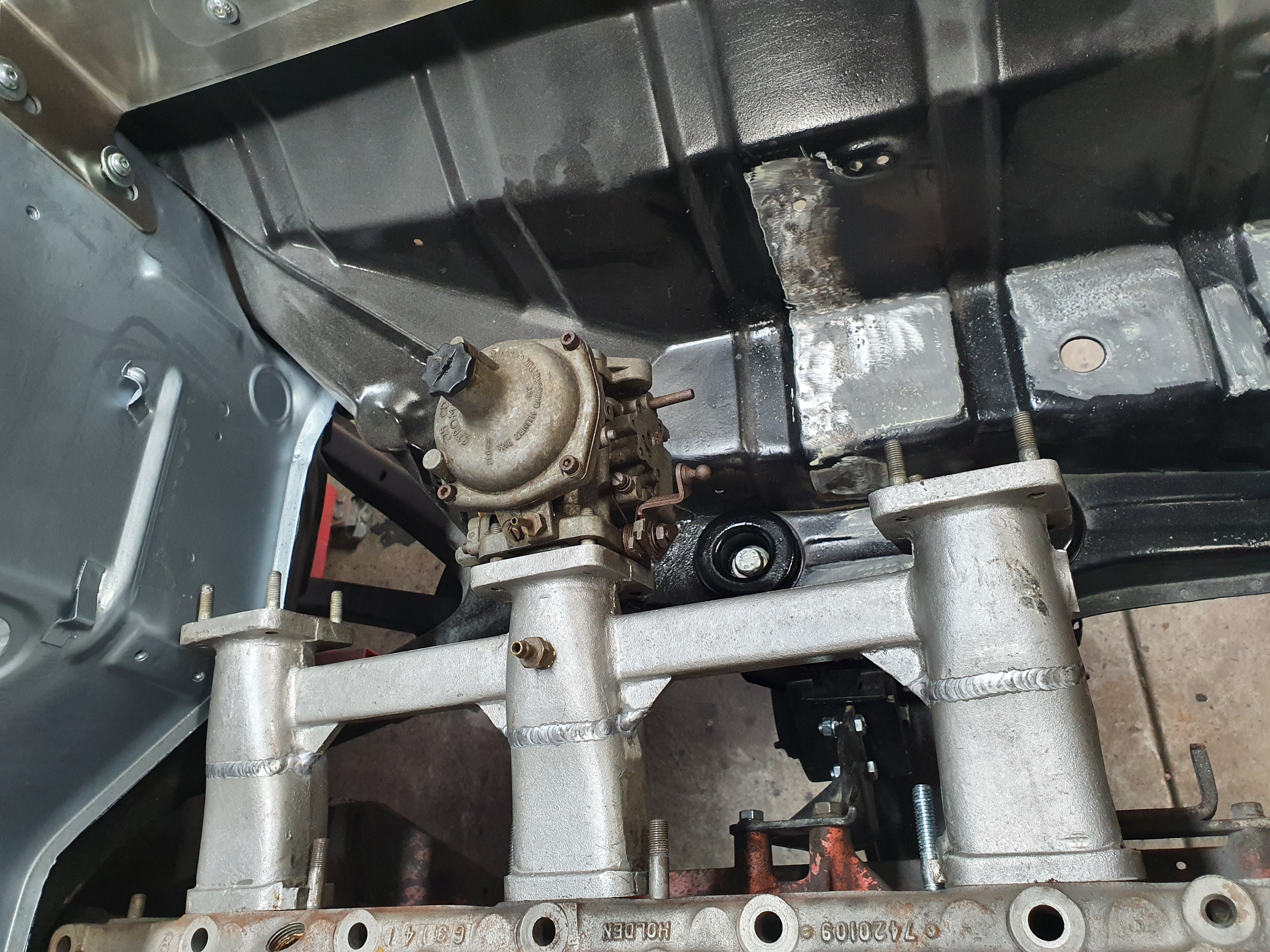

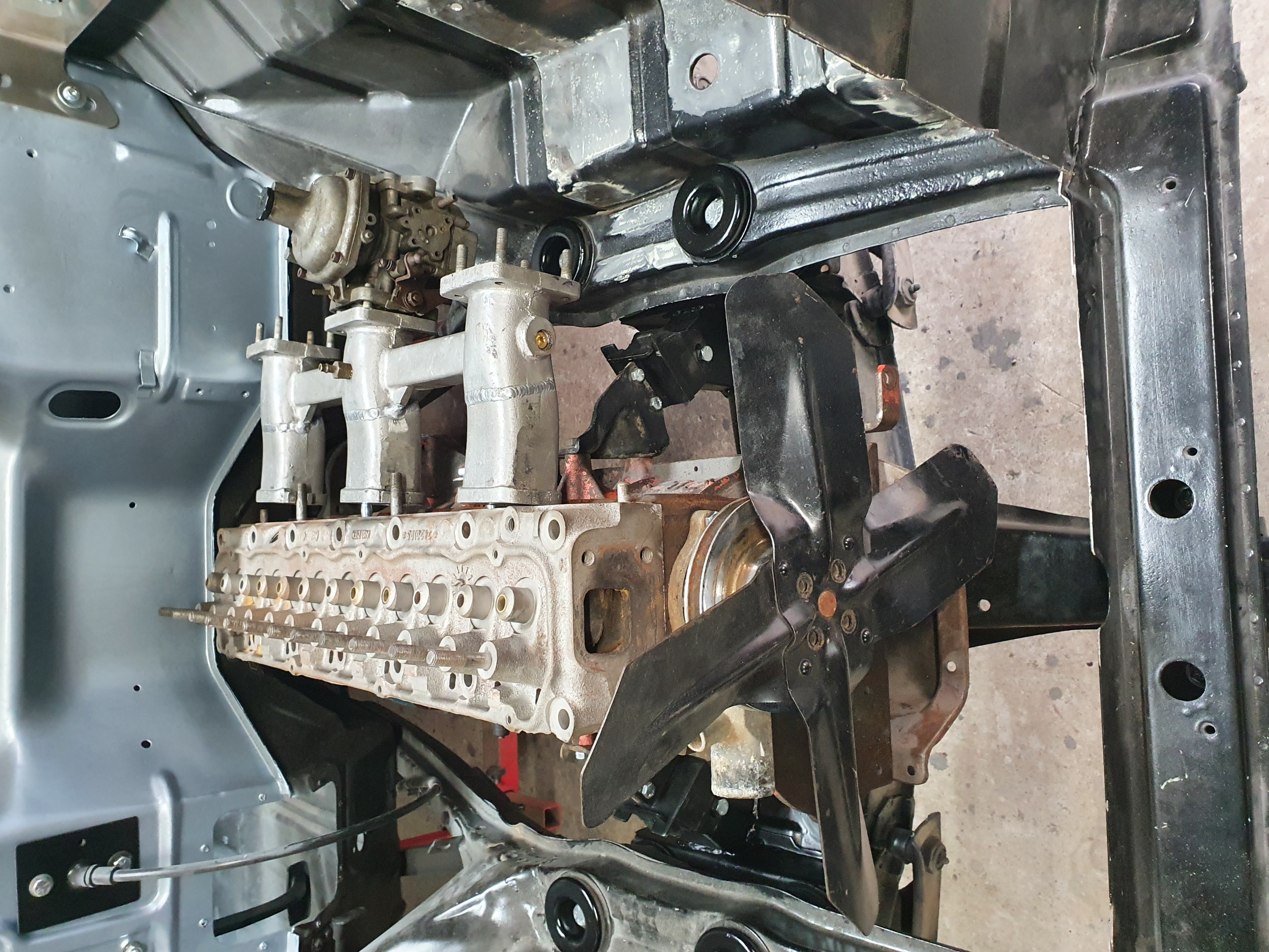

Well, a bit more test fitting. All is good. Having the mounts before and after the bracket skews the motor so unless someone can convince me otherwise, I will have them both behind the engine plates.
On the other hand, the tripples are producing a world of pain. I was expecting to remodel some firewall tin and was not bothered by that, but now see that I am also going to have to reshape the inner guard strut to get the back aircleaner to fit. Consultation with engineer required methinks.
Photos showing success and problem.😁

Ah yes the modifications, gee I love em !!!
10mm minimum gap from body to engine and hardware, so looks like cut cut !
I had triple SU's on the red engine back in the day with domed air filters, nearly fit but had to do the rear carb chop into the firewall and that was all.

Yes this modifiying mallarky has wiskas. I will do firewall first and then see whether air cleaner or strut mod is required.
