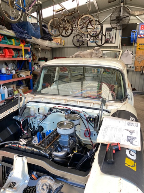

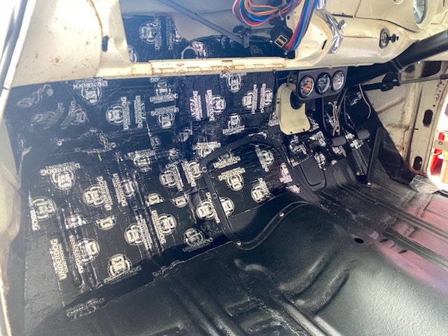

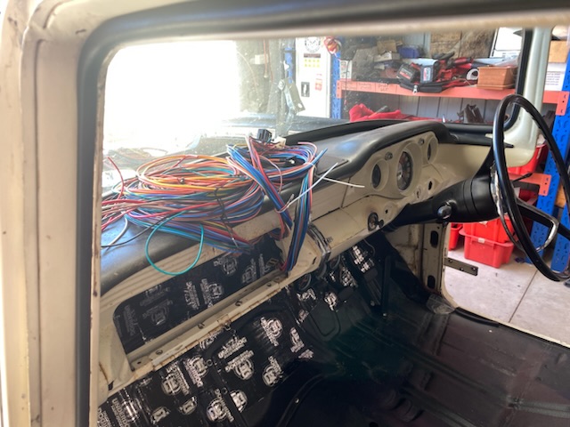

Thanks guys for the kind words.
Had a good couple of days.
My auto sparky came over and we wrote a list of little things to get done before taking the car to him.
More I do is less he charges me.

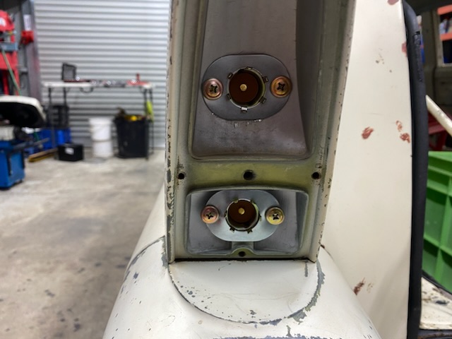

Got the fuse box mounted and wires slung onto the dash so it’s easy for him to start feeding it though out the car.
Layed a remaining pice of dynamat on the fire wall.

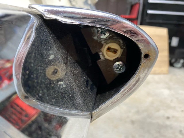

Mounted the rear indicator, reverse and number plate light sockets.
Made a battery clamp out of some angle iron too
Also retorque the head.
Had the blue boss watching over me as I did the valve adjustment.

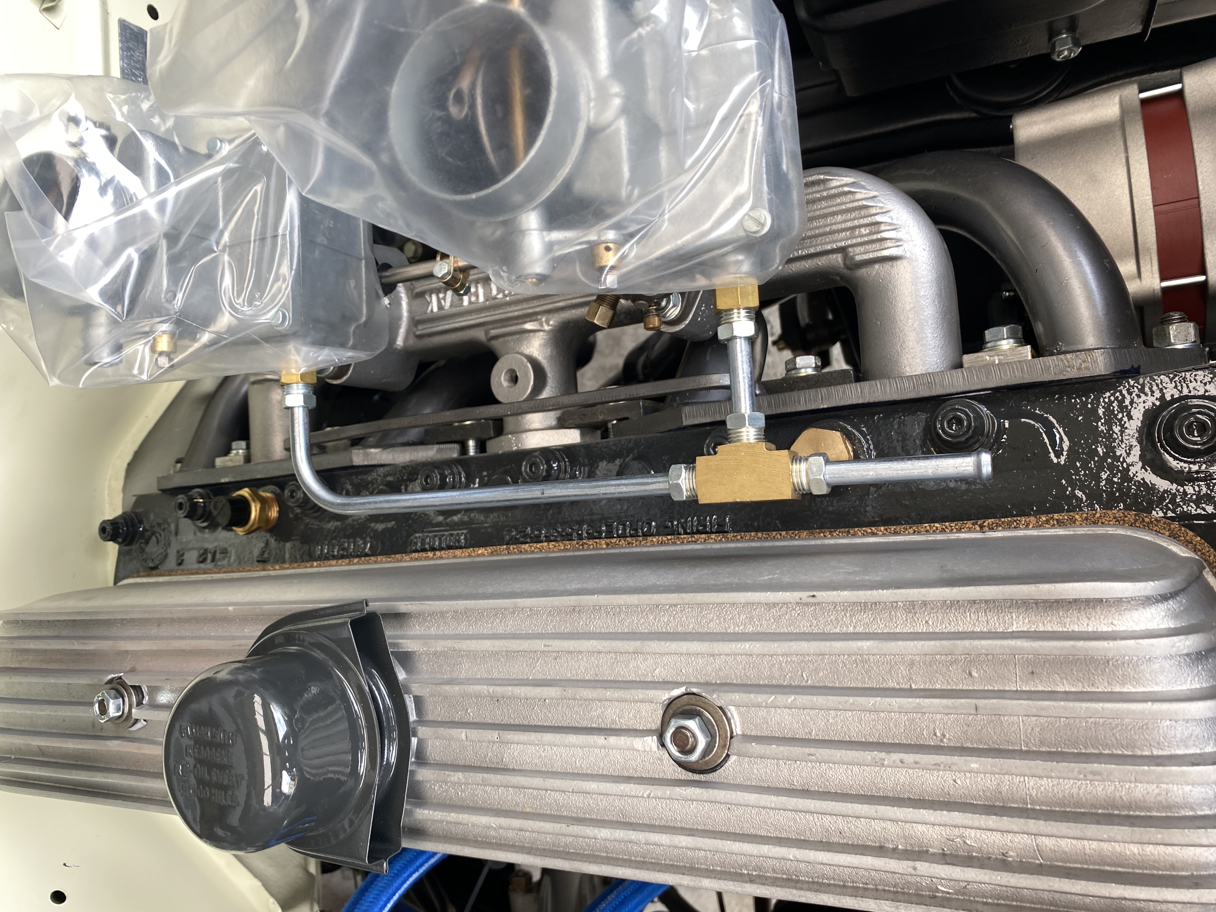

My inlet manifold has a leak in the gasket, I know this as I sprayed a little brake cleaner around the gasket area and the revs fluttered.
And yes the manifolds are dog tight.
What’s your thoughts on going a double gasket with some sealant?
What type of sealant?
Different sealant on inlet and exhaust?

In ref to your inlet manifold I can speak from experience. I would not rely on sealant. I took my manifold off and faced it with a file, straight edge and backlight. You have a mill so it will achieve a more accurate result than my work.

Try assembling the inlet manifold to the head without the gasket to check that nothing's binding. It may be that the locating rings bottom in their holes before the mating faces contact each other.
The other problem may be exhaust-manifold-related: if the extractors or headers have extended faces and holes to locate over the manifold studs, then a danger is that the clamps bottom on the extended webbing of the exhaust manifold, and provide little clamping force on the inlet manifold. (Way back when, I put twin Strombergs and extractors on a grey. I cut the webbing on the extractors back to the same dimensions as the stock exhaust manifold to equalize the clamping forces on both manifolds.)

Manifold was killed flat and checked flat against head 100%
Not using location rings, it’s been rolled pinned in place for location.
As for extractors, all things you mentioned have been done.
Extractor faces were 10mm thick and manifold faces 9.5mm thick, I made custom clamps which reflect the correct size 1/2mm off set and the clamps are thick Bisalloy plate steel so they won’t bend.

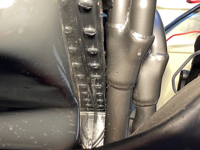

However now you mention it I noticed the extractors touching the bottom of the engine block when I was under it the other day, I wonder if this is effecting the clamping position of the manifold?
My first thought is that the manifold and extractors would clamp somewhat individually via the clamps.
You may be able to see my custom clamps if zooming in on this photo but I can’t guarantee it.
Also I did take the manifold and extractors off and reused the old gasket, maybe these 2 issues are by problem?
Will get photos of the extractors touching the engine block next time I’m ‘In the Shed’ lol

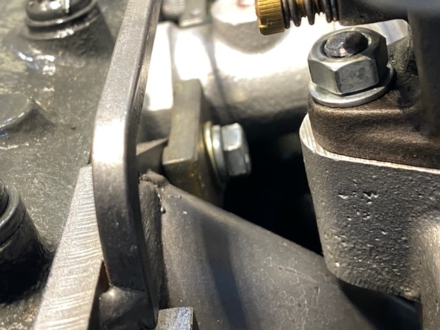

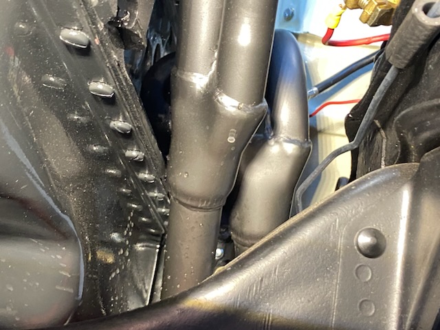

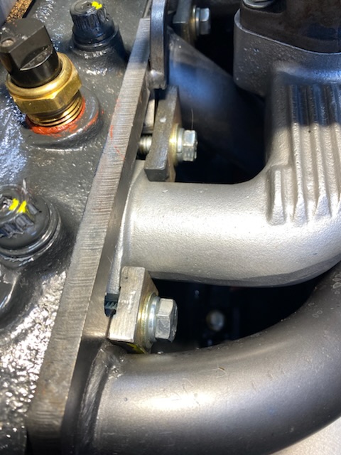

On another note this is the HiTec headers and how they touch on the engine block.
Also some photos of my custom clamps
I did see that at Jaycar but the battery lasts next to nothing so I’ll look for another alternative or a simple kill switch will do the job!

Re: FB Standard Wagon
Drew,
Time for the ball-pein hammer, I think. With the extractors fouling the block like that, you run the risk of blowing the manifold gasket on the underside, where you can't see the leaks.
