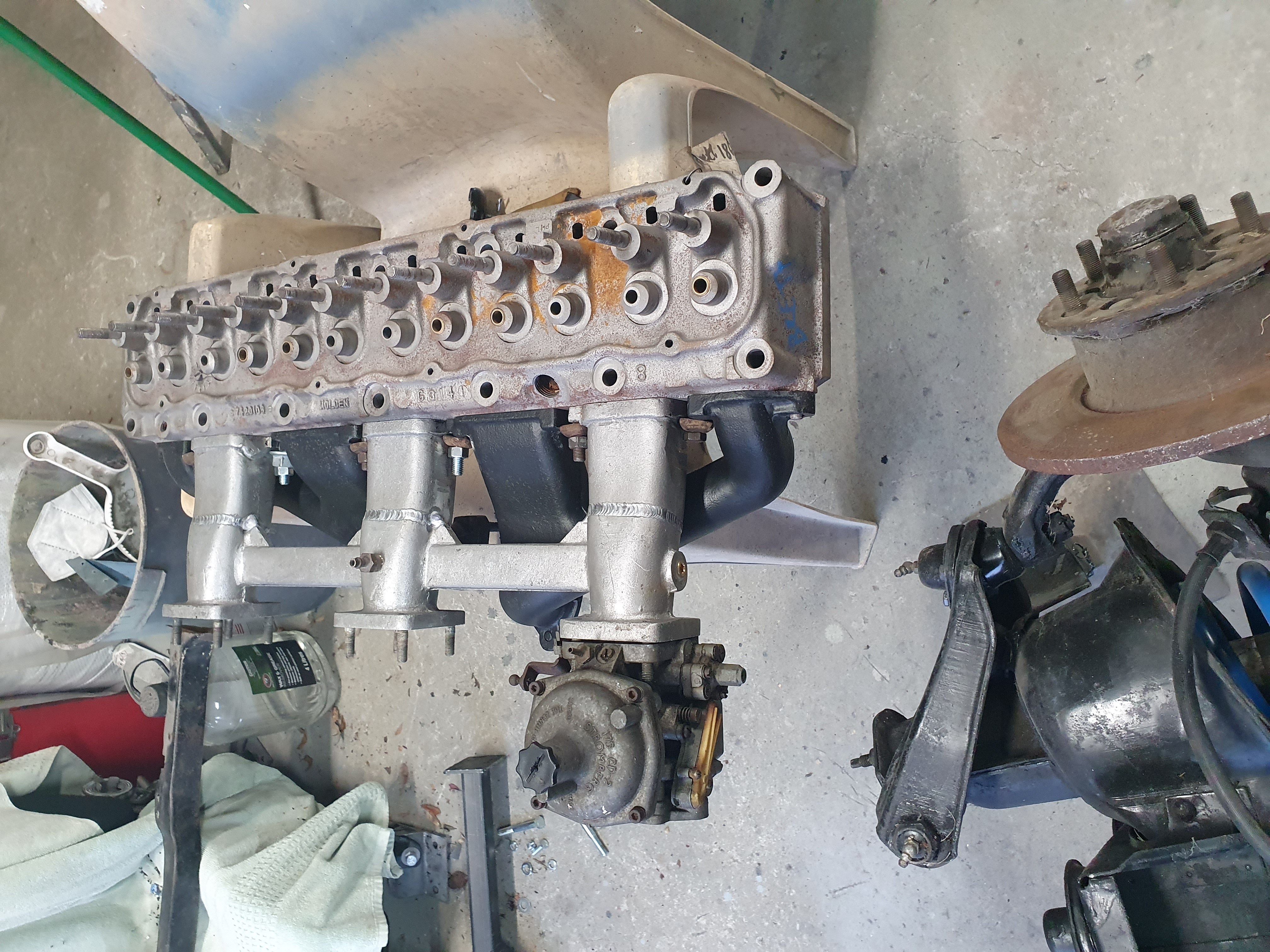

Re: Project 2.
Got my SU intake manifold straightened out to enable a level fit of the tripple sidedraft strombergs. It is going to take a fair bit of redesigning the firewall to get the end carb and air cleaner to fit. Rob's headers are a neat fit already.
Tomorrow will be the rebuild of 1st cross-member hump brace if I can get a go at it. Then once that is sorted, firewall mods.

I don't understand why it would be necessary to modify the manifold Brett. Will the carbs now be level with the head, which will generally be leaning back about 5 degrees?
Posts: 2536
Re: Project 2.

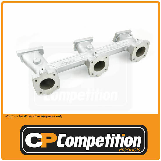

Hi Clay, it's necessary because all but the original XU1 tripple carb manifolds have the carburetors sloping upwards. This is ok for SUs which have adjustable float chambers that can be levelled to compensate. The CD175s are not designed to have the float chambers tilted and so my manifold needed to be adjusted. Pic of a common manifold that works for SUs but not CD175s.
I would have happily used an original XU1 manifold, but didn't like the 1,000 buck price tag.

Posts: 11675
Re: Project 2.
Ok thanks for the reply. I wonder why they don't make them to suit the cd zenith Stromies.
