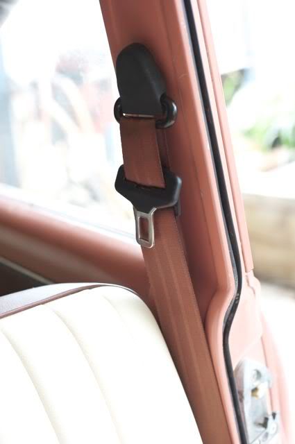

Here's where I bought mine from.I bought lap/sash for the outer seating positions and lap for the inner ones.You just tell them what belts you want and what model car they are going in.
Kit comes with all belts,bolts,spacers,washers and under floor mount plates to conform with ADR's for seat belt restraints.

Unfortuneatly the new type belts look really out of place in older cars, but I can get them in a variety of colours, and if you can find some old original metal buckle sets I can fit them, and have them re-webbed if necessary. We've done a lot of old holdens.

Im in SA......mmm I was hoping to get some seatbelts that kind of look original, yet still compliant...what s the chance of that happening?
