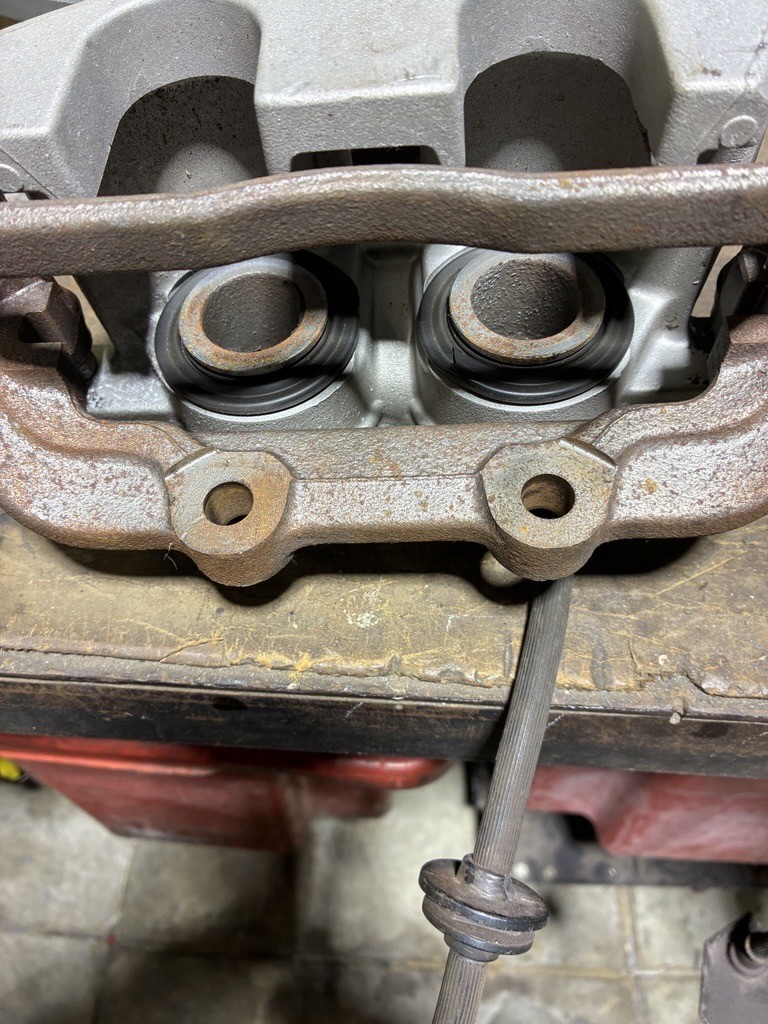

Hey Greg it isn't the adapters that are the problem it is the callipers, where I have ground the calliper in the picture is to flatten the mounting area and so that when it mounts to the stub axle it mounts flat to the mounting face of the stub and doesn't kick it over to jam on the rotor.
I'll take a photo of the other calliper to show what I mean

Hi Greg see the photo of the calliper that I haven't ground, you can see the casting is close to the mounting holes.
Because the flange of the drop spindle where the calliper mounts is so different (larger) that you need to give the calliper the clearance otherwise the mount holes don't match up and the calliper fowls on the rotor.

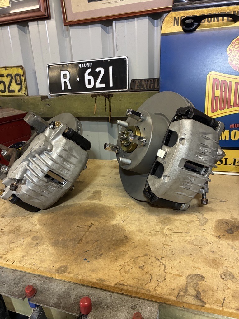

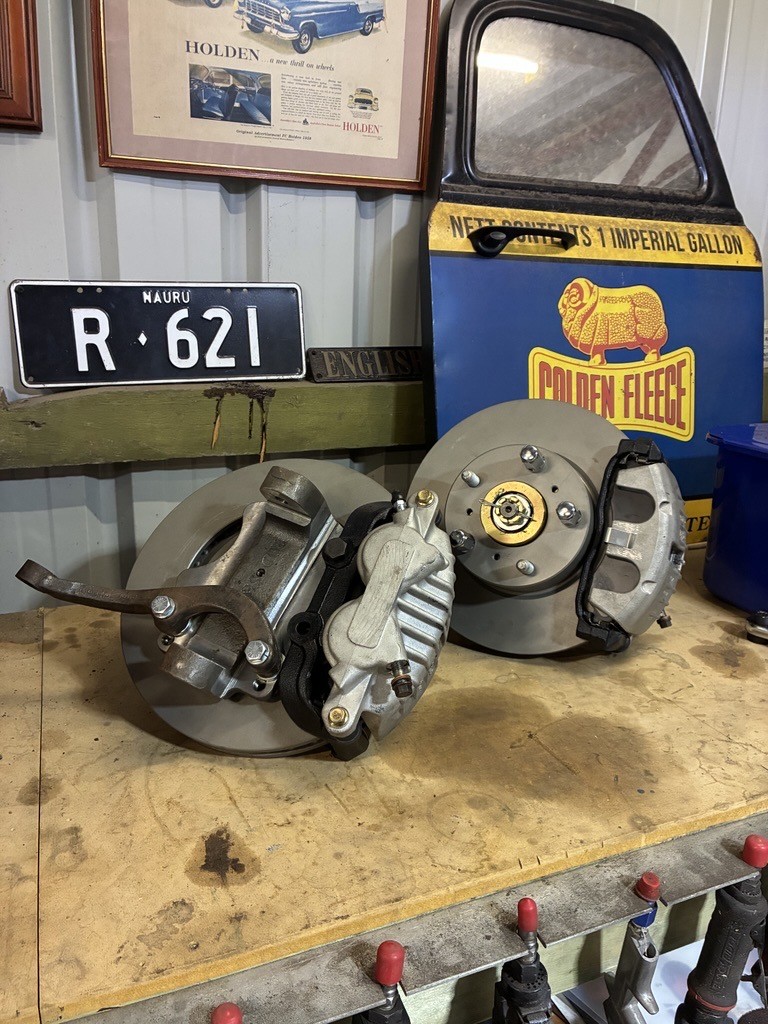

Finally got the brake upgrade sorted after some modification which you have to do anyway to get the VT callipers to fit the drop spindles.
The rotors are VT V6 but I have drilled them out to 14mm for the studs because the rear is VE which are 14mm and VT is 12mm so I wanted to have same studs front and back.
Just need springs and I can put the front suspension together.

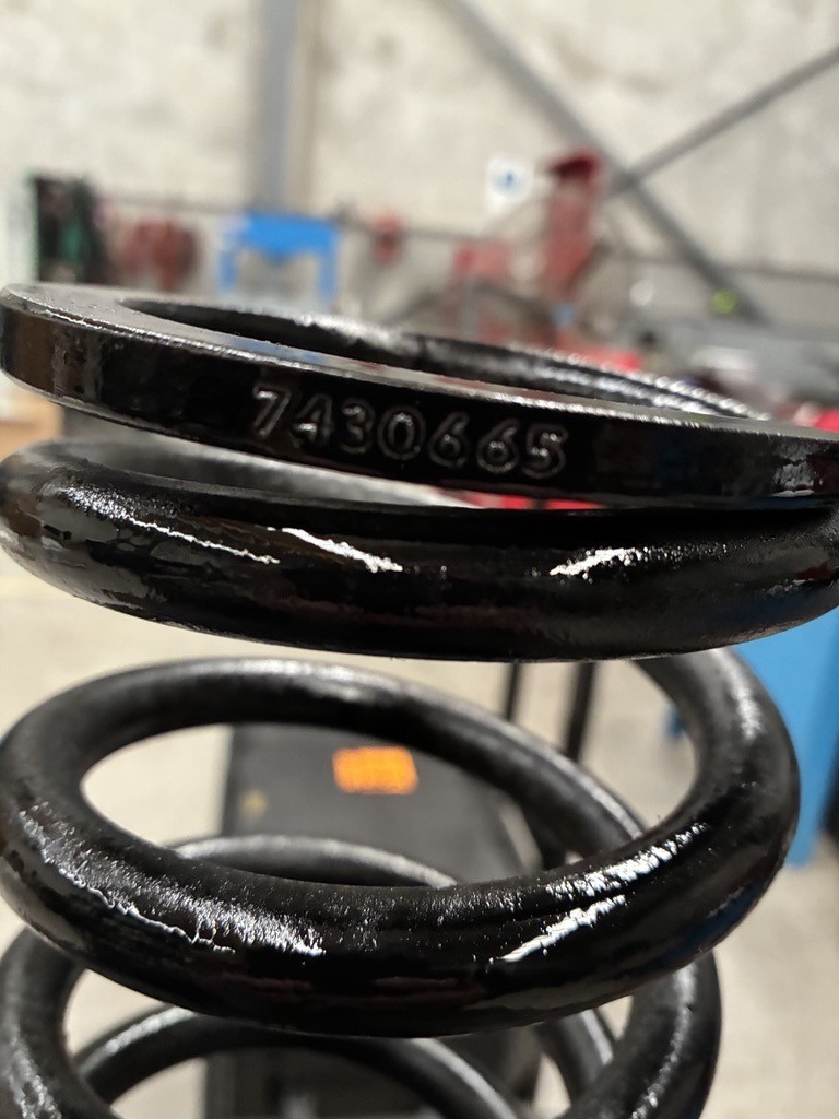

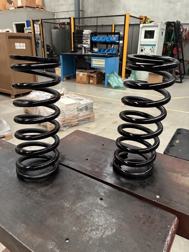

Springs arrived yesterday from Vic, they had been blasted and primed, I gave them a quick coat of paint.
Image (8).jpeg (246.25 KiB) Viewed 2087 times
They have the holden part number on them!!

I now have all of the parts for the front suspension, hopefully I can get it all together before the Boss and I head overseas later this month.

Owe and they are straight it is just the way they are sitting when I painted them and took the photo :crazy: :crazy: :lol:

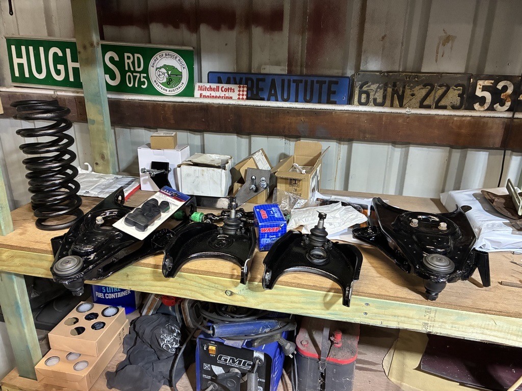

Everything ready to go :clap: :clap: :clap: :clap: :clap: :clap:

Nice work mate. Grease nipples on the ball joints? The uppers on our sedan don’t have any and I’m wondering if that is how they are making them now.
Posts: 2822
Re: Neil's FB Station Wagon
Thanks Clay
Pretty sure the uppers have grease nipples and I haven't put them in the bottoms yet as you can see.
