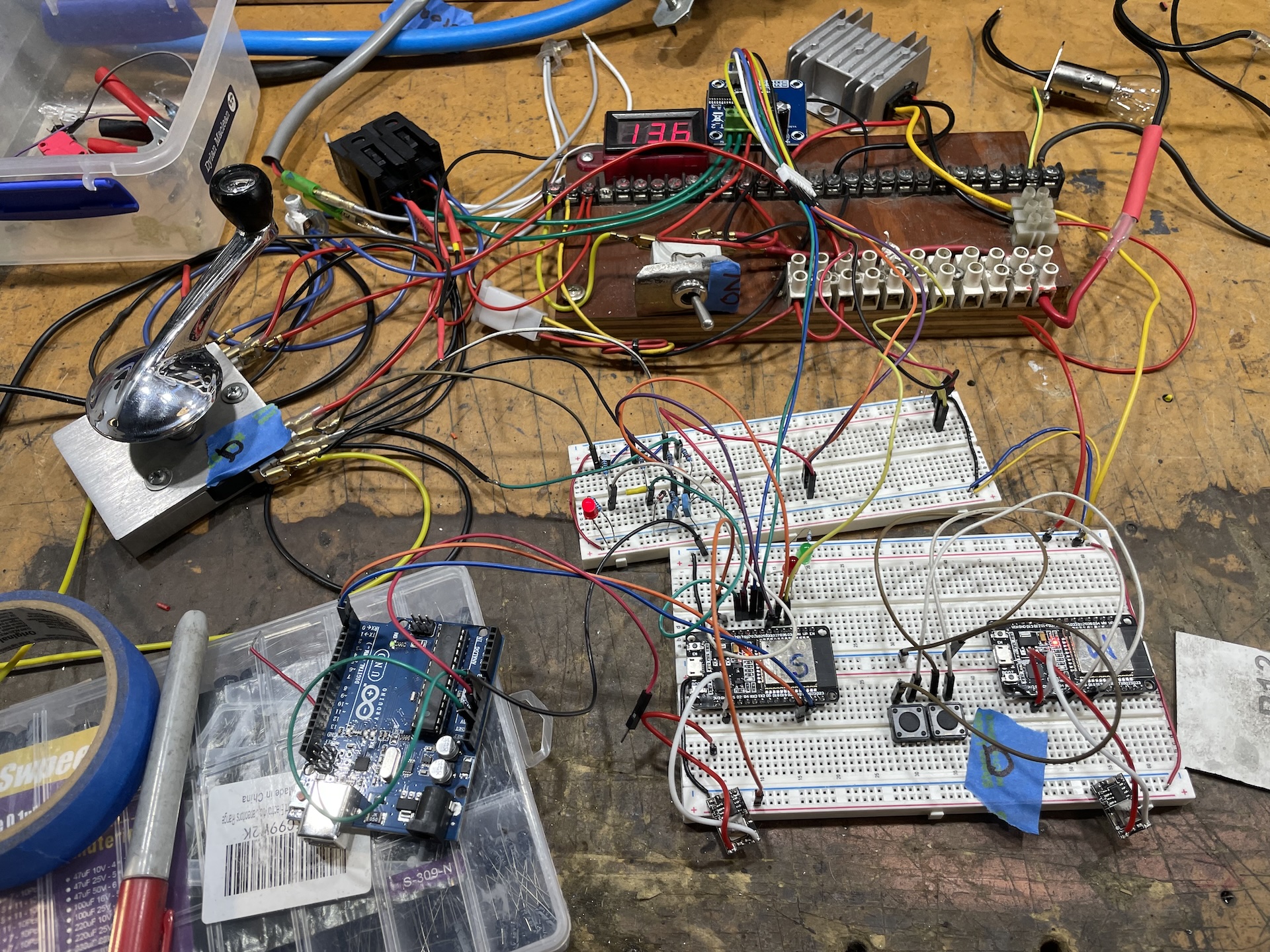

Yeah it's a mess. But it works.
Out of shot is the power window bolted to the wall.
Left is the window switch, bottom left is an Arduino which I am using to program the 2 small microcontrollers on the bread board. The one with a S (slave) will be in the doors, and the one marked with an upside-down M is the master which will be in the centre console.
Press either D on the window switch, or the Master and the window goes down until either you release the button or, if you press and release, it goes down and stops automatically when it reaches the bottom.
It does all this power control to the window with a motor controller module (just to the right of the voltage display at the top). This module (I think) is designed for robotics, and easily handles the power window motor. It also provides current feedback to the micro controller. So in the program, if the current goes up above a threshold, the motor is stopped.
The motor controller module uses PWM, so you can run the motor at any speed from 0 - 100%. I have programmed mine to ease in from 0-80% over a second, run at 80% then ease down to 20% until the current threshold is reached.
There is redundancy too. If either the micro controller or the motor controller module fail, then the power defaults back to 'normal' operation, getting 12V directly from the window switch via the 2 micro relays in a normally closed state. These relays only engage when you press a button and disengage after a minute of no activity.
