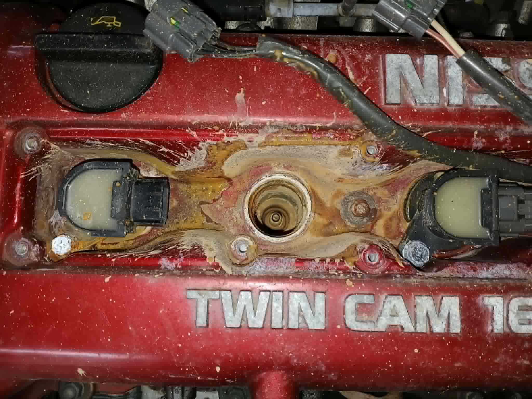

yeah factory turbo and intercooled all out of a 180SX, have to get it sorted first looked at it and drove it 18 months ago went like a bullet someone else bought it and story goes didn't drive it much and passed away (so no information) but now it isn't going well fine when cold but the more it warms up the worse it runs to the point anything over 2000rpm it just completely breaks down but only under load, i'm hoping coil packs and plugs but who knows on an engine with a computer and a hundred sensors on everything, but heat and load and the fact 2 of the 4 plug tubes were half full of water for god only knows how long and a third had had water also isn't a good sign for coils

Re: another A40
Yuk - that certainly wont help - I think you have found the problem there mate :thumbsup:
