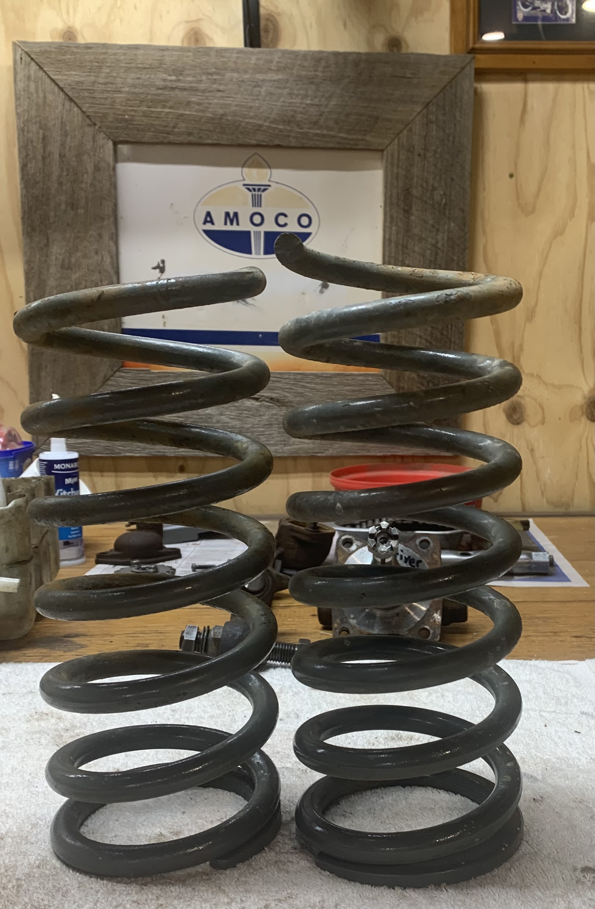

Pulled the spring from the passenger side that has a different part no from the above. The passenger spring is part no 7419137, which according to Clay’s info is a sedan spring. See picture of the spring comparison of the mismatched pair.
This probably accounts for the different tyre to guard clearance I had as per earlier post.

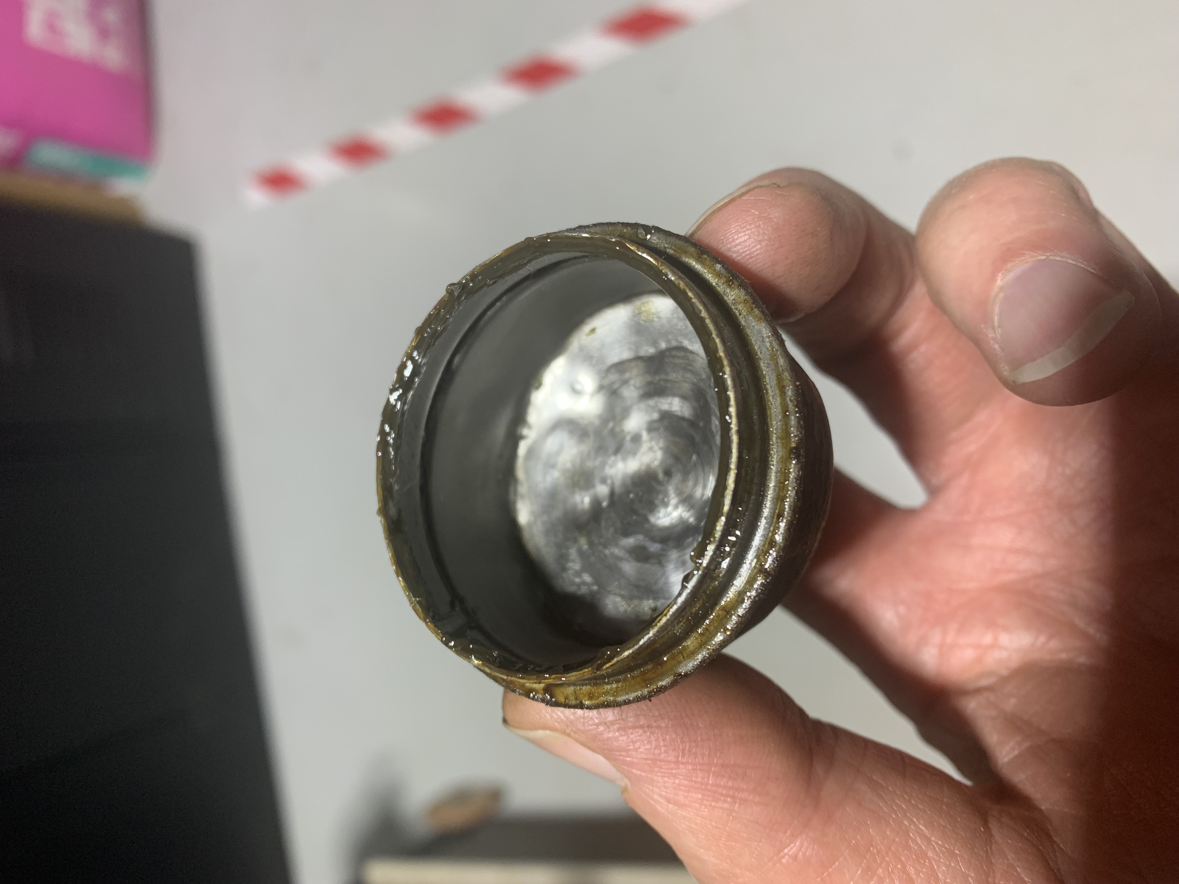

A couple other odd things I noticed was some washers missing, rubber grease seals and a shortage of grease in the wheel bearing cap. See picture of the cap prior to cleaning. Grease must have been in short supply!!

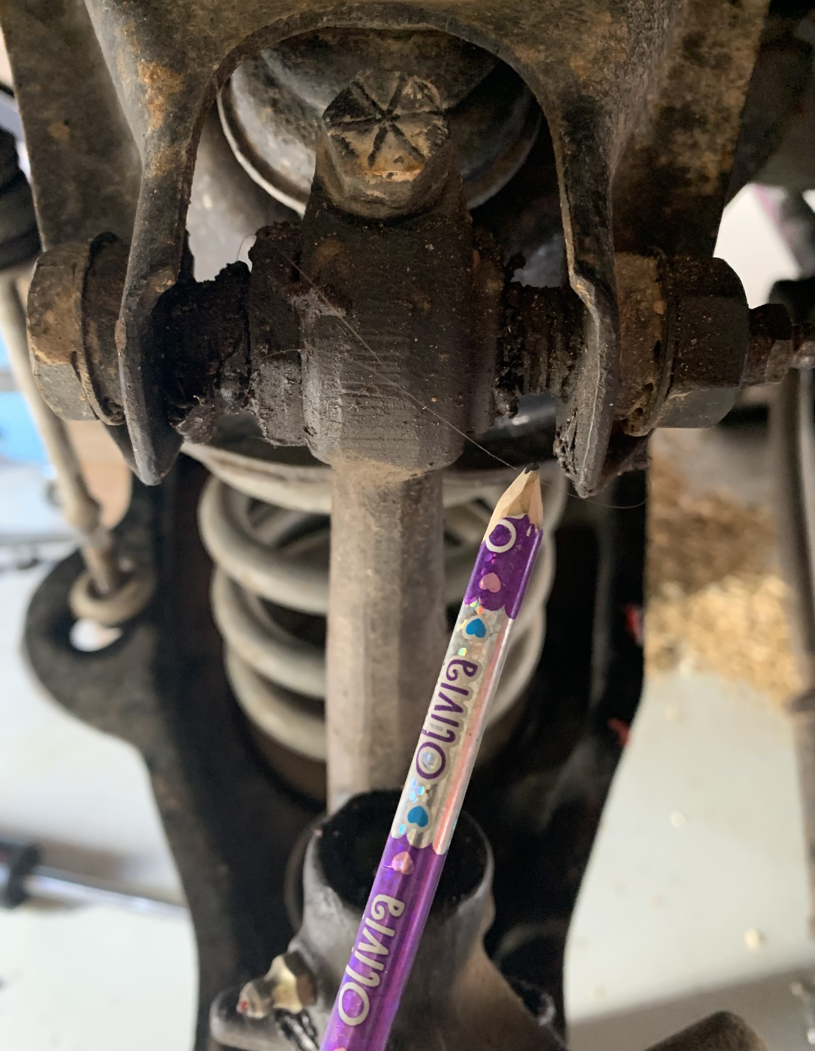

Absence of the rubber grease seals where pencil is pointed.
Yes, my ute had mismatched springs, both foriegn to the car, also.
You can use old heater hose, or go to car parts plus, for those seals.
