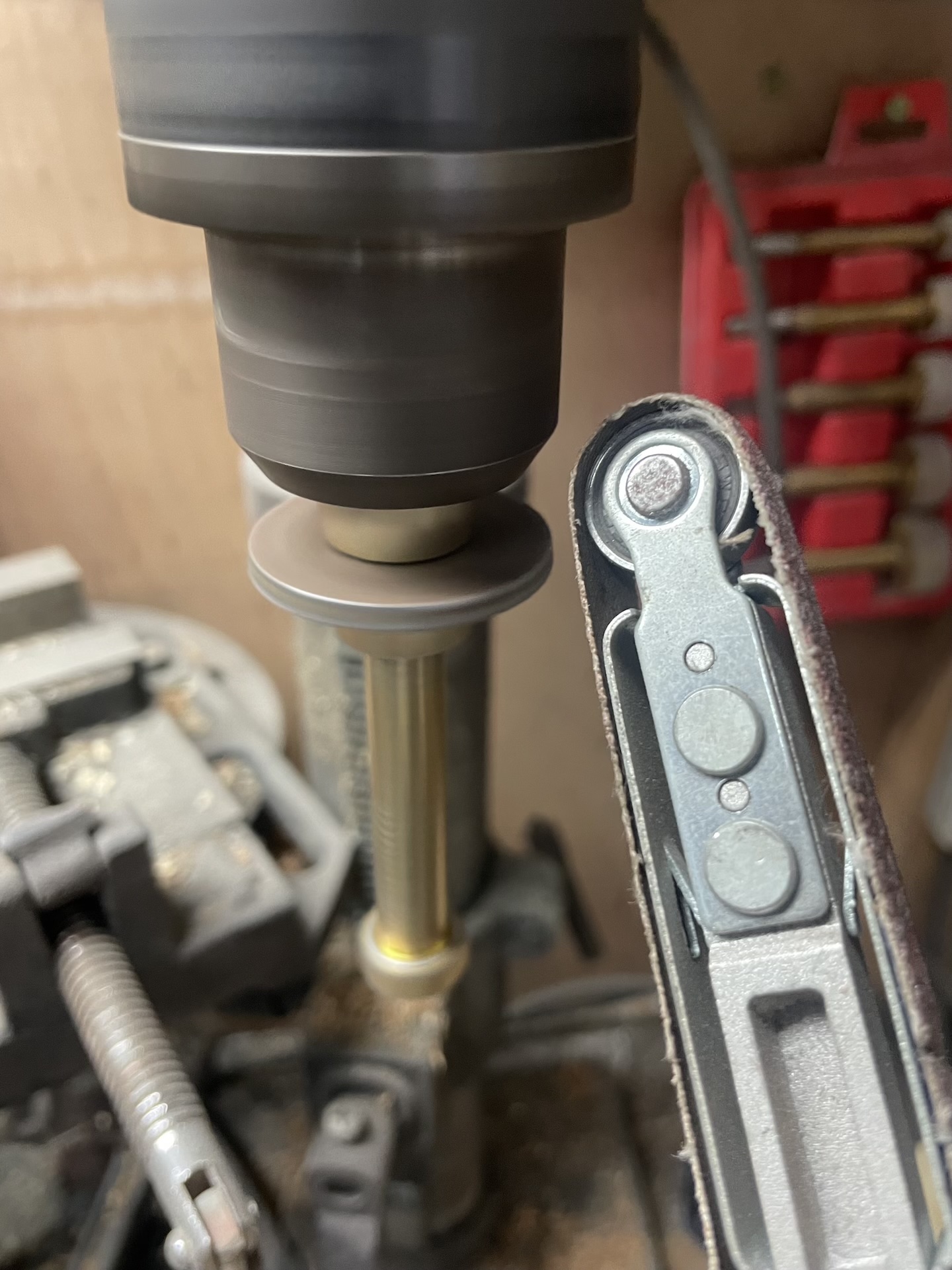

Been a minute. Tinkering away but not much going on. Just making stuff shiny with a new bench top polisher that I got to complemnt/replace the angle polisher set up I made which was pretty loud when running.
Bought some stainless coach bolts to replace the chrome ones in the bumpers. Getting imperial in stainless is next to impossible from where I have searched on the internet, so metric it is. M8 and M10 for the rears.
First polish - straight out of the packet at the bottom and polished holding the bolt precariously by hand Second Attempt. Got smart and put the bolt in a drill. Results and pretty good, initial polish on the left, drill on the right. Take a couple of minutes per bolt.

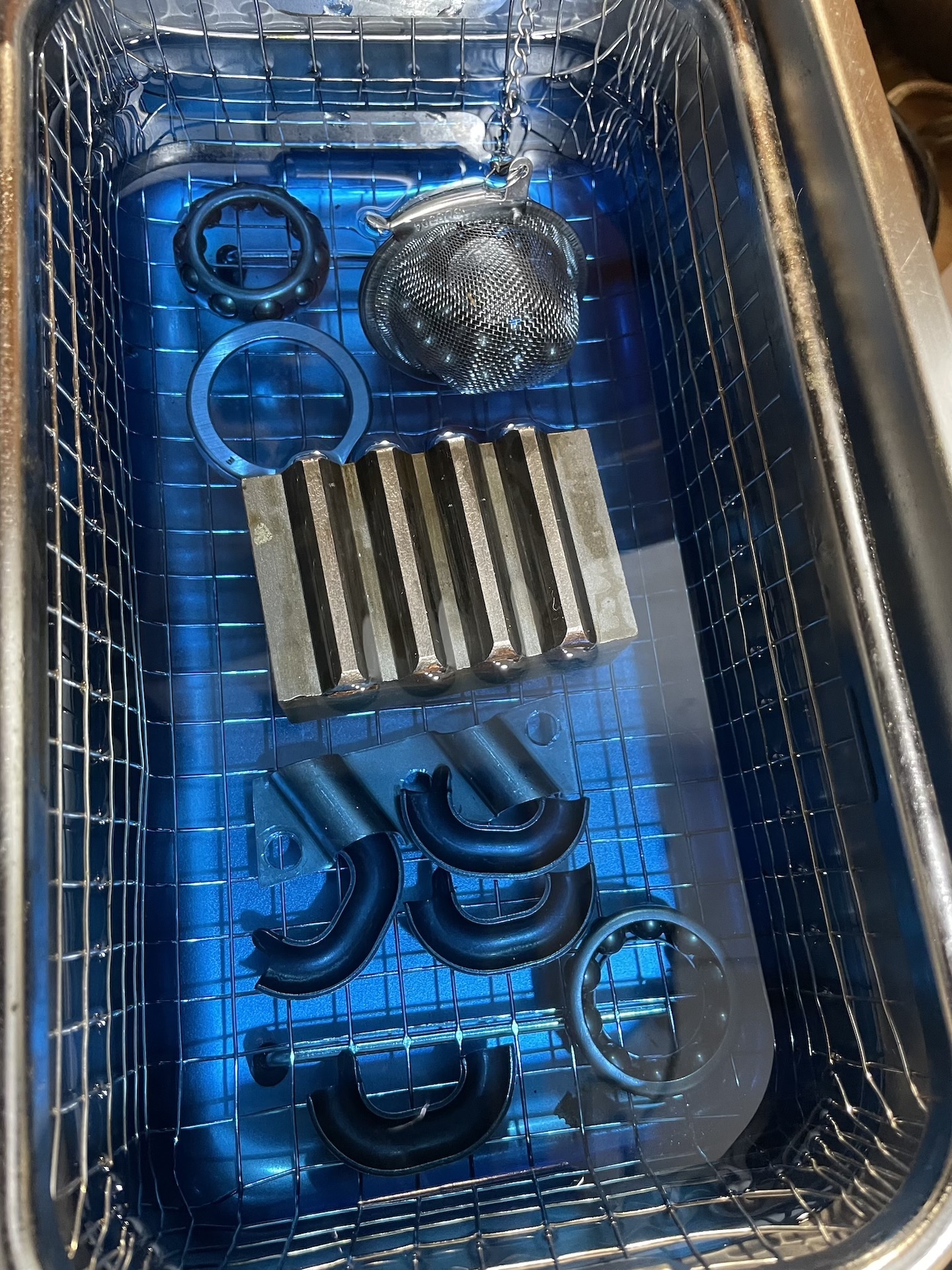

So back in May the plan was to reco my EH steering box using a rares kit.
Ordered an adjustable hand reamer (23 - 27.5mm) and asked my old man to source a large tap to assist the bushing removal. (4 month later and I’m still waiting on that tap.)
Rares kit arrives and after comparing it to what I pulled from the HR box I am now thinking I don’t need the kit. The bearings and races are in really good condition, and the bushes in the EH box are not sloppy with the HR sector shaft roughly fitted.
Only one way to find out and that will be to rebuild the EH box with the HR internals and see how it feels on the car for play. Won’t be able to test it in anything other than the vice for now but curious to know.
The ends of the splines on the shaft have been mashed a bit and are preventing the my pitman arm from fitting very well. So out with the file for a quick chamfer. Used a flat bladed screwdriver to tap out the HR bearing cup. These two recesses in the steering box are your friend when removing. Everything into an ultrasonic kero bath. Monitored temperature so as not to let it get too hot (google says flash point of kero is between 37-65C). I stop when it gets to 35 C. Clearly not a risk taker! Initial fitting of the bearing cup into EH box. In my ‘lathe’ I turned a washer down to the OD of the bearing cup. Final fitment with bolt/washer/socket combo pulling the bearing cup into place. Result Then it was just a matter of greasing everything and fitting. No photos as this was all dirty work.
Putting all the balls back in the nut was not as hard as I thought it was going to be.
Left the bearing cup in the HR adjusting nut and swapped it for my EH one.
There was minimal slop between the HR sector shaft and EH bushes, and the shaft moved freely so for now I’m going to leave it at that. Got the overhaul kit for future Scott if he needs it.

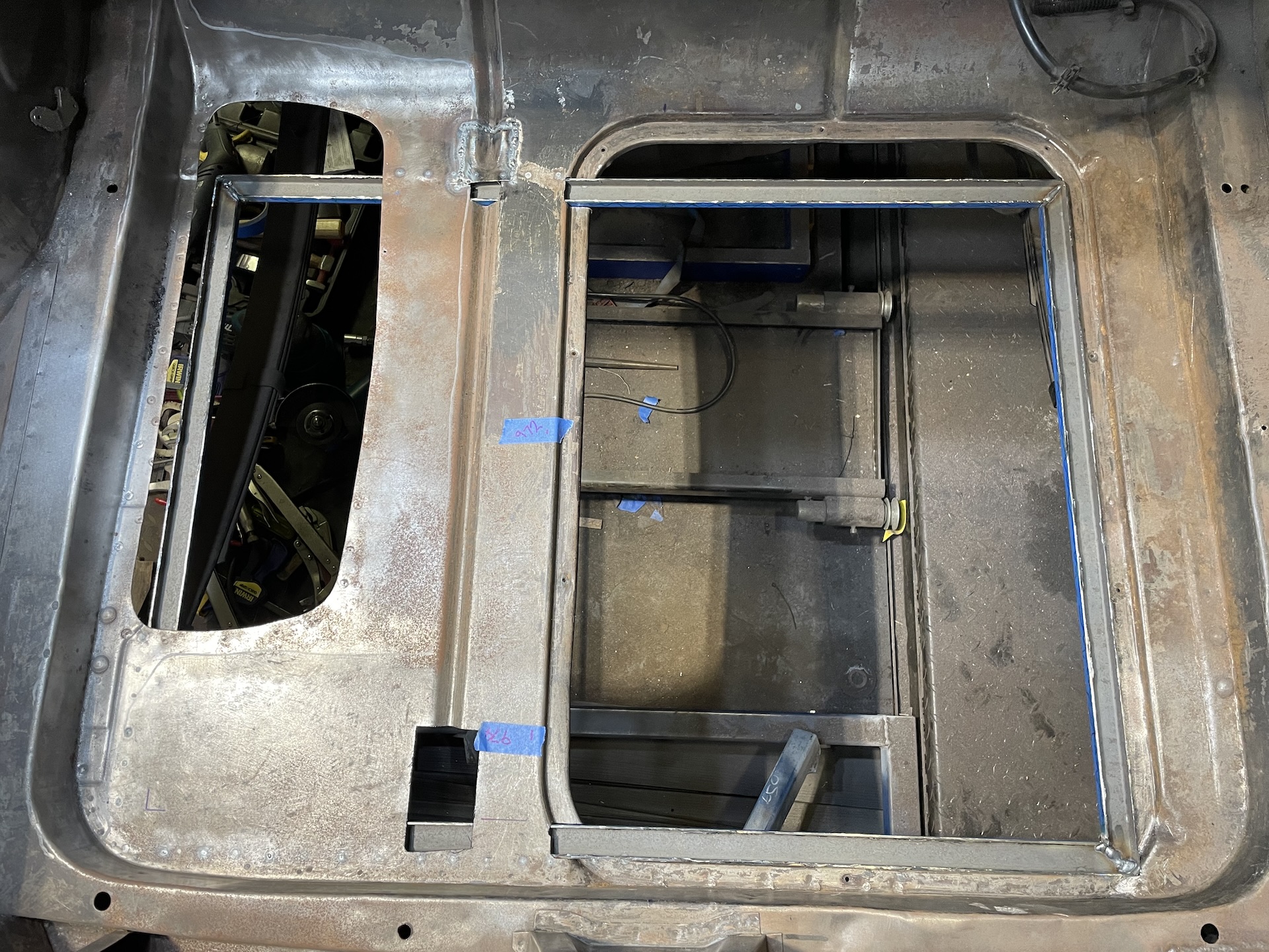

Mustang tank install time.
Started off with a measuring tape and some CAD. Inlet pipe is slightly offset from centre by 20mm to the right, so tank has to be offset to the left.
Plan was to build a frame out of 90 degree bent sheetmetal. As I don’t have a brake I got creative with a bit of scrap 25 x 25 x 1.6mm SHS to build a frame. Figured I could split the tube I had with a cutting disk in the angle grinder using the guard as a guide, and the result would be nice and thick and straight.
Not quite - 3 cutting disks later I had these 2 bananas.
Bent over my knee to straighten, then cut out a notch and bent to create a 90 degree corner, repeat and clamp the two lengths to the tank and mark, ready for final cut and weld.
Flip the car onto its belly, marked and notched out the bits where the lip of the old tank and and the bead roll were preventing the frame from lying flush.
Side tracked as I decided to take the end of the bead and move it to the back behind the tank.
Frame tacked in prior to cutting out the old metal.

Quick test fit.
Kept the filler neck off the old tank thinking I could re use it. Not quite! Ideas anyone? I thought of pie cutting the neck but if there is a simpler solution let me know.
Cut out the metal from the floor and re used it to patch the gaps left by the spare wheel and old tank.
A day of welding and grinding later, frame is installed. There is a bit of a bend in it but overall the floor is much stronger than before.

Very tidy work as usual mate , looks like a bought one. Can you use rubber fuel hose to make the filler line up rather than try to fettle the original filler pipe ?
Re: Ol' Rusty - FB/EK Sedan
Need the diff and wheels on, and three fat mates in the back to check. Piece of string under a rear tyre, then lift it upwards from the back of the car. If the string hits the tank before the body, then too low. Can always pack it upwards, especially if the filler neck has a length of hose joining it.

Thanks Blacky. I have a short straight hose, ID 57mm, to connect between the tank and the filler pipe. Think I’ll have to ditch that for a 45 degree one and adjust from there. Yeah mucking around with the original pipe is probably a bit of overkill as its a long way off at the moment
Thanks Harv - thought I’d read that but couldn’t find it. What I might try for now is to put the diff under and sit it on the bump stops with wheels on. Not sure if I will be sticking with the 13” dragways but it will give me an idea at least.
