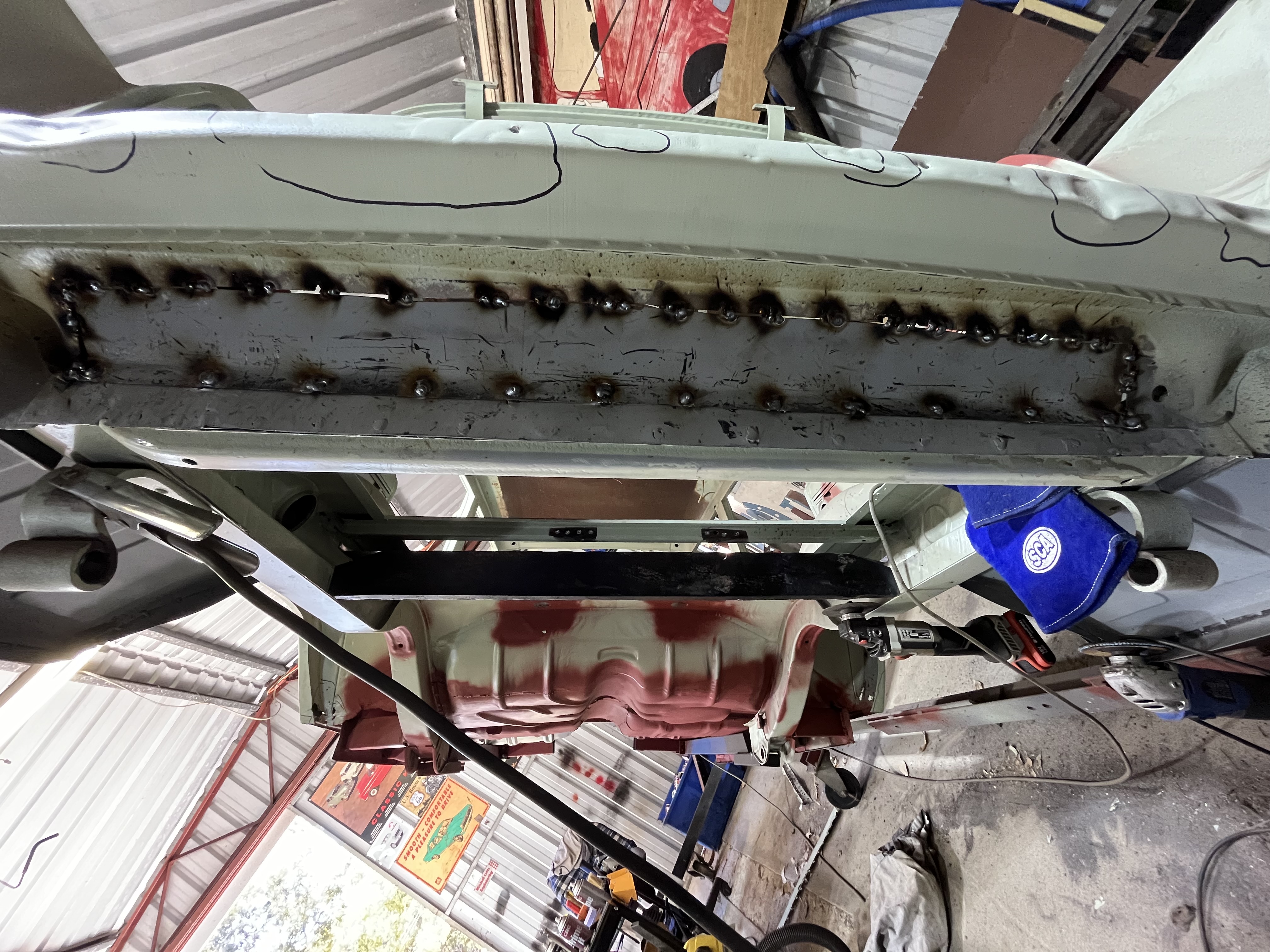

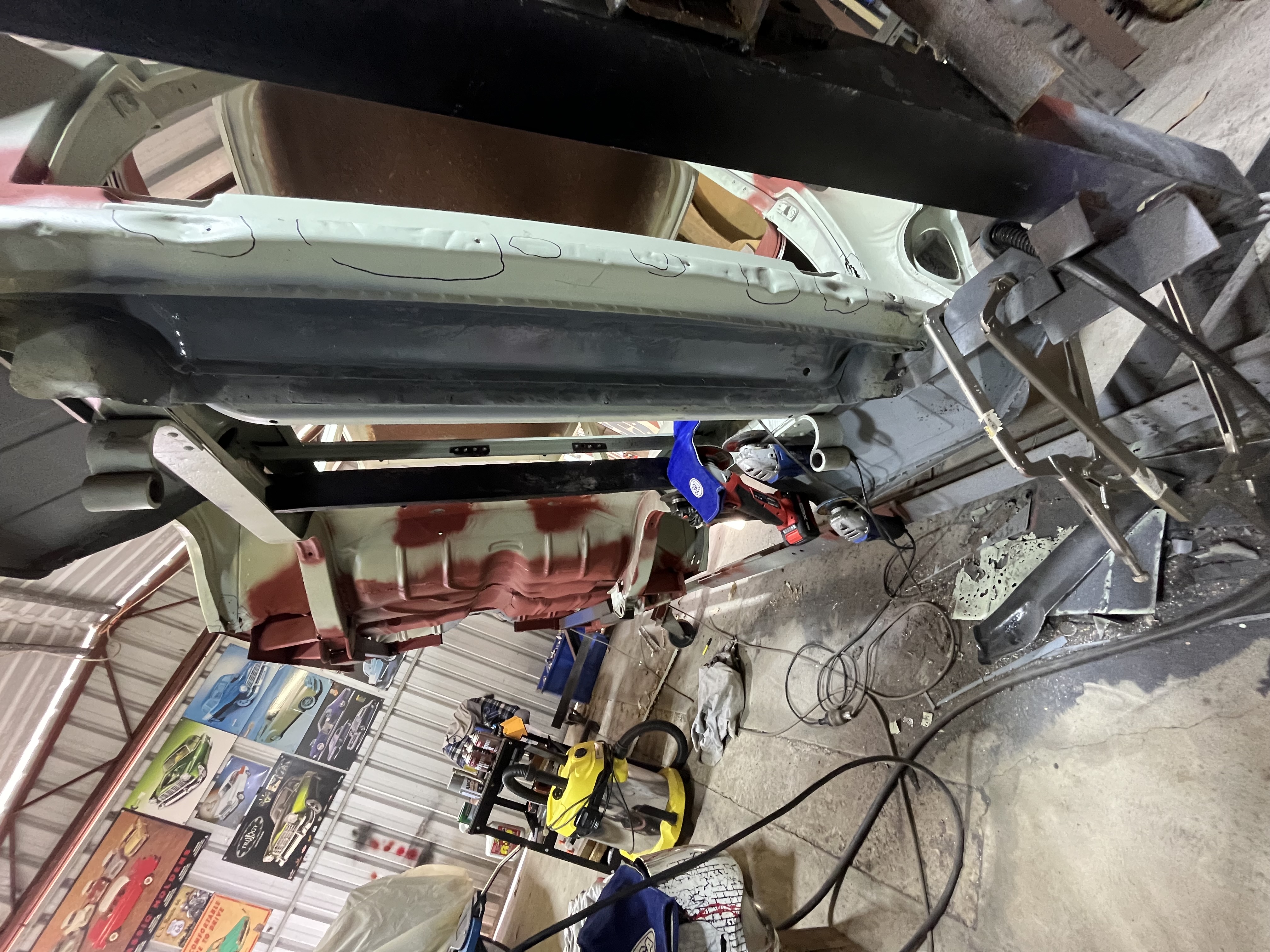

Bit more done on the weekend.
This rear area is like a Sarah Lee cake, layer upon layer :roll:, fitted the first piece that goes 90 deg. into the back
The first patch piece.
In place
Final piece, I tacked it in and then walked away trying to be patient and not put too much heat into it will finish it in the next few days.

Finished the back repair and another small one now on to the sills hopefully will get both done this weekend.

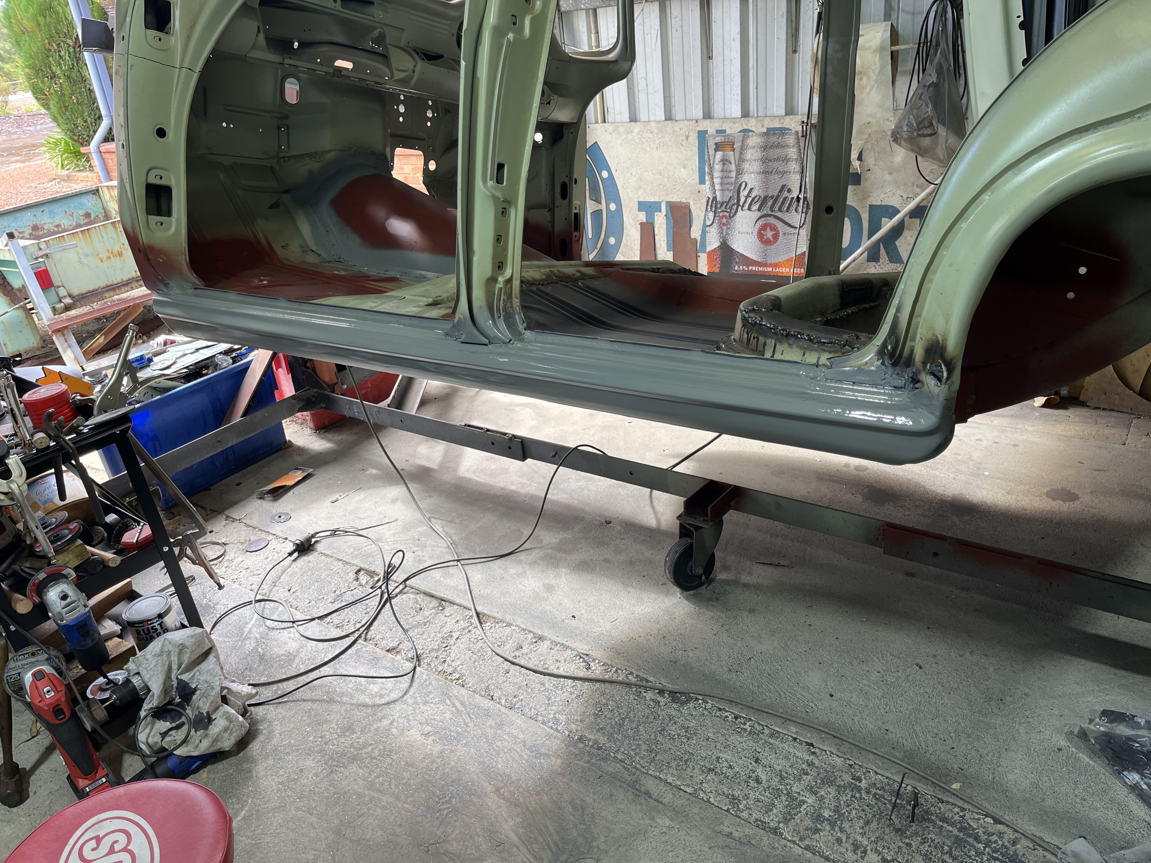

Passenger side sill finished off, not pretty but in,
Funny enough I have to say that the Rare Spares sills didn’t impress me this time, I used them on my Ute but this time the curve to the bend/ flat were the kick panel goes seems to be too tight, I had to open it up to get the bottom to go under the inner sill and the top to line up with the floor.
I know I’m complaining but I suppose at least we have something, it’s better than nothing I suppose. :crazy:
Started fitting the drivers side, same as passenger but I’ll make it fit. :roll:

Looks the goods Neil
Posts: 2710
Re: Neil's FB Station Wagon
Yeah, great work Neil.
The sills are strange, i had 2 NOS ones and they were slightly different to each other.
The theory was the people assembling the bodies would use the best fitting parts for each vehicle and the stockpile at the end is now what we have as NOS.
The bodies are all over the shop from the factory as well. No problem with the metal fab skills you have though.

I got the drivers side sill tacked in today and have realised the sills don’t have any of the original slight curve front to back, it took a bit of manipulation, read here BFH, to get it to fit.
