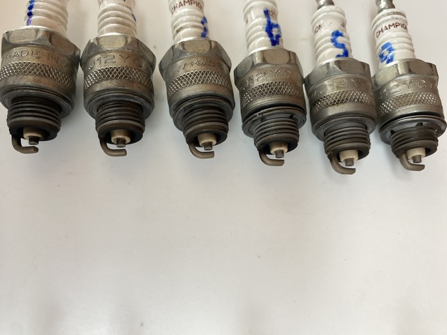

-spark plugs were totally fouled on 1-3 cylinders, 4 was an average foul and cylinders 5-6 totally lean

Pic below of the spark plug readings at this point......

These plugs were looking this way with both idle air mix needle 1.5 turns out evenly.
At this point I leaned the front carb progressively, fitted cleaned plugs and ran the car on the same route.
This cycle is did at least 8 times - God freaking damn it I make more work for myself than required.
Eventually I got all plugs running evenly, clean and lean.....
Front carb idle air mix needle fully closed... rear still at 1.5 turns out. Houston we had a problem!

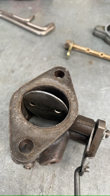

With the carbs throttle bases plates removed and side by side for comparison this what stood out like dogs balls..
Can you see it?
Rear carb base on right - butterfly closing nicely past the idle ports
Front carb on left - butterfly not closing fully and idle ports partially covered.
Diagnosis - Front carb butterfly not closing fully, creating extra vacuum which activated idle secondary ports.
Constantly pissing fuel into the intake aka over fuelling at idle - hence running super rich on the front cylinders.
Can you see it?

Both butterfly were then removed for a 'check & measure' which shown there front butterfly was larger in dimension about about '.005.
Checking the fit of the front butterfly back into the base shown it was an interference fit and was sticking in the throat of the base.

The directive was then to reduce the size of the outside dimensions of the butterfly so it seats in the same manner as the good carb.
I wanted the front throttle to close in the same manner as the rear
Process was delicate but simple... some fine filing, sanding and rubbing with scotchbrite pads.
I checked the butterfly fit for high spots with a torch shining underneath to show any high / low spots on the and I adjusted the plate accordingly.
After taking the phot below I realised I had removed too much material so I raided 'EKmart" as Blacky would say, found another plate and started again.
Taking more care than the first time I got it perfect, way better than the photo below.
- IMG_9202.jpeg (79.85 KiB) Viewed 12960 times

After a lot of fecking around I got the throttle plate to close which matched the good throttle plate position of the rear carb.

Got home removed the plugs and this what I found!!!
Tuning was then a breeze, the carbs synced perfectly as expected when following the procedure.
The 219 was then terrorising the neighbour hood, driver waving at grandmas, kissing babies and patting single mums on the bum.
- IMG_9215.jpeg (69.99 KiB) Viewed 12941 times

Totally happy with the result I then knew I could fine tune it and get the plugs 100 percent perfect...
Happy days...lots of WOT action coming to a neighbourhood near me!!!!
