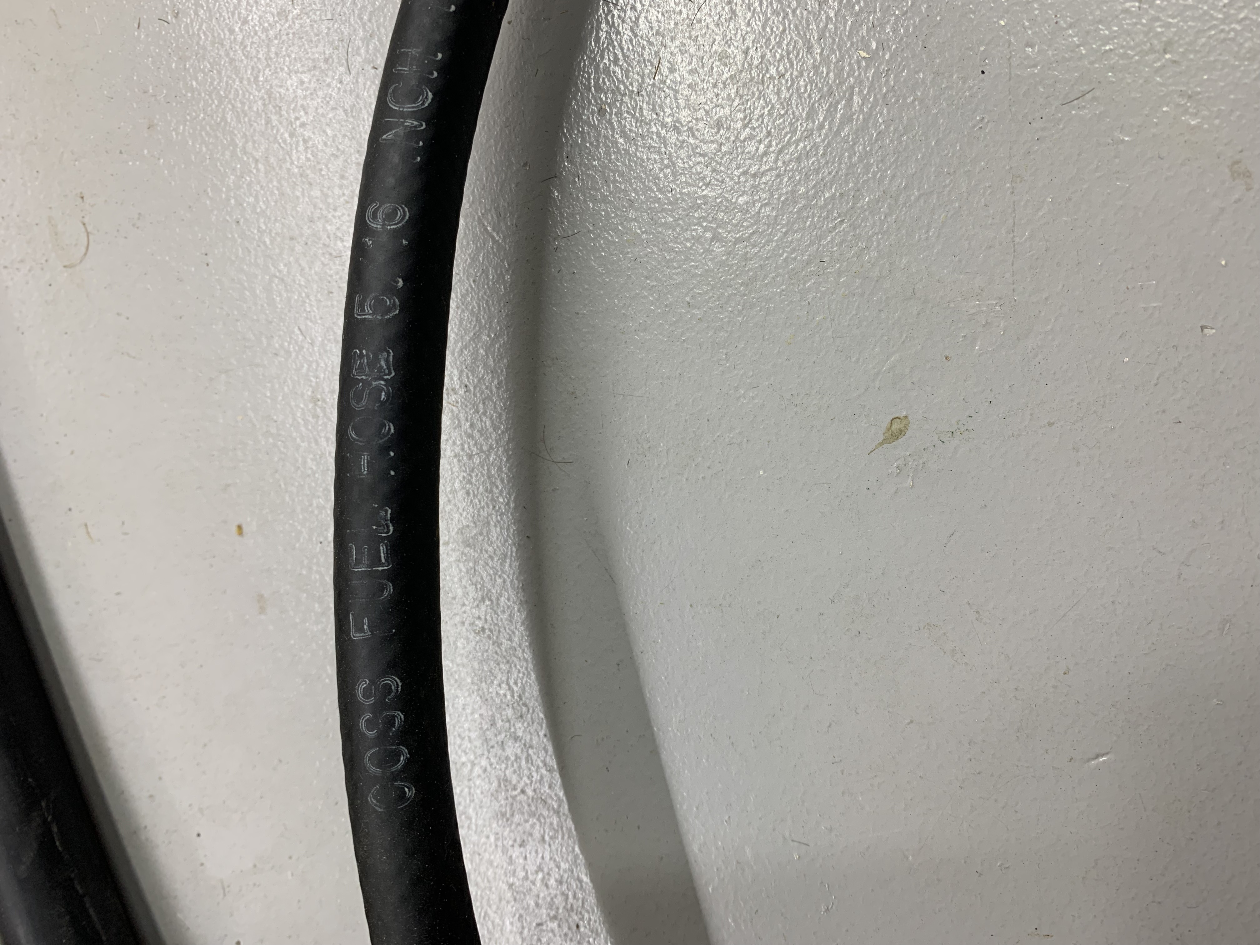

Couple pics of the tubing I used. I cut a piece of both sizes approx 12mm long (you can always trim down) and inserted small one inside bigger.
Larger size is approx 19mm outside dia, 3mm wall thickness and 12mm inside dia (old tube off a dishwasher).
Smaller tube (5/15” fuel tube) approx 14mm outside dia and 7mm inside dia.
My underside pics were a bit ordinary in the dark. Hope this helps.
- Dishwasher pipe 19mm outside dia
- IMG_3652.jpeg (784.42 KiB) Viewed 10674 times
- 5/16” fuel tube
- IMG_3653.jpeg (2.07 MiB) Viewed 10674 times
- IMG_3655.jpeg (627.97 KiB) Viewed 10674 times
