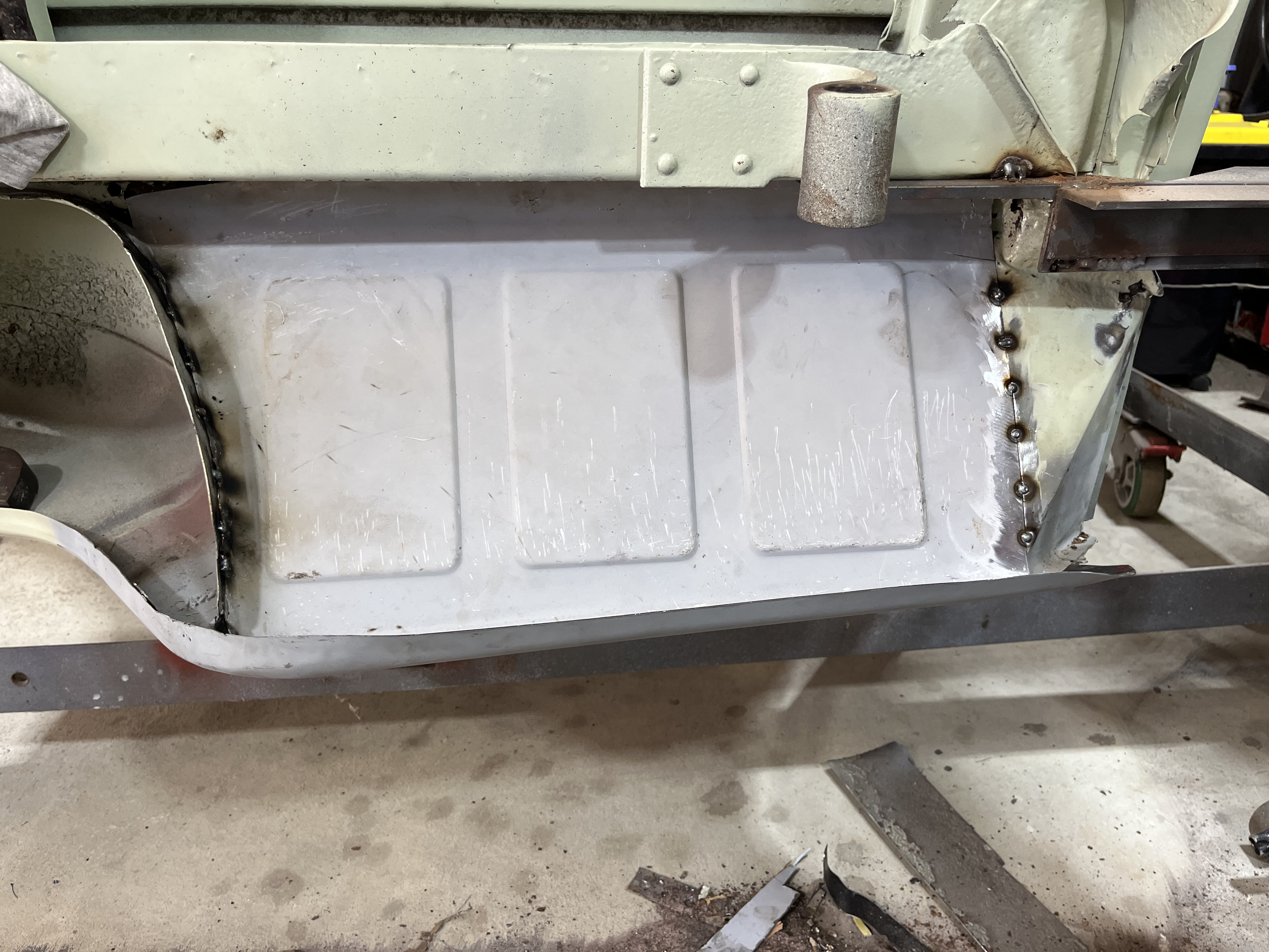

Drivers side in, weld in inner tomorrow.
Excuse the boga welds they’ll clean up :lol: :lol: :lol:

Of course you were right Scott I got warpage :roll: will have to get a shrinking disc and give it a go watched a You Tube video about them and looks like the go, hammer and dolly did no good.
Fitted the inner yesterday, tacked for now, it got pretty humid in my shop and I'd spent most of the morning on the outer :roll: :roll: :roll:
One more side to fight with :lol: :lol:
