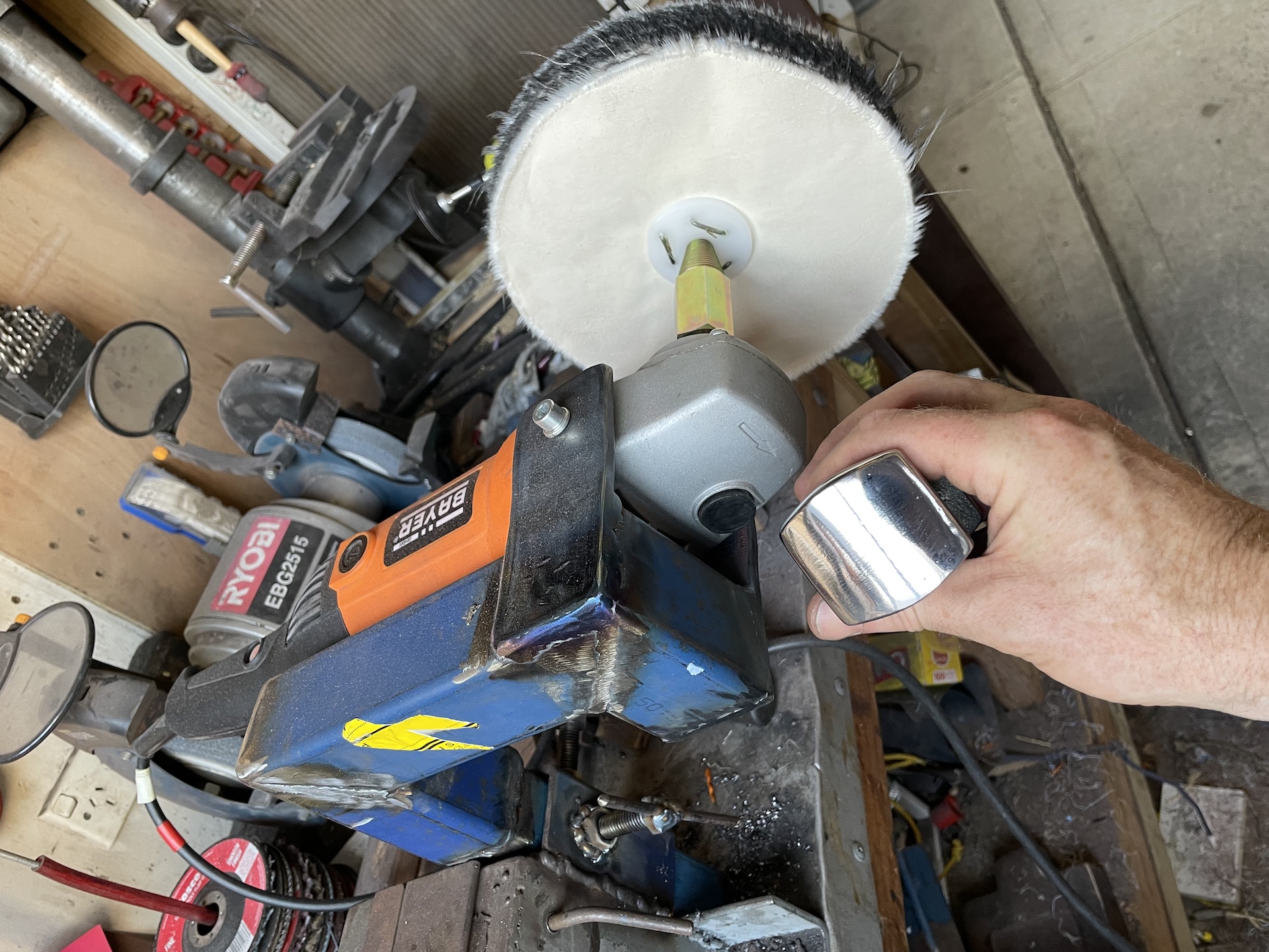

First thing - make a bracket to bolt the polisher to my bench which was made out of scrap from the rotisserie build. Quick test polishing up one my cheap dollies with grey and blue compounds. First lesson (still being learnt), must sand out all the scratches, not just the deep ones, as what was not visible after a quick run over with 320 in the DA, becomes very visible when polished.

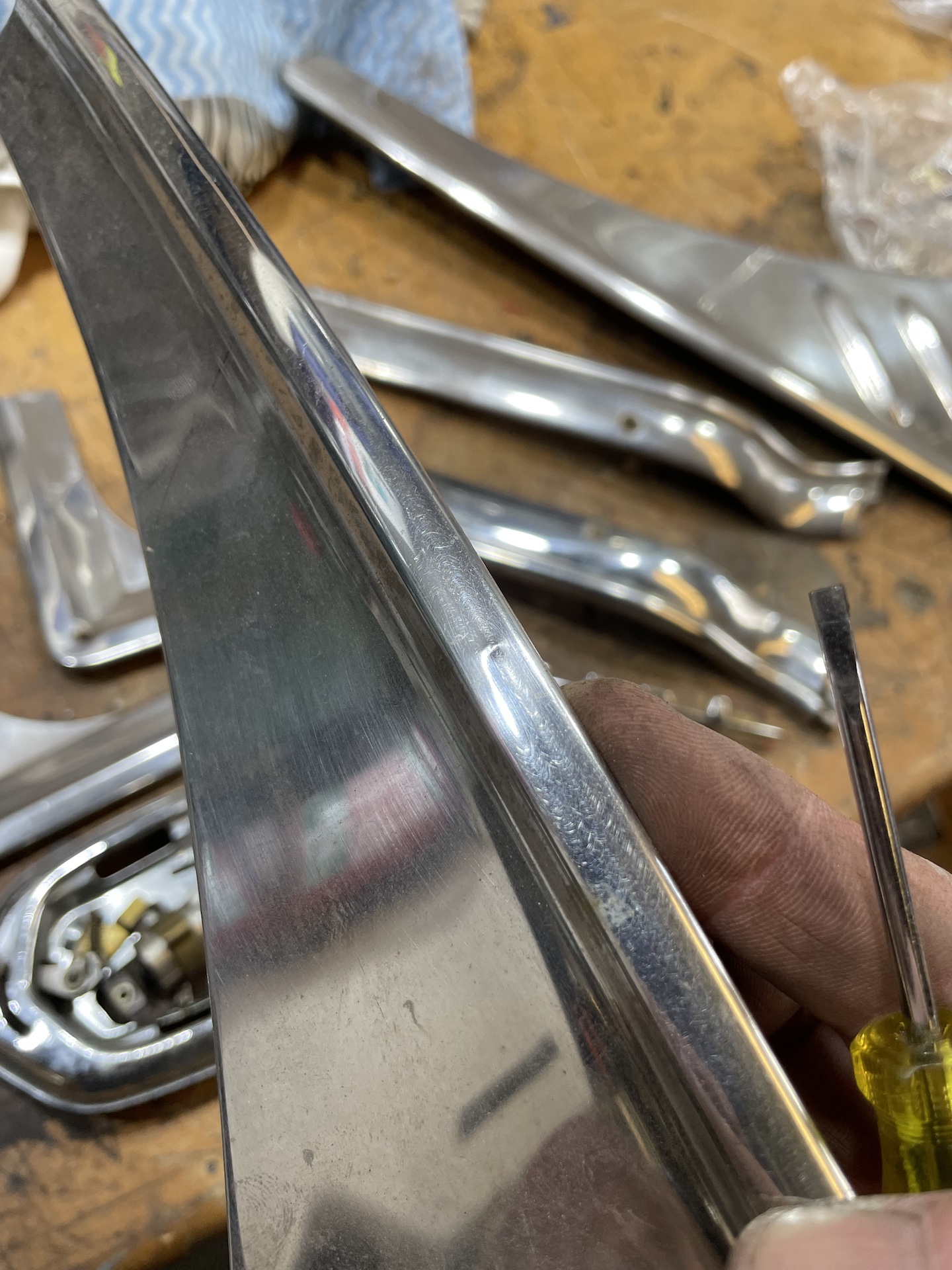

Jumped straight in and grabbed a bit of bling off the car. This piece has a dimple in it which I want to try and get out. Got a thin piece of hardwood in the vice and gave it a few taps with a soft mallet which ended up a wavy mess worse than the dimple ever was. Pretty annoyed I had ruined this piece so no progess pic of this state.

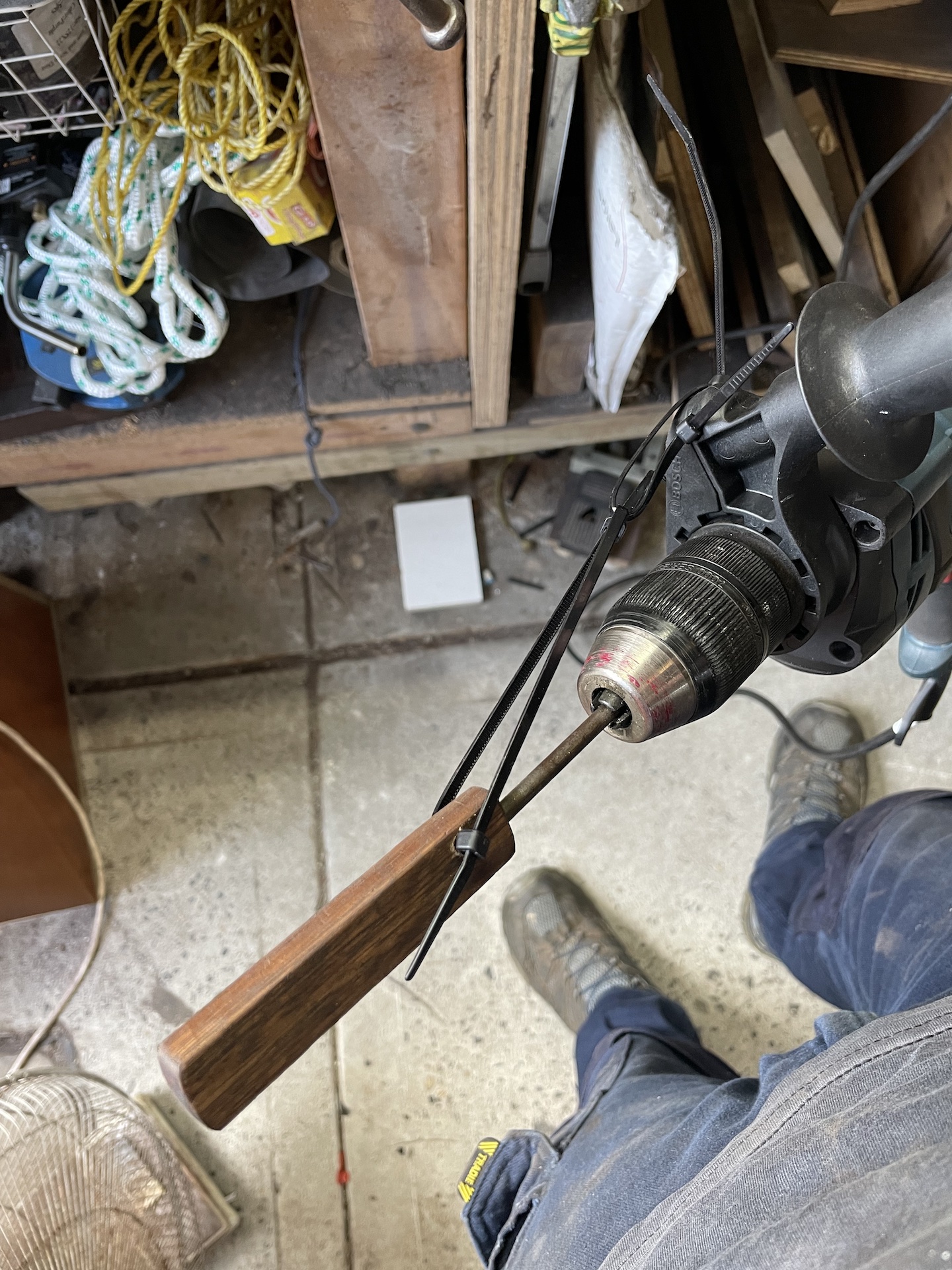

Decided what I need is a planishing hammer, which I don't have, so I came up with a low rent solution. Bit of machine oil down the shaft, set to hammer and off I go. Really have no idea what I'm doing and really hard to operate drill, hold piece, and make sure I'm sandwiching it between the two bits of wood, so potential to totally cock this up are high. But pressure was light and after much tapping, a quick sand and polish it looks like this. Probably should have stopped here but I thought the shrinking disk might help even things out even more. It did, but not as intended. Too much heat, not enough lubricant, galling. Nothing to lose now, went aggressive, sanding the area with 120, 180, 180DA, 240DA, 320DA, 320/400/600/800/120 wet and dry, each grit spreading the sanded area bigger and bigger as I feathered the edges and sanded the previous grit out. Finally onto the polishing. Started with grey (fast cut) compound on the treated sisal wheel. This really does most of the work and is the equivalent of blocking a car when prepping for paint.
Then onto white (SS) compound, with a white stitch, then a loose leaf, and finally the swansdown. These three final steps take very little time.
Here is the result. It's good enough for me, but for a great finish you can see that I needed to spend more time on the cut stage. As I have subsequently found on the few other pieces I have done, sometimes that means even going back to the DA to remove scratches that you thought were gone.

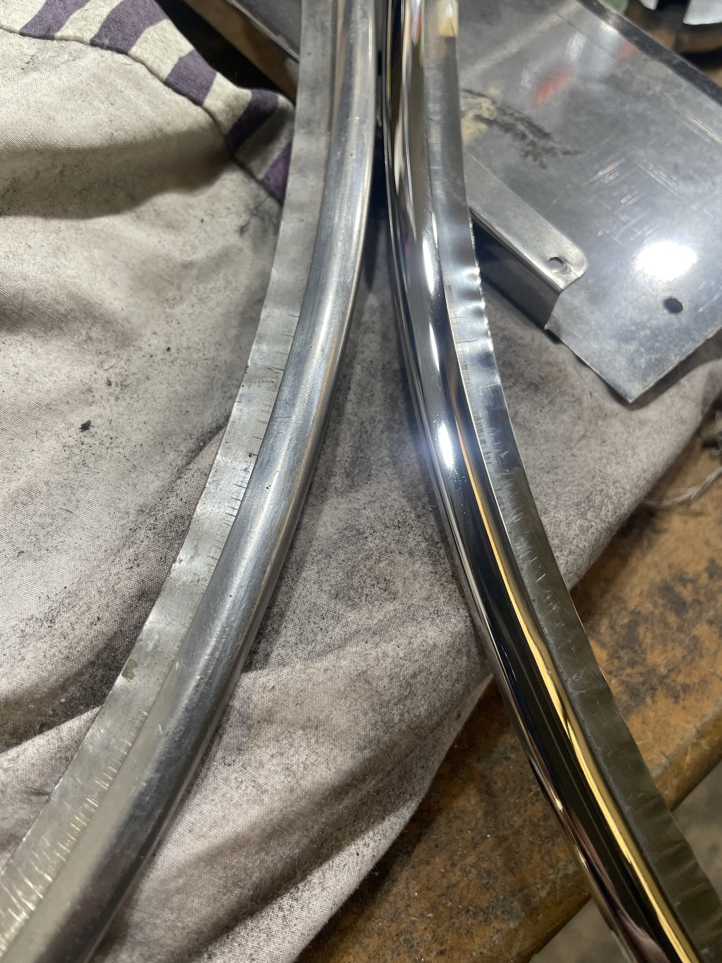

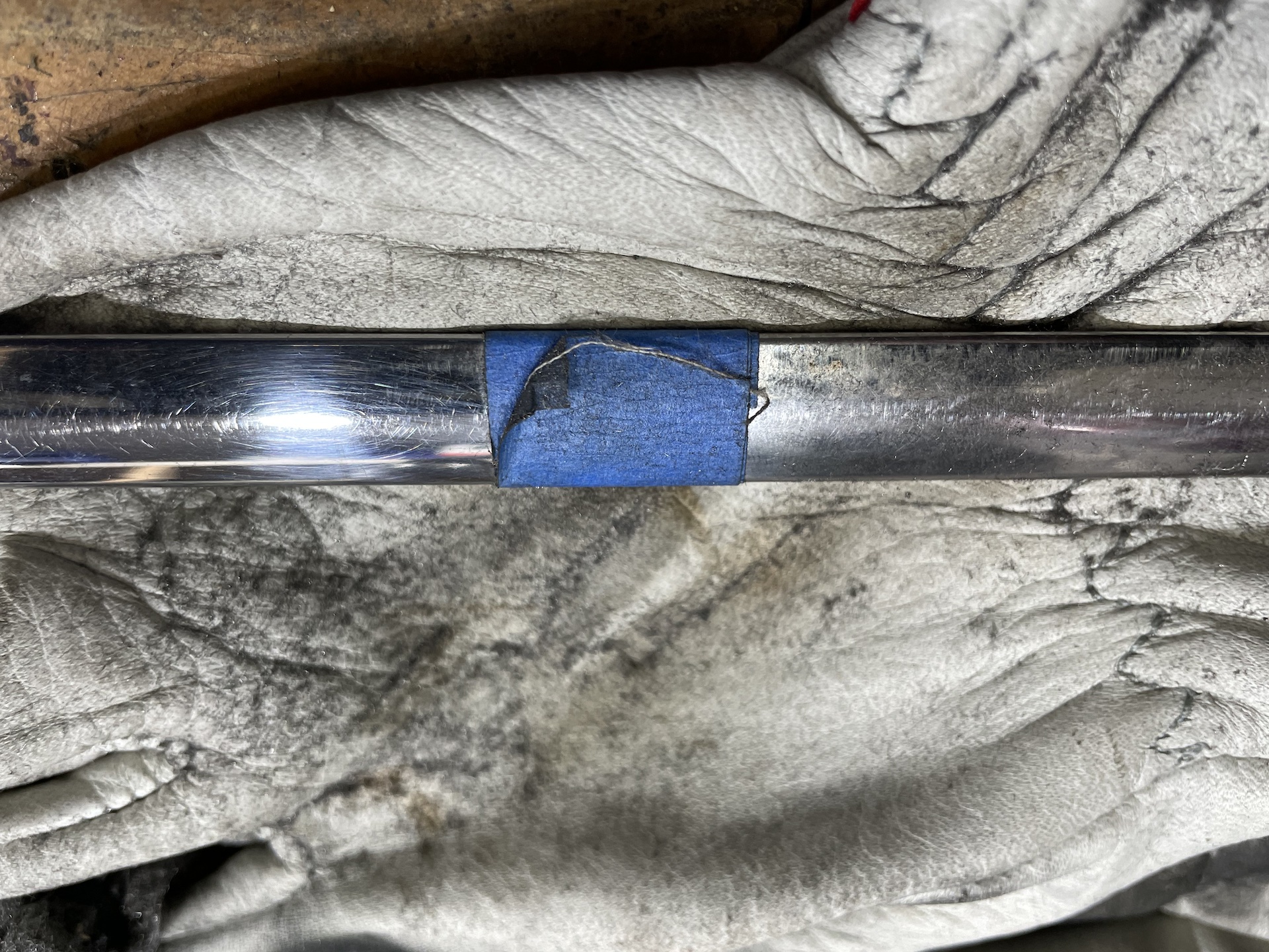

Here is another example. Int rear trim. Has a deep scar on it, which you can see in the broken line of the light reflection.
Tap, hammer drill, shrinking disk (more lubricant this time), sand to180 DA, cut with grey compound (too lazy to go to 1200 wet and dry), re sand (to 320 DA), cut, cut other light scratches (should have sanded first but got there in the end), polish.
Can still see some sanding marks but I'm ok with it. This piece probably took 1.5 hours.

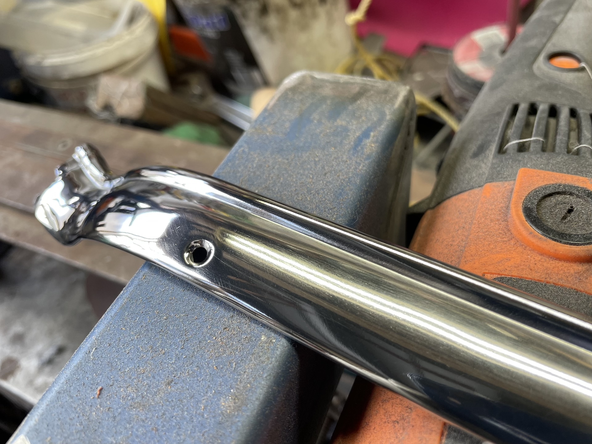

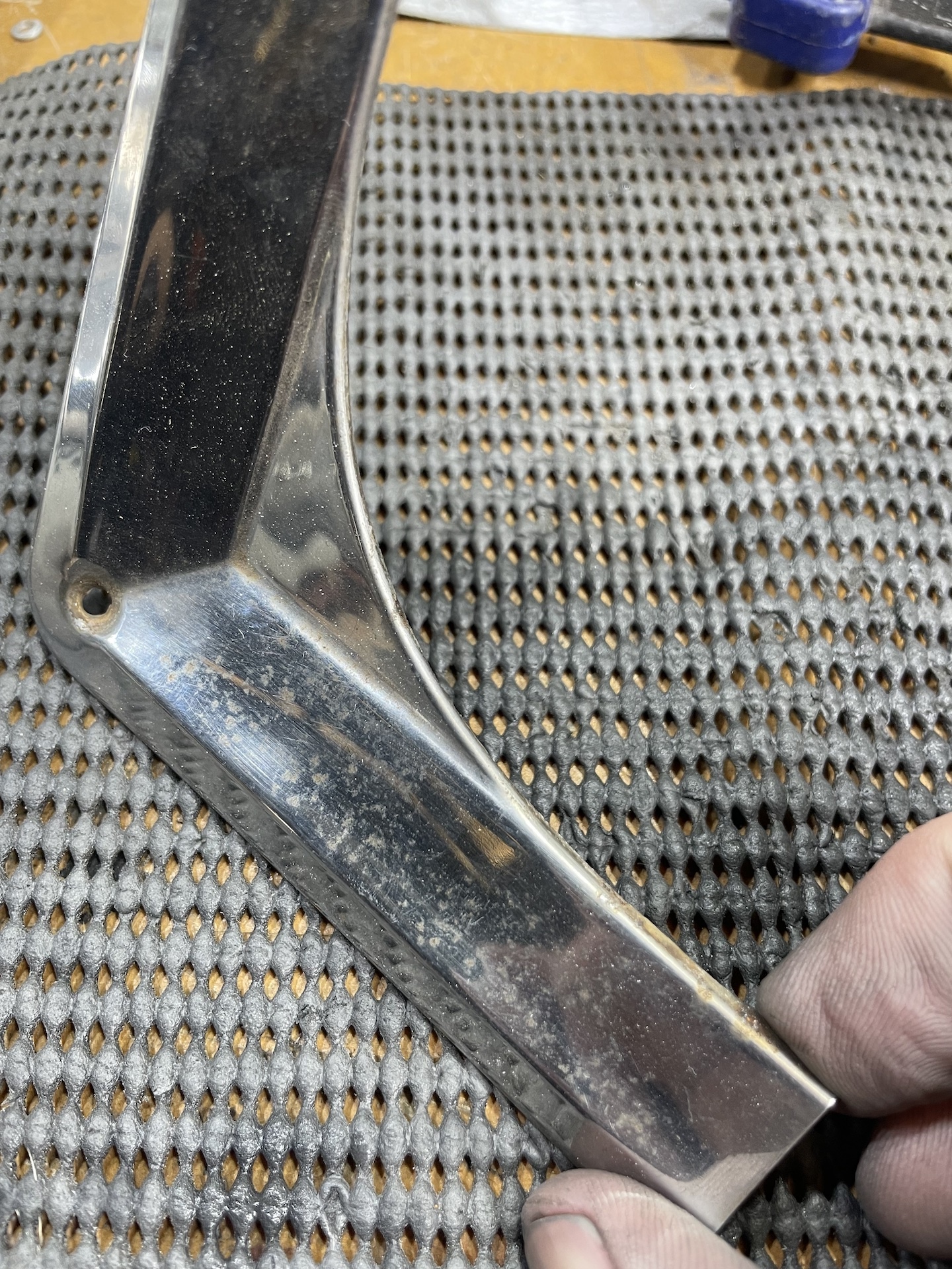

A slightly different approach, which I tried before going down the sanding route. This piece had a few rust marks all over it. Tried aluminium foil and 0000 steel wool, but in the end sandblasted it. Kinda liked the matte steel finish but it felt too much like aluminium. Cut and polished, now it looked shiny but with a 2k paint orange peel look, so but through all the sanding steps, cut and polish and have these. Again, still a few marks, but good enough. One on the left was sandblasted. One on the right had a few dents removed which were self inflicted - the wheel ripped the piece out of my hand, sending it ping ponging around the workshop when I was on the final phase of polishing. Take away is as long as you get fairly close with what ever hammer dolly technique you choose then its just a matter of sanding smooth and polishing. I'm sure by the time I have finished my last piece that the method will have changed, but this is working for me.

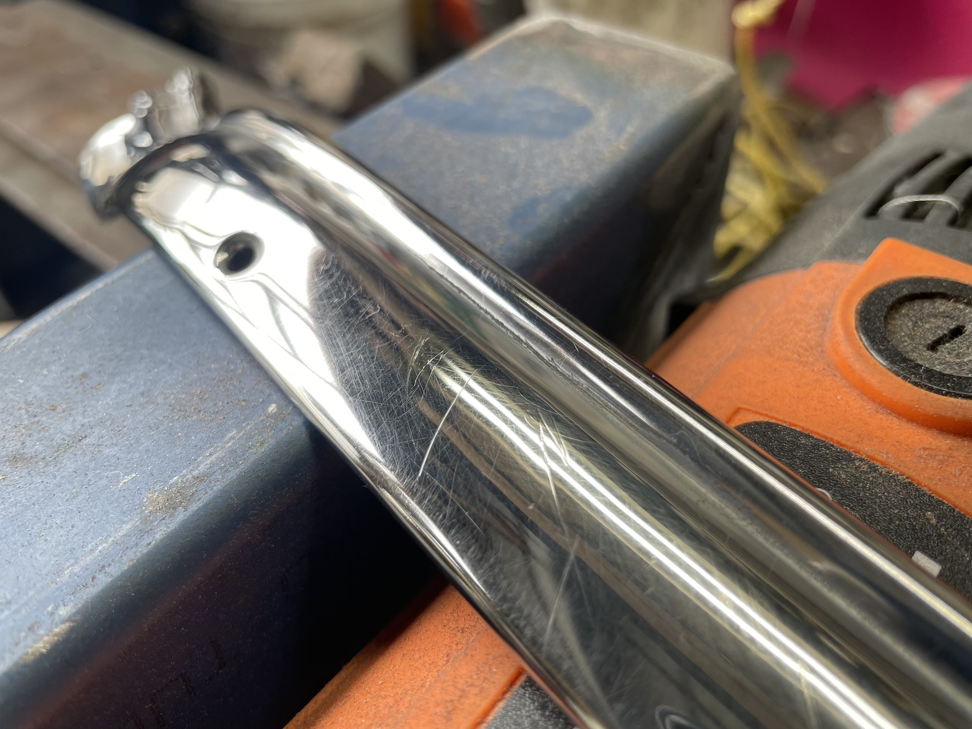

Interesting - I primarily got the 0000 to remove rust spots on chrome (because I read it somewhere - not from some deeper understanding). Next piece I tackle I'll give it a go at the end to see what it does.
The photos show up every flaw. At the time I finished I thought they were good - well better than what they look in the pictures.
But you have to stop at somewhere - no point getting a mirror finish only to scuff it all with a dirty sponge the second time you wash it.

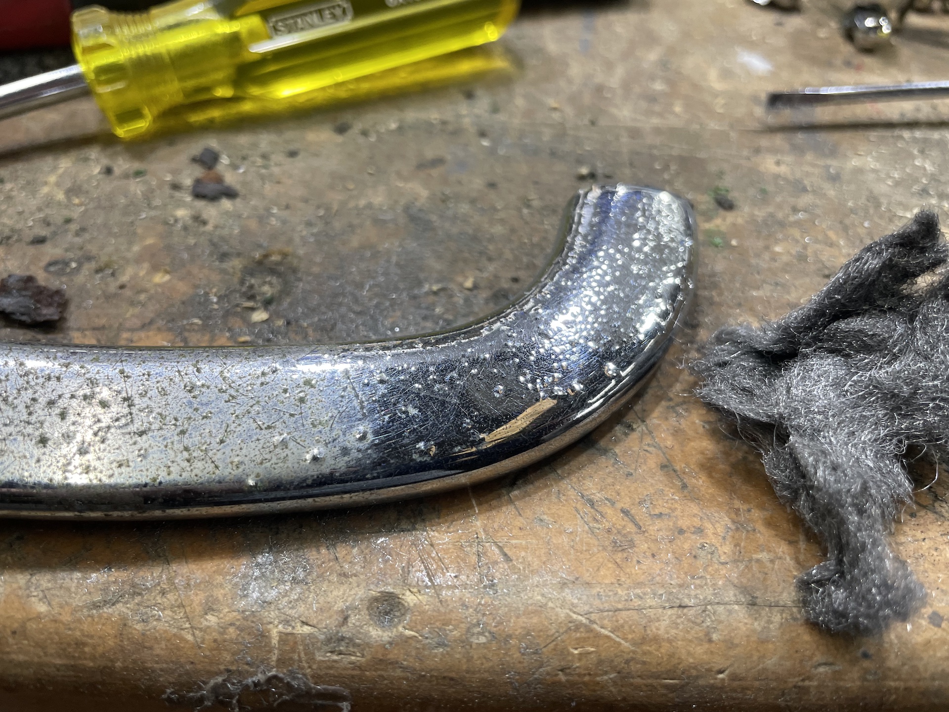

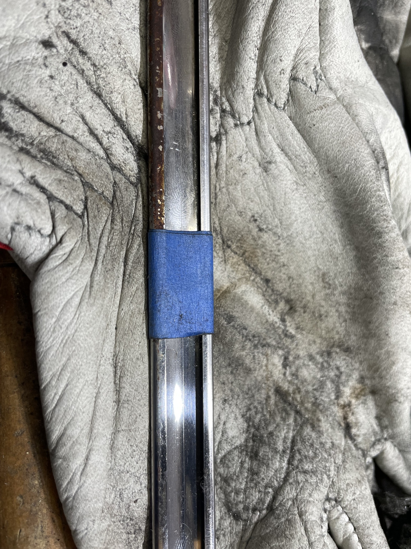

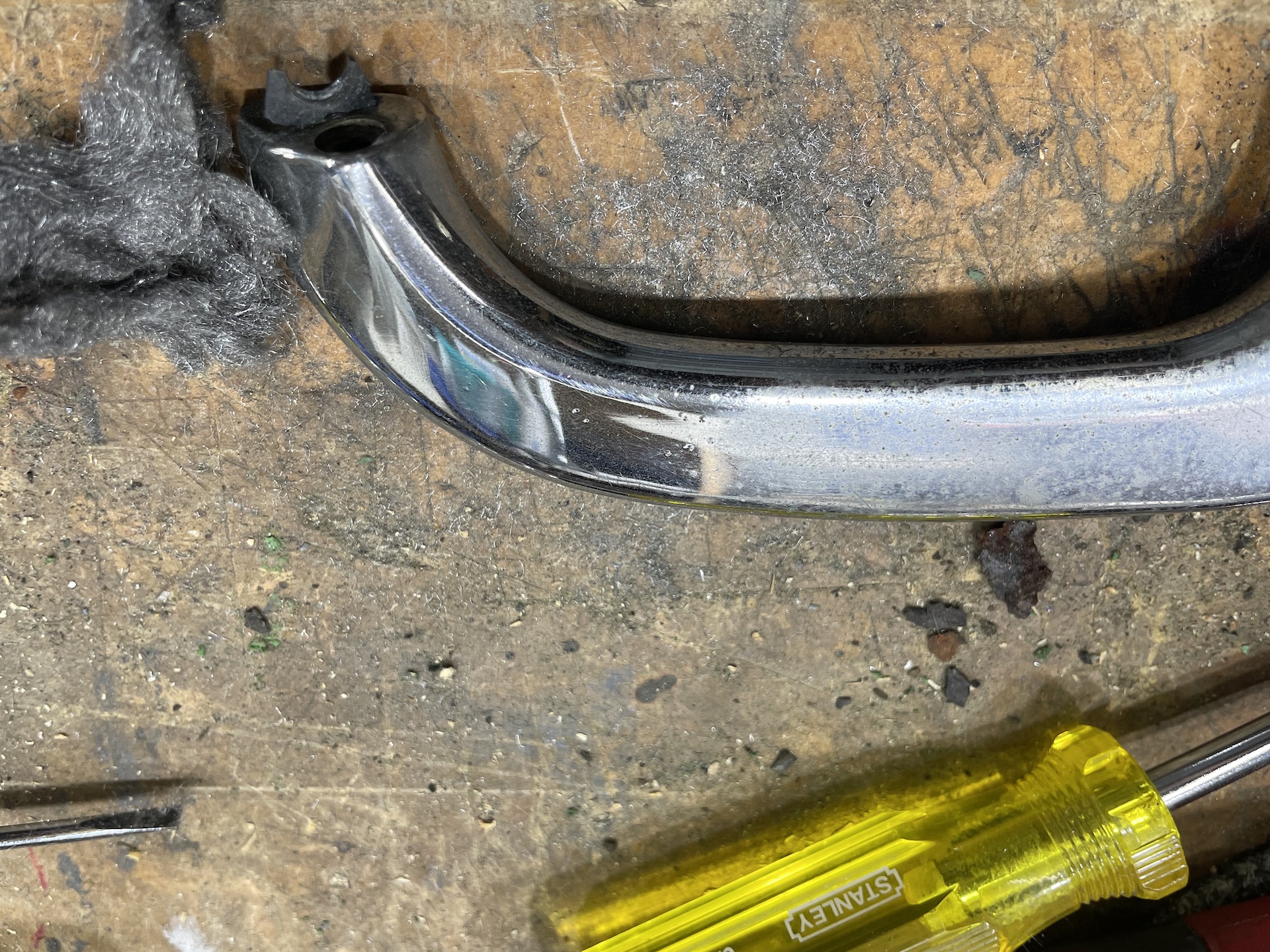

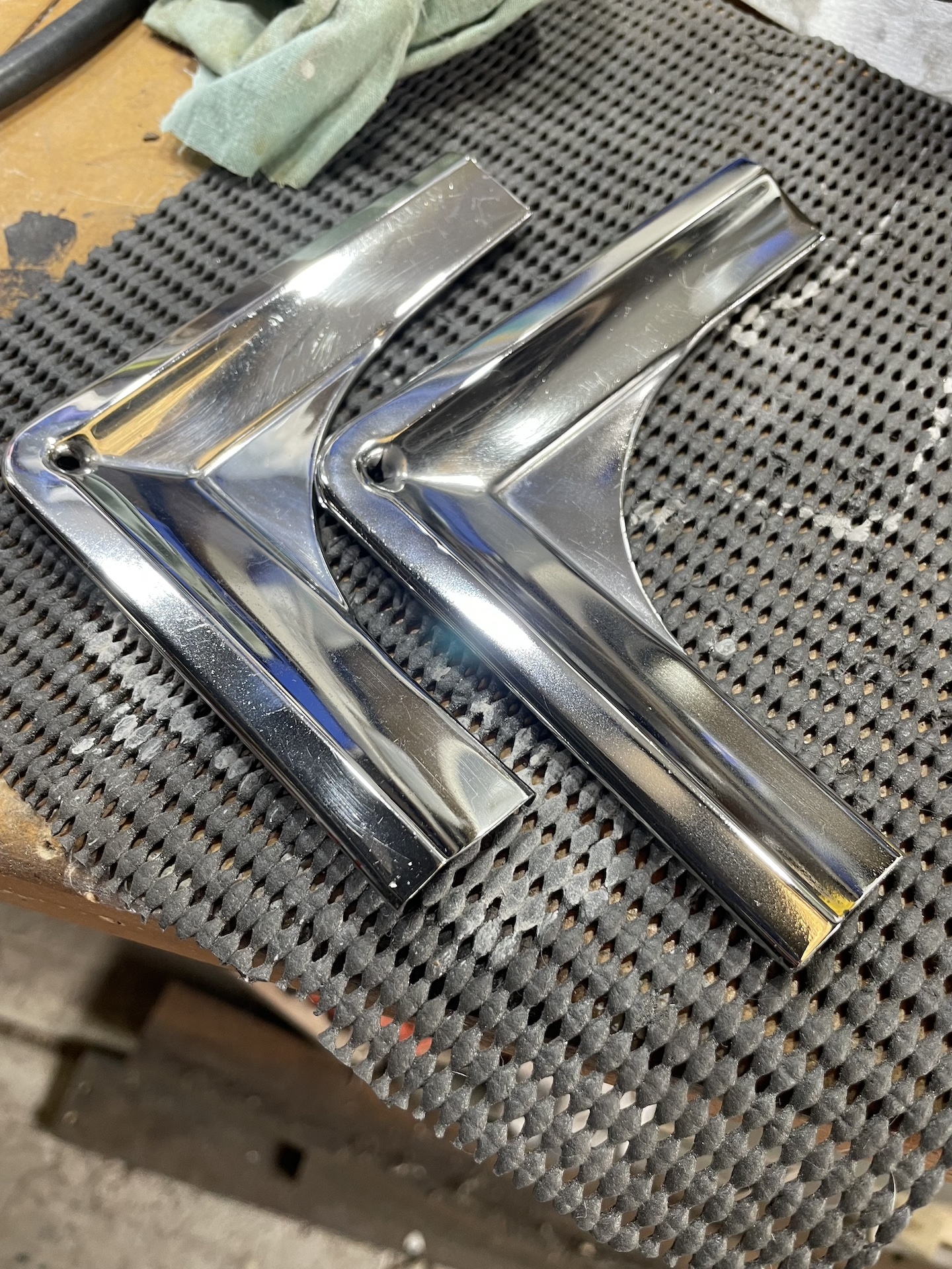

Did a quick test today with a rear chrome door handle and the stainless strip off the rear door glass channel. Only 0000 steel wool and a bit of elbow grease. No more than a minute on each test.Errol62 wrote: Mon Feb 12, 2024 8:03 am Great stuff Scotty. I spoke to a metal polisher guy at all Holden day a couple of years ago and he uses 0000 steel wool to finish off stainless. What are your thoughts mate?
Door handle is pretty janky, with pot metal pox bubbling behind the chrome on the top of the handle. Stainless has a line of rust along one edge which has transferred from the rusty door glass channel. The steel wool would not remove some of the bigger chunks - I scraped them off with a knife. Pretty impressed with the level of shine. Doesn't really do much in the way of removing existing scratches, but for parts where access would be difficult with a polishing wheel, or if you just want to tart up parts bolted to a finished car, then I think 0000 wool is the way to go.

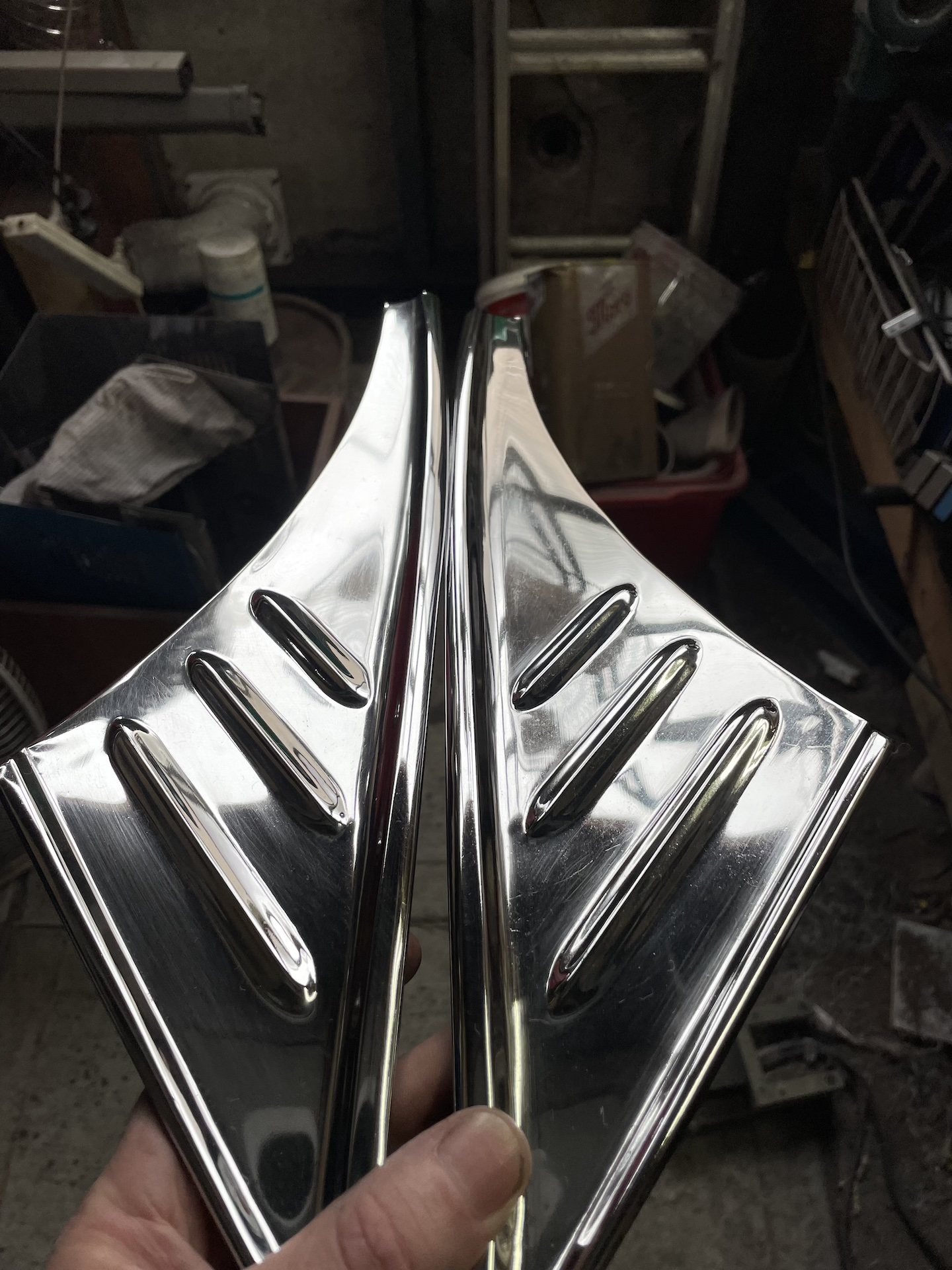

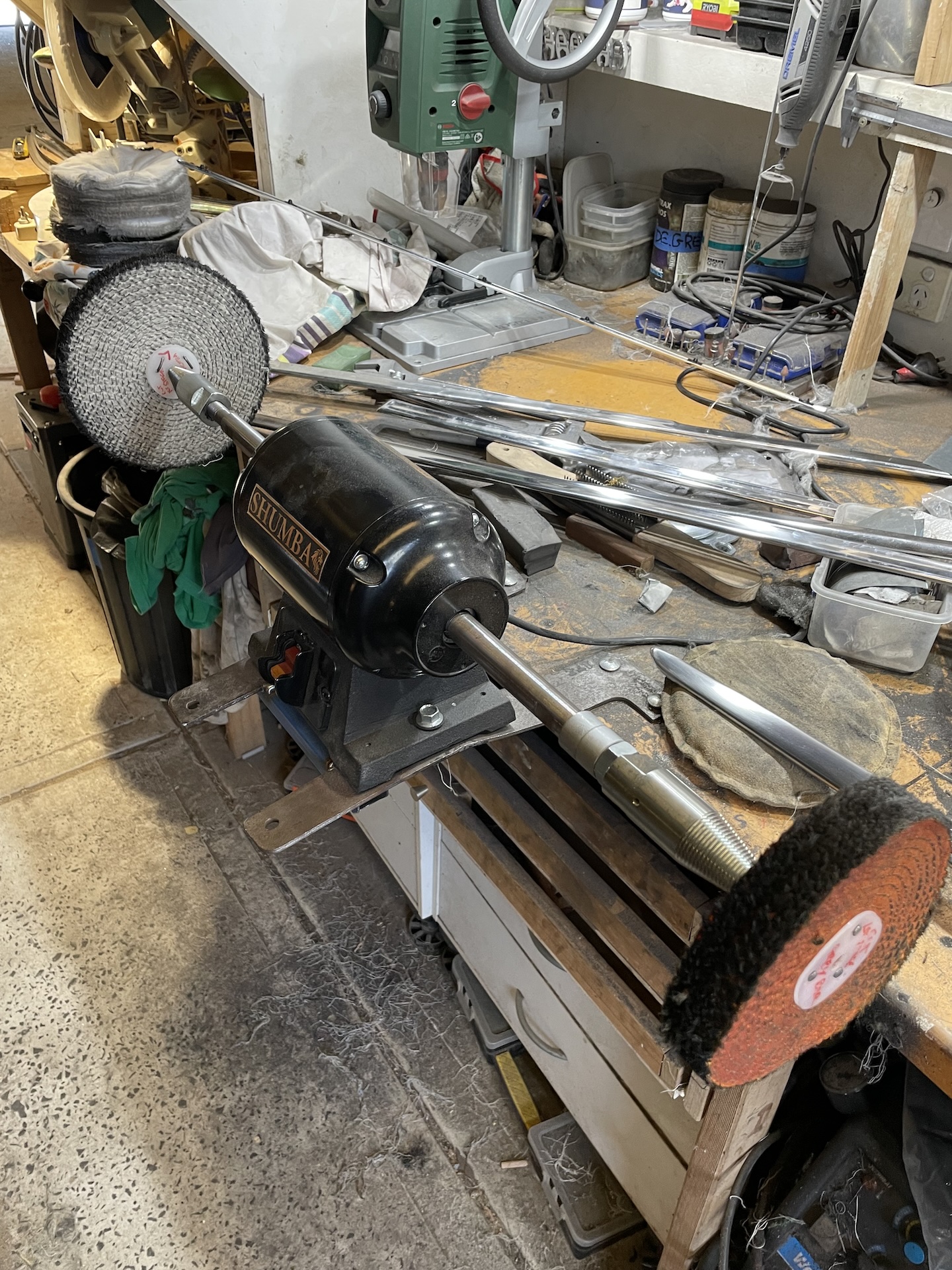

Back on the polishing.
Decided to up my game with a bench polisher. Much quieter than the variable speed polisher.

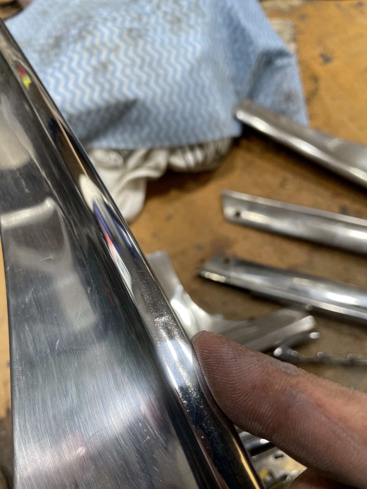

Still a fair bit of trial and error but what has been working the best so far
Dolly out dents with hardwood
File/ sand with 120 on the DA
Hand sand deep scratches with 180
Hand sand light scratches and any 180 scratches with 240
Hand sand the entire piece with 280 wet and dry. Much easier to see any scratches when it’s wet. Back track to 240 if you can still see scratches.
Cut with grey compound at a 45 degree angle. This is probably a step back from the 280 W&D, but creating angled surface helps you visually see what you have missed when polishing.
Polish out the 45 cut with terracotta on 2 mops.
Polish with white stainless compound on 3 mops.
The passes on each mop are pretty quick. It is really only the first cut and first terracotta that need a bit of extra attention.

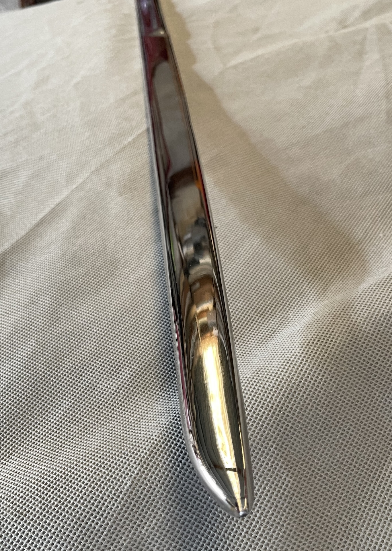

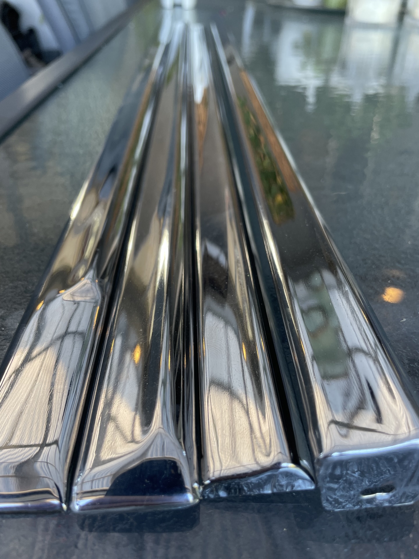

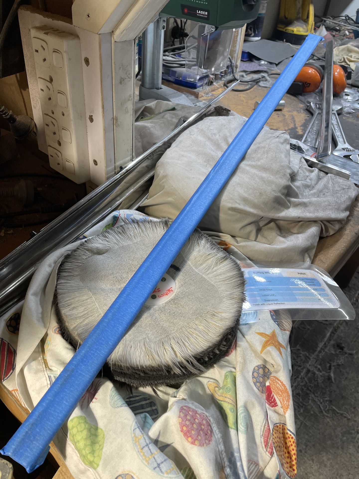

Here is the passenger side trim that I did before I improved my method. Was happy at the time, but now all I see is the deep sanding marks I have polished rather than removed on the left hand piece. Only being super picky because I have already invested a lot of time in repairing these.
Front drivers side trim. Before. After When done, to stop them getting scratched in storage, I’m using blue painters tape. And today I received my door trims from Glenn (Stinky), so decided to give them a polish as well. Halfway there, a good before and after. Total time for the two was roughly 2 and a half hours. Not a job for the impatient. But very rewarding.
