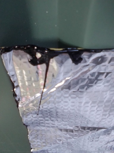

I used this lightweight one in the EK .. no problems ... (see 'gimme 5 years' thread)
https://www.ebay.com.au/itm/Car-Builder ... 2749.l2649
and this one in the campervan to stop the long panels vibrating
https://www.jaycar.com.au/combination-b ... gJhTPD_BwE
P.S. don't go with the cheapest ... I've had trouble with one 'dripping' on another car (and even just sitting in the shed) ... okay on the floor but you don't want that up top or down the sides

I lined my roof with UnderDog deadner off eBay.
Worked really well and I’d definitely use it again
I’d say it about 3-4 mm thick when rolled on.
I did Howe remove all of the factory roof lining which was a PITA as mine was on the rotisserie and I was pressure cleaning the body and it started to bubble.
I’d say if your roof insulation is stuck fast you can leave it and it’s absolutely fine, but if you put another layer on top it will e too thick like blacky mentioned.
My hood bows were tight AF to get in with the single layer of UnderDog.
