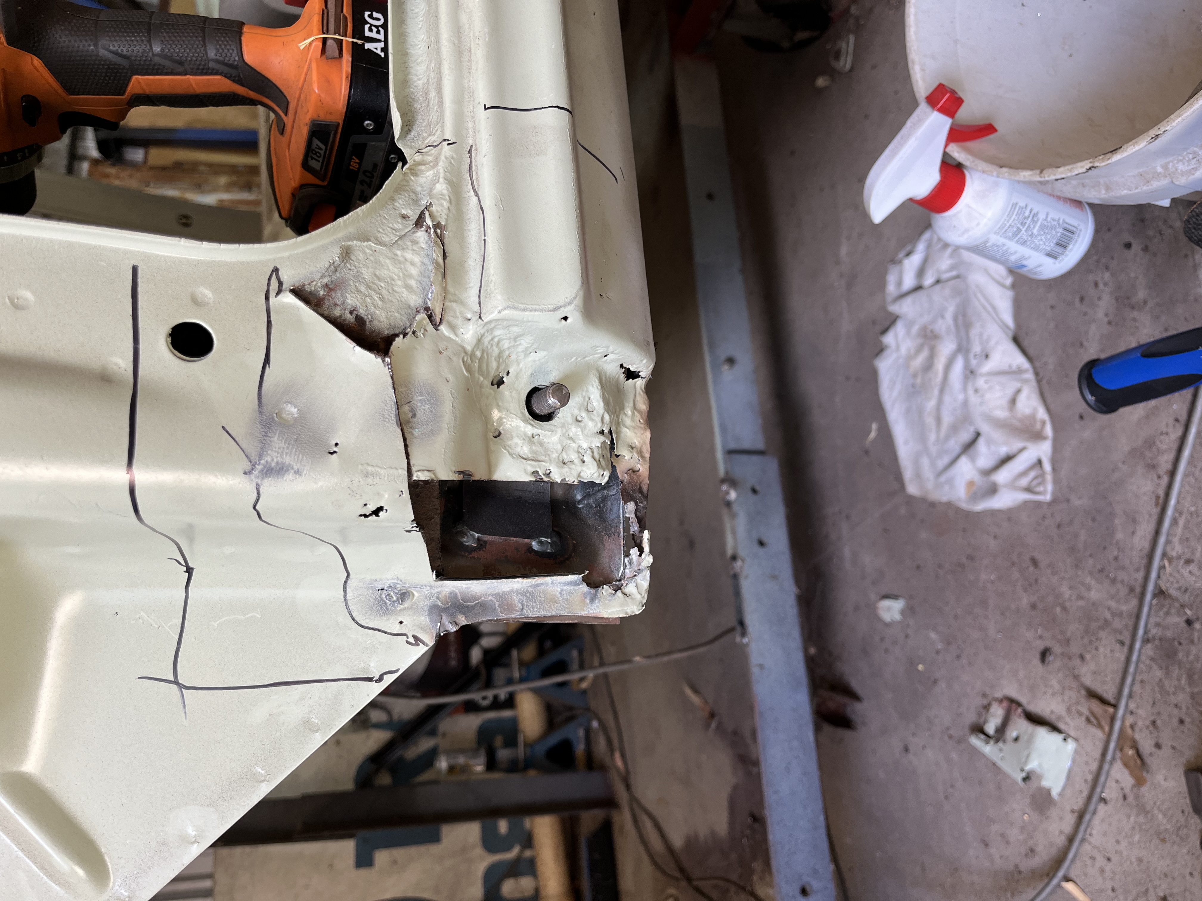

Blue and white stripped (butchers) apron on again yesterday.
I had sprayed some rust converter on the inner section that I was going to reuse.
Unfortunately the very bottom of the inner piece has rusted where it is supposed to wrap slightly onto the inner sill. Cut the new section down and made both the old and the new fit as best I could, drilled holes for tack welding the outer to the old inner, the two are originally spot welded together. Welded it in (as best as I can ) and gave it a clean up trying to hide my bad welds
Re: Neil's FB Station Wagon
Put some primer over my mess, the extra material at the bottom has to bend 90 deg back under the inner sill.

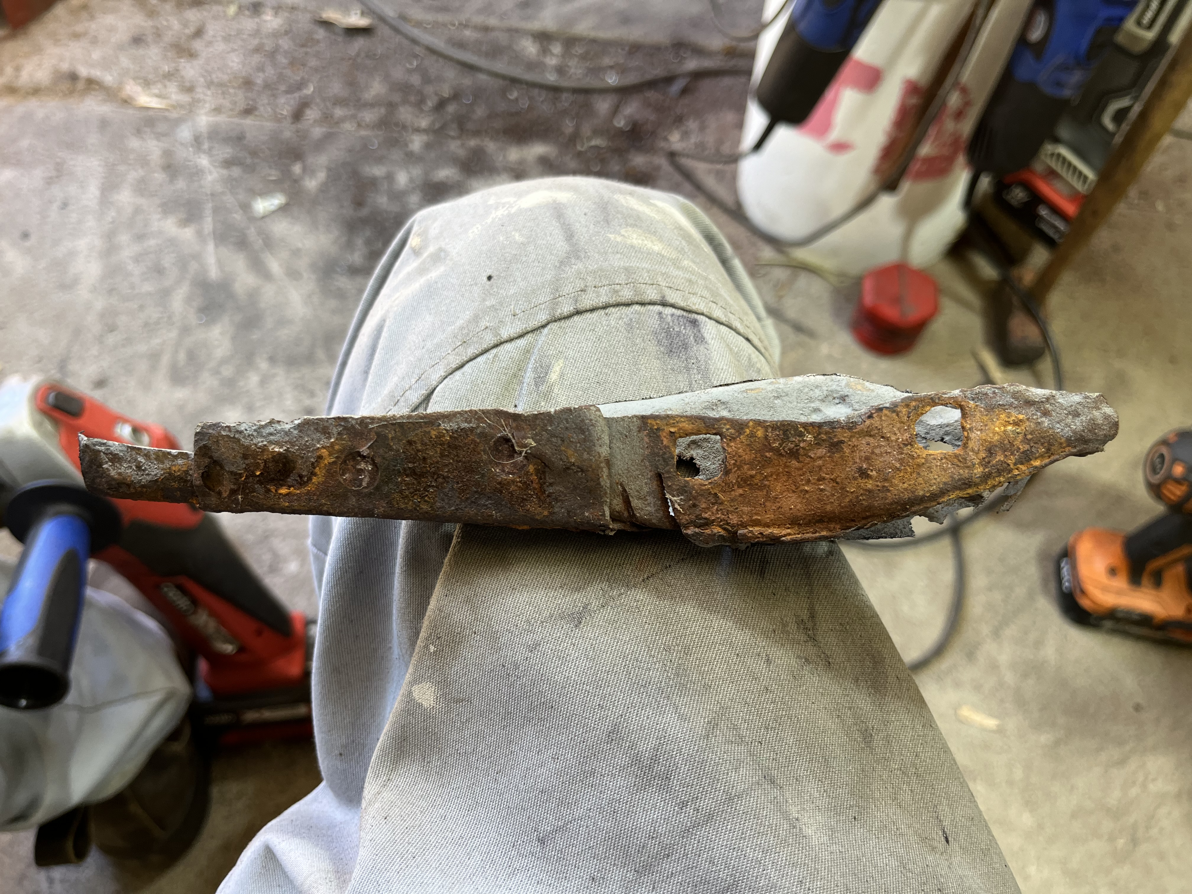

Donor piece, needs to be trimmed still, you can see where the outer wraps onto the inner sill. I still have to do the inner piece near the floor pan (the new small piece in the previous photo from a couple of days ago) I think I'm going to stay on the passenger side for a while, have to put in the floor pan once I finish with the A pillar and them may as well cut away the outer sill (I have a new one) fix the rear section of the inner sill and then fit the new outer sill that way the passenger side should be finished
I had to cut the piece of the inner sill away where the bottom of the guard bolts to, I tried to keep what was there but there wasn't really enough good metal to weld too, I have a donor piece I will weld in and then fold the new outer A pillar bottom onto the sill ands finish welding from the inner side. Donor piece, needs to be trimmed still, you can see where the outer wraps onto the inner sill. I still have to do the inner piece near the floor pan (the new small piece in the previous photo from a couple of days ago) I think I'm going to stay on the passenger side for a while, have to put in the floor pan once I finish with the A pillar and them may as well cut away the outer sill (I have a new one) fix the rear section of the inner sill and then fit the new outer sill that way the passenger side should be finished
