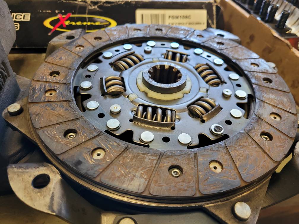

Picked up a billet flywheel and competition pressure plate I thought I may as well instal. Then I remembered mine was all balanced as an assembly with the crank, in my limited understanding. I mean it’s probably an overkill anyway. Being chromoly it is only 7kg against standard 11kg. The clutch may be slightly heavier than stock if anything. Driven plate was to suit dyno input so no use to me. You’ll probably guess where I got all this.

Mate Tim got me motivated. We were going to Dudley's last day, but decided to pull the motor.ImageHapply crank main journals and cam bearings look good.ImageThe rear main cap shell has a line in it.ImageI will replace all but the cam bearings seeing as I've got it apart. I'll replace the driven plate too. It is more eorn than I expected.
