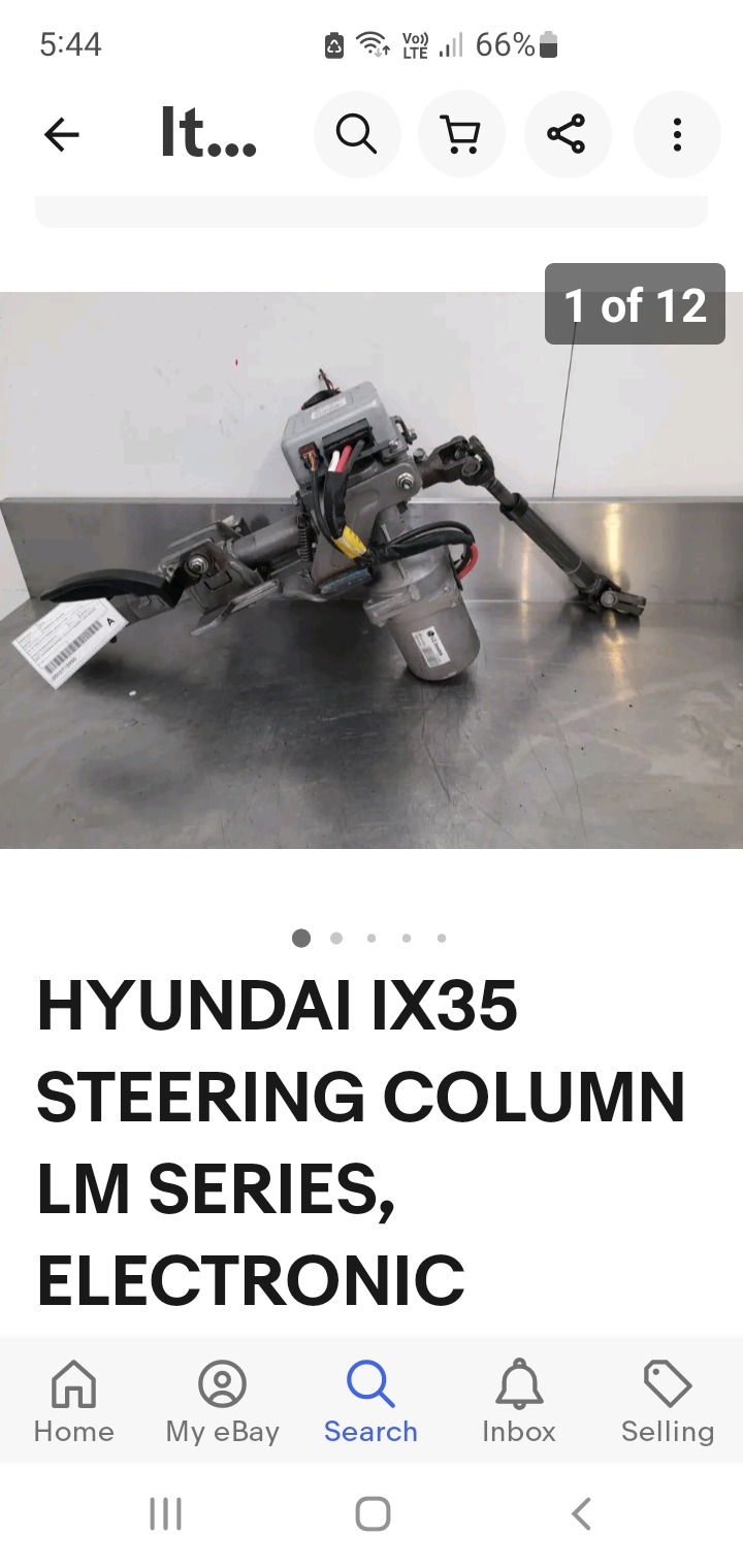

For a non factory option, I have started looking at electric steering units like this
https://www.flamingriver.com/fr40200-mi ... r-steering
Not at a stage yet to really fully consider, but its would be a tight fit with a collapsible column. Would need to fit it to the base of the column I think. Don't know if there is enough room between the steering box and the fire wall (assuming these units can be mounted in the engine bay). Early stages - need to sort out my steering box first. Or look at rack and pinion. Or do what I do when faced with the big picture problems - go back to cutting rust out of the car. Baby steps!
Scott
Posts: 14275
Re: Project 2.
I have looked at an under dash EPS unit, the column shift makes it more difficult but not impossible- there is a ute on here fitted with one . I bought a couple of them and it’s another “one day” project……..

Heres an interesting read, it is for an american falcon but the concept is the same for all old cars,
I have a standard Torana rack in my car and it is awesome to turn whist moving but is hard standing still. When i get some time I will look at one of these electric units.
https://www.therangerstation.com/tech/t ... onversion/
The amount of work doing a steering box modification compared to one of these units i feel would nearly be the same.
Posts: 2536
Re: Project 2.
Yes I grabbed one of these to play with but not enough under dash room to even consider it.

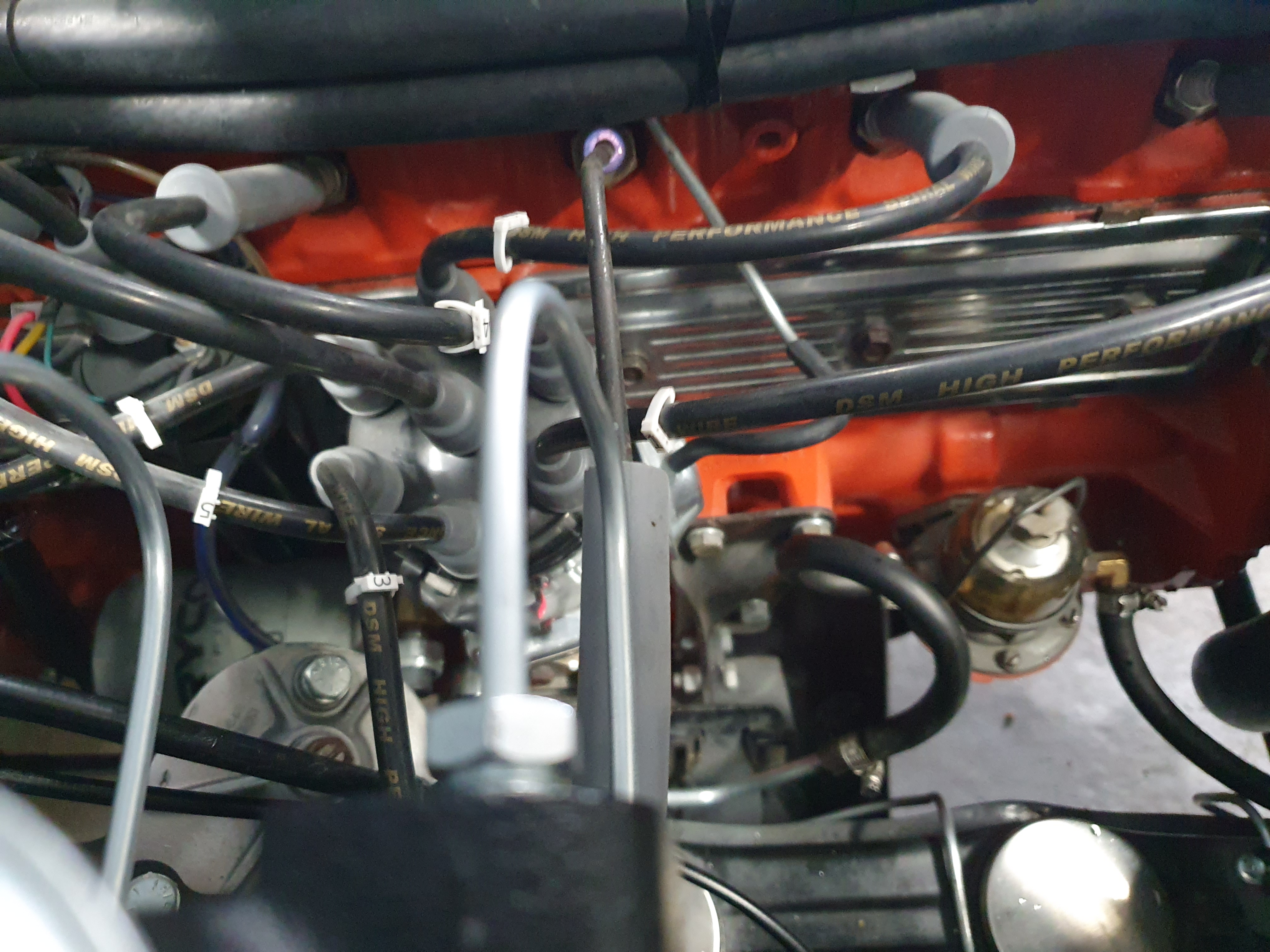

This one for Clay who is fond of 'jugs'😆

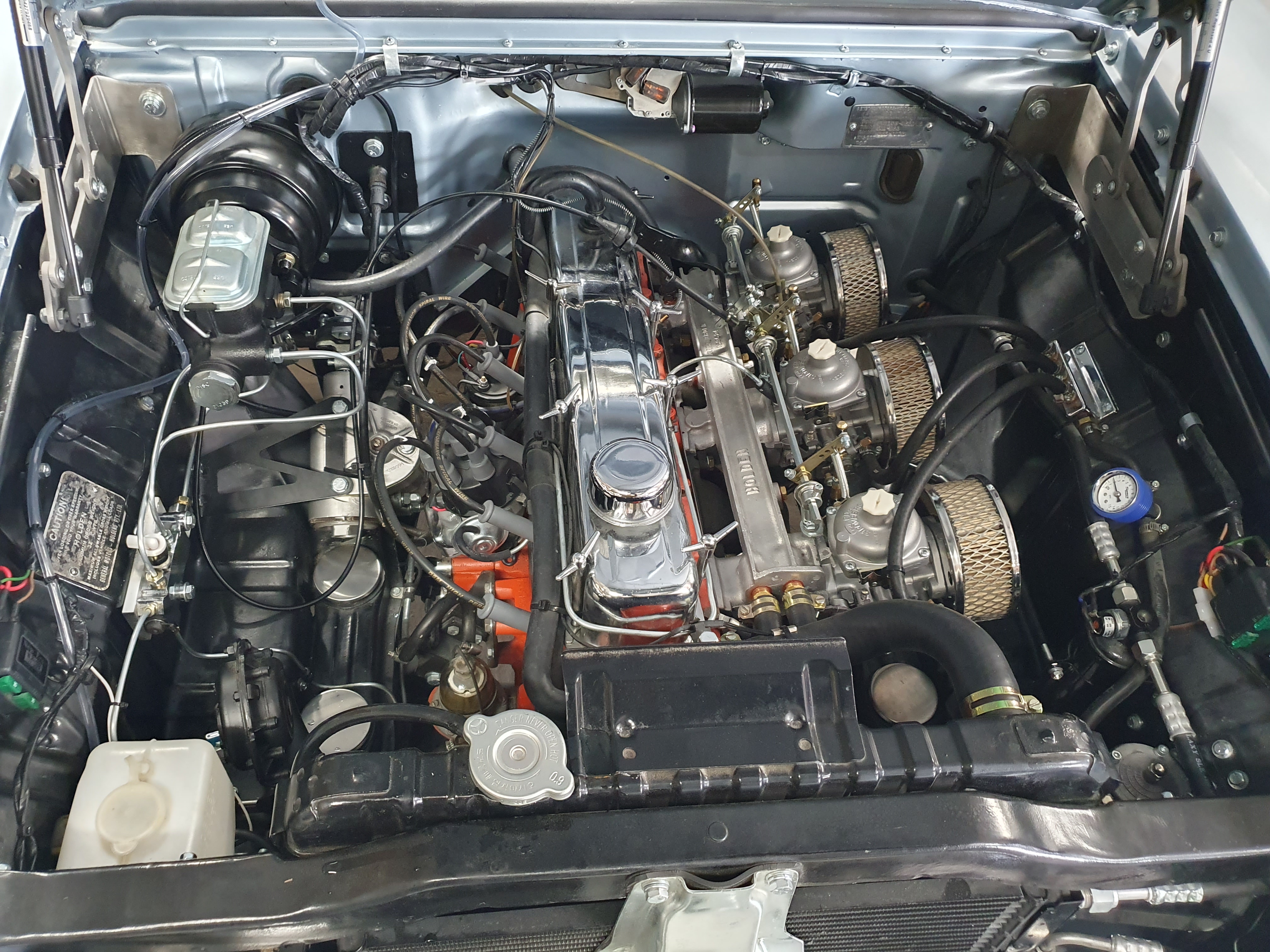

I like a big pair myself :wink34: :wink34: , but a beautifully worked out set up, well done Brett. :thumbsup:
FB Restomod V8 Sedan
Posts: 2289
Re: Project 2.
Nice one Brett…….. but I don’t see a bottle of Coopers stout 🤔
Posts: 2536
Re: Project 2.
Reschs Pilsner for me.
Tuning completed. Blue mixture and 1/3 up the tube for each. Easy peasy. Running sweeter than when on WW.

Thanks Brett. Kept me entertained for 20 minutes looking at that. I’m using a similar throttle cable set up by the looks. I see the Holden manifold is water heated and you are only choking the rear carb, which should still give you idle up on all three due to rigid linkage. Tidy setup with the springs. I don’t like the way mine hang down under the carbs, sorry jugs, so may revisit this. I take it your throttle cable and lever aren’t fully set up in the photo, and you have the individual levers pulling the throttles. I’ve seen some set up to push but not sure about it. They turn the levers 180 degrees on the individual throttle shafts. Engine bay looks mint mate. Bit more exciting than the old WW.
