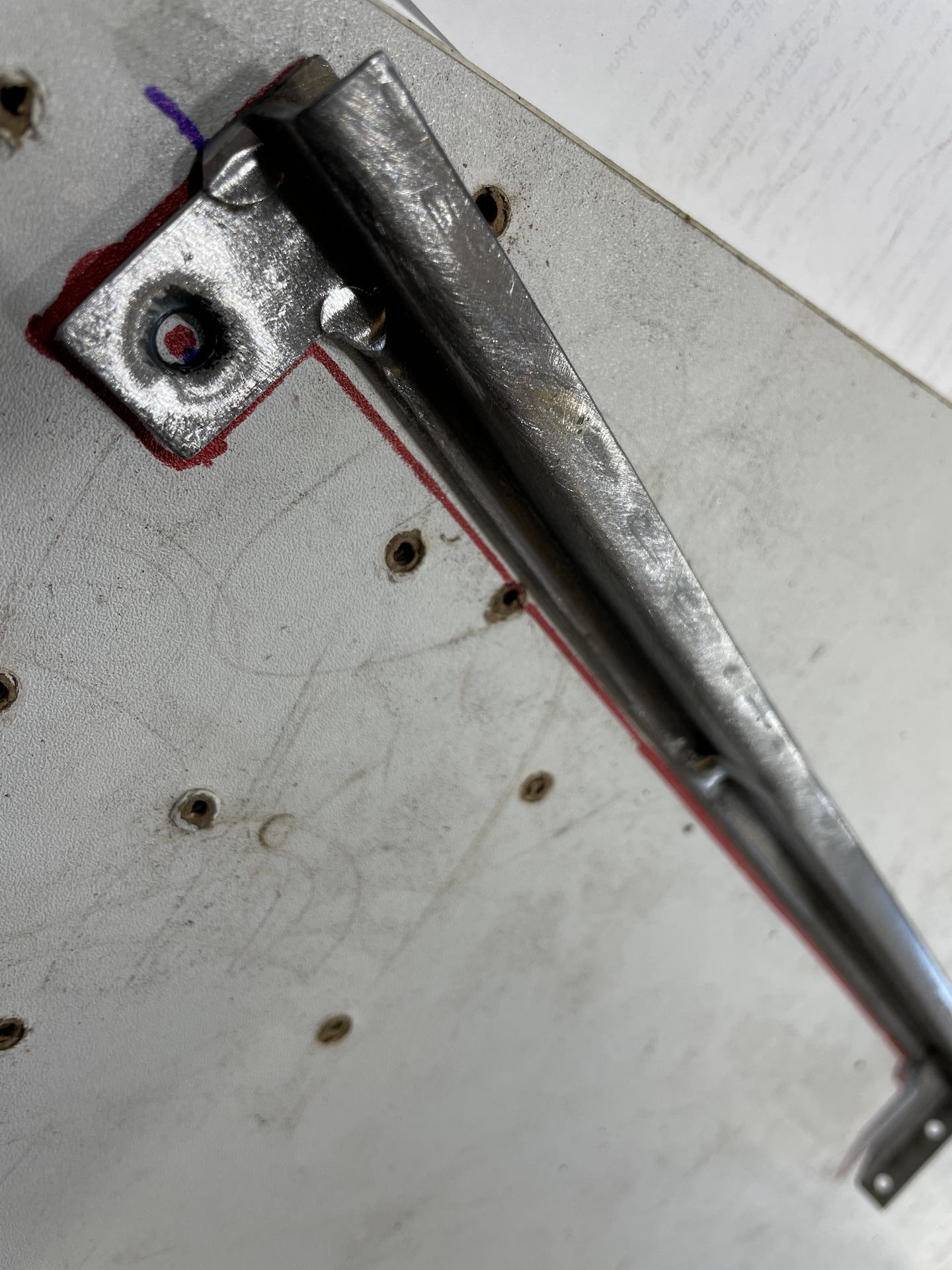

On to the rear channel guide.
Happens to fit perfectly over yet another piece of hardwood decking.
Folded new metal over the hardwood form. Using the old metal to trace out where to cut and grind the new piece.
Bit of manipulation and old and new should marry back together.
Good as new(ish)

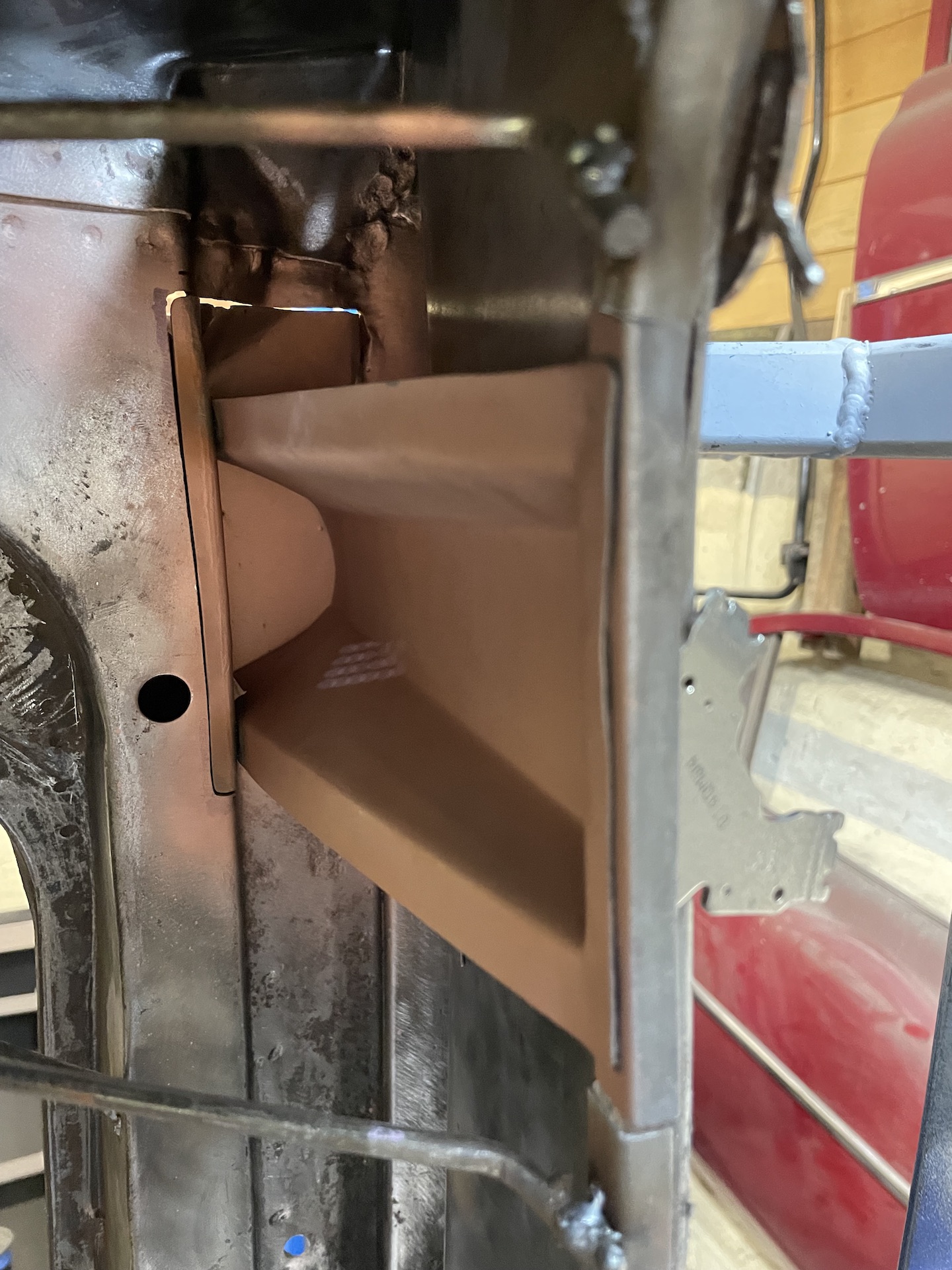

Inspired by Dave's Orange Betty EK Sedan, I decided it was time to tackle the upright brace. Decided to brace the panel around the upright, so I could use the existing boot rubber gutter as a guide to line things back up.

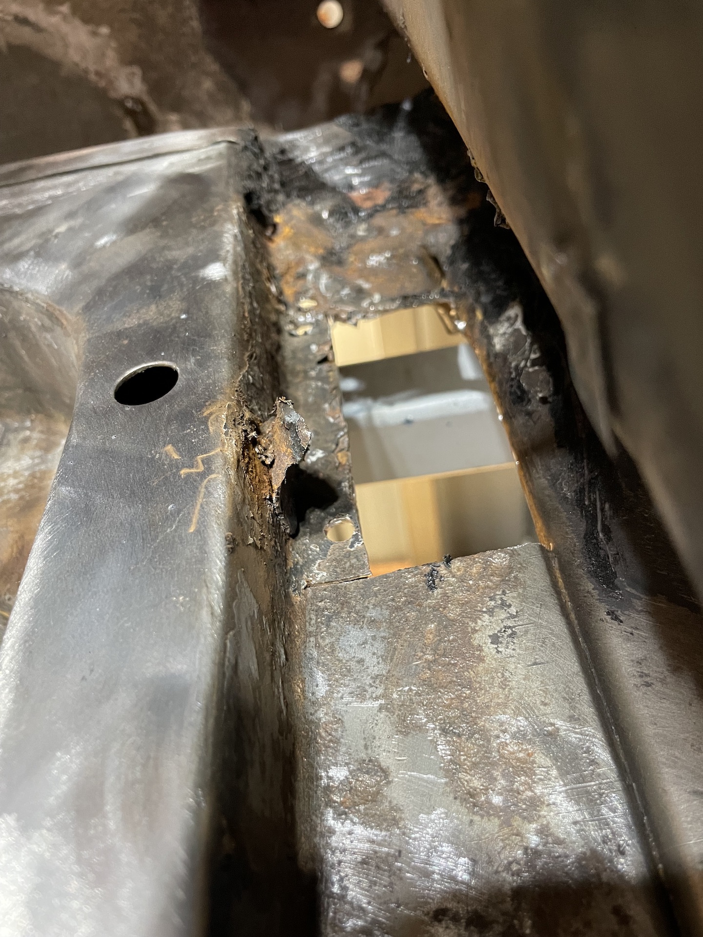

Cut out most of the rusted floor, drilled out some spot welds and prised the brace off the cross member with a cold chisel.

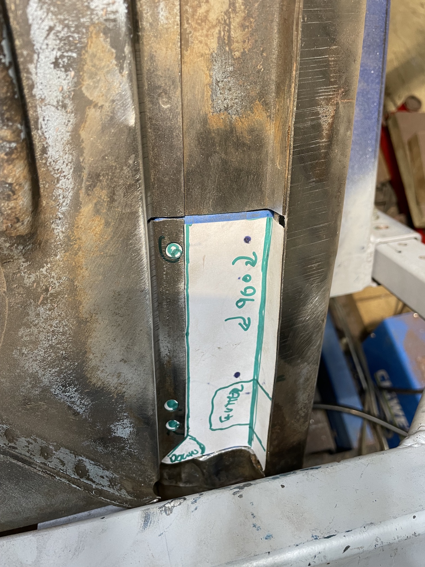

Then decided the only way to easily weld the brace to the cross member was out of the car, so I cut a bit of the cross member out as well as it too had a bit of rust. This is what needs to be replaced.
Made up a paper template for the cross member fix.

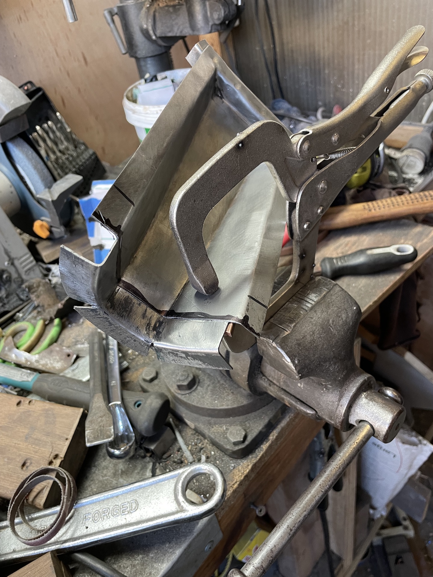

Used a bit of scrap to create a profile for the replacement. Bent up the replacement but didn't take any pics of that. Only tricky bit was the drain hole which I did the same as the rear quarter replacement.
Meanwhile, made up a new bottom for the brace.

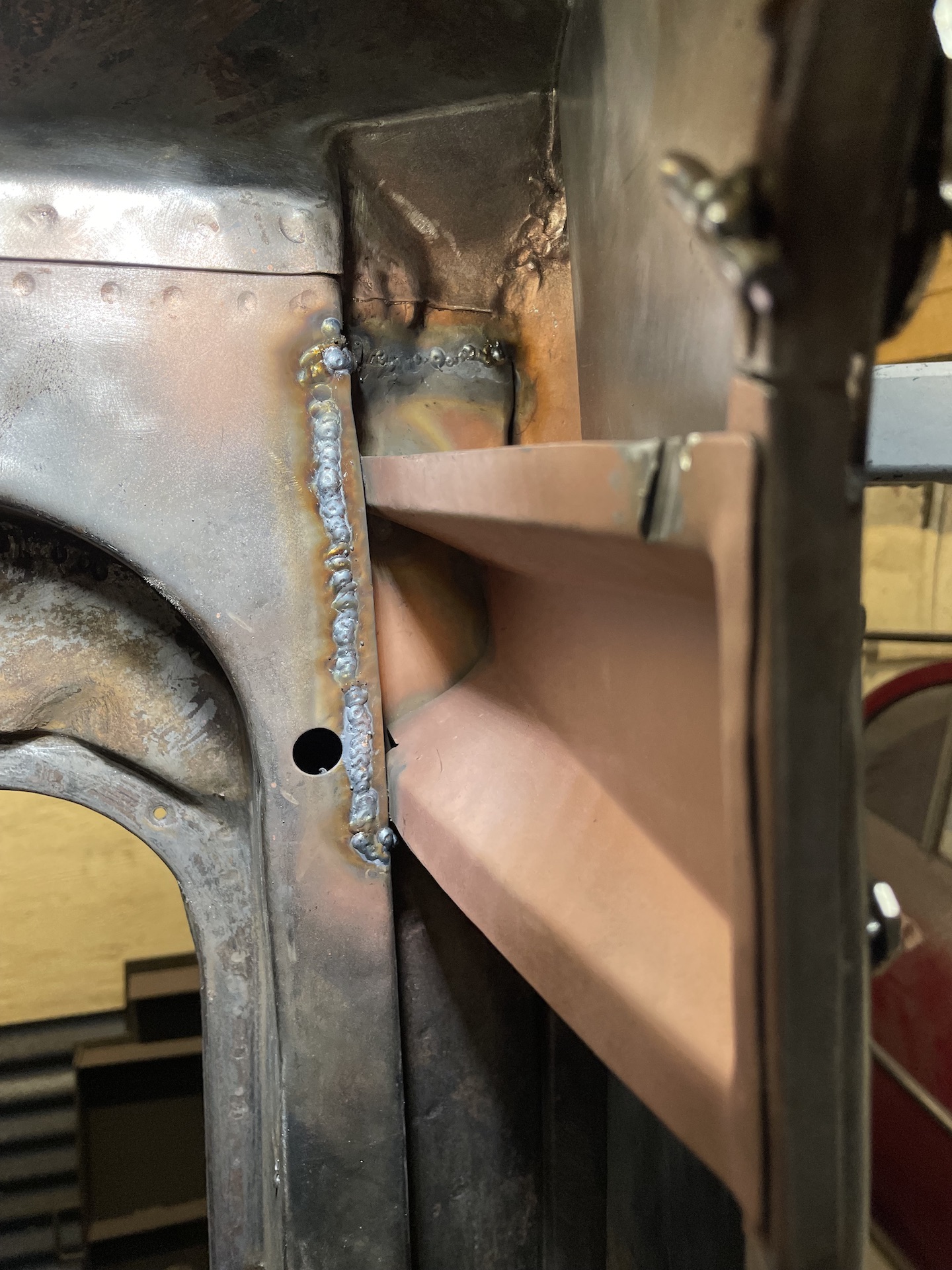

Compared my new brace with the brace on the other side and decided there was not going to be enough meat to spot weld to. Also couldn't work out how I was going to fold those tabs and get it to line back up. So I cut the bottom off and made a new one, scribed a cut on the brace with both the new base and the brace in position, crossed my fingers, cut, and started welding.
Traced out the new foot of the brace onto the new, folded cross member replacement, and drilled for plug welding.
Splash of weld through primer and plug welded the two bits together.
Then trial fit. After a bit of manipulation to make sure it all line up.

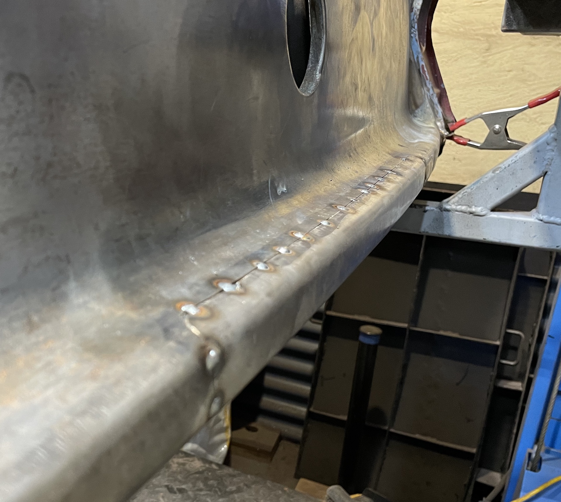

Plug weld the brace to the patch and the patch to the beaver. Then stitched the patch in along the two sides from the bottom.

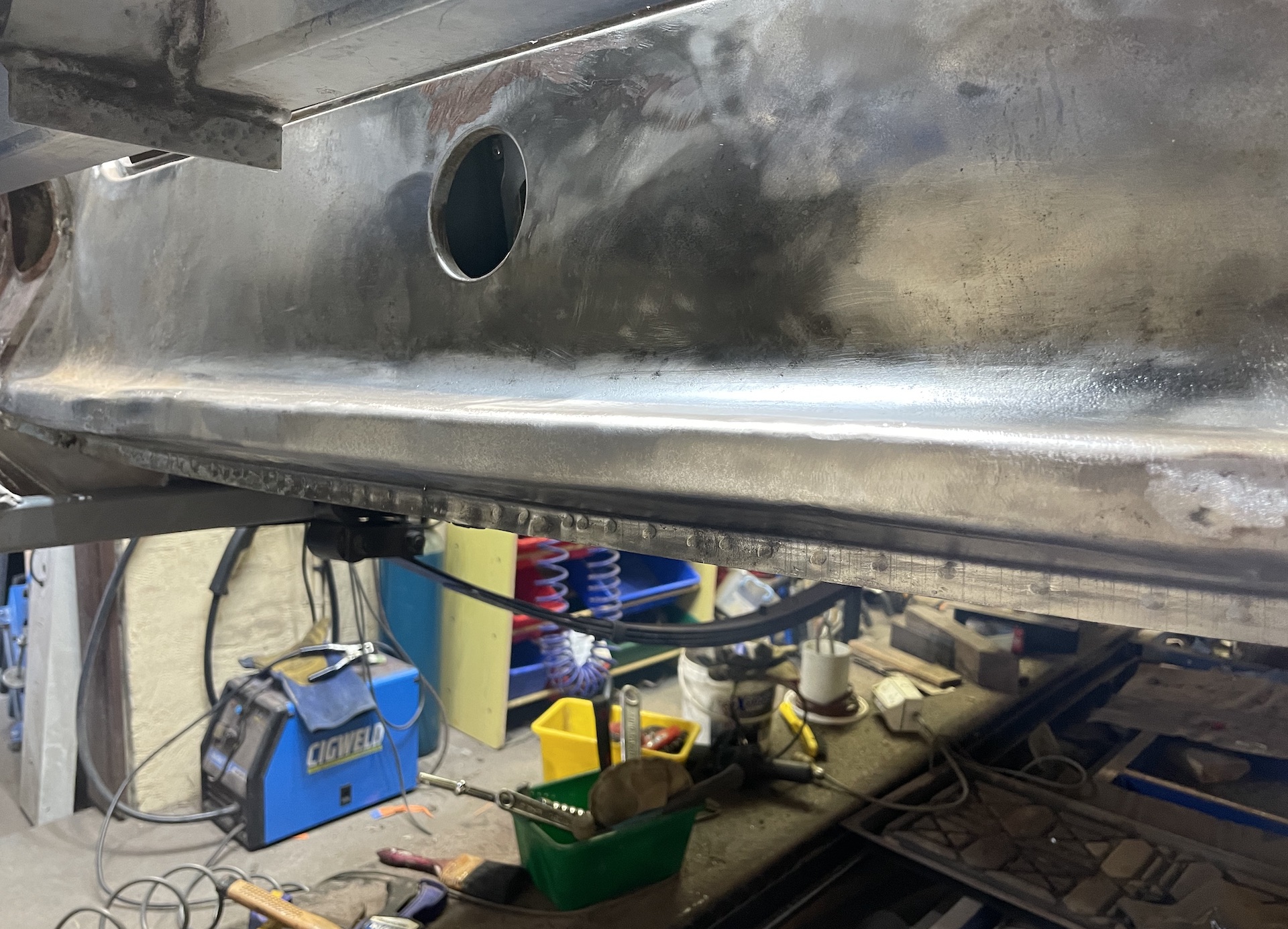

Stitched the patch in to the top of the crossmember, and attempt to do the sides. Really is just not enough room to get the MIG in here. Tried grinding off the gas shielding nozzle at 45 degrees but it didn't help much. Haven't dressed these down yet, might have another crack, or could cut open the bottom of the cross member and weld from there (still don't think access with the torch would improve), or maybe I should just buy some JB Weld and move on.
Dress down the welds under the car, and while I was there finally dressed the welds around the rear quarter repair which I never got to. Spray on some easyphos and time for the next challange.

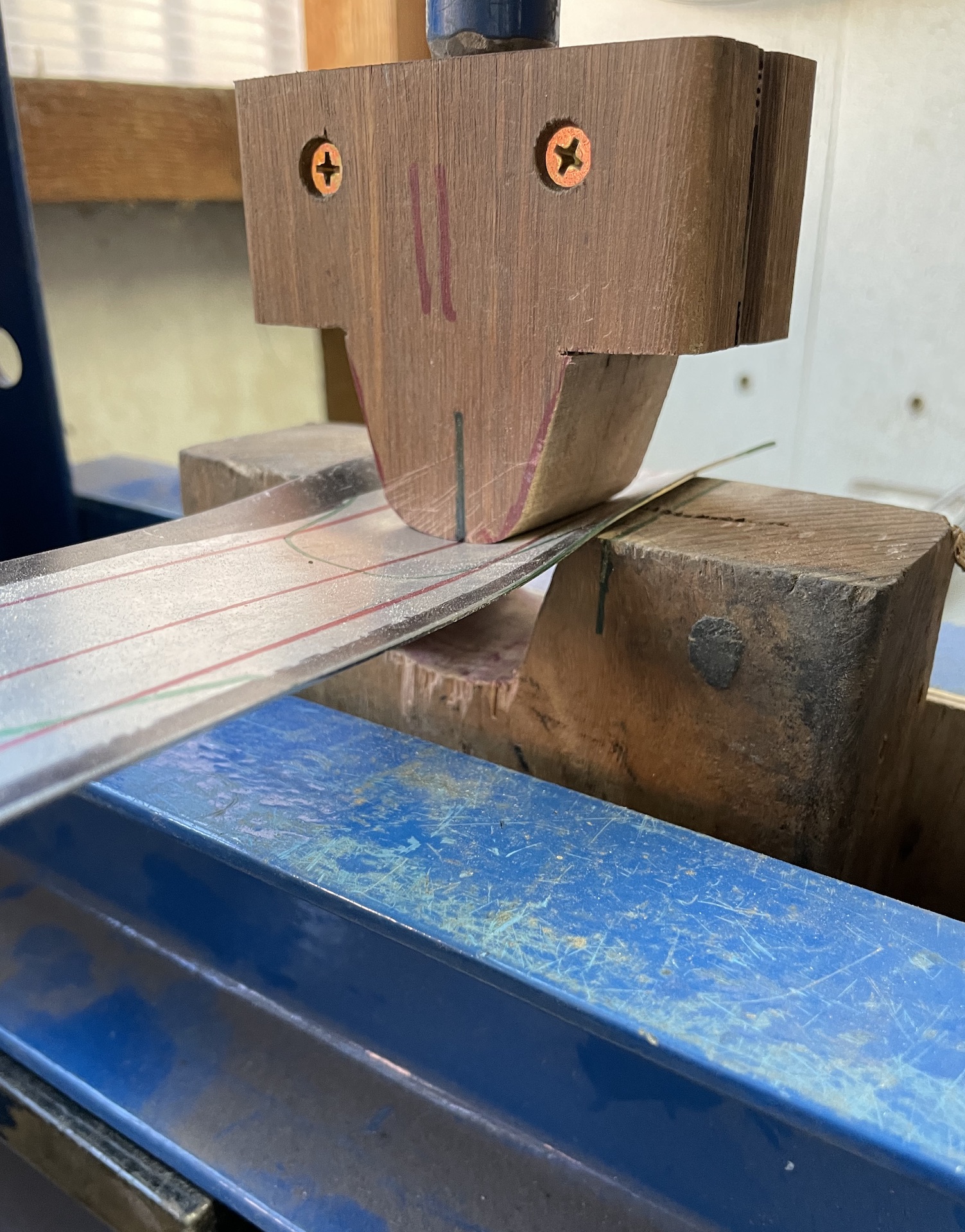

Next. Back of the car is a bit of a mess. Full of bog. Wire wheeled it out a while ago, cleaned it up and thought I'd just try and fill the pin holes as it's hidden behind the bumper. Fail. Just blew bigger holes.
So used a profile gauge to cut a template and then got the powerfile into action to build a die out of hardwood.
Lots of lines on a bit of 1mm steel and into the press.
A few passes later.
Bit of massaging to tighten up the profile and it's a good fit. But it is curving out instead of in.
