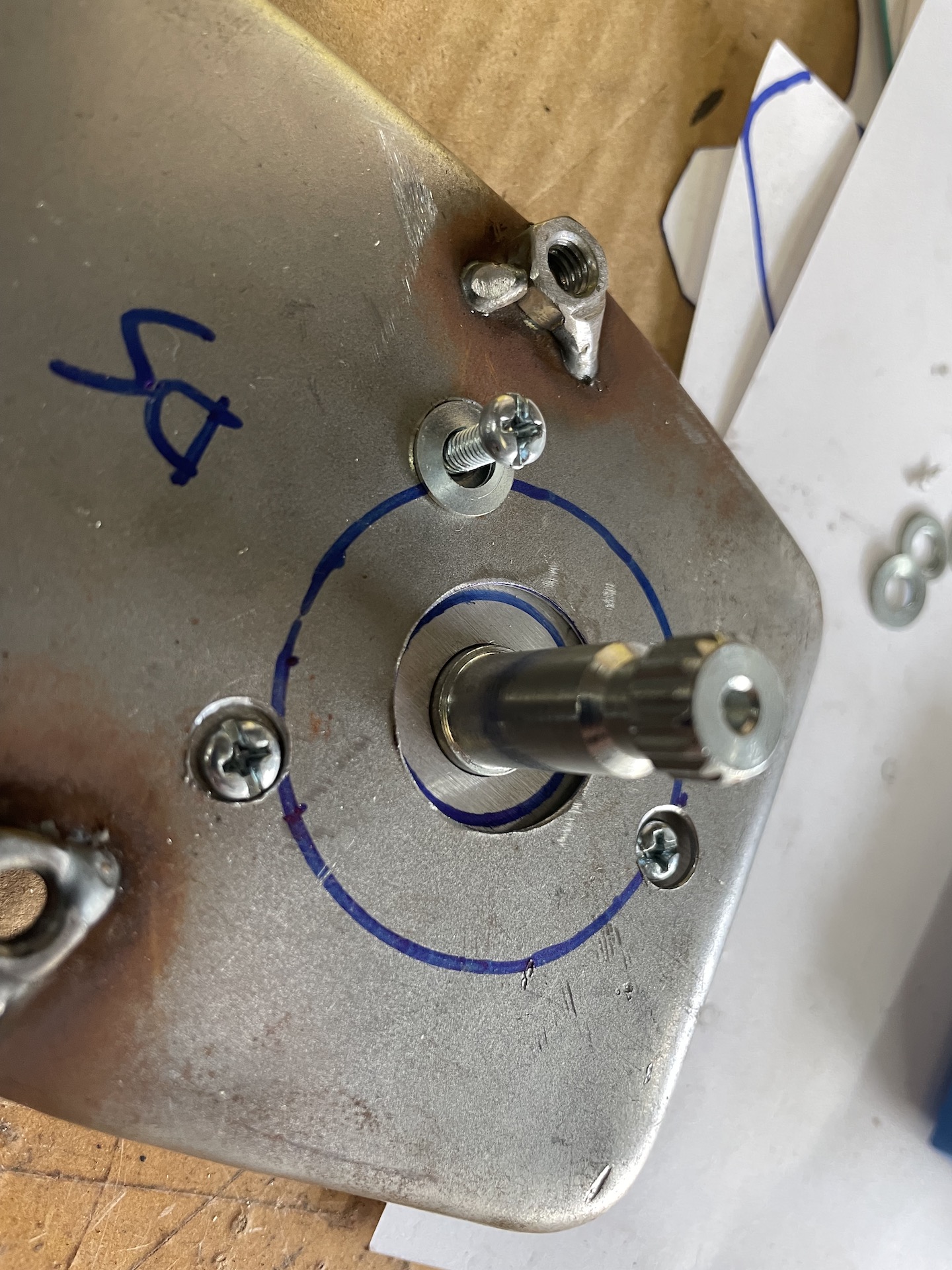

These are mounted directly in place of the existing window winder. There is a selection of shafts, none are a direct match but this one is close enough.
Quick test fit - the 3 mounting holds are just on the lip. Made the decision to make a mounting plate and bolt that to the existing 3 holes of the door winder rather than butcher the door. Thinking was that if the power windows didn't work, I would be able to easily replace with the original winder.
A bit of bashing of metal later.
Got to say, these units are a PITA to mount. You need to remove the top plate to mount. Undo the 3 screws and the whole thing springs apart.
Much swearing and frustration to just get them back together. So to add the mounting bracket, my solution was to drill holes bigger than the mounting screws in the bracket and add washers. Screw the whole thing together with 2 screws, then, add the third with the plate and a washer. Unscrew and add washers to the remaining 2 bolts.

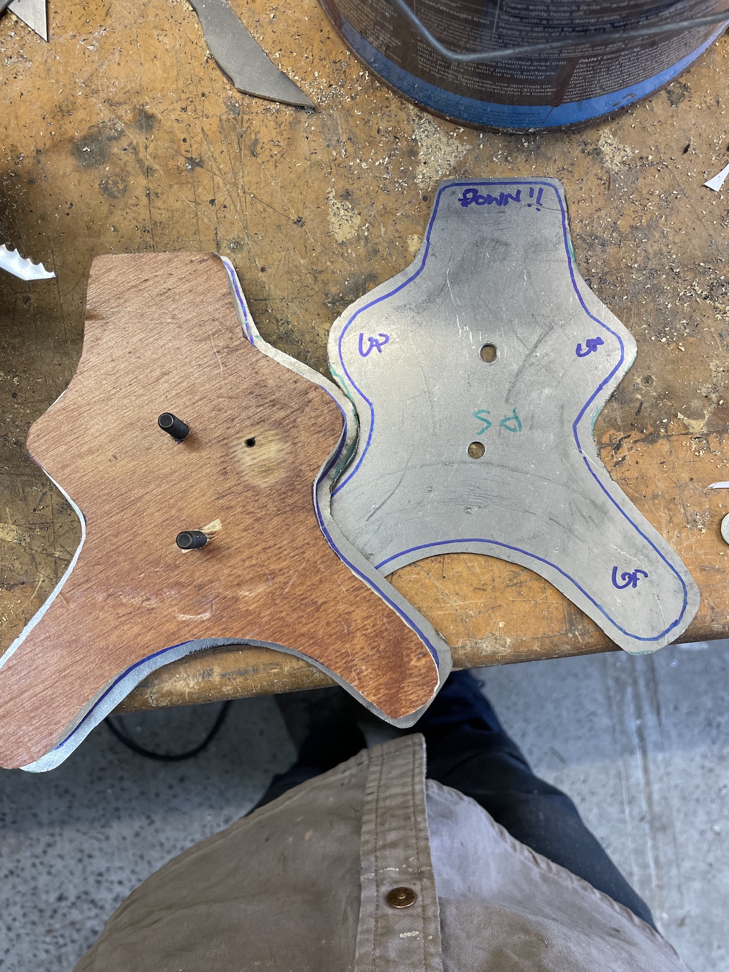

Using the bottom bracket of the speaker as a mounting point for the motor bracket. There is not much in this area of the door to attach the motor to, so the plan is to fabricate a mounting plate, hang it from this bottom bracket, and then brace it as needed. Got the paper and pens out.
Traced and cut 1.2mm sheet with the jig saw, then trimmed the template down, traced and cut the scrap of ply that keeps on giving, to the final shape of the bracket that will hold the power window motor bracket.

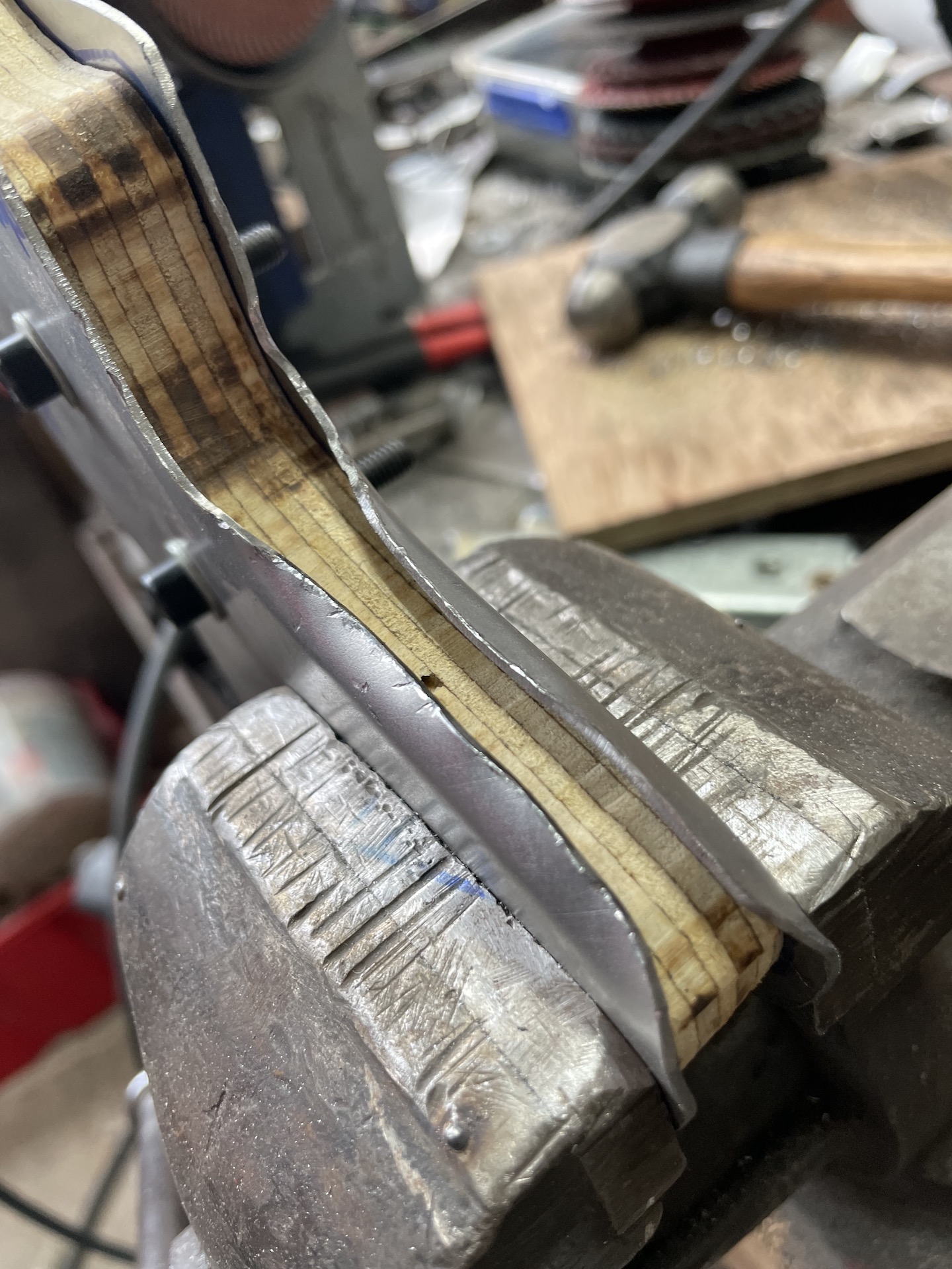

Bolted it all together and put it in the vice to keep as flat as possible. Hit the ply metal sandwich with a hammer. Many times.
Now I feel better.
Unbolt, flip around and continue to follow instructions on metal
Cut off end of ply and bend the dogleg
Use cut off bit to complete the job.
Grind away all the excess metal, drill holes for bolt access and centre of motor which is a little proud, and ready to fit.

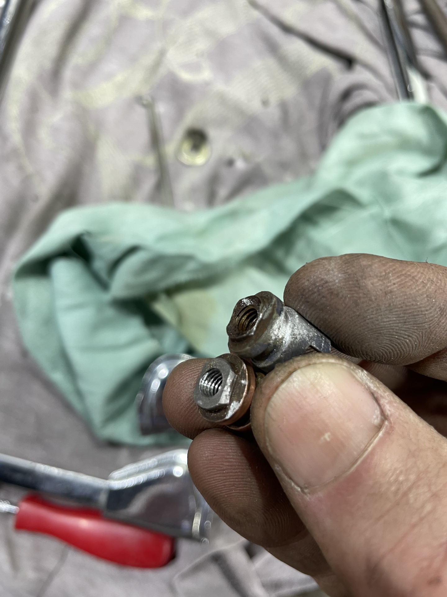

Not quite. Was going to position the bracket between the two nuts on the speaker bracket. Cut the blue hose about 6mm too short between the motor and rail. Doesn't seem like much but it was causing the cable to rub on the edge of the guide tube at to bottom. So deleted a bit, welded in another nut.

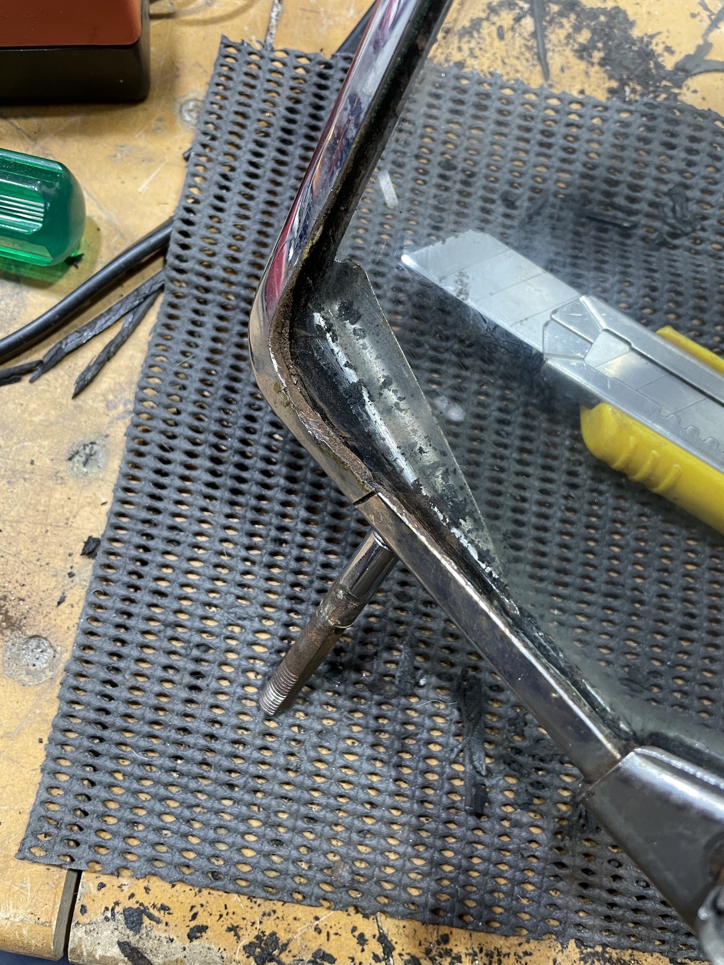

More door fun. 1/4 vents and bailey channels. Stripped the 1/4 vents down as needed new seals and probably look at getting them rechromed. Needed to replace the frame of the drivers side as there is a bit of rust in the bottom. Wanted the glass so a knife fight ensued.
Here's what's left - its junk now and I have a spare - one of the few bits I saved off my original FB in Melbourne. Have a crazy idea that you could combine 2 top halves to make a 'new' one. Just need to work out how to attach the bottom shaft.
Hours of scraping silicone out of the passenger side one, minutes removing the setting tape from the donor. Note to self - use setting tape. After a few baths in citric acid and a dusting of silver rust paint, the passenger and donor brightwork is ready to go back together (but I still think they will get rechomed).

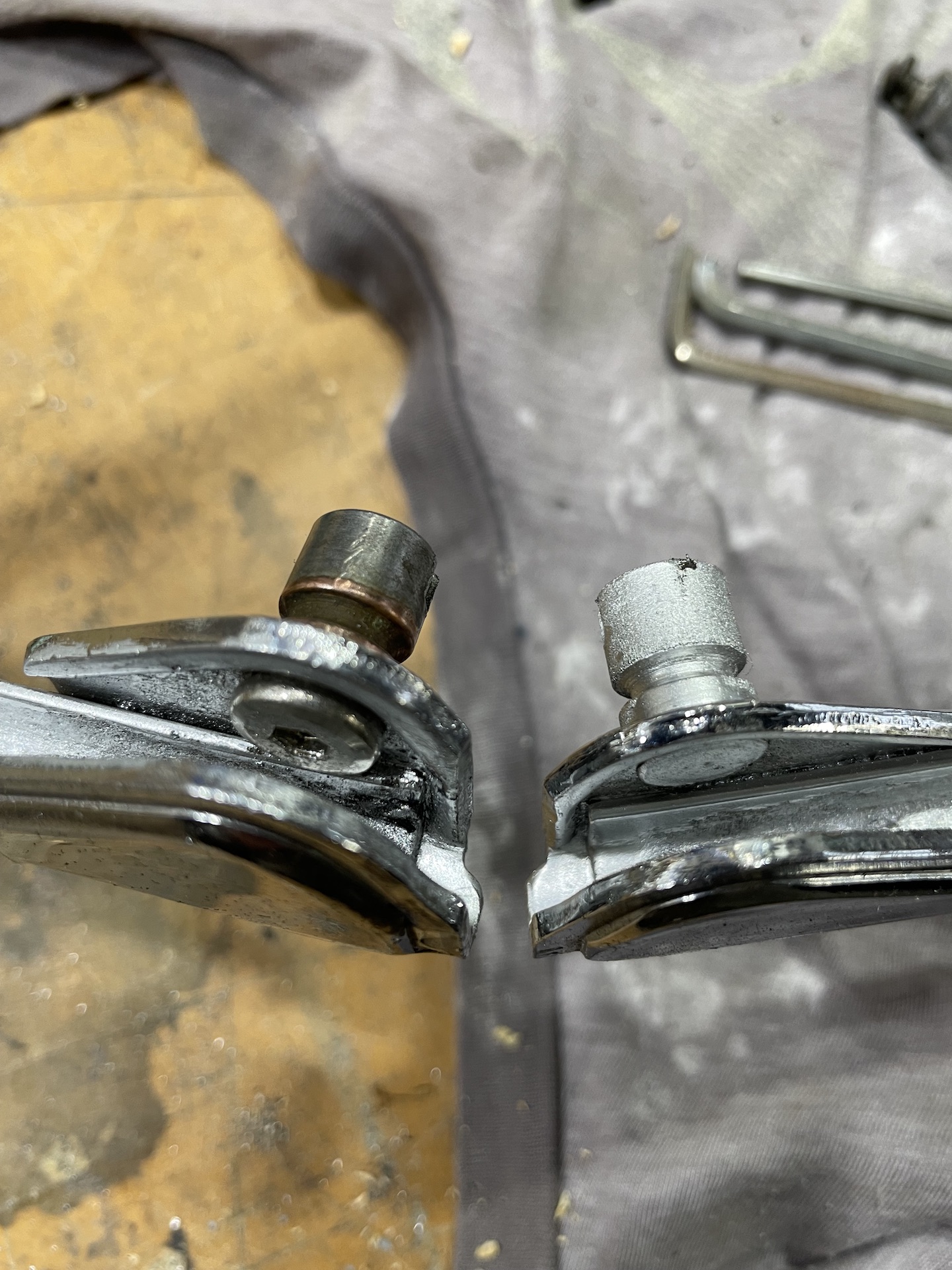

The passenger one is bugging me - the shaft for the latch is loose in its housing. Closer look and its had a sneaky repair job that requires a special removal tool.
Can see why this was moving around. No damage to the frame side though.

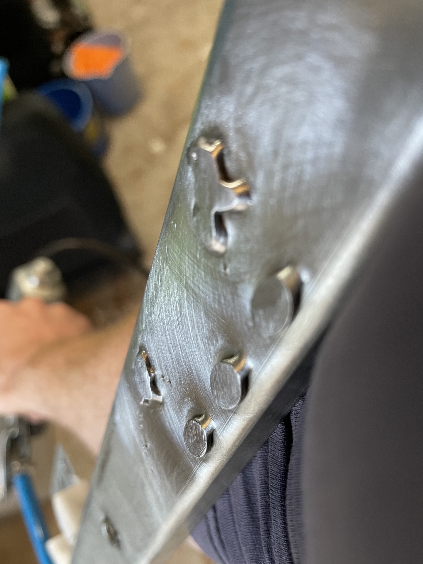

Time for the first sacrifice off the original drivers side frame.
And here's a look at the profile of rivets. Would have drilled them out to remove the bracket, but needed to split the bracket anyway.

Ground the shaft off the bracket
Drilled and tapped to accept M5 hex head bolt
Found a bolt - its a little proud. I'll double check this before reinstalling the glass.

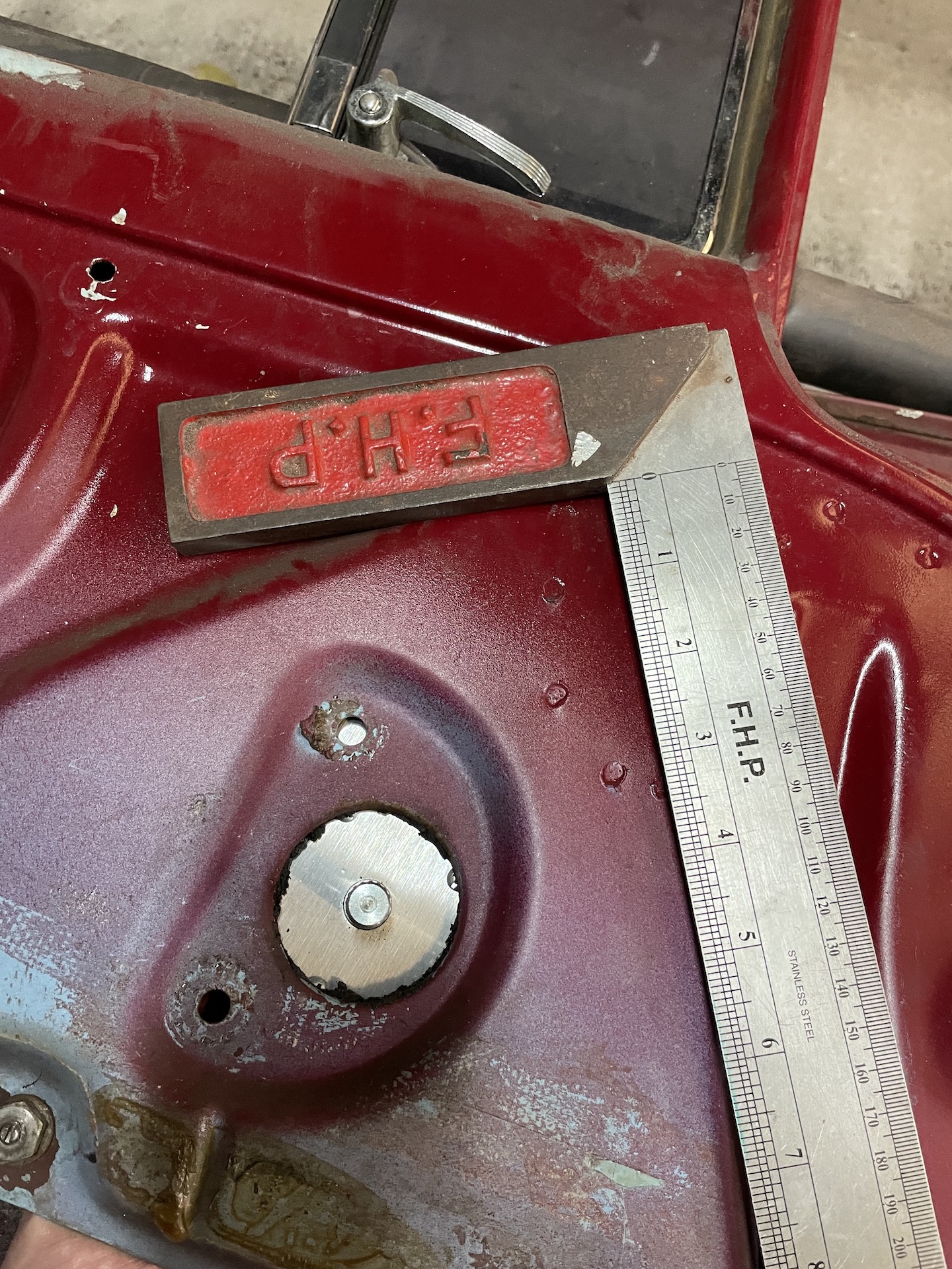

Removed the lower bailey channel guides from the 1/4 vent and the rear of the front doors.
Sand blasting revealed a few holes.

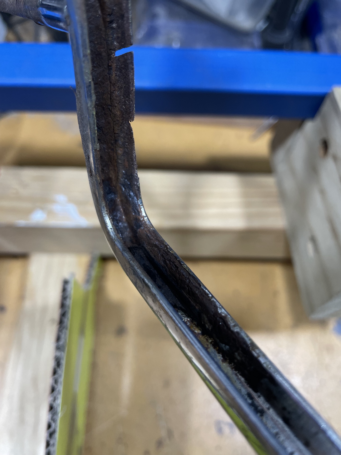

Starting with the 1/4 vent, did a quick fold in 1mm sheet to replicate the folds in the channel.
Then moved on to 1.6mm which requires a bit more blunt force.
Also made up a new tab for the end adjusting bolt.
Actually made a few. Took a few goes to hold on to enough metal. Should have just welded a nut on but as I did have a nut this seemed like the quicker option
Before a cut the bad metal off, I made a shadow board as a rough guide. Then cut and trimmed until it a fit.
