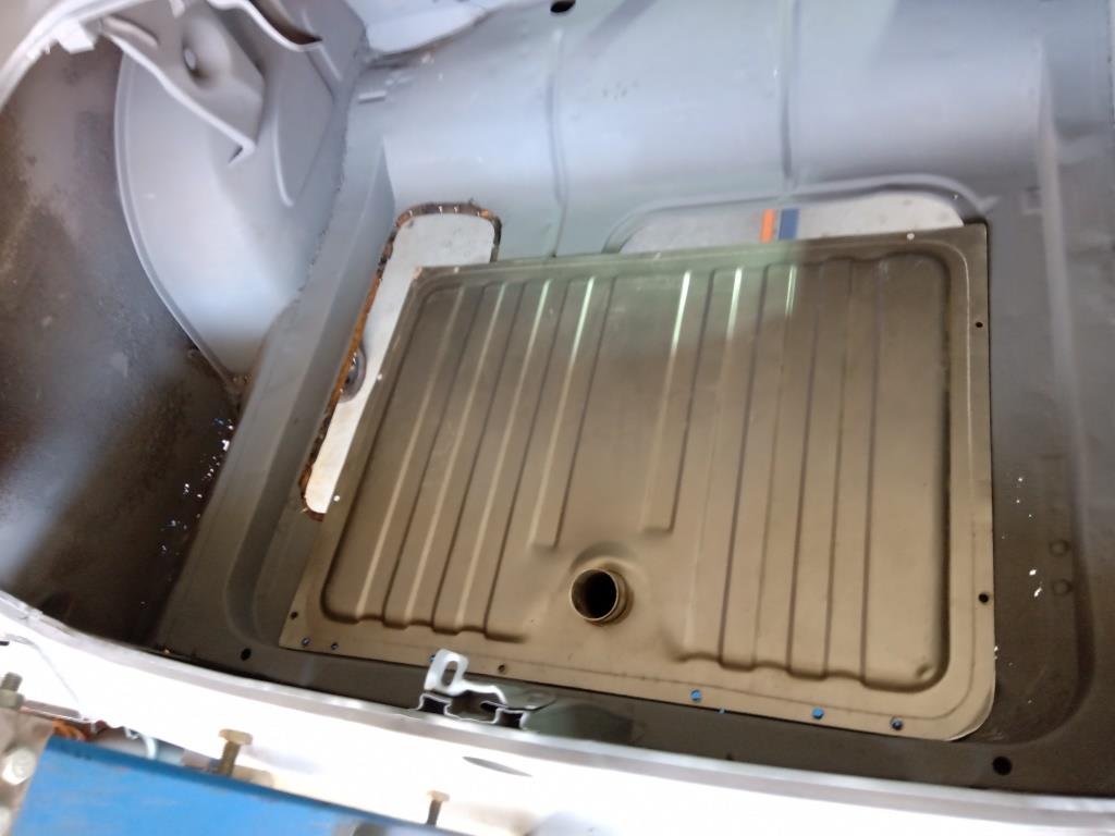

And boot floor rough cut to fit Mustang fuel tank

Hey Dave - do you have the part number for that tank? 16 gallons? I started researching dimensions and I thought it was going to sit closer to the diff than yours. Might have been looking at the 69 tanks which are 22 I think. Inspired to start looking again!

It’s a shame they aren’t 50mm narrower- from that pic it looks like you could retain the spare wheel well if you offset the tank to the drivers side ??

I offset the 16 gallon mustang tank in Ammo's ute so i could have a straight line on the exhaust.
I did move the filler to the side after this photo.
mustang tank in.JPG (111.48 KiB) Viewed 5577 times
My understanding is the tank the same width and length but get deeper as the capacity increases.

Your right Roger - just had a look through my notes and the tank I was looking at that was long was a '69 Maverick tank. It's a bit skinnier than the Mustang tank (699mm vs 829mm), so the spare wheel would fit. Just a bit too long. The filler is offset to the wrong side so some modding would be needed. I put that in the too hard basket.

Sorry Scott, no part number I can see. And while it may have moved over to save the spare wheel well I didn't want to mess with the perfectly aligned filler position!

How much room is there between the tank and the diff? Maybe worth a look at sneaking the spare wheel well in there. Apart from the fact that it probably doesn't fit, I guess access to the fuel sender would be an issue.
