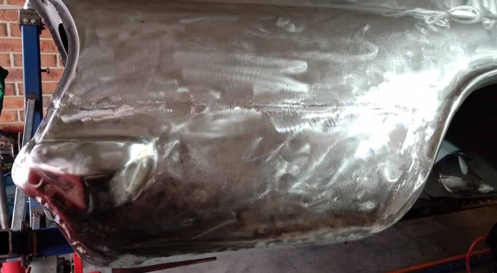

Fully welded in the Rares Patch and the patches for Rares patch....
lots of grinding later.
Not too bad. The panel at the top weld is a bit wavy, there is shallow low in the middle of the patch and a bit of dent/hollow where I blended the original wheel arch to the Rares one.
Will now have my first go at using filler!

Great work Dave. Some say to seal the metal with 2k etch prior to filler.

Errol62 wrote: Sat Jun 03, 2023 6:40 pm Great work Dave. Some say to seal the metal with 2k etch prior to filler.
Thanks Clay. Yeah, have heard that, but 'others' say filler adheres best to bare metal.... And I'm using glass fibre in the first instance so waterproof. One of those "6 of one and half-a-dozen of the other" things.

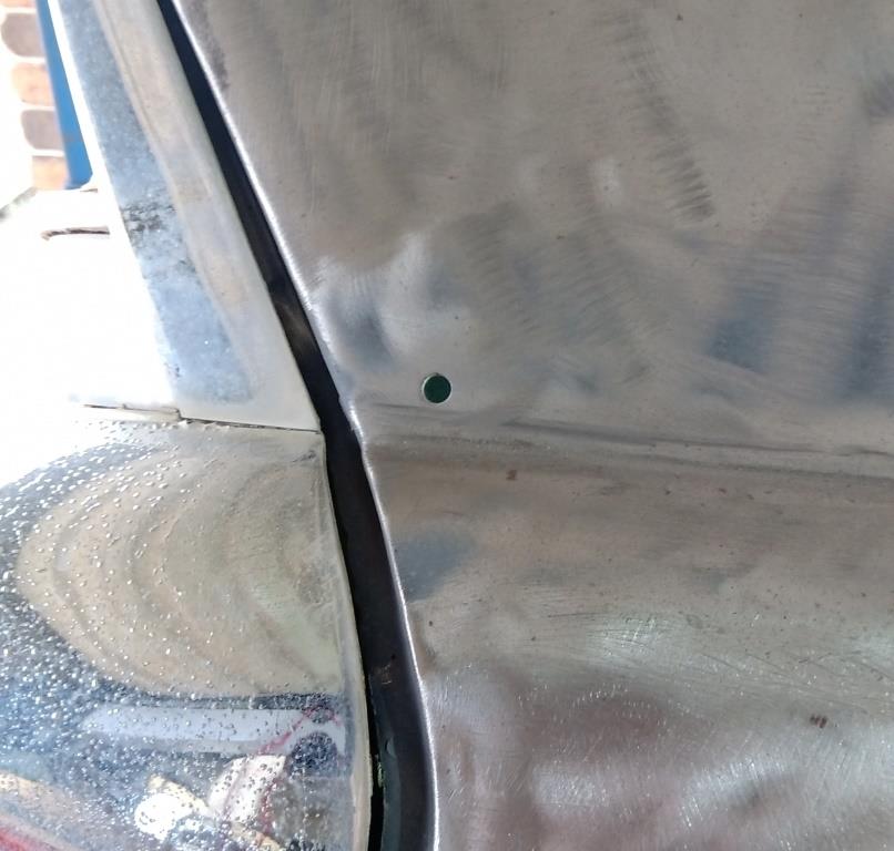

How is the rear taillamp unit supposed to interface with the rear qtr panel?
taillight fit.jpg (101.76 KiB) Viewed 7688 times
It looks like I've got to straighten out the lumpy bits on the edge and cut a slit in it???
Also, what is this hole for?
Dave
62 EK Sedan in slow progress
Posts: 11669
Let me slither out into the yard snd check my couch cut.
I’m guessing the hole is for retaining the end of the stainless trim, but I’ve never owned a special, couch cut included.

Errol62 wrote: Tue Jun 06, 2023 4:45 pm Let me slither out into the yard snd check my couch cut.
Awesome, thanks Clay. Looks like my Rares qtr panel patch is about 10mm too high but I think after some massaging it won't be noticeable.
I've decided not to use the EK trim so will be welding up the holes.
Dave
