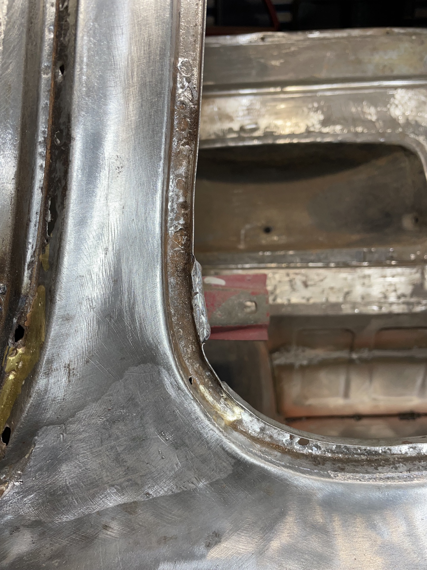

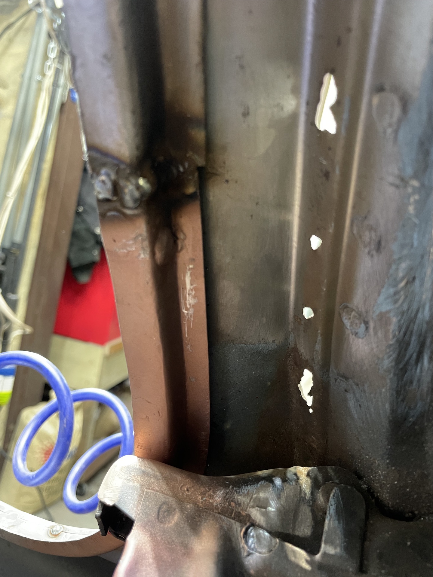

Next step - replacing the first of many sections of the boot rubber channel. This was closest and has some tricky bits so a good place to start. Can anyone let me know if the welding between the boot channel and the boot hinge upright is normal? I have it on both sides. When I cut through it with the grinder it went bang and shifted either a/. boot hinge upright down and back 2mm or b/. the lip above the boot up and forward 2mm. The boot hinge upright is spot welded all along the parcel shelf so I was surprised it moved so much.
Cut out the rust, leaving the top lip in tact which will give me a go line to weld to. There is a supporting brace which runs the length of the top of the channel. It is spot welded to the bottom and back of the channel.

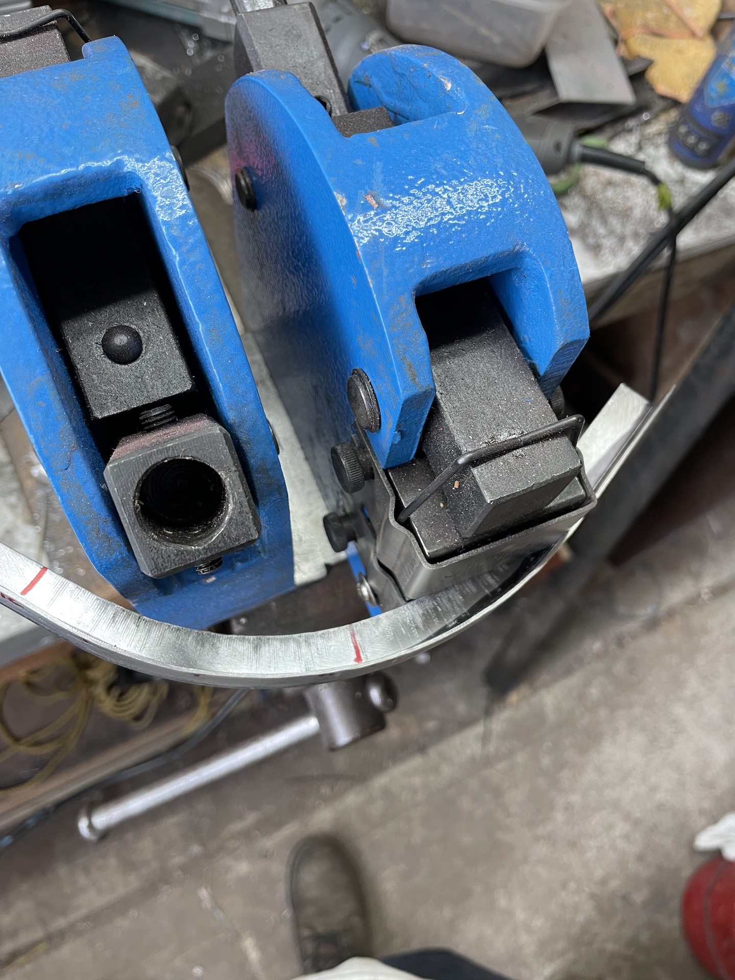

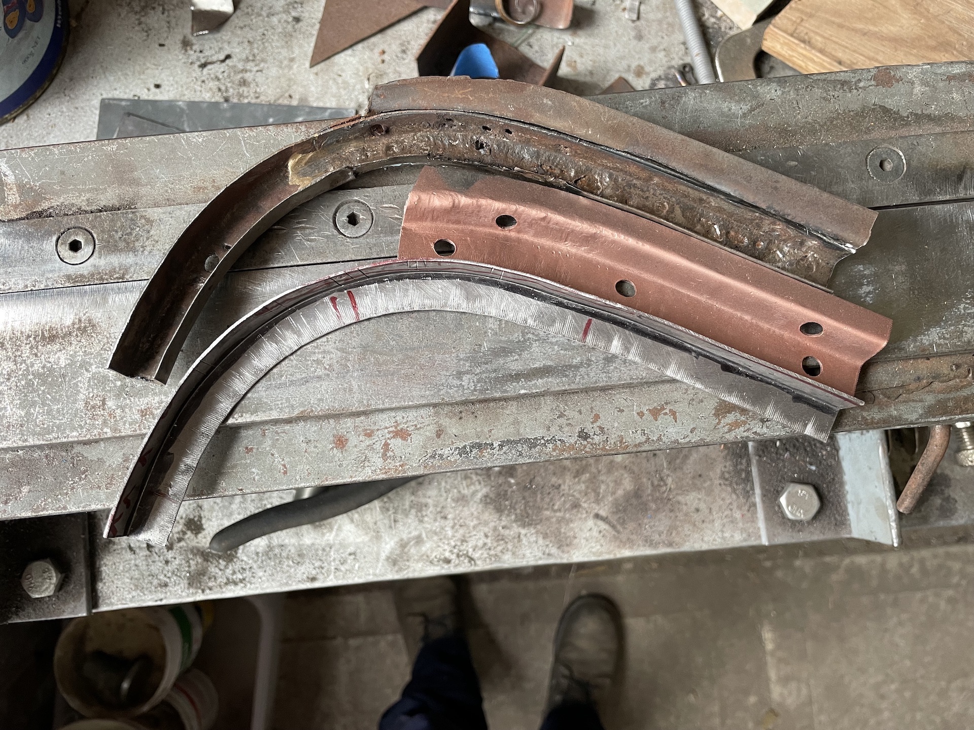

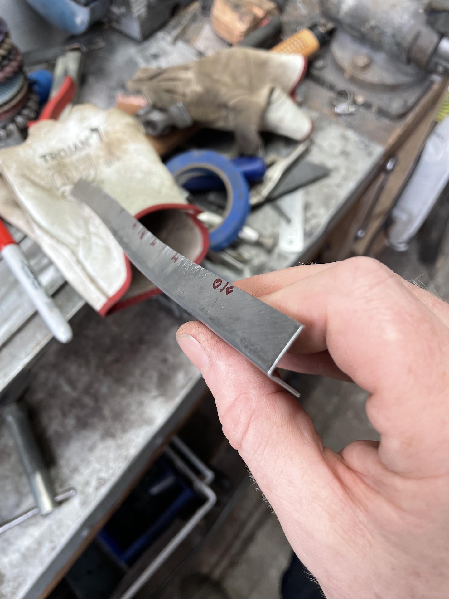

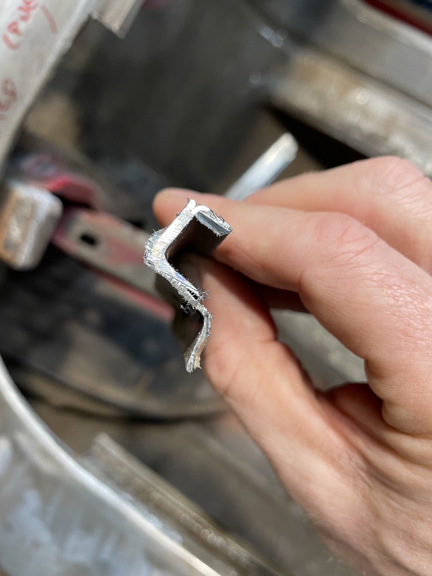

I made the brace and manage to not take one picture. It ended up being a battle as I tried to make it in one piece - folding the metal into 2 90 degree bends then massaging it with various shapes of metal to get it to curve into a similar shape to the original. As it will never be seen, not too concerned - just wanted to make sure it is strong. To make the U channel, which curves in all directions, I needed to make it in 2 parts. Back and bottom, then the front. The is a subtle wave as the channel as it curves around. I used a bit of tape and code to mark where it needed to be stretched and shrunk and transferred to my angle.
Then add the main curve only to discover the mount I made for my shrinker stretcher has a major flaw with tight radius.
Test fit, stretch, test fit shrink. Repeat

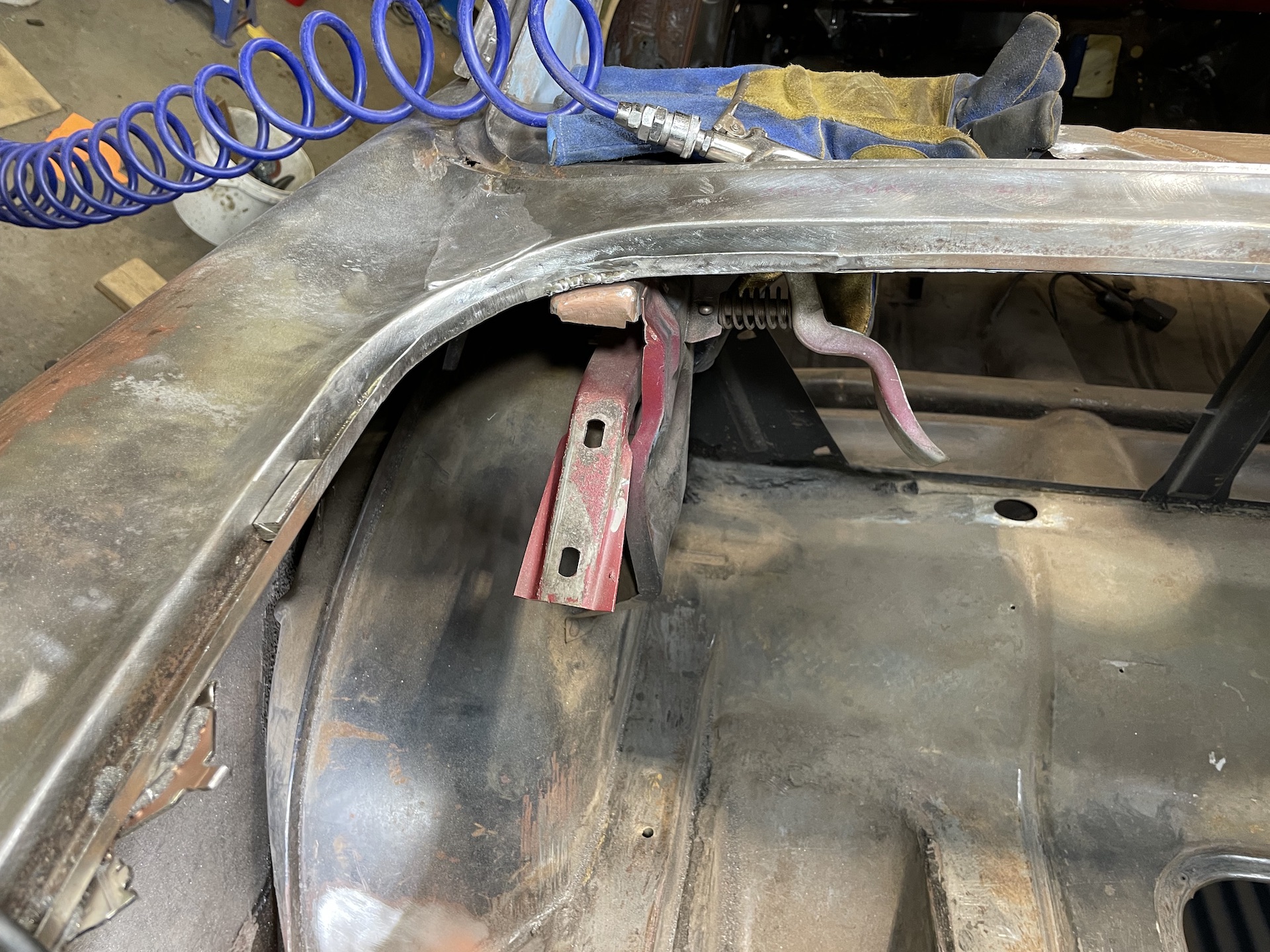

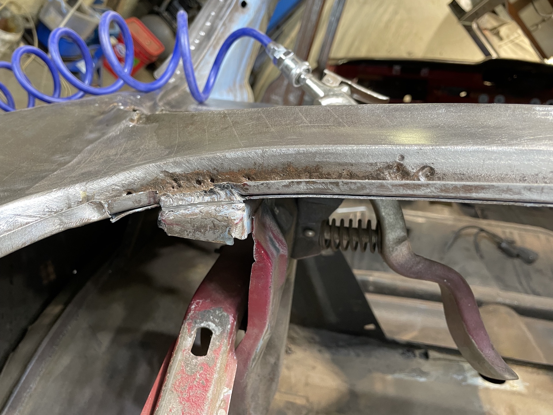

Plug welded the brace to the U section, the heat shrunk it slightly, so back to the shrinker stretcher which, to my surprise, still worked on the now 2mm metal.
Tacked in and welded both the front and back of the braced section.
Dressed these down, then finished welding the rest in. Things got a bit hot for the lead which started to run.

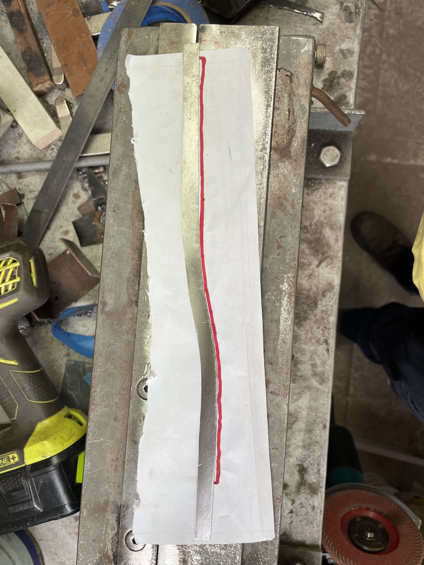

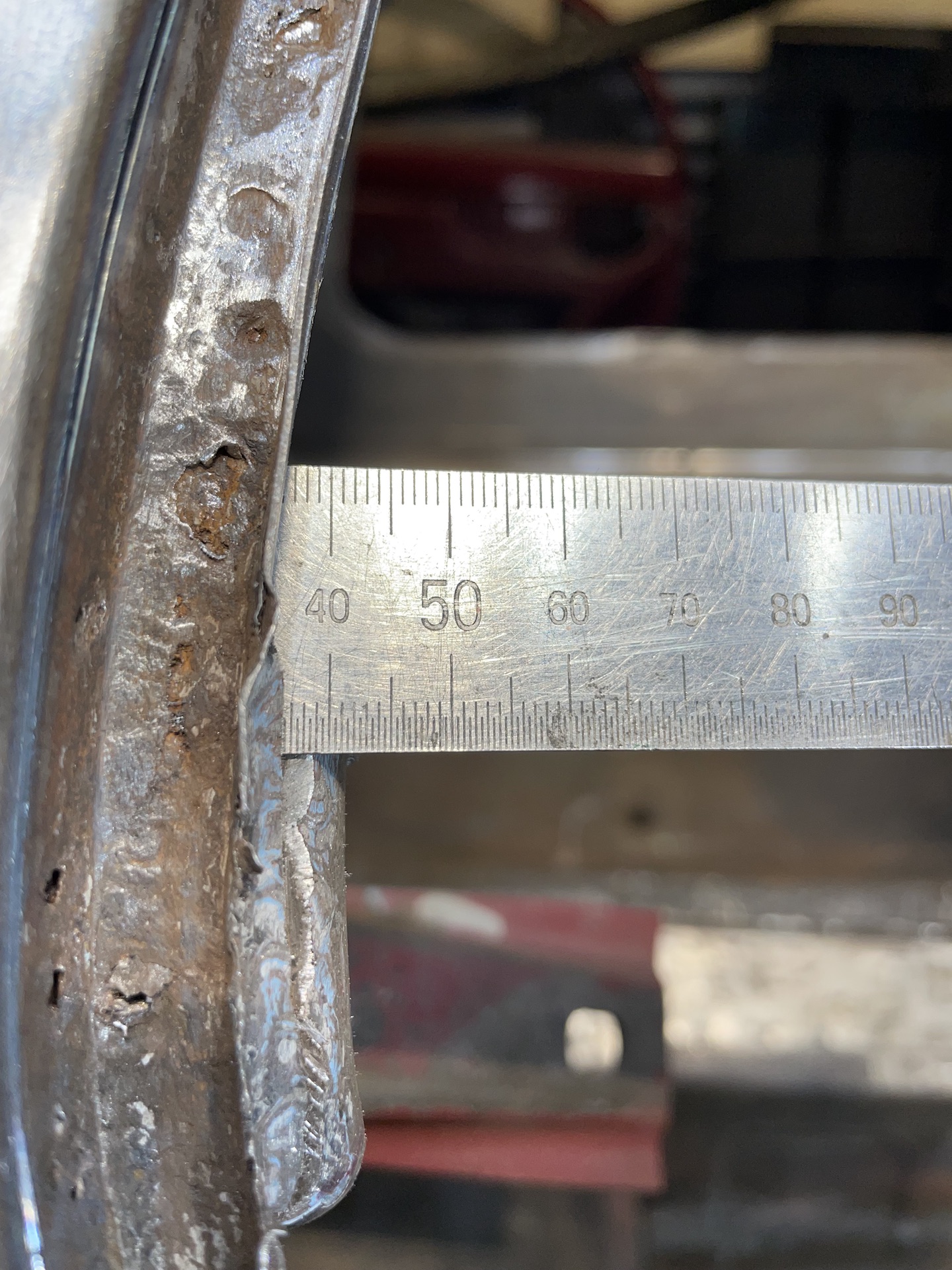

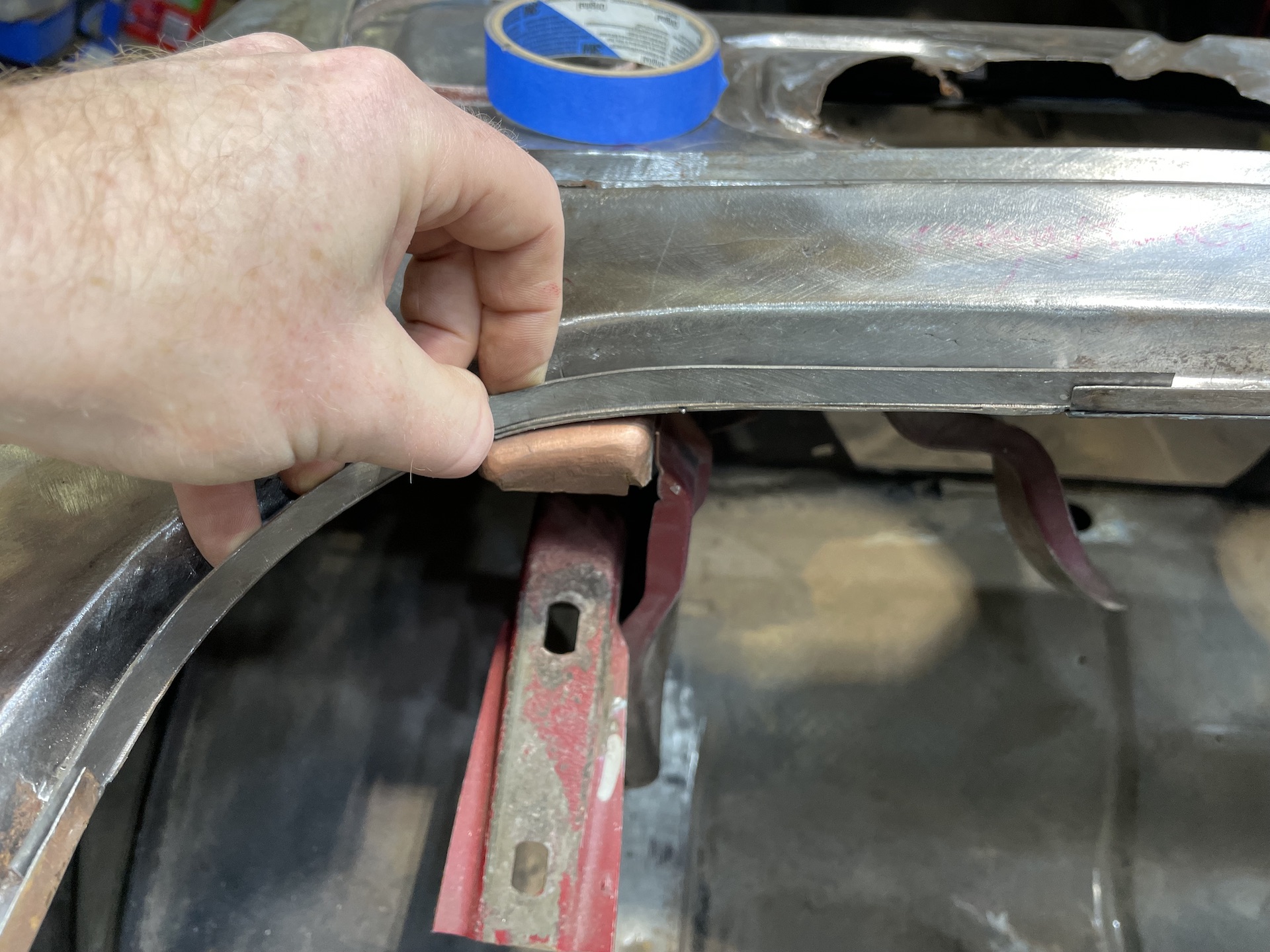

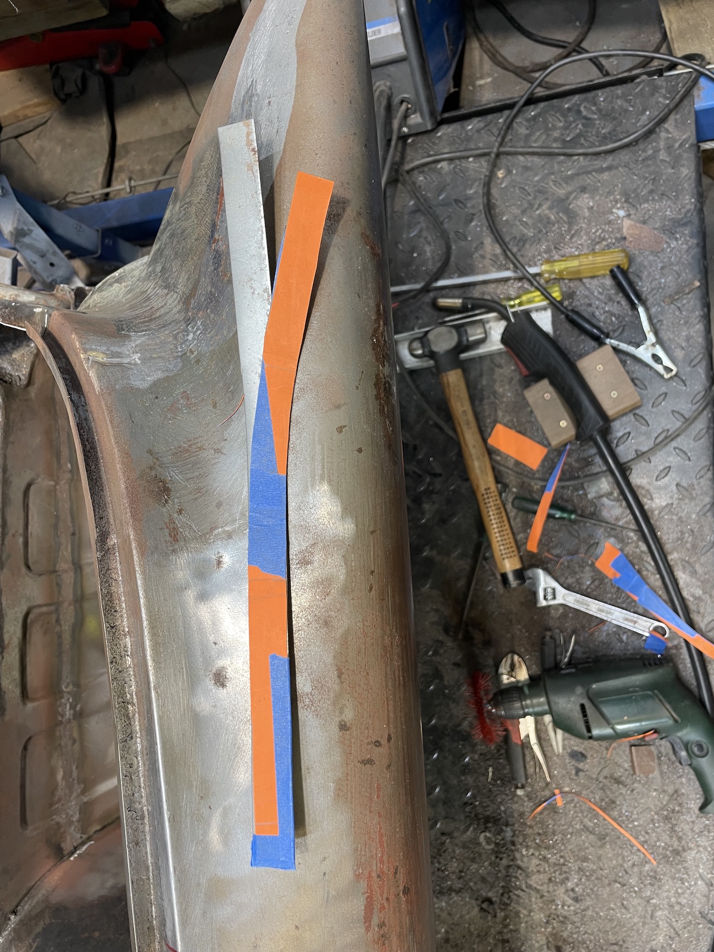

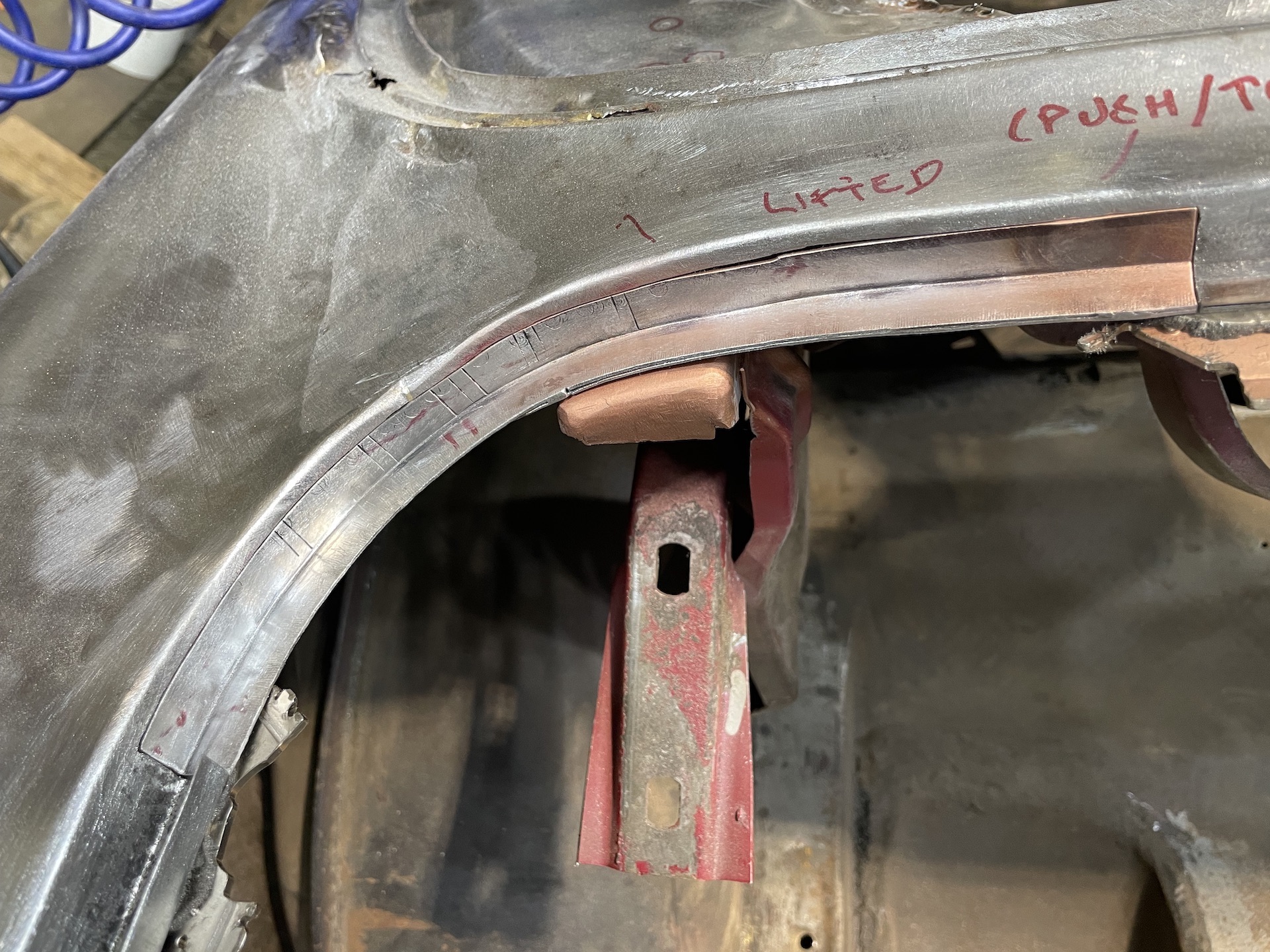

To make the front edge I did a rubbing of the edge on paper with a dirty finger then transferred it to a bit of metal. It was not even close - way too much curve but was a starting point I guess.

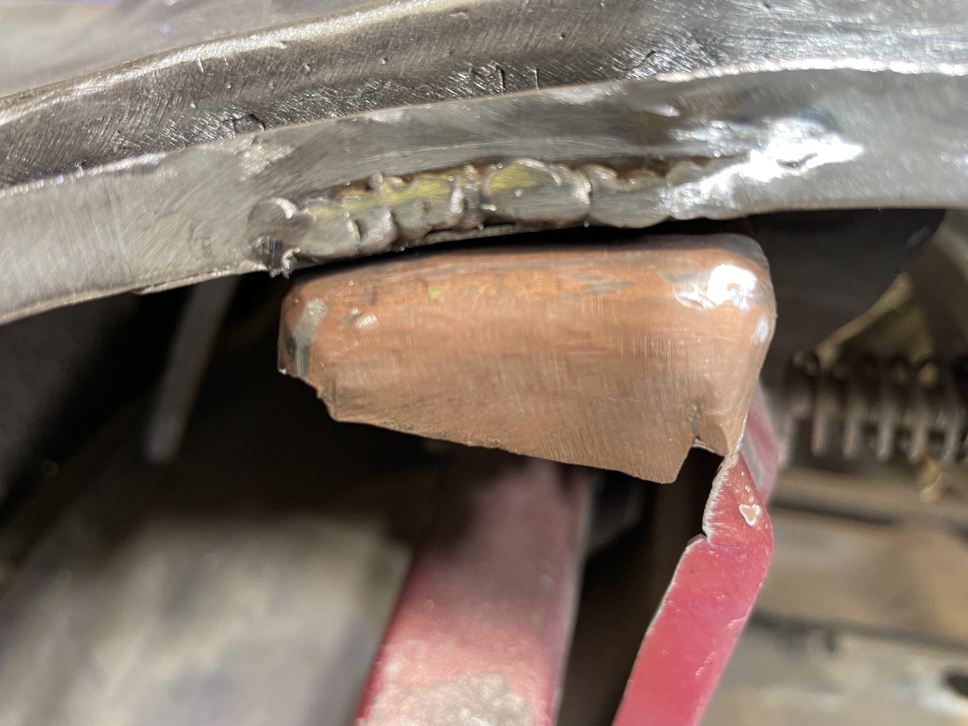

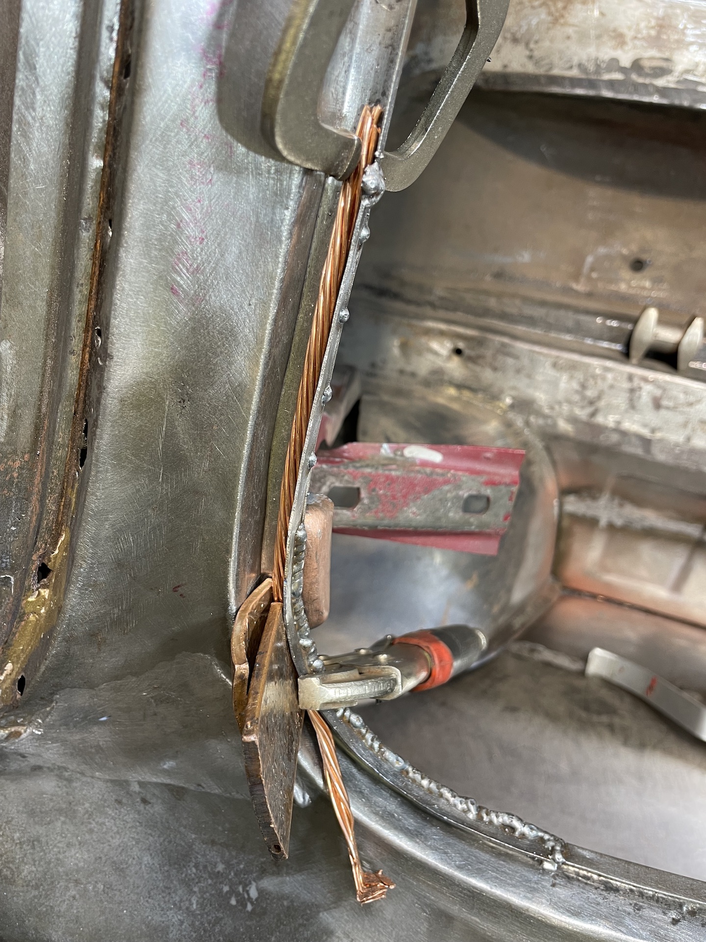

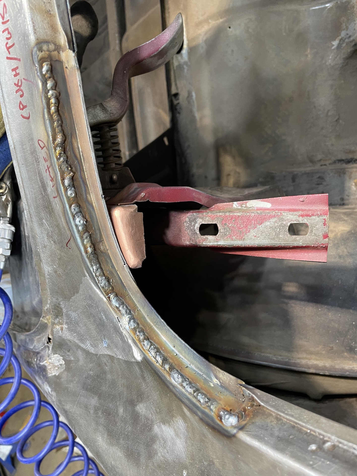

Tacked in with my custom copper heat sink helping to pull the heat away and prevent any blow throughs.
Almost done. Using a bit of 10mm square rod ground down to 9mm as a guide to level off the inner lip. Can't get round the corner so I'll do that by hand.
And I have left this for now - suggestions welcome. To weld or not to weld?

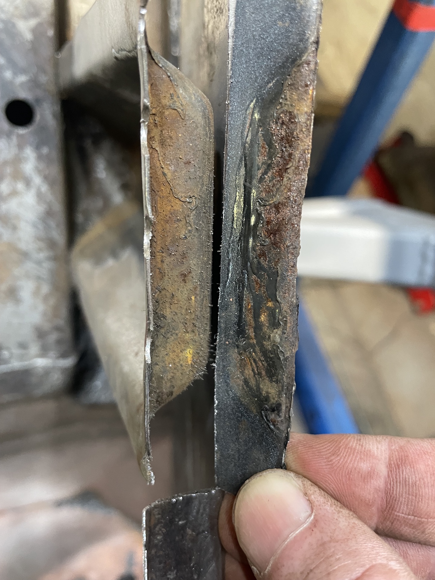

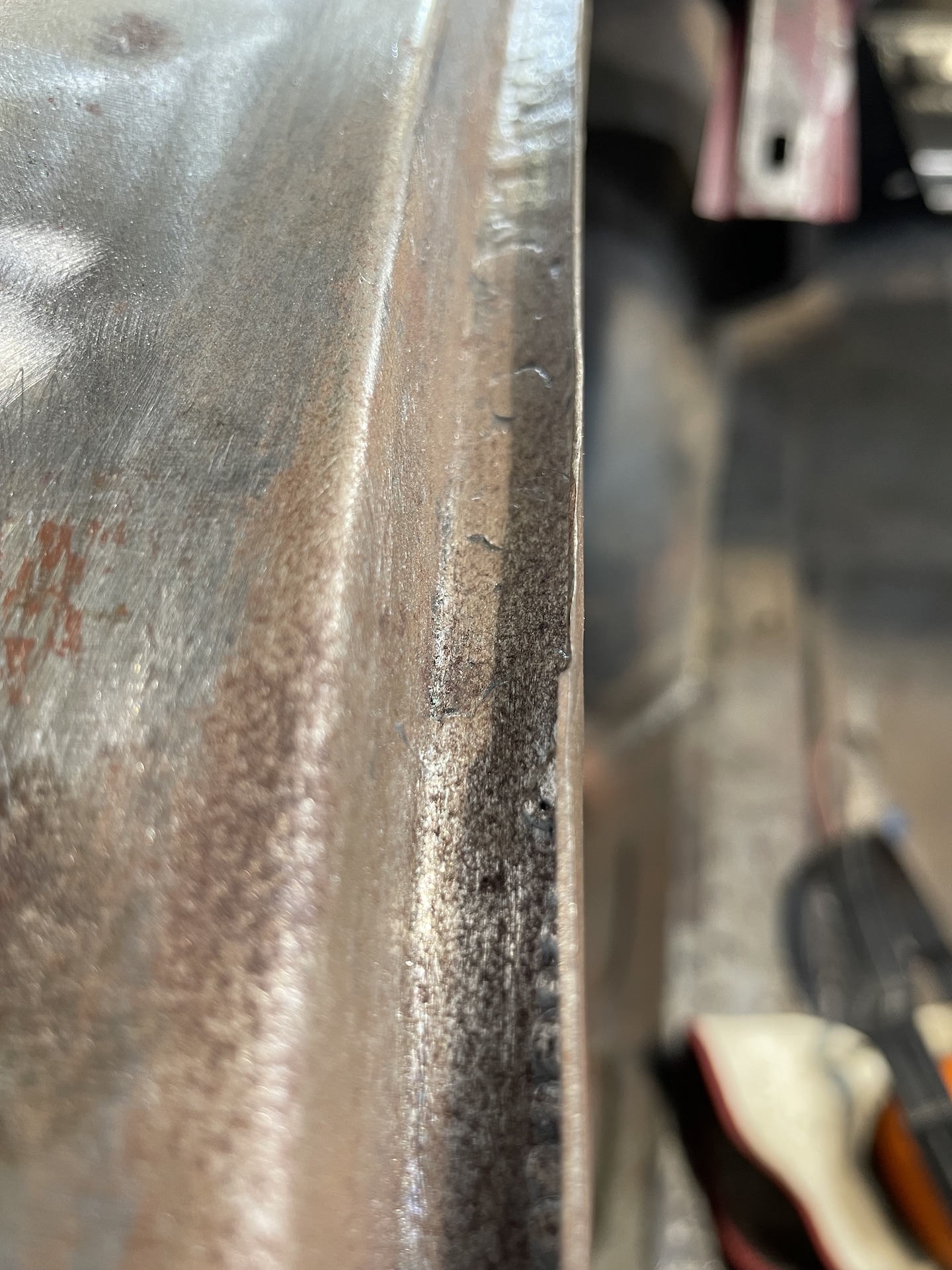

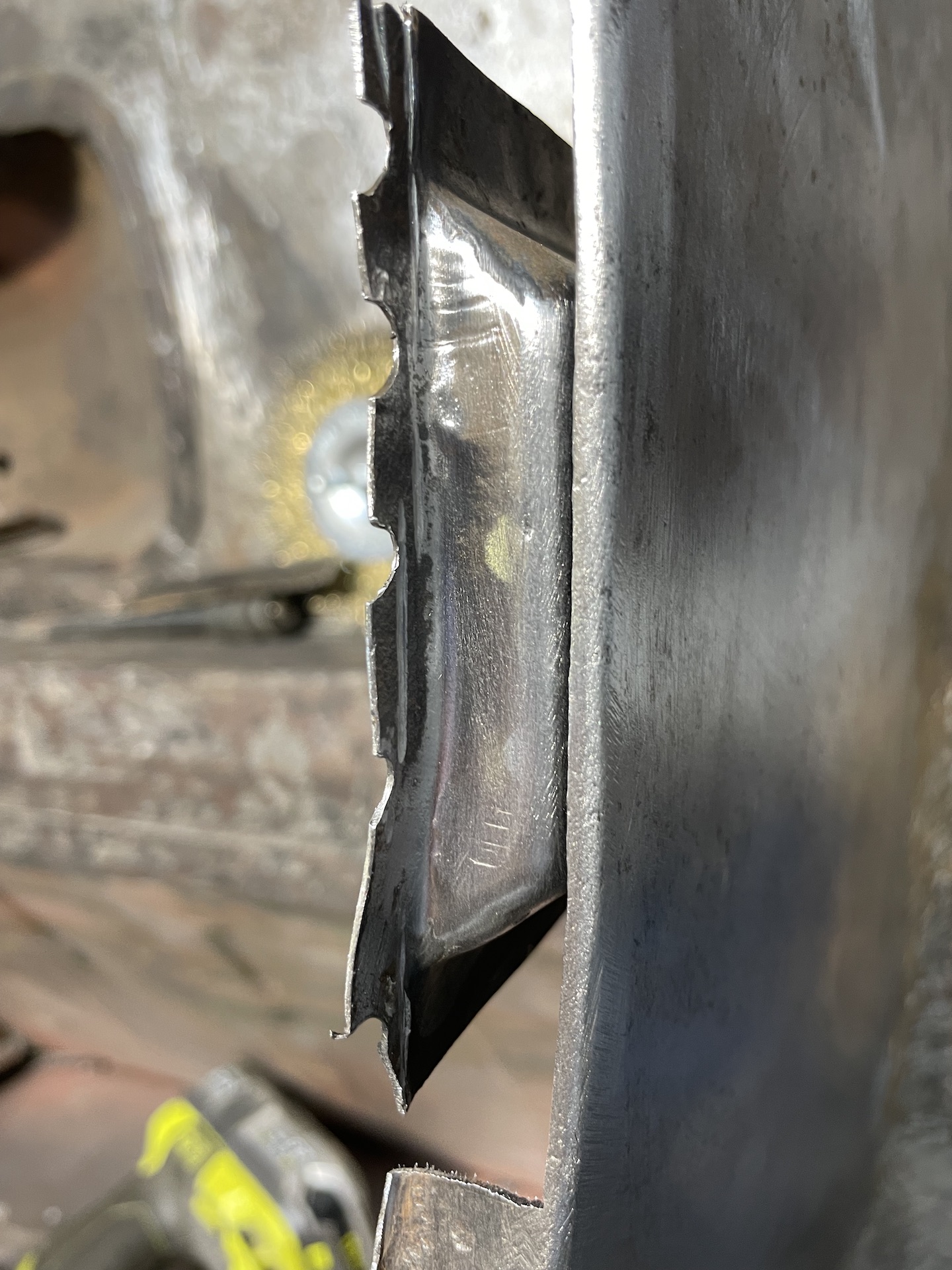

First off, after all the work that went into the corner section, I decided to have a go with a die grinder/powerfile/wire brush to remove the rust from a 'good' section, and fill it with weld with the MIG and grind flush. Think I spent twice as long to end up with something that is a bit shit. The original metal is also now really thin. You can see the join to a newer section 2/3 down the outer lip, which has already gone rusty. Going to cut it out and replace at some point. So todays adventure is removing the lip around the bottom support bracket, which is pretty eaten away around the spot welds. Figured this area might be of interest to some. As I am replacing the boot lip, I just drilled out the spots. Cut the top and side off the lip, leaving the base as a guide, run the wire wheel over it. I was hoping to just replace the top and side, thinking that the bottom was just be lightly pitted, but the wheel kept removing, and the surface of the bottom near the vertical brace was lumpy.

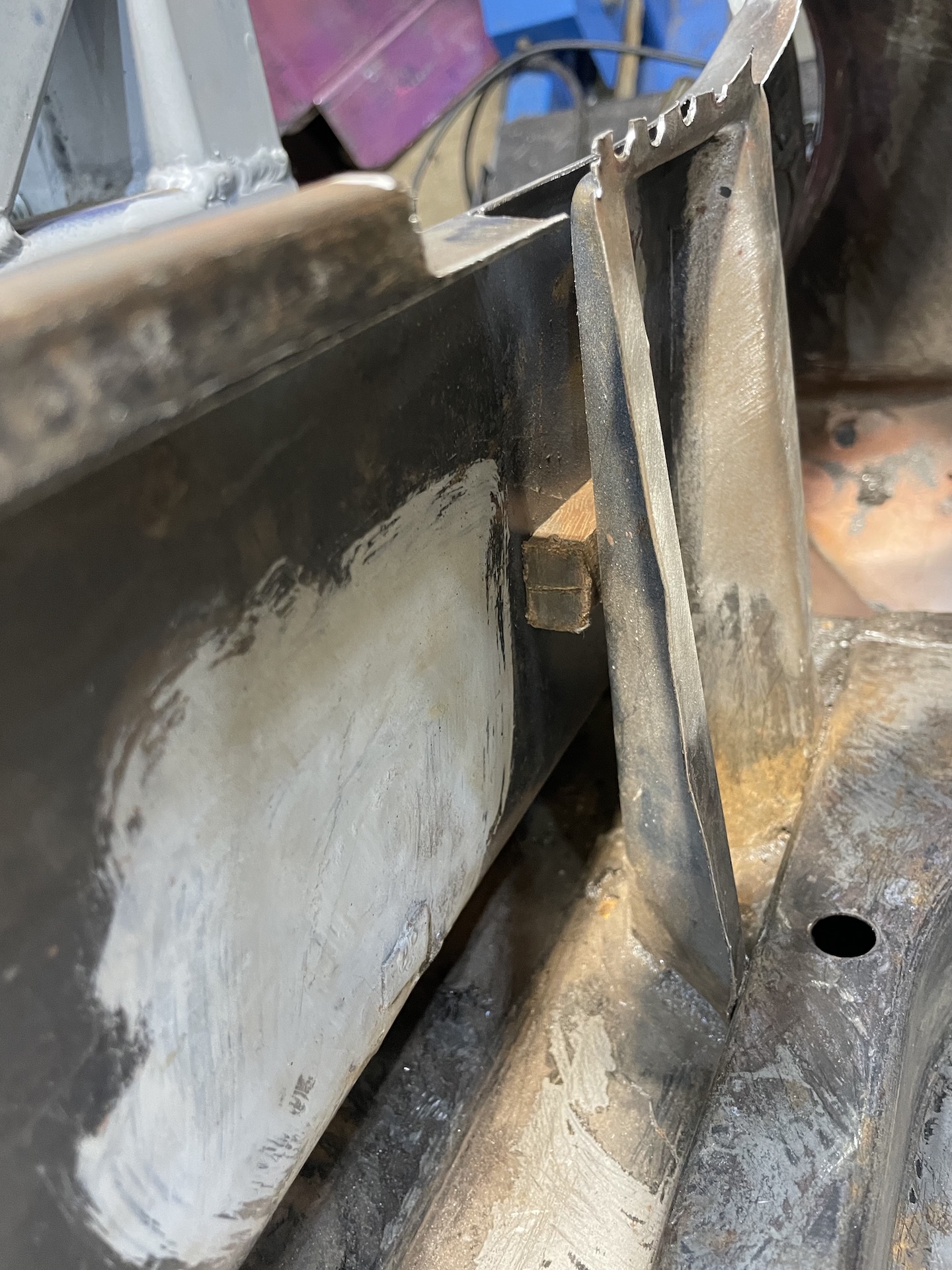

So off it comes. A bit of rust on the bottom, but none on the brace. Wire wheeled and ready to prime and weld. Jammed a bit of wood between the brace and the panel to keep the distance right.

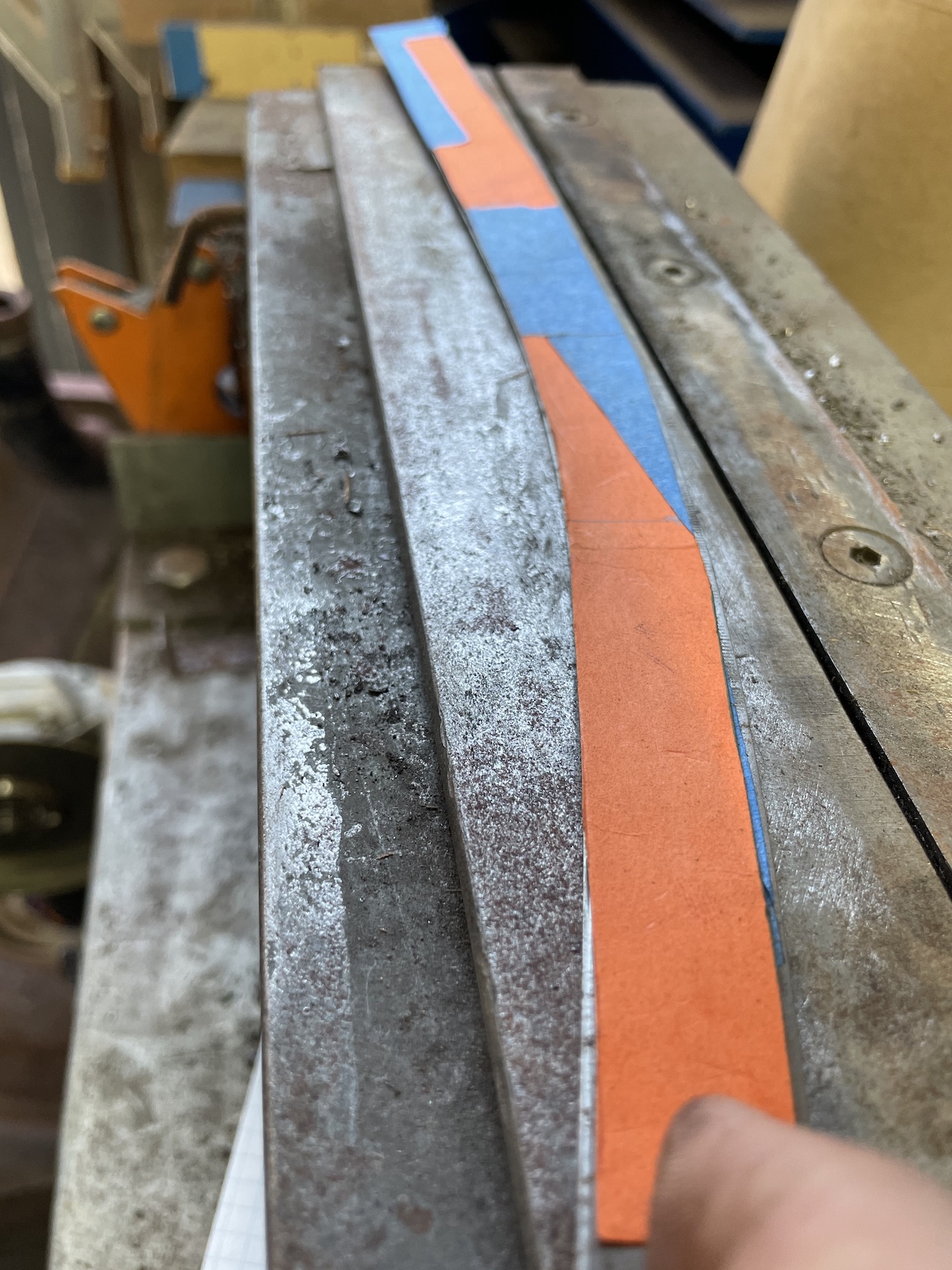

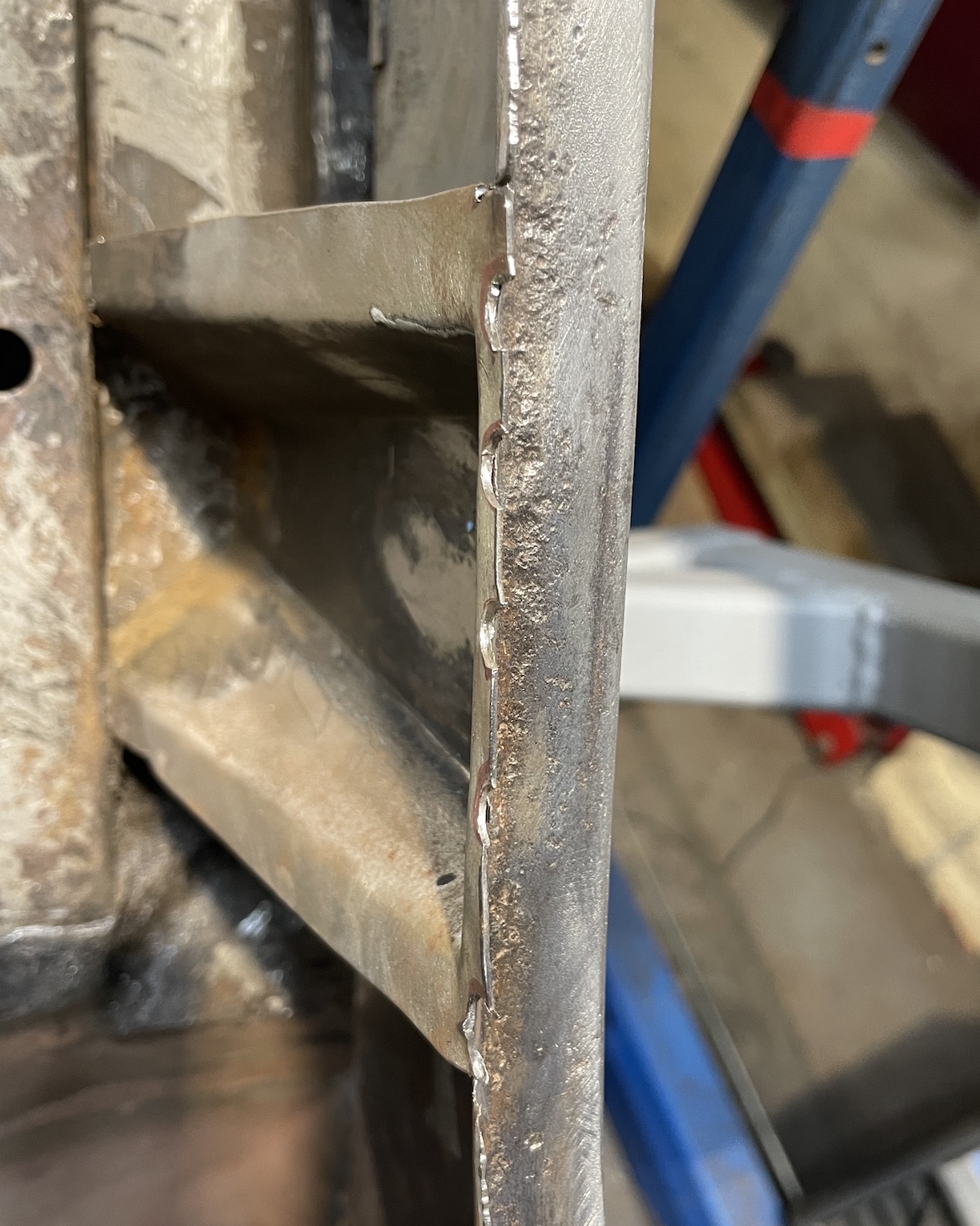

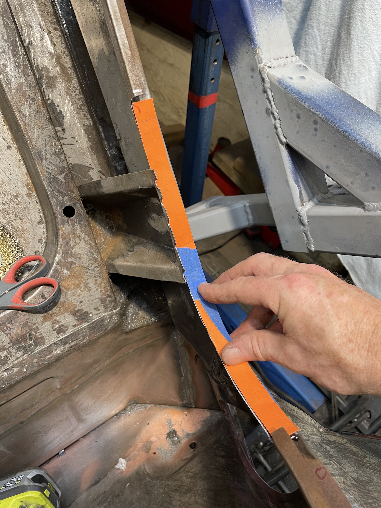

Out with the orange paper to get the profile of the bottom
Could have cut the metal to this shape, but easier and more efficient to form a straight piece.
Well easier if you have a shrinker/stretcher! I stretched this - I guess I should have shrunk as I would end up with slightly thicker than thinner material.
3 passes through and happy with the result.

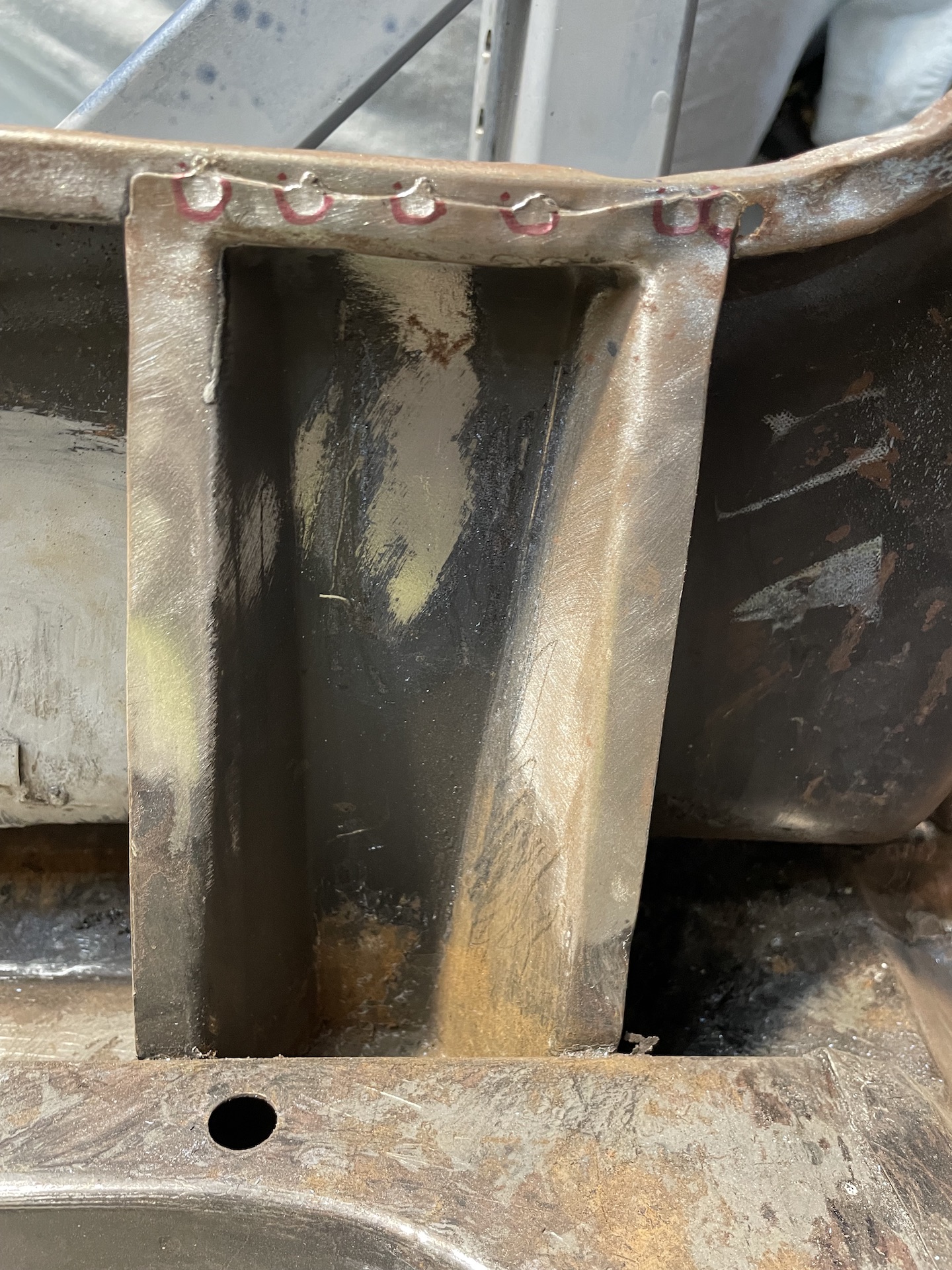

Bent and twisted to match the curve of the boot by hand, and got this. Outer edge is good to scribe and weld in.
The heat got the better of me, but the plan is to use the existing base as a guide and finesse the inner curve. I have already made rest of this section, but didn't take any pics. Same process as before
