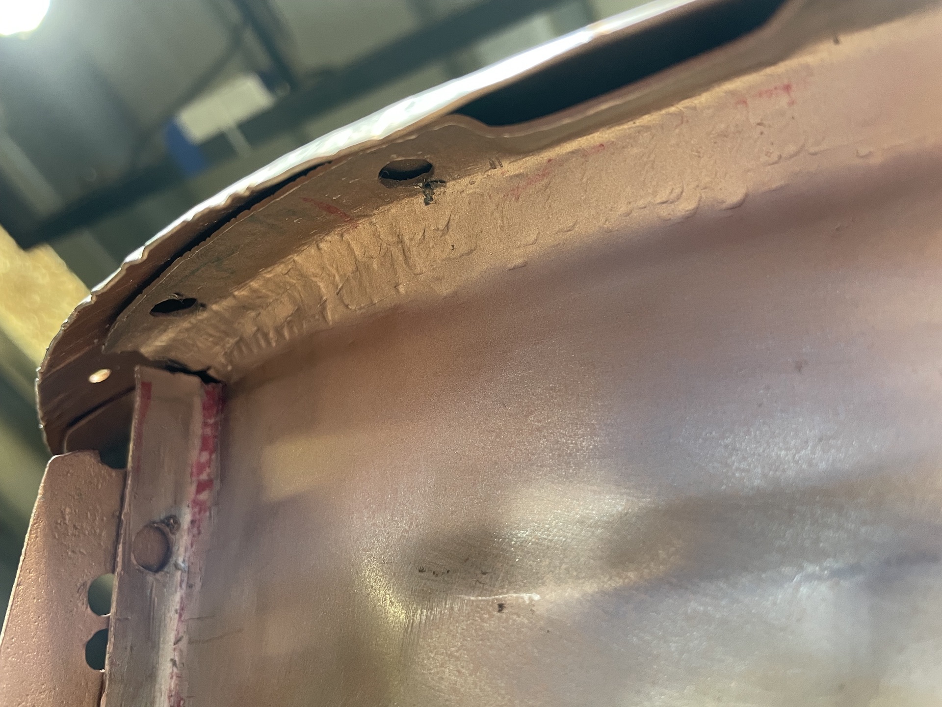

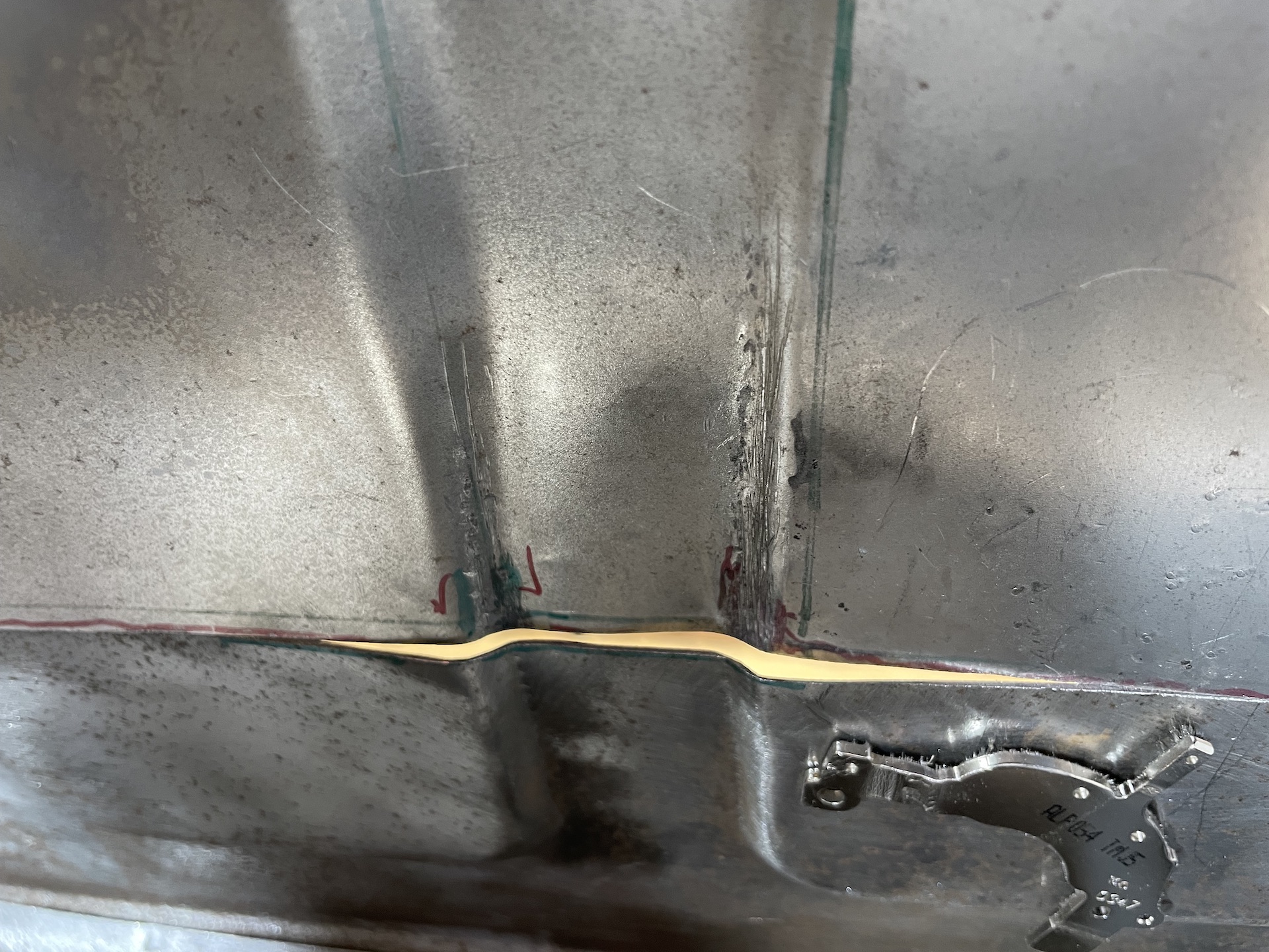

Start final fit of inner quarter
Got some fitting issues where the rectangles meet.
Think I had this panel off and on at least 30 times, tweaking the original and the replacement to get everything to line up. 2 sessions later, primed and ready to weld.
Tacking and tweaking the fit
Scott

Dress the tacks down and did the plug welds onto the outer panel
Some time, and a lot of wire later. As you can see I got a little trigger happy and seam welded the inner to the outer. Also found some more pin holes in the butt join of the outer to the original.
Walked away, job done (apart from the hours of grinding).
Come back and realise I missed this join between the inner wheel arch repair, and the inner/outer rear quarter.
Walk away again.
A week later, much mucking around to fill in something less than the size of a 20 piece.
No pics of the finished weld here, but there were lots of grinds back through to nothing and weld landing in the wrong spot. Got there in the end.
