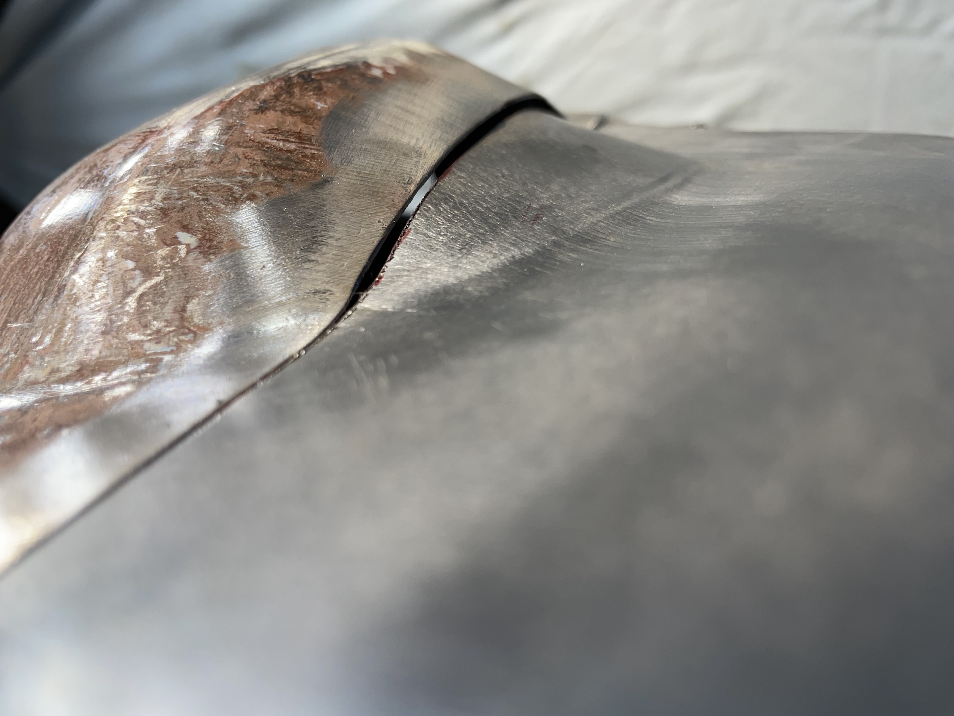

Could be accused for oversharing with the photos. But here goes anyway.
Final fit up and scribing before cutting. Still a bit of work needed on the inner but fitting the outer first.
My wood block profile is not as close as hoped. Will need a bit of work to find some common ground. Never going to see it anyway.
Outer profile is pretty close though. Just a few bends here and there with a screw driver should line them up.
Checking to see how close the profile of the curve sits against the original panel. Found that if I put a small amount of pressure behind the two panels they line up.
