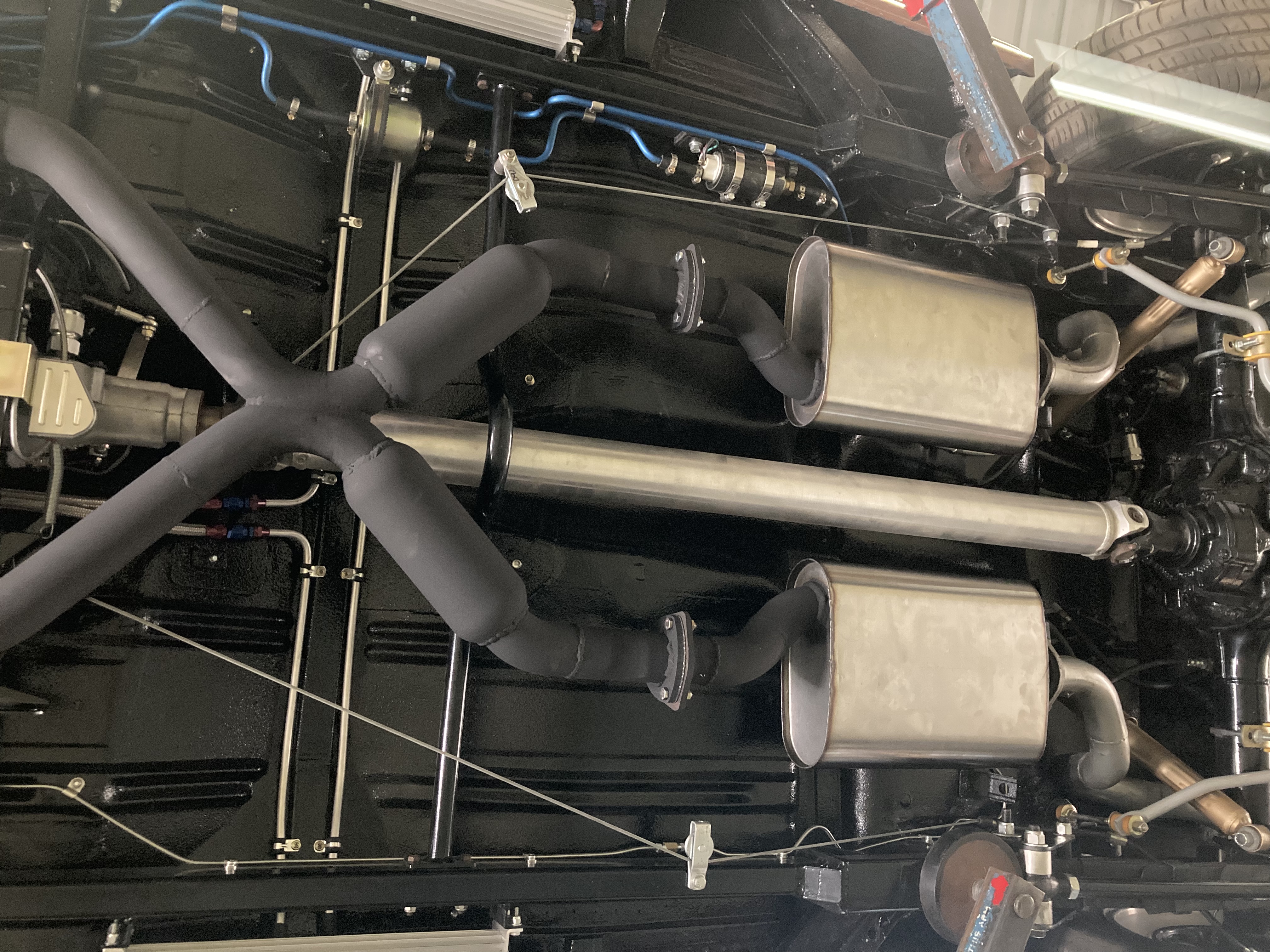

New triple flow mufflers and resonators in, I wish I had a db meter as the phone one is not accurate.

I just love these pics. You are the neatest engineer on the forum. An absolute credit to you and your skills.
Posts: 11669
Re: Chev EK
Neat and functional as ever. Sorry I will have to wait until the Not The Vic Nats next year to see it by the looks, but it will be worth the wait Greg.
