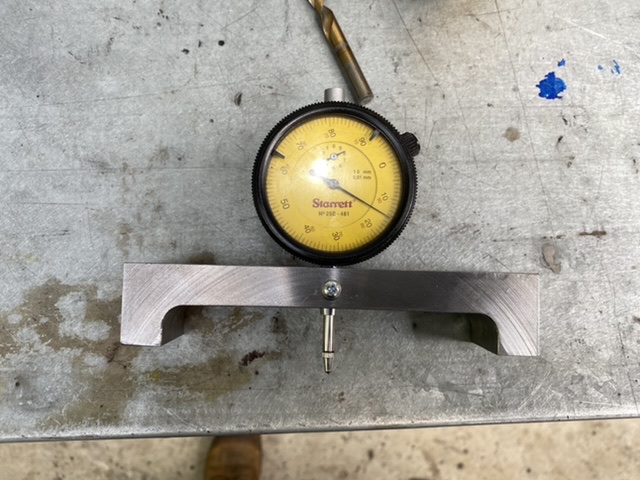

Deck bridge is made, now to get some real measurements on what’s happening with the piston heights

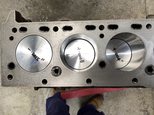

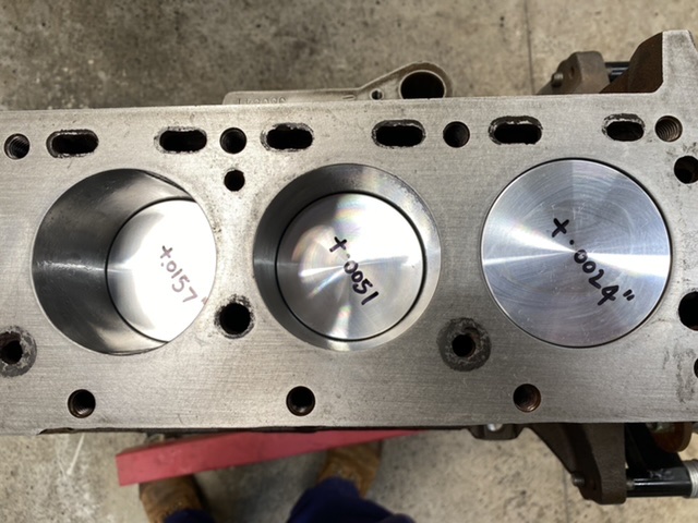

So I have measured the piston protrusion in relation to deck height…
#1 -001” (below deck)
#2 +001”
#3 +.004”
#4 +.015” *** this is the concerning cylinder
#5 +005
#6 +.002
I spoke with Southcotts and they said the crank will be fine, grinding a crank .010 won’t throw the stroke out on 1 cylinder.
In regards to the rods, it’s highly likely this rods was like this from factory as they were a matching set.
He told me to CC the head and if there is a combustion chamber larger than the rest I should put the long rod in that cylinder to bring the compression in that cylinder up.
He also said with a .060 head gasket I have nothing to worry about.
So I’ll do some further investigations and make a decision on what I’ll do next.
Hope to keep it all a simple as possible, not forgotting is is just a dirty old grey motor at the end of the day

So I have read this in detail and to be honest it is all a pain in the neck to get right especially when you have to rely on others to do work.
I would do the following.
Measure all piston gudgeons to top to make sure they are equal.
Measure all conrods big end to small end.
With your crank in measure each journal at top dead centre with your deck gauge.
You will have all the information then and how to overcome it.
Crank, because it has been machined undersize it is possible that it’s offset ground. That’s a problem.
Conrods, pick the ones that are equal then get some more and have the closed and honed to match the others.
Pistons, I find it hard to believe they could be different but you never know ! Machining the tops is one way around it but they will have to be rebalanced of course.
Ultimately if it was slapped together with all different measurements it would still go fine and you probably wouldn’t notice the difference !
Welcome Drew to the world of blueprinting !!!
Re: FB Standard Wagon
Good advice on matching the higher crown to larger CC, but as Greg says good to know where the problem is. Big end journals ground -0.01" I would think it possible to be the issue but money on the rods.

However I regards to the crank being offset on the 1 journal I don’t think that is the case.
#3 and # 4 would have been ground on the same set up so if that theory was correct I’d expect #3 to have the same offset.
It’s definitely in the rod, which I haven’t measured as yet.
I think I’ll fly cut the piston and balance them at home on my kitchen scales
