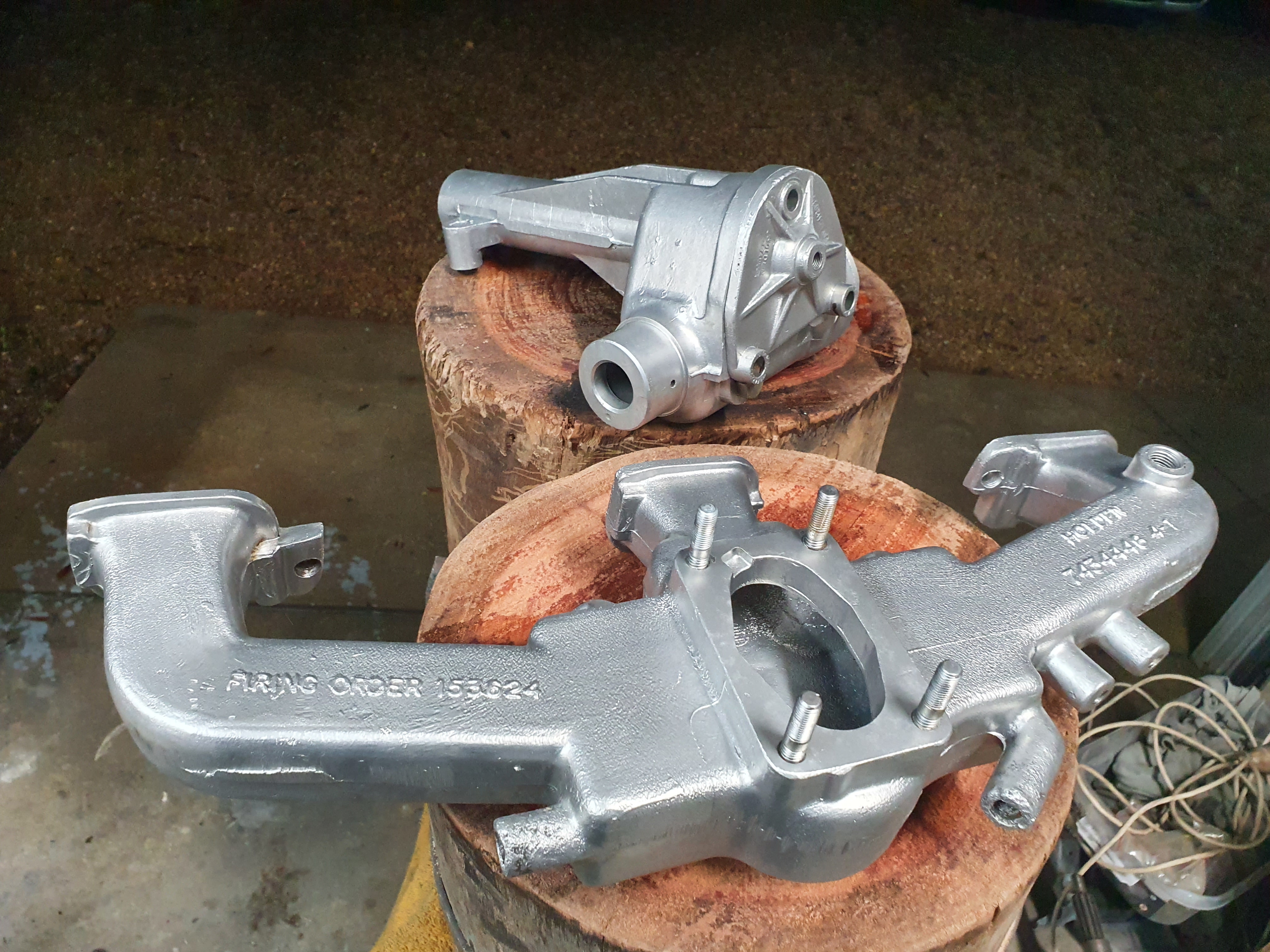

Got some vapour blasting done this week. Clay you might recognise something here...
- 20220513_185722.jpg (2.86 MiB) Viewed 1468 times

Tidy job on the mani. I prefer to run through the cab. A firewall union thing in the corner of floor hump and lower firewall adjacent starter motor then earth starter gearbox bolt to inner subframe bolt. Then maybe an isolation switch somewhere in the cabin. Use big fat cable to zvoid voktage drop. Adds some weight to the car but you get improved handling the further back you mount the battery. Telling you how to suck eggs no doubt.
