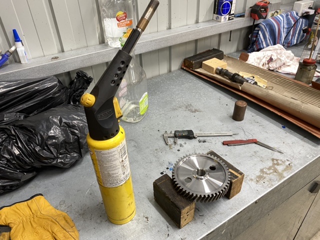

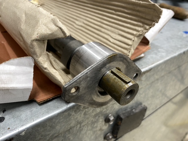

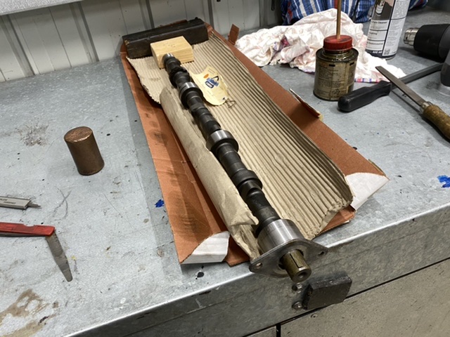

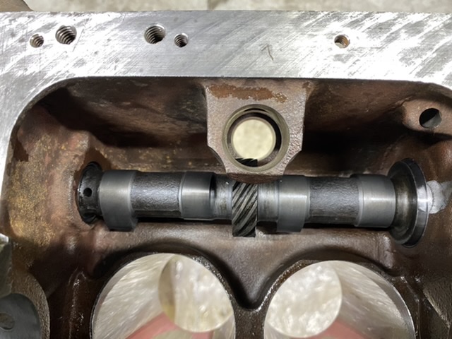

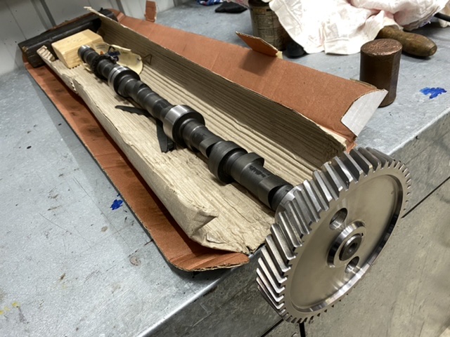

And the last job for the day was to fit the timing gear to the cam.
Fitted the retaining plate and the woodruff key, antiseize on the shaft.
Heated up the gear and slipped it onto the cam, a slight few knocks with the copper dolly into position with .006” clearance between the retainer plate and the timing gear.

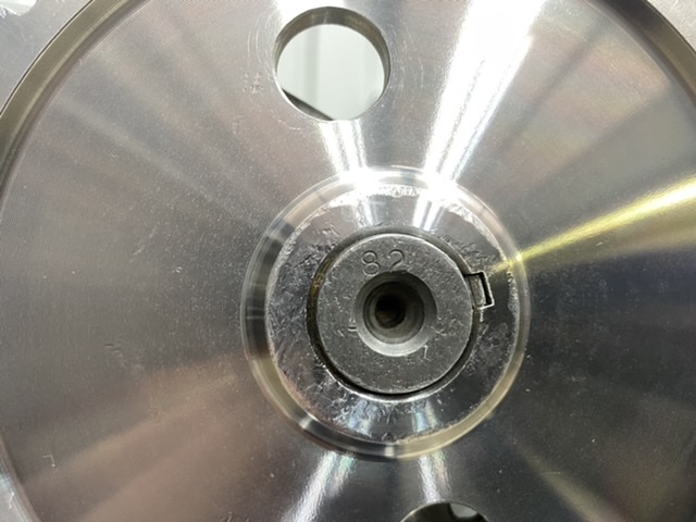

Even noticed the nice ‘82’ on the end of the cam!

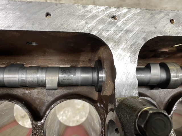

I dummy fitted the cam and it made me gasp when I seen all of the cam lobes didn’t line up with the lifter holes but I figure that is how the lifters get their spin?
However the dizzy drive is offset from the dizzy hole too…
Does this all look correct?
It has to be correct as I can’t see it working any other way.
Drew

Drew,
"I dummy fitted the cam and it made me gasp when I seen all of the cam lobes didn’t line up with the lifter holes but I figure that is how the lifters get their spin?
Does this all look correct?"

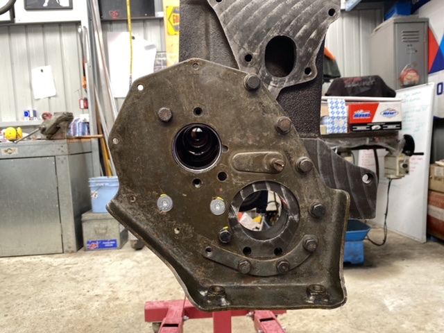

Uh-uh. You forgot the front engine mount plate. That's why the camshaft sits about 5 mm too far rearwards.

ardiesse wrote: Thu May 05, 2022 9:46 pm Drew,
Ahh of course Rob! Haha im a rookie!
Well that explains that little question, totally makes sense 🤣🤣
I’ll dummy the front plate up and do another trial fit tomorrow
Drew

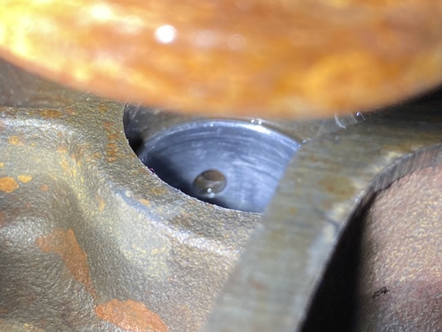

The rear cam bearing only has about a 35% hole alignment for the oil to flow from the oil gallery to the cam journal.
What is your opinion on this?
Drew

Rear Cam Bearing: It's misaligned. Your view is from the rear of the block, isn't it? That view suggests it needs to go in further, but your camshaft photo suggests that it's been pressed in too far. At first guess, I'd say flush with the front of the bore would be the right place. Check the dimensions on your other J-block, and from the next trial-fit of the camshaft. Do you have the special, shallow welch plug for the camshaft bore? If not, you can put the lathe to use again.
While you're at it, I'd suggest checking the no.3 cam bearing to make sure the two oil holes are aligned, otherwise you won't get any oil flow up to the rocker gear.

ardiesse wrote: Thu May 05, 2022 10:36 pm Rear Cam Bearing: I think it hasn't been pressed in far enough. Your view is from the rear of the block, isn't it? Check the dimensions on your other J-block, and from the next trial-fit of the camshaft. Do you have the special, shallow welch plug for the camshaft bore? If not, you can put the lathe to use again.
That photo was taken from the back of the block through where the welsh plug will be.
Looking from the front the bearing is pressed into the block neatly. Lineal position of the bearing is fine is more the question about the oil gallery alignment.
Yes I will check the other cam bearings.
Drew

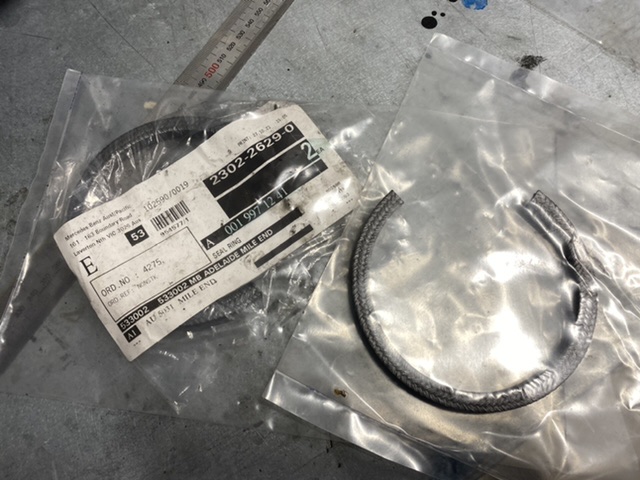

Yes the RMS in the gasket kit is just rubbish, I don’t know how they still even sell them.

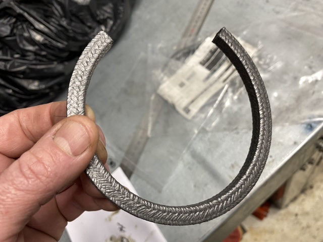

However I have met a fella here in Adelaide who said a few of his mate race grey motors and the use a Mercedes Benz RMS in the their greys, so I went ahead and grabbed a couple to try out.
They are a hard rope type seal with a coated silver frosting.
Measure 8.1mm wide x 8.8mm high
Aka .320” x .346” … no idea what it equates to in fractions.
Drew

Somewhere on this forum (or maybe FE-FC) I have the dimensions of the grey motor seal groove. But it's easier to find an old rear main cap with seal in place and measure it -
Base of groove: about 6.5 mm wide
Top of groove: about 9.3 mm wide
Seal depth (installed): about 8.2 mm
Seal cross-section is 8.2x(6.5+9.3)/2 sq.mm, close enough to 64.0 mm^2. The Merc seal is 8.1x8.8, about 65 mm^2. Looking at my old rear main cap, the OEM Holden seal spreads out to nearly 13 mm wide in the gap between the main bearing cap and the crankshaft. You'd need to taper the cross-section of the Merc seal (softwood and a hammer?) before installing it.
It would be a real achievement if the Merc seal's length was a complete circumference of the Holden crankshaft, and you could fit it in one piece, with the join at the "bottom" of the tunnel in the block. But the more I think about it, the less possible it looks.
P.S. - your rear cam bearing will still let enough oil through to lubricate properly.

Cheers Rob, yes I will work the RMS very patiently and take my time, I have it on good work that they work well so I am happy to take the gamble.
Thanks for the opinion on the rear cam oil hole - all good too!
Front engine plate has had the ‘knock around’ as you suggested and I have it sitting tight around the oil feed area.
When I bolted it to the block before I could fit a feeler guage between the plate and block into the oil feed chamber, but not anymore, it’s nice and tight on the block.
