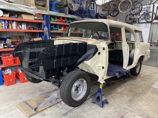

Re: FB Standard Wagon

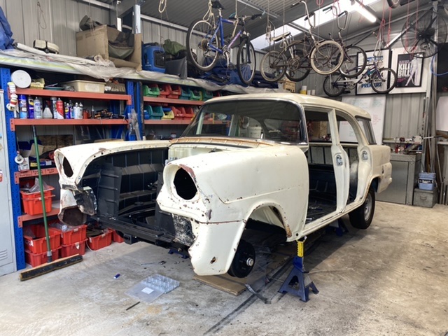

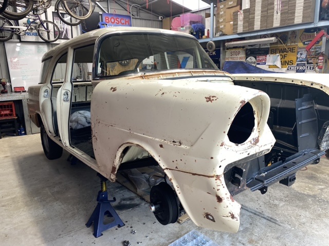

A few pics of where it’s at.

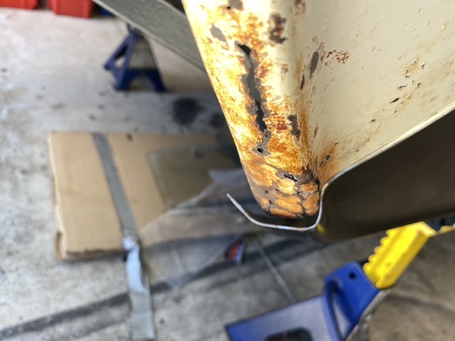

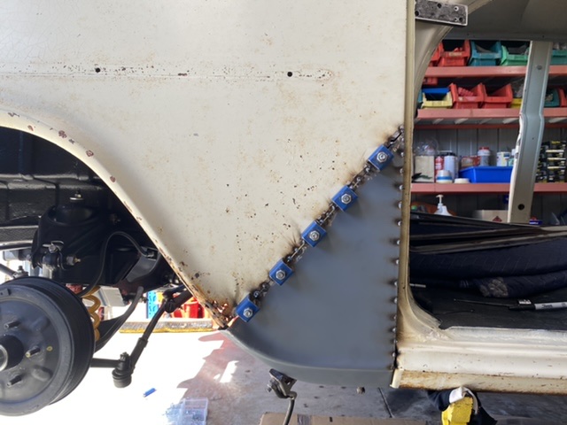

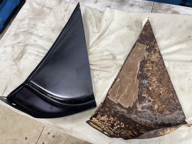

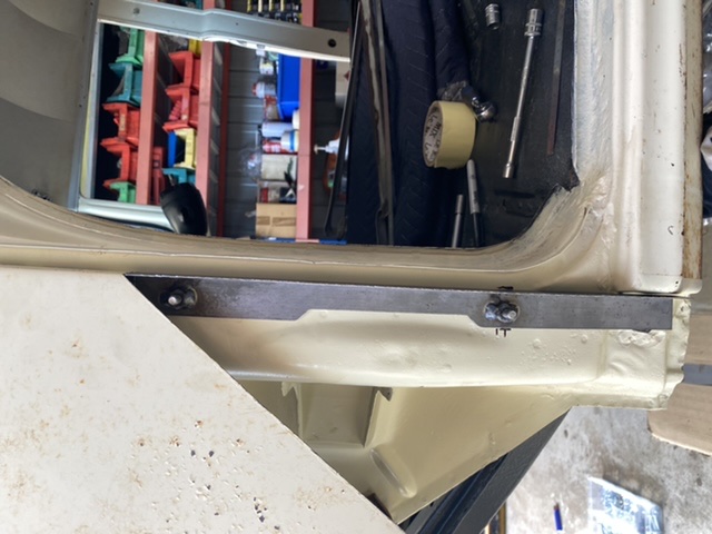

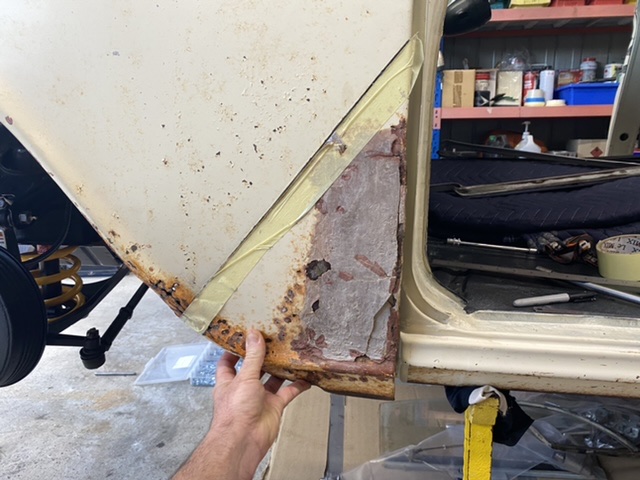

So the LGS guard had a bit of cancer down low so I’ll try to get that sorted today.
Cut the offending section out and a tricky bit will be to replicate the vertical mounting face on the A pillar.
So here we go.
So here we go.
As long as you do most of the welding with everything fitted up to the car it’s not too bad. Make sure the continuation of the sill profile lines up okay looking from the side.

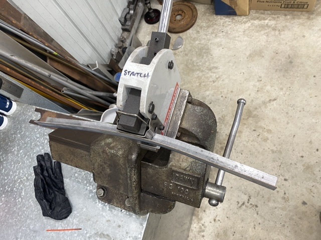

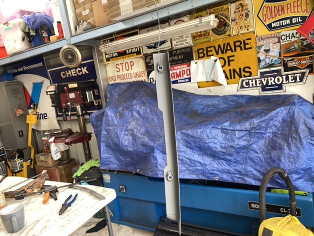

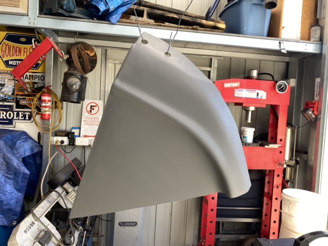

Quick stretch of some 1mm angle to the right profile

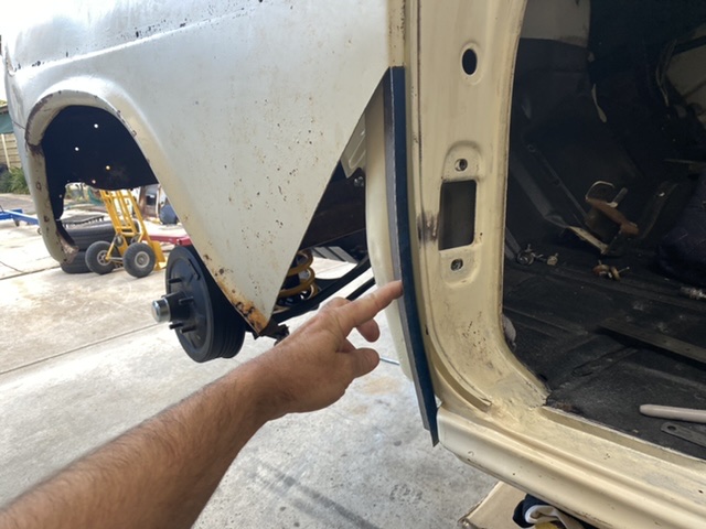

At least have got a good straight line to work on now.

That’s a good call Clay, yes I’ll be keeping an eye on it.Errol62 wrote: Mon Mar 14, 2022 8:49 am As long as you do most of the welding with everything fitted up to the car it’s not too bad. Make sure the continuation of the sill profile lines up okay looking from the side.
There is literally no way these patch panels can be welded straight on.

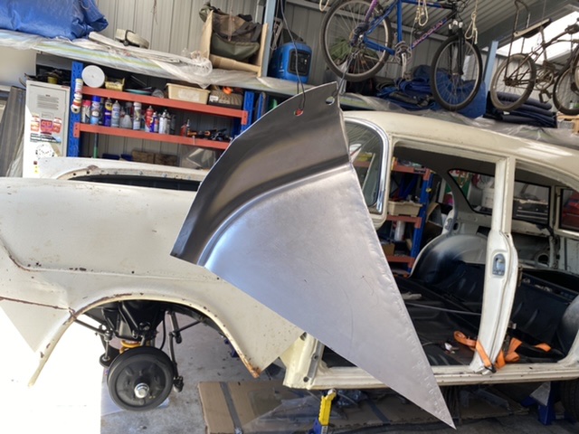

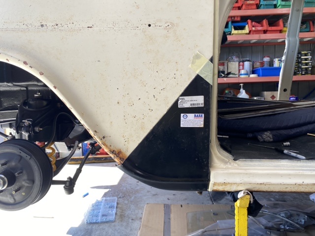

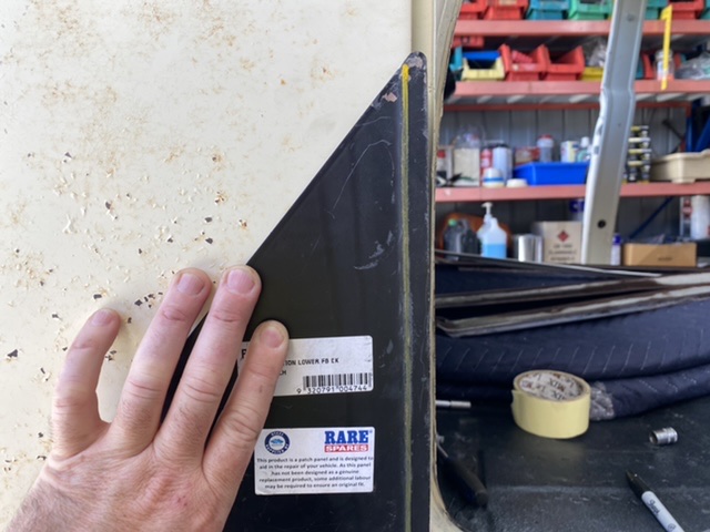

Getting there, got to love the basic profiles on these patch panels.
If you don’t love them you hate them!
You can see the yellow line was the original fold line, lucky it had the extra bit of material on the fold that I could flatten out to use.

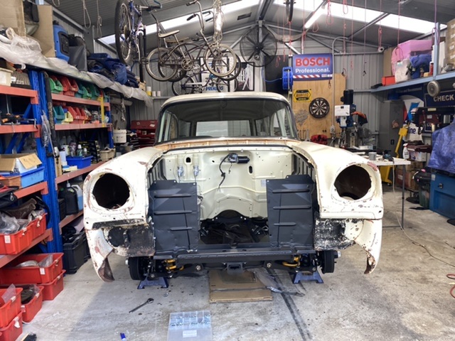

While the paint stripper was working I summoned the exorcist from her bedroom…
Seems when ever she is here my spirits disappear…
Got her to hold the front beaver panel, and hour of knocking around seen it slip into place which will have to be good enough for now.
I call it ASBESTOS… As best as it’s going to be for the moment.
With time tapping on my shoulder I still have an engine to build an and auto spark tard to do his job yet.
Nationals are still in the scope
