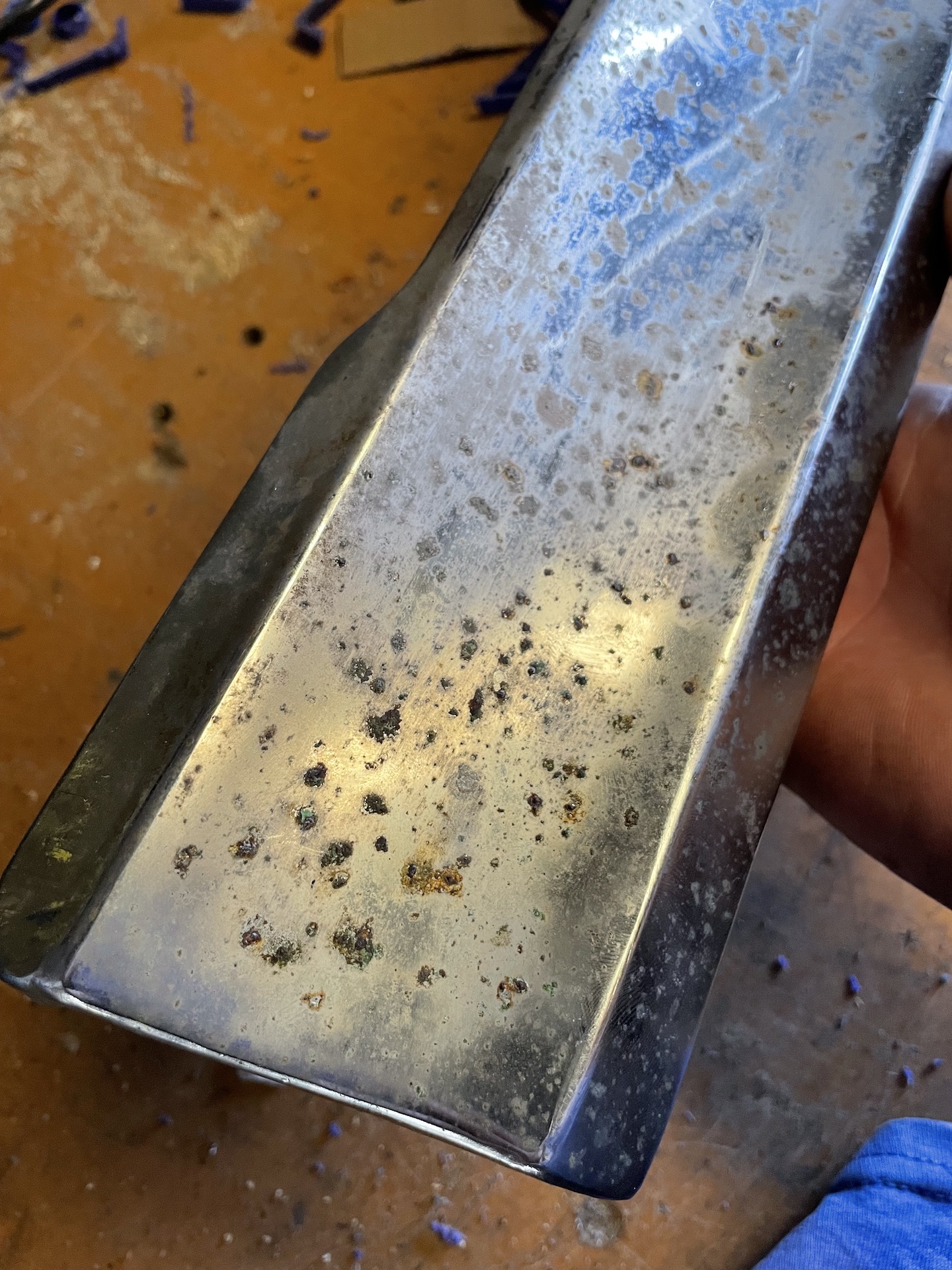

Been a while. Small update.

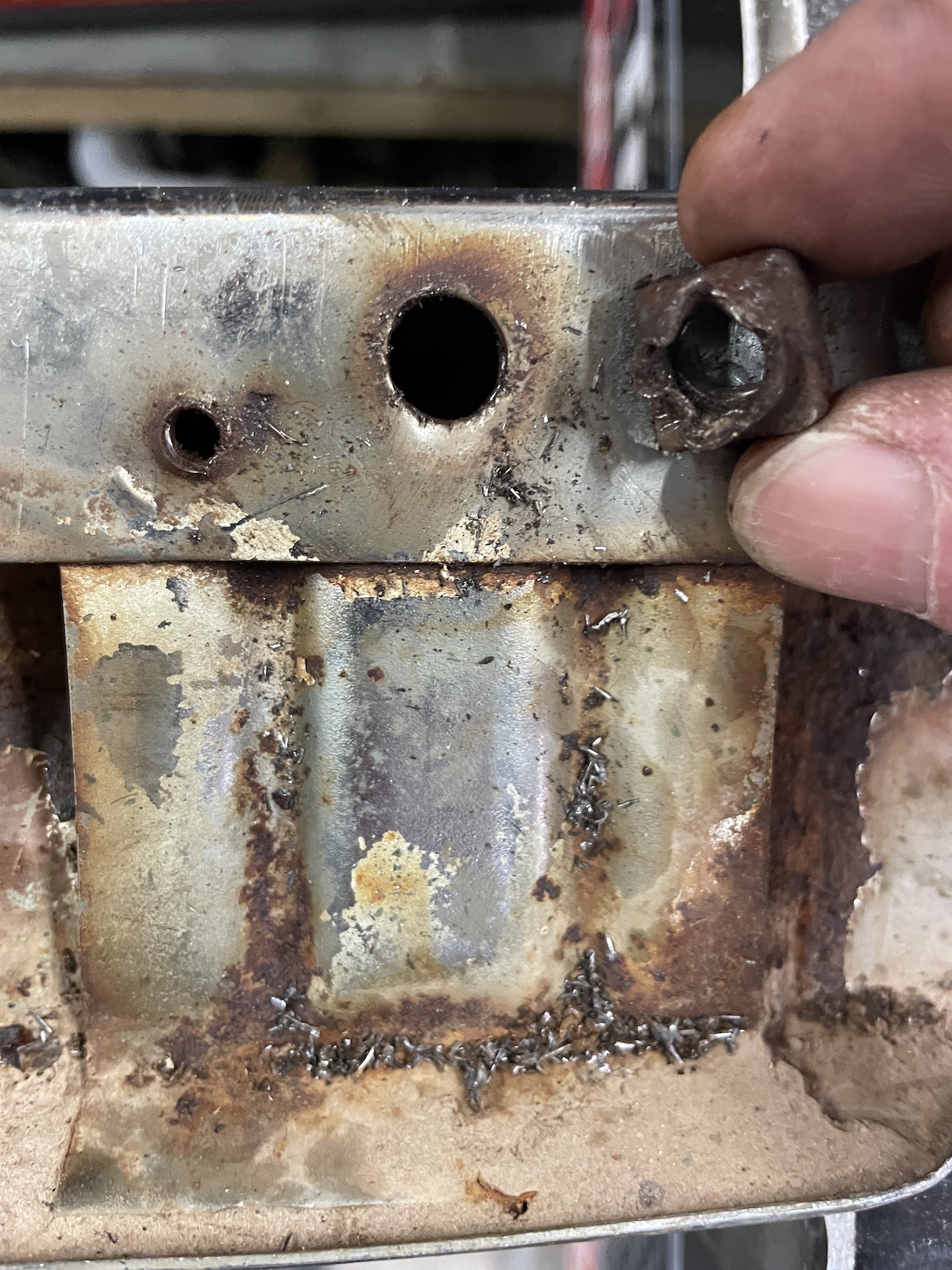

Got my bonnet bar and first impressions - meh
Was not a great picture so I asked the seller what the condition of the chrome was like. "A bit of pitting" was the replay. As mine is a holey mess I figured I'd take a chance knowing I would have to get it rechromed.
So expectation was not high and it has not failed to disappoint. First - unboxing. Loose rust was sliding around inside the box like sand. Looks like it has spent a fair bit of its life upside down in the weather.
Bolts in three nuts and the fourth sheard off and replaced with self tapper. Self tapper in the bin and a bit of drilling and brute force later.

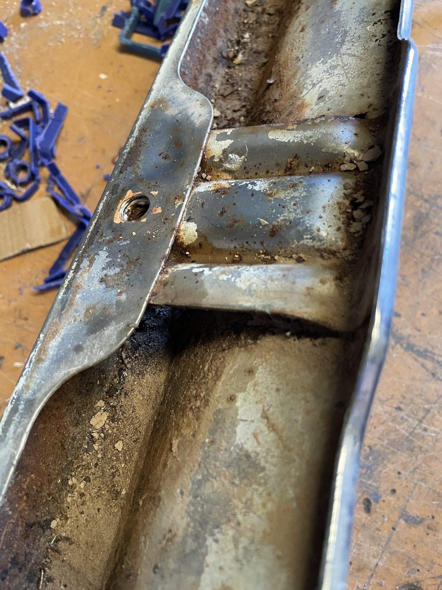

Time to do a bit of cleaning.

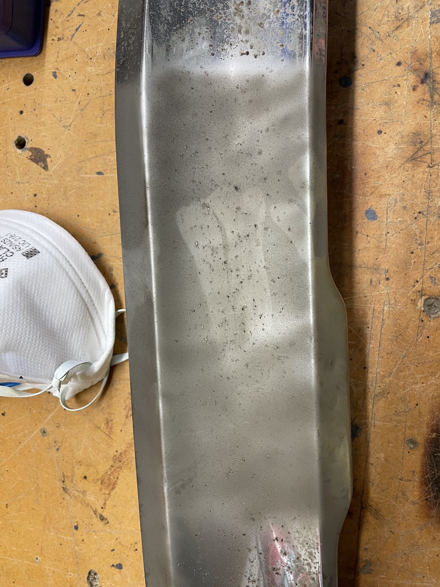

Phase one - wire brush
Does ok but never getting in to the nooks with this method.
So on to phase two. Sandblasting. Had to get my craft hat on to make it fit in my new supercheap cabinet.
Does a lot better but really hard to see what you are doing and the cabinet is tiny, so I now how a Trex must have felt. Those glove are close together! Note: shirt as light hood - can't even see in without it, its like a mirror.

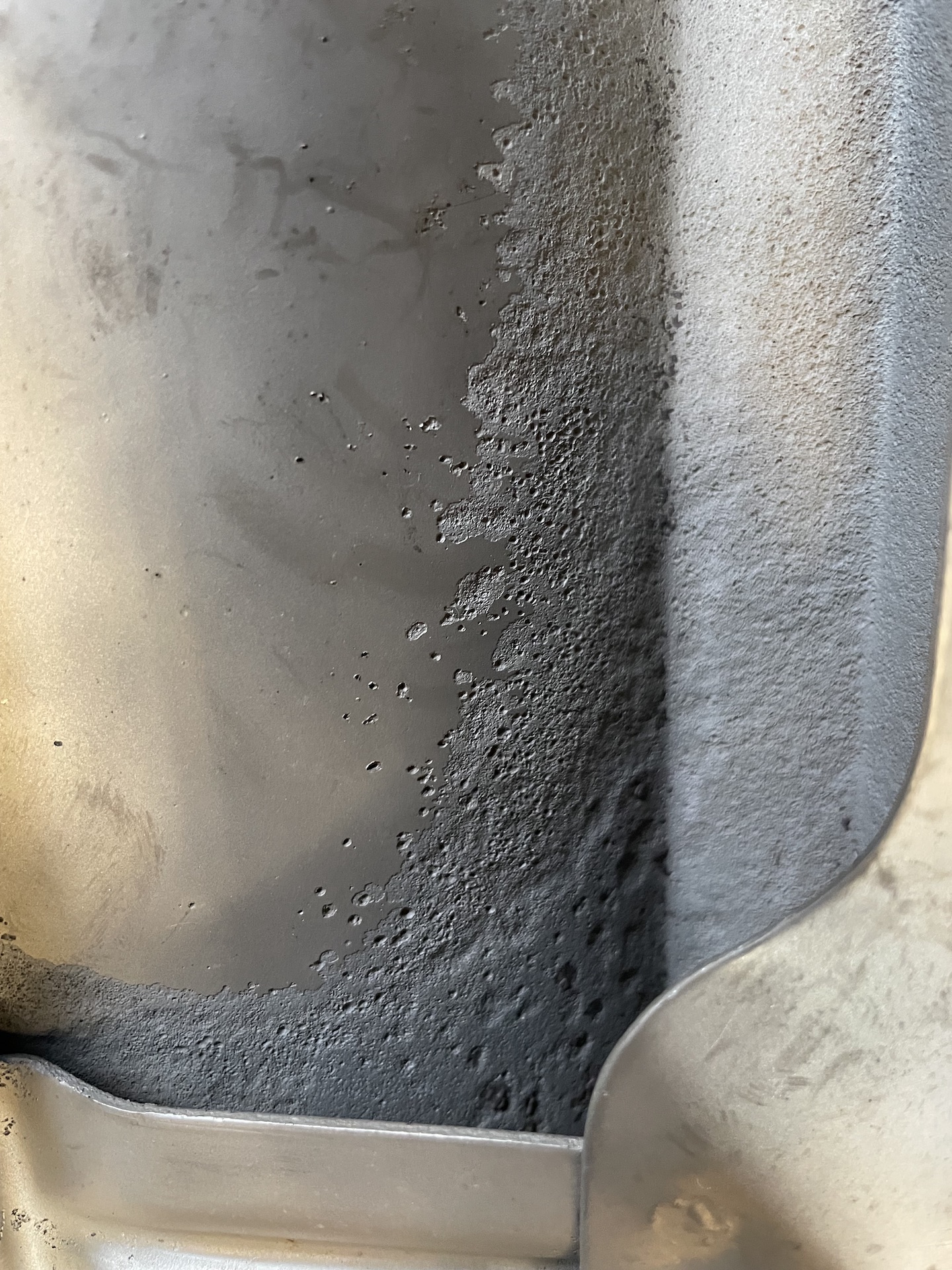

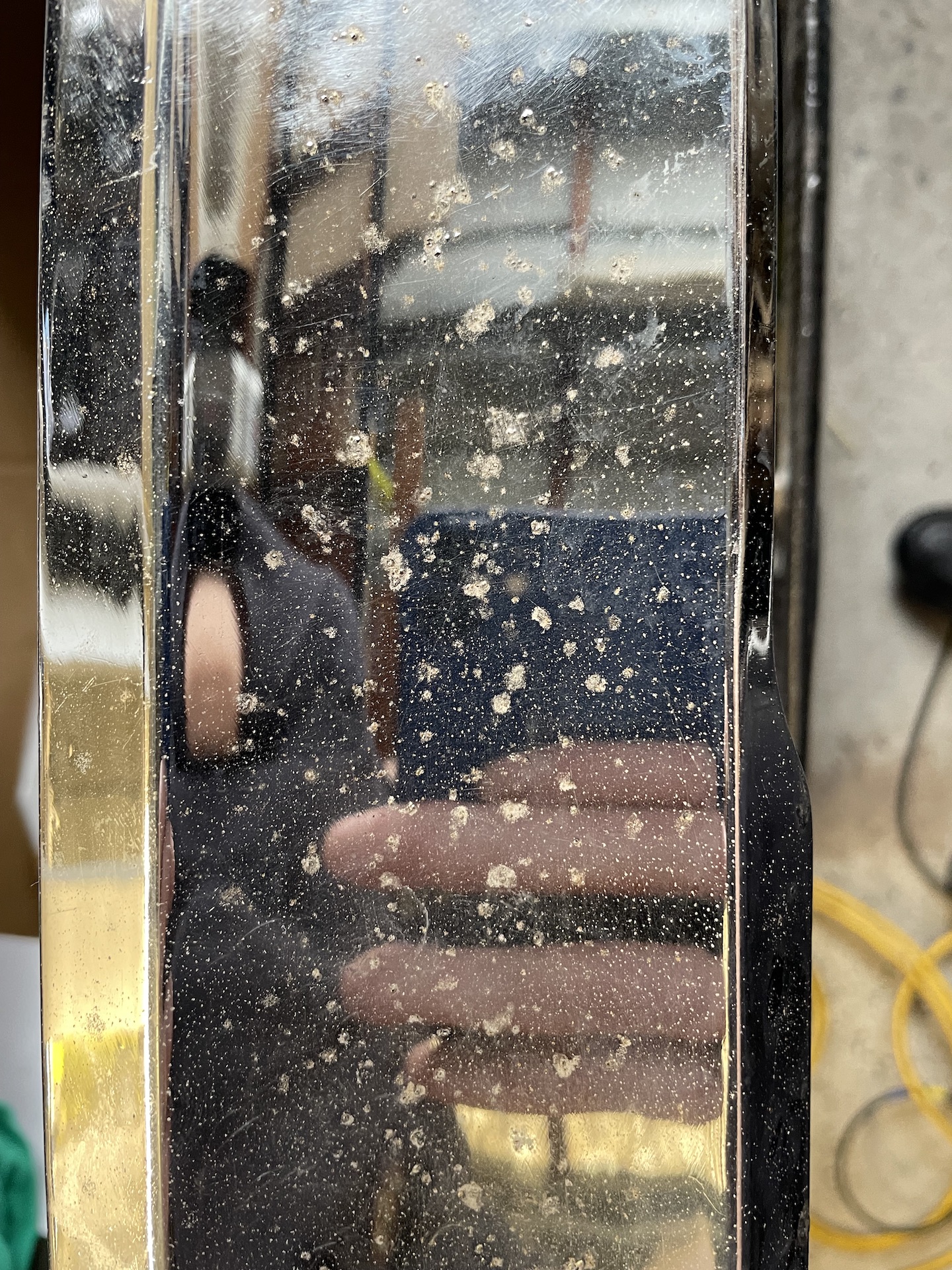

Did a test on the front as well for sh!ts and giggles. Hasn't really done much more than brush the chrome. Media might need a change to something more aggressive.
A bit on the top plus a close up of the pitting in the chrome.

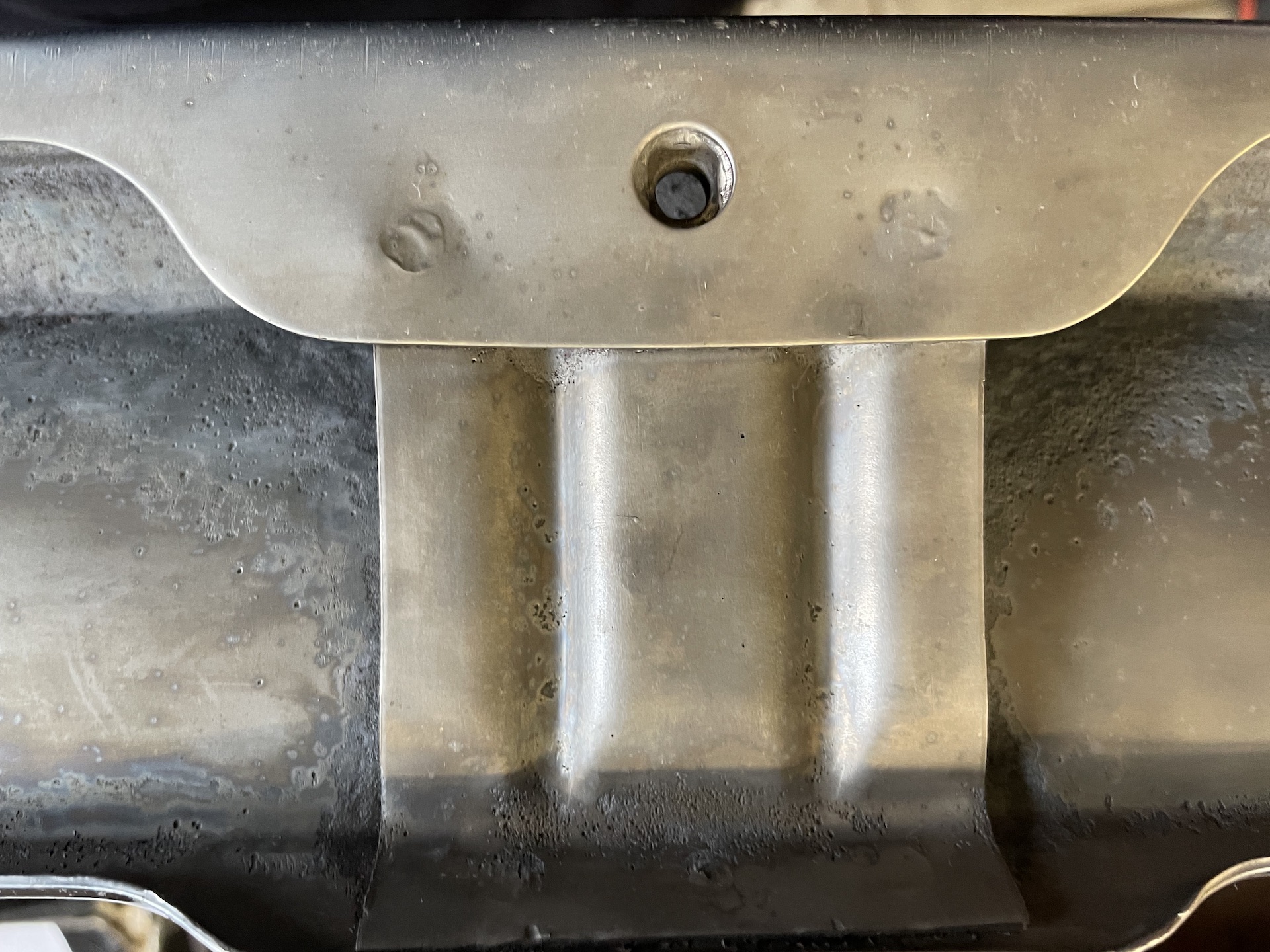

And finally Phase Three. Citric Acid (Wonder if Clay has been thinking "why didn't he just do this at the start?)
Ratio used was 500grams to 8 litres of water. From lots of reading that seemed to be a good strong mix. After a few hours gave it a scrub with a toothbrush, then left it in overnight. Blast with the gurney in the morning and here is the result.
Got into most of the nooks, but still ended up getting the last few spots off with the sand blaster. These were only found when I gave it a scrub with deoxide.
And the front still looks a bit sh!t.

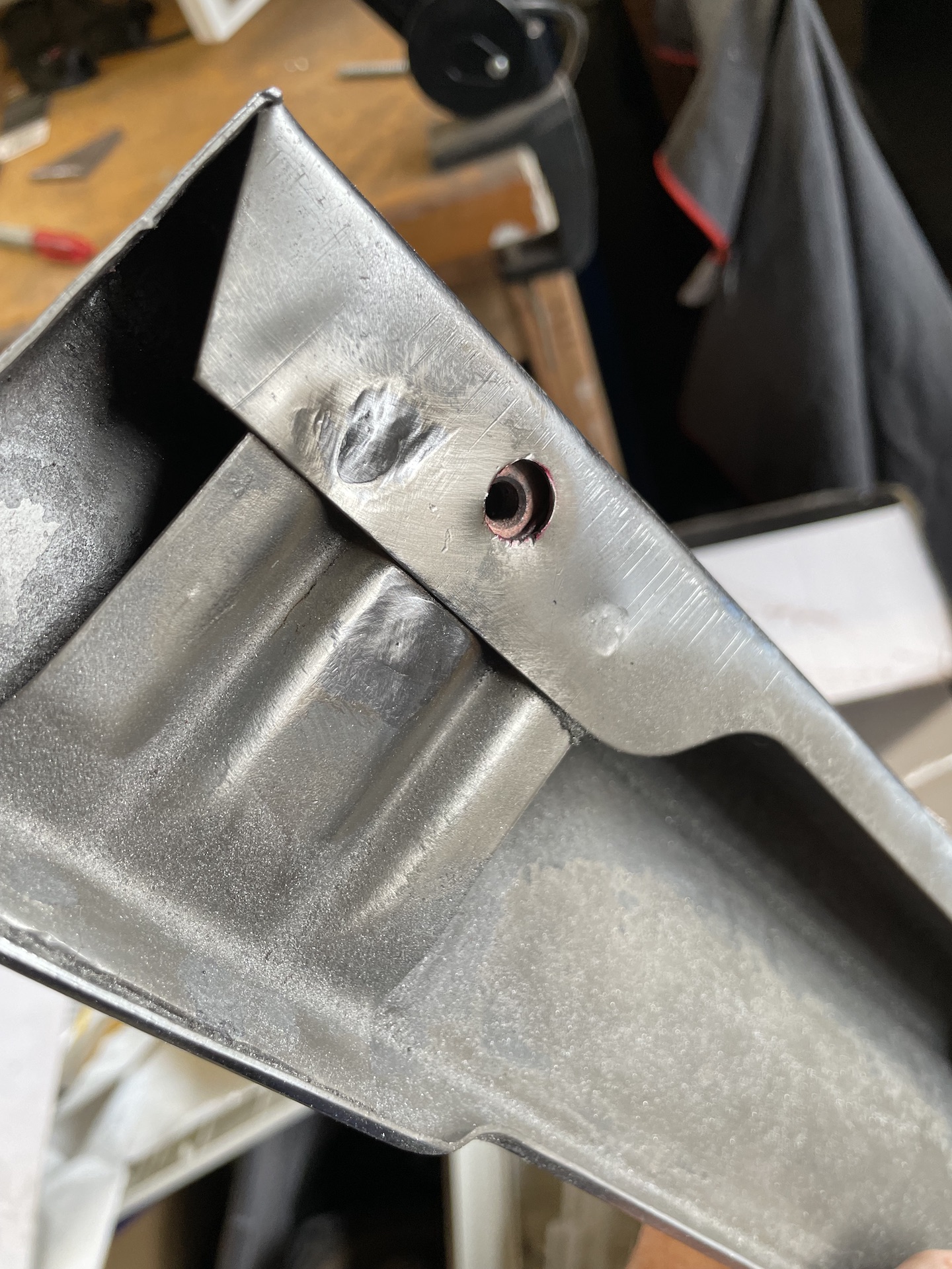

Next job - fix the captive nut. Thought about folding a sheet metal bracket round a nut but I didn't have a square nut and it all seem too hard. Instead I got an offcut of mild steel 5mm bar from the rotissery build (still a work in progress), and cut it down to fit between the ribs of the brace.
Then drilled a 7mm hole in the brace and plug welded it in . Also filled in the self tapper hole.
Lastly, gave everything a spray with Easyphos, to protect it for now. Bought a fancy re fillable can online and put the EasyPhos in.

My two cents' worth: Examine the front face of the bonnet bar directly in front of where the braces are welded to the bar. If there are little rusty pimples, worry at them with a scriber. They may become pinholes. Pinholes are fairly easy to weld up and dress down; and then you can get the bar rechromed.
Or you can send the bar to the platers' anyway and get them to electrolytic-strip it, which will certainly reveal any rust holes. Then you repair them, and then they can re-chrome the bonnet bar.

From my experience with chrome platers they do not like to plate stuff that has been sandblasted, it opens up the metal too much and is a bugger to plate (= expensive )
I would take it to a plater and have them strip the old chrome in their pickling tank rather than sandblast it .

Clay - Fingers crossed on the re chrome, but as Blacky pointed out, might not be doing myself any favours attacking it with the sand baster. Had the EasyPhos in a glass lens cleaning spray bottle which was great for a fine mist with no drips at the end of each trigger pull. But the nozzels clog after a while. Windex bottle might be good for a larger area though.
Rob - Had a bit of a poke at the front, there were a couple of places where the chrome had bubbled but haven't found any holes.

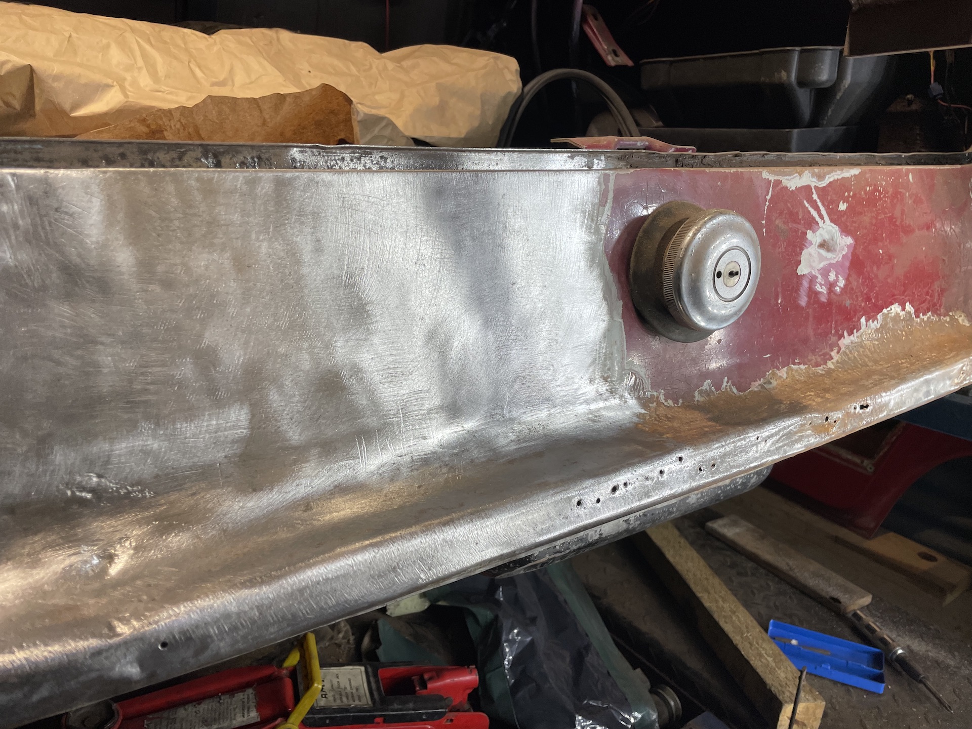

Now that the car is hanging and I have some spare time (Kitchen/Dining reno stole most of the last 3 months), started poking around the back of the car.
Not shy with the bog on the back. Was expecting it to reveal more of a horror show - just think it was some cost effective (lazy) panel beating. Few holes to fill here. Pretty sure it is behind the rear bumper so I'll test out my panel beating skills here as well Then had a bit more of a scrape around the rear quarter. Knew there was a few spots at the front. Now I have found the ones at the back Method for finding these pin holes that is working (so far). Scrape off 4 layers of primer/paint with old wood chisels. Doing this to keep dust to a minimum and prevent potential warpage from strip disk. Also the strip disk tends to smear the red paint which means constantly back tracking over 'clean' metal. Original plan was to scrape off red then mechanically strip primer filler and original blue. Then I just started scraping the lot. Time consuming, and not for the impatient, but not a bad job to do for an hour at the end of the day.
Some spots are pretty obvious, and a quick once over with the wire wheel reveals the rest as they don't come up as shiny as clean metal. Quick prod with a sharpened screw driver reveals if there is a hole.

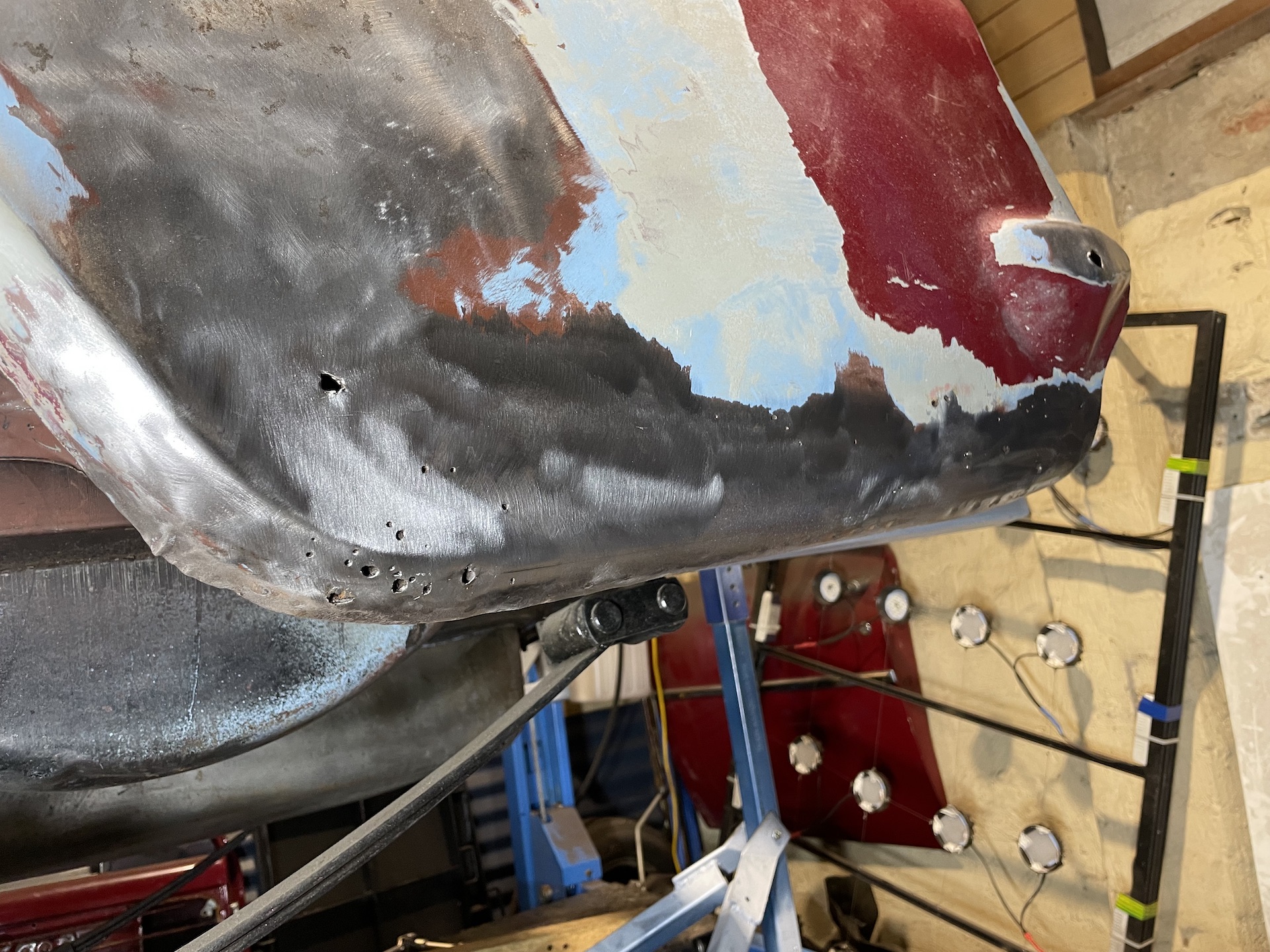

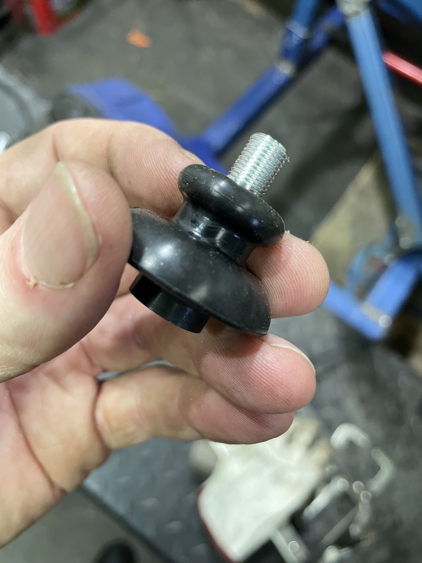

Now that the car is hanging on the rotisserie decided I should get it balanced/centred. Having issue with the car rotating down on the drivers side and added a bit of weight to the left to compensate.
Then I remembered the tank! Still had fuel in it of course. About 7 litres. That's some nasty black stuff. Pours out darker that a Coopers Extra Stout. And the smell gets into everything. A nice 19y/o vintage.
Set it up as per Rob and Clay's advice. In the middle of the circle pressed into the firewall just above the traverse line at the front .Back is tricky as I did it with the tank in and I have left the rear springs on for now, so at the back I was in the middle of the filler hole.
Then I attempted to spin and hit my first snag.
Had to raise both the rear and the front 50mm to clear the rear bumper mount point. Here is the rather dodgy way I have been lifting the car. Could be worse - the jacks could have been on bricks I guess.
Success - the car spun past the mount point only to hit the top of the fin. Missed it by that much.
Repeat process for another 10mm gained. Only problem with doing that is now the front is very close to the subframe - but it just clears so all good.
Only issue first time rolling the car over was more fuel pissing out of a hole in the top of the tank. Wasn't prepared for that and it went everywhere. Going to to be smelling that forever.
At that point I decided to take the tank out! Easy now that I had the car over as I could get at the 4 seized screws that were rusted in.
With the tank out I had to rebalance the car - now centred on the boot lip. Spins pretty easily. Spent the next hour rolling the car around just because I could. Actually looking forward to repairing the drivers side plenum now!

Happy news Scott: Good to have it on the spinner. Sympathise about the old fuel- it has a half-life of about a thousand years. Going on what you have already cleaned up we'll need sunglasses to stand near it soon.
Re: Ol' Rusty - FB/EK Sedan
Great work Scott. Bit of a heart in your mouth experience mucking around with so much weight at first or was for me. I use the aid of gravity to adjust mine, turning it up the other wsy and easing off and re tightening one side at a time. All flexes slightly and allows this. Also can put it on the side and use a lever to adjust.
