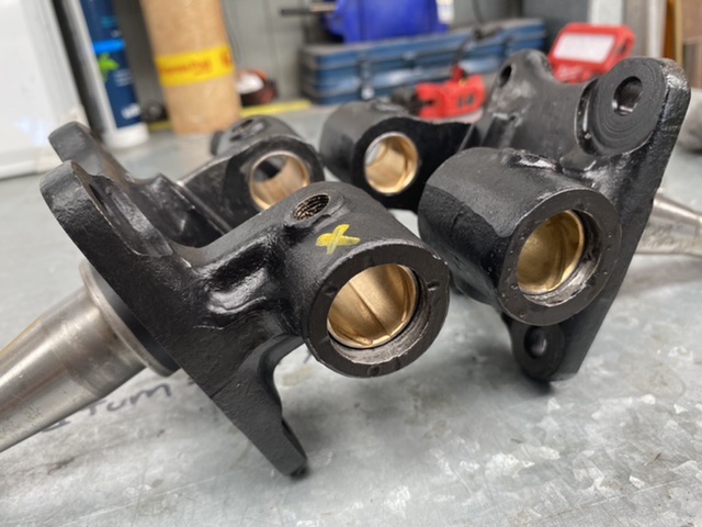

Hooked into the king pins over the last couple of days.
Bloody hell what a laborious job it is to ream the .010 out of the brass.
It’s taken 2 afternoons of elbow grease to get the bush’s to size, only due to my hands and arms hurting with the continued action of the work.
Will open the Center cast piece up the .010 with emery paper spun on a bit of timber tomorrow, hopefully that works ok.
I hope so, totally committed now haha

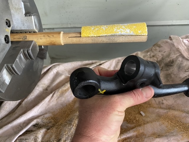

I tell ya, what a pain in the arse opening this cast piece out .010 to suit these over sized king pins.
Tried a dodgey set up in the lathe to polish the internal diameter out, be real luck. But I have been using some crappy sandpaper for the job, should really have emery tape.
Brett suggested a dremel and some sanding and grinding attachments- I’ll have to go to Bunnings and have a look to see what they have.
Other option is buying a short adjustable reamer which hate and Forbes have in stock but there is no guarantee that will actually work.
So the question is, how is this job done without bashing your HWS against the wall while trying to achieve it?

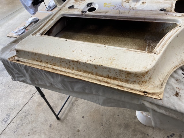

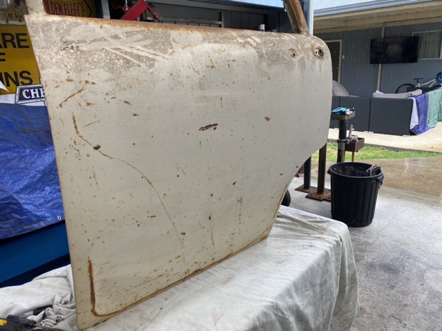

Time to make a start on the doors whist I wait on a decent solution for the long pin cast hole.
Actually looking pretty good for rust in this one.

Other back door is a good one too.
- B6955C37-BD06-4763-8265-116EBCA684EE.jpeg (112.95 KiB) Viewed 1134 times
- 102356FA-EE03-4205-9E03-1E53BE85825B.jpeg (113.69 KiB) Viewed 1134 times

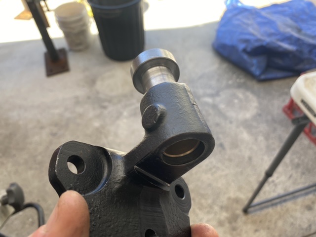

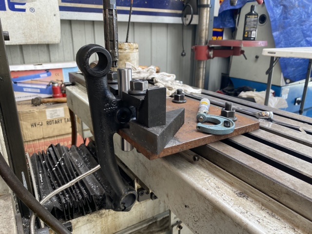

Kicked on with the king pins.

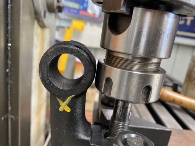

The Center cast piece has proved to be a pain to open the hole out .010” to suit the over sized pins.
Tried using the dremel, linishing rod on the drill and a small brake cylinder hone.
All were either butchering the hole out of shape or simply doing not much at all.
Ordered an adjustable reamer which I could chuck in the mill, made a jig and bingo job done in a hour and a half.
A nice finish is always achievable on about the 5th try lols.
BTW if anyone in the group needs this done to the Center cast piece of the king pins shout out and I’ll do it for yas.

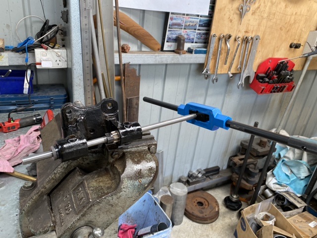

However getting your hands on the Warren & Brown tool to do the brass bush’s will be up to you!
