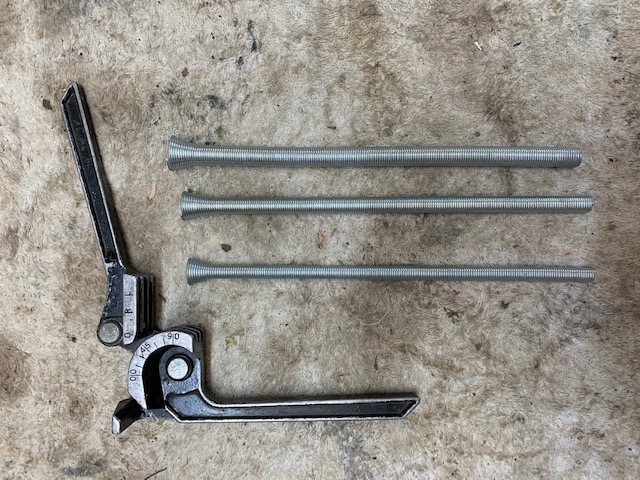

In the Shed wrote: Thu Aug 19, 2021 11:30 am
Hey Drew
I have bending tools your welcome to borrow. My flaring tool is only a single flare and I think you need a double flaring tool.
Geez thanks mate! If appreciate that but I can’t help but think the tube bending tool would be a pretty basic little bit of kit?
Can you post a pic of it somewhere?
I might be able to whip something up on the machines rather than get you to send it to me.
I’ll PM you.
Hi Drew
Bend tool does 1/4”, 5/16” & 3/8” also have bending springs too.

Drew
Posts: 2518
Re: Wilma FB project
I have that bender too- it works really well.
Belly760
Posts: 205
Wilma FB project
Post by Belly760 »
Do you remember where it came from Brett?

Posts: 2518
It was part of a flaring kit. Kit is just ok but bender is a beauty.
