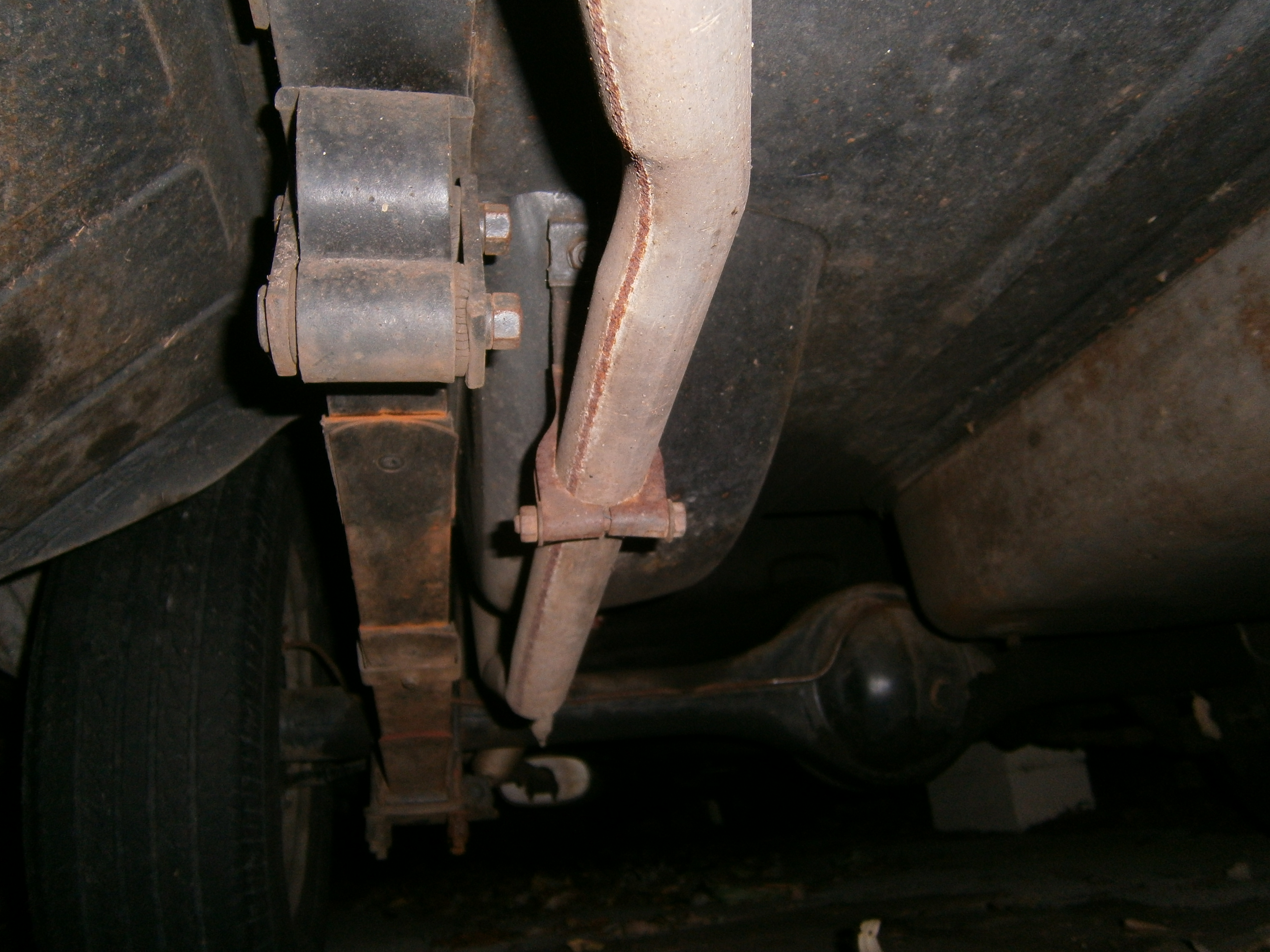

Brett,
You might have to lengthen the right-angle bracket on the tailpipe hanger by about an inch to achieve the right clearance. For comparison's sake, here's the tailpipe hanger of my FC (camera aimed in the dark):
The tailpipe clamp is this amazing folded sheet metal arrangement which grips the rubber insulator on both sides. The tailpipe sits about an inch below the rear bumper, and there's about a hand's thickness between it and the boot pan behind the spare wheel well.

Thanks Rob. They are pretty much the clearances I currently have. It's hard to tell from photos I guess.

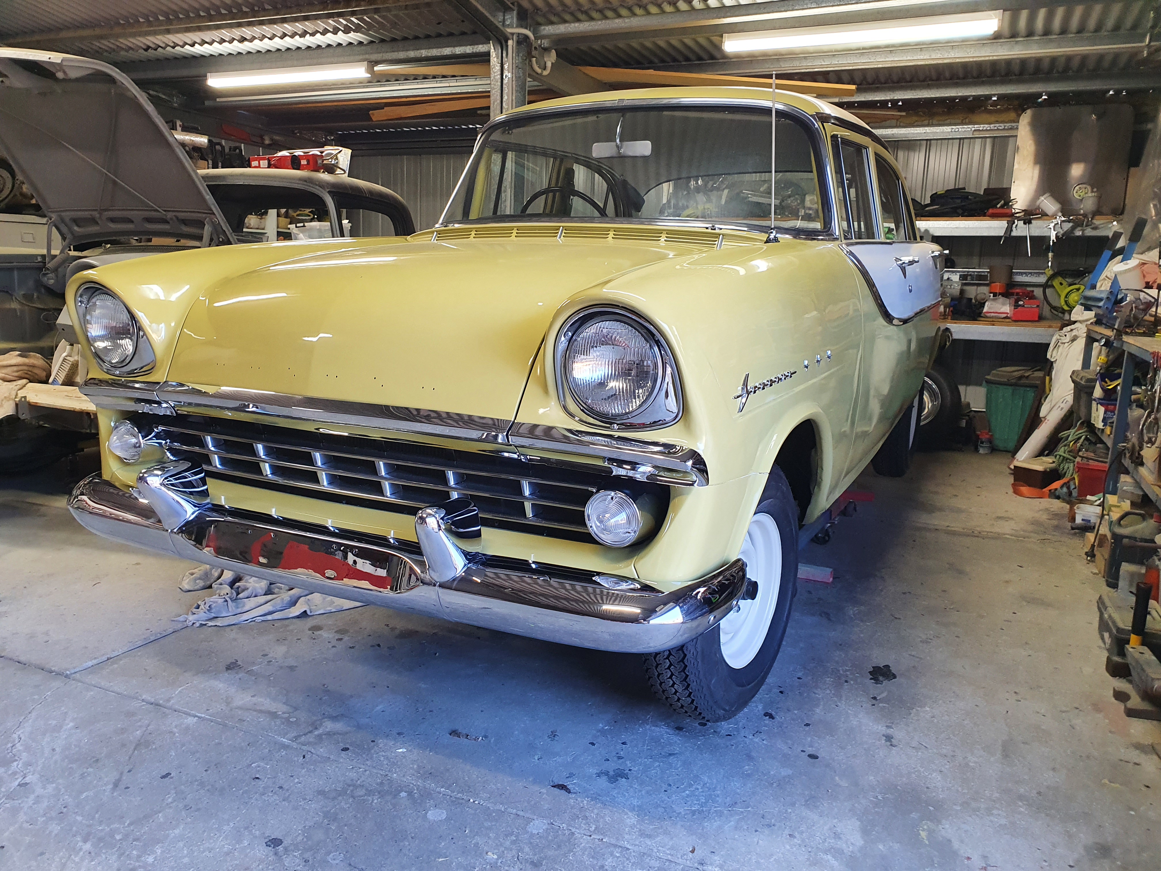

Not much left to put on now. Horn, gear sellector rod thingys, aircleaner all need a paint and the bonnet bird and letters need a polish. Oh, and one wheel still to go on after clutch and gear sellector rods are sorted.
Having troubles with bleeding the clutch- had it right and then thought I could get it better. Not so far, as have lost all pedal now
. Nothing leaking, so its just perseverance....
No one told me that you can't fit the two trays under the radiator and front of engine after you have previously fitted the sway bar. Well now I know.
Engine tune up, coolant and heater hose fine tune, a bit of wiring and fuel line filter to do. I bought a digital combination oil pressure and water temp gauge that I'm going to mount under dash to the right of the handbrake, so that job to do too.
Bit more wet and dry on body and bonnet and then full on buff still to do as well.
Oh, and I still haven't sorted the striker plates and rear doors fit.

Or the bonnet letters 8 )
I never took my splash pans off the car actually. Brush painted on the car with KBS motor coater. Bumper iron inners have to be bolted up after fitment also.
I have trouble every time with the clutch. I find it usually comes good with use as long as you have some function.
You aren’t really going to paint the selector rods, are you? Very thorough indeed.

I'm having trouble with the bonnet sitting down properly at the hinges. I guess they might be a bit tight and may settle down. I have used all the adjustment available. I can push the corners down to level but they are not doing it without my help. Any thoughts?
