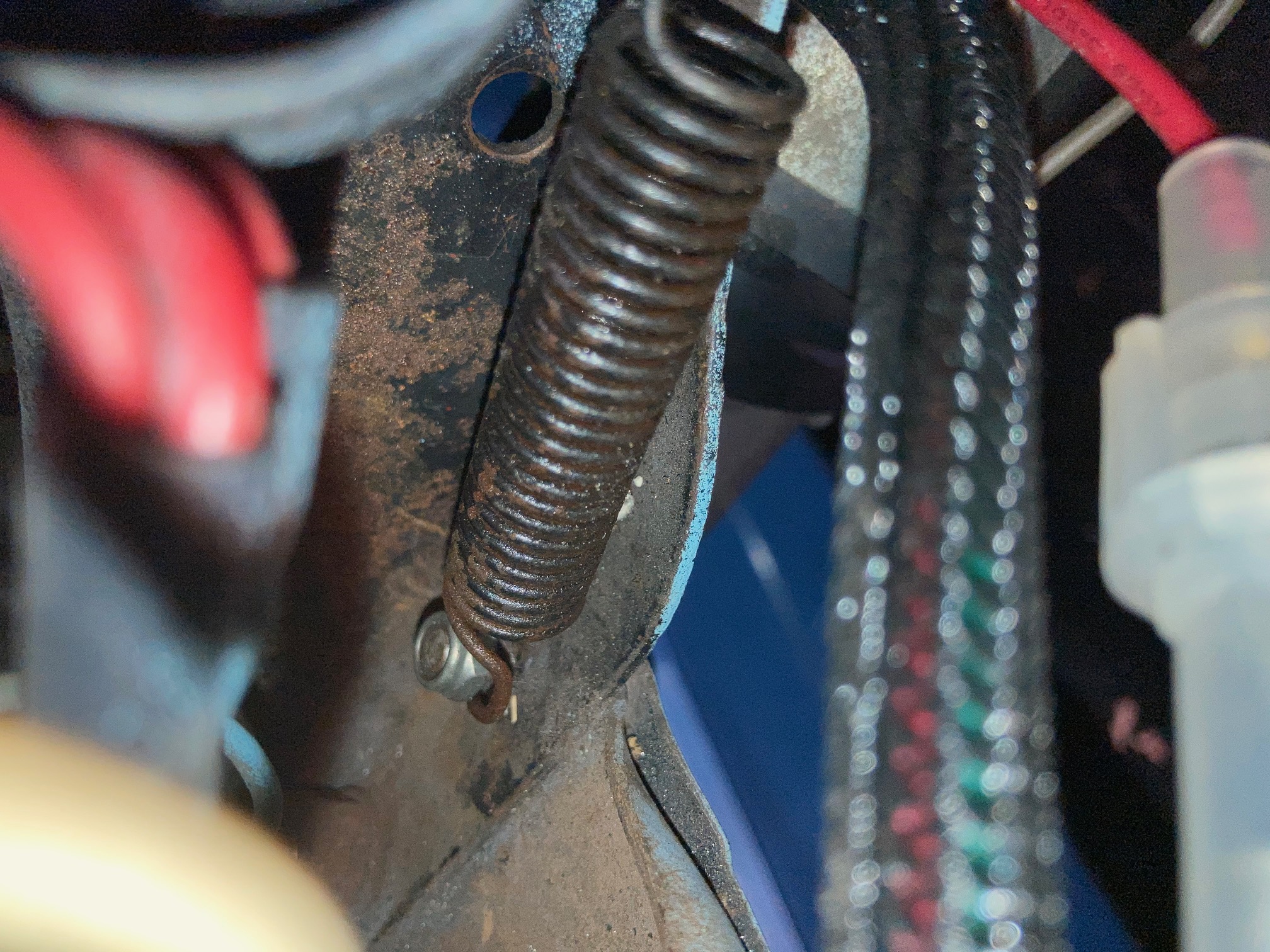

Ok, help please!
Trying to fit brake pedal return spring. I found the remains of original one on the clevis rod pin and replaced with one from a spare pedal box.
Just can't work out where the other end attaches.Image
FB ute driver, EK van project
Posts: 2536
I'd be interested in that one too. It's somewhere in bottom of dash I think, but mine is not right either currently.

Post by Rev Tex »
Hi,
Not sure if a manual sedan is the same, but mine attaches to a bolt on the bottom of the dash. I've attached photos.
Looks like the same bolt that secures a cross member.

Rev Tex wrote:Hi,
Iain
That is just what I was looking for, and makes sense. Much appreciated Iain.
Clay
Posts: 2536
Yeah that's where mine is too but I'll have to sort it out a bit more. When I push the pedal, the spring is scraping on the dash. Longer bolt to lift it a bit may be the fix for mine.
