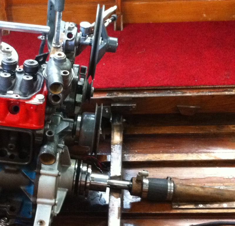

The blue section should be the timing cover seal running surface.
I forgot to add that this coupling is part of the cast timing cover assembly. This is a direct drive arrangement - no dog clutch.
I have a grey motor dog clutch set up which incorporates a thrust assembly integral to the timing cover housing. It is different again to what you have.

Thanks Craig - appreciated. It helps explain why the Tawco timing cover seal/bearing setup shown earlier in this thread is so chunky.
Interestingly, I've got another ally timing cover at home (assume marine - see http://www.fbekholden.com/forum/viewtop ... 7&start=30) that has a similar beefy seal/bearing setup, but no wings to mount to the hull. It had a 2" ID oil seal and heavy ball bearing mounted in it (Presco seal P3246 2” ID, 27/8”OD, ½” thick. Axial deep groove ball bearing Hoffman England W1-5/8. 2.469” OD, 15/8”ID, 0.719 thick). The seal and bearing accepted a solid steel piece that would allow some form of equipment to bolt up to the grey crank. I assume that the thrust for this one would be taken externally, perhaps similar to your dogclutch setup.

That's a standard pressed steel cover. No thrust set up there. I dare say by the design of the coupling that an external thrust is used on the prop shaft.

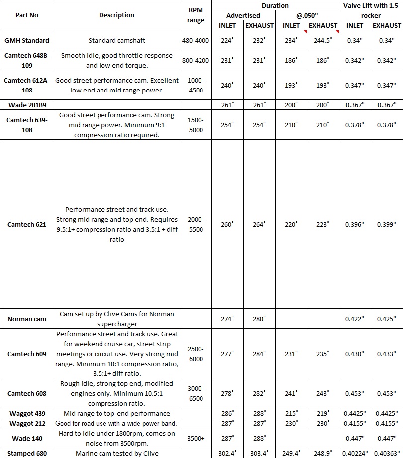

It only took me three years, but I finally got the cam measured up (from page 1 of this thread). It's stamped 680 on the end. Results below:
grey motor cams.jpg (232.89 KiB) Viewed 1673 times
Its a monster of a cam, and no wonder that it did not run well on a street-driven humpy. Talking to Clive, he is pretty confident that this was a Repco ground cam, as the lobe lift is very small. Most likely a specific one ground for the crossflow head in marine service.
The Repco cams for the crossflow head were HP1 (racing) and HP2 and 3 (sports). The only data I have for them is that the HP1 had 80 degrees of valve overlap. This cam has 98.5 degrees... lumpier still.

I'll plug this into my program and see how it comes up. Pity I already have had my cam ground by Clive. He never recommended this one at all knowing that it was for a crossflow headed grey.

Full cam card info below.
