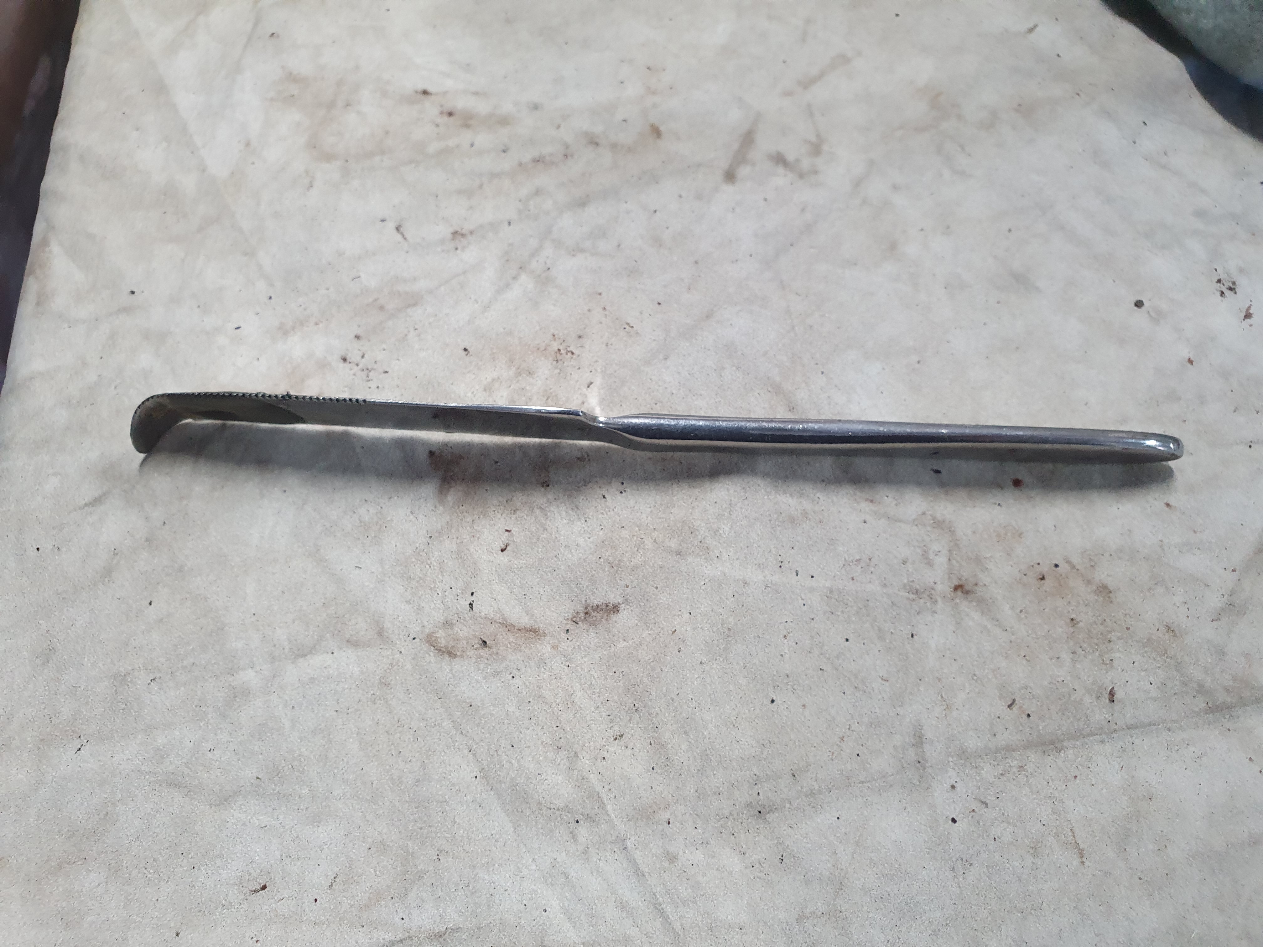

Thanks for info everyone😀. I can now attest that you can install a rear outer rubber door seal without taking the door off🤗🤗🤗. Got door clamped shut for a few days now to settle it all down after spraying some Rares magic rubber stuff. It's nice and warm today so back to front seat rails and seat trim prep and painting. Special rubber fitting tool in photo.
Special tool 1234
Special tool 1234

Brett
Great tool there from the kitchen. Hope your misses is not on this forum :shock:

Re: Wilma FB project
Hi Stephen. No trouble there: that ones from my shed drawer😀. If it was one of the 'proper' ones I would be running still.

Brett027 wrote: Thu Apr 29, 2021 5:19 pm Hi Stephen. No trouble there: that ones from my shed drawer😀. If it was one of the 'proper' ones I would be running still.
Phew....... :thumbsup:
PS: I remember getting in trouble as a kid when I used the ends of Mum's soup spoons as tyre levers on my push bike. :oops:

Doesn’t take long for my kitchen utensils to all end up in the garage. To the point my wife bought a cutlery set from Kmart and put it in my tool chest 😂

It would not be an Aussie kitchen unless some of the dinner knives had bent ends from being used as screwdrivers or prise bars :mrgreen:

Somehow my story about a car has turned into an expose' on the use of kitchen cutlery. Who would've thought🙂.
