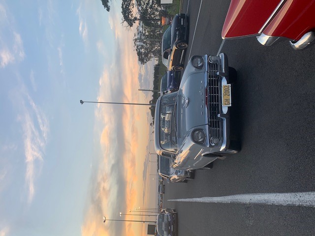

I guess it was only a matter of time...
Graces ute at Eastern Creek.jpg (84.87 KiB) Viewed 1400 times
... before the ute "accidently" went out to Eastern Creek for a run down the quarter :mrgreen: Grace was observing this time, but suspect the ute may start to mysteriously disappear on Wednesday street-meet nights.
Looks like a bog stock EK ute will pull 20.8s@60mph. With factory 2453lb and 75BHP, the calculators reckon there is another second in it, though we were going gently.
