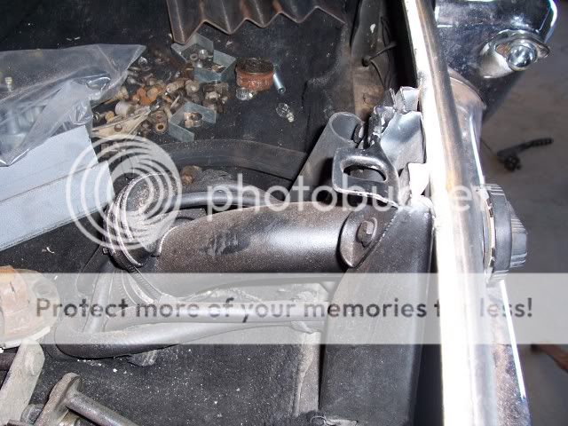

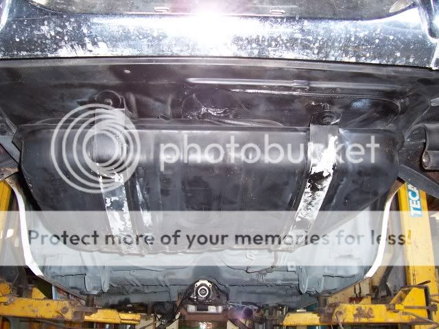

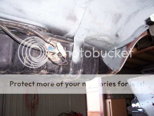

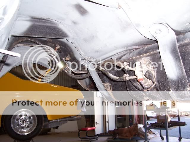

Found these old pics of a VN Commodore tank mounted in our old V6 sedan --
Posts: 2542
Re: FUEL TANK REPLACEMENT
Would a metal tank ( like a mustang) require straps Blacky?

Blacky thanks for sharing the pics!.....The Commodore tank appears to hang lower than the quarter panel ?

Done the same as Blacky with my FB Sedan (VS Commodore tank), the only difference was I fitted a 3mm plate under the boot area to have a clean area for the tank to fit up against. this also nicely covers the old tank and spare wheel areas.

Brett027 wrote: Thu Feb 11, 2021 12:35 pm Would a metal tank ( like a mustang) require straps Blacky?
Mustang tanks are mounted in a similar way to the stock tank so no straps required.
