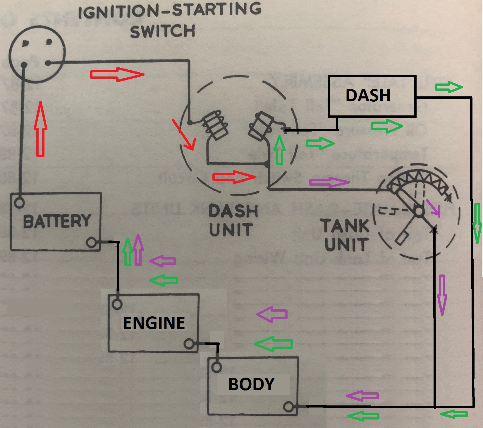

Thanks gents. I think I have my head around how they work. The diagram below I have butchered from the Workshop Manual:
Fuel gauge.jpg (556.89 KiB) Viewed 18212 times
With the ignition switch on, power flows from the battery through the ignition switch (the path shown by the red arrows). Power then flows into the fuel gauge, and through the coil on the left. The coil makes a magnetic field, trying to pull the needle to the left.
Some of the power then follows the green path, flowing through the coil on the right. This coil makes a magnetic field too, trying to pull the needle to the right. The power flows out of the dash (through the two dash screws), through the body sheetmetal, through the fuel pump braided hose, through the engine, then through the battery negative lead to the battery.
Some of the power though does not follow the green path. Instead, it follows the purple path. It leaves the fuel gauge without flowing through the coil on the right. It flows to the back of the car, and into the fuel tank sender unit. It passes through a variable resistor in the sender unit, then flows through the fuel tank mounting screws, through the body sheetmetal, through the fuel pump braided hose, through the engine, then through the battery negative lead to the battery.
When the fuel tank level is full, the float arm rises and the variable resistor has lots of resistance (30Ω). This makes the purple path very hard to travel down. Being lazy, the power decides to mostly flow down the easier (lower resistance) green path. This puts lots of power through the coil on the right, and the needle is pulled hard to the right of the gauge. When the fuel tank is empty, the float arm falls and the variable resistor has very little resistance. This makes the purple path very easy to travel down, so the power decides to flow more the purple path. This puts less power through the coil on the right, and the needle starts to move to the left of the gauge.
All of this relies on a nice, clean, low-resistance path through the body sheetmetal, through the fuel pump braided hose, through the engine, then through the battery negative lead to the battery. In an ideal world, this would have no resistance at all (0Ω). There is always a bit of resistance though – copper wiring, crappy terminals, corrosion, loose screws, paint under terminals etc. The first check that Rob asked me to do was to measure just how much resistance this path had by measuring the voltage shown as “A”.

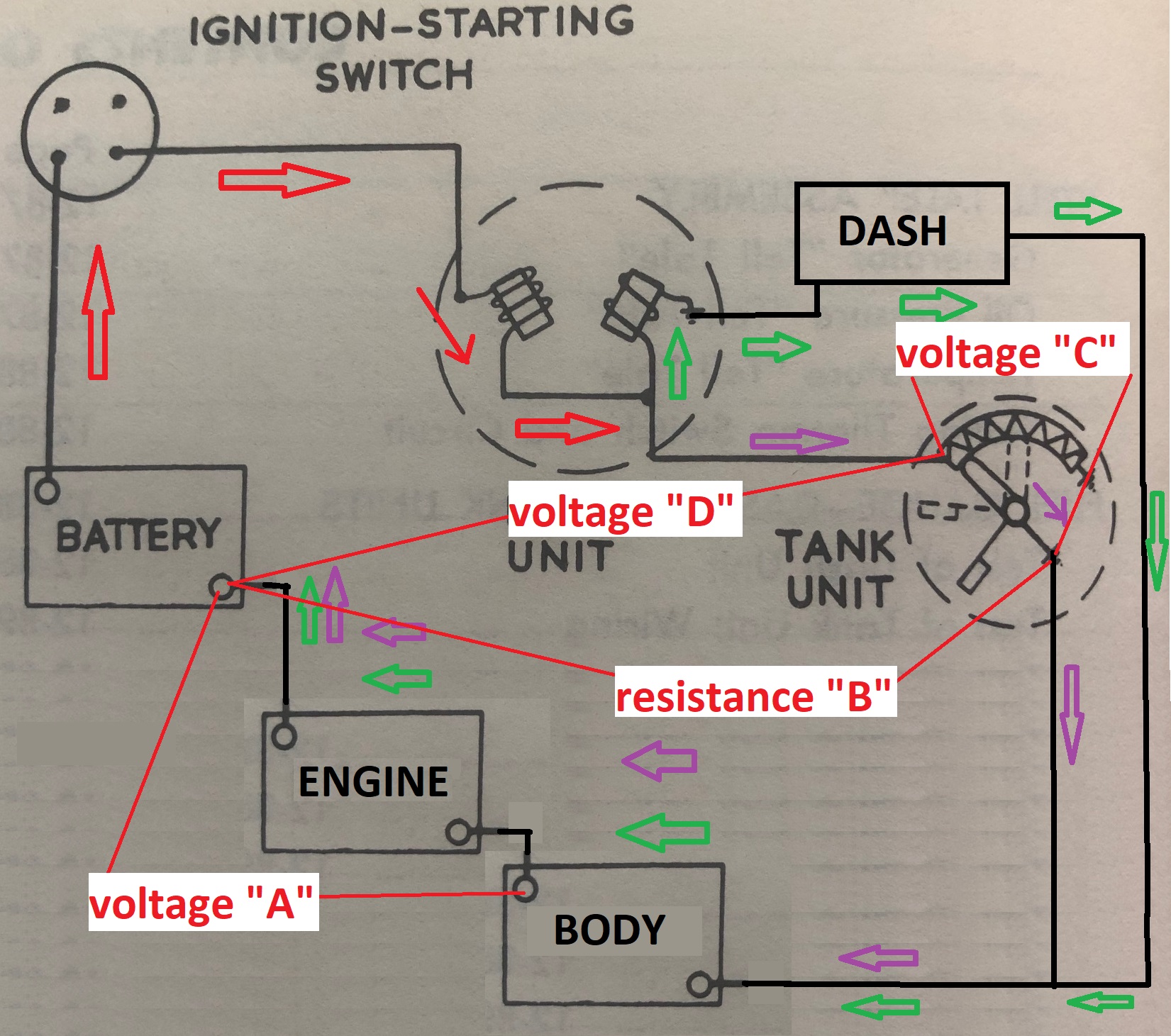

Fuel gauge measurements.jpg (602.07 KiB) Viewed 18212 times
This checks if there is any obstacle for power to flow from the sheetmetal back to the battery. If there is no resistance, “A” would be zero. When I measured this on the FB, I got 0.2V (it should be less than 0.1V). This is partially because I have no fuel pump braided hose, and rely on some pretty crappy paths to get power back from the sheetmetal to the engine and hence to battery (worn engine mounts, carb linkage, choke cable, radiator, rear spring u-bolts etc). Putting a strap from the battery negative to the body sheetmetal would help this.
To check just how crappy that flow path is, the second measurement Rob asked for was resistance “B”. It’s the same test, just covers more of the path. This would ideally be 0Ω.When I measured this on the FB, I got 0.4Ω. Is that a good value or not? I suspect it is a pretty good value. To check it, I ran a heavy (40A) wire from the fuel sender all they way to the battery (bright shiny copper, new terminals), and measured the resistance. It gave me 0.4Ω. This makes me think that my flow path of “the fuel tank mounting screws, through the body sheetmetal, through the fuel pump braided hose, through the engine, then through the battery negative lead to the battery” is pretty good at 0.4Ω.
What happens if this was a crappy flow path? It would make the purple path very hard to travel down all the time. Even when the tank is empty, the power would want to flow down the green path, and hence the gauge reads like it has fuel in it. If the resistance gets up to 15Ω, the gauge would think that the sender was at half way (half of 30Ω) and would show half full when the tank was really dead-empty.
The further checks that Rob suggested are measuring voltages C and D. If there is no resistance, then these are the same (and for the FB they were… 1.7V). A final check that I did was to pull out a fuel tank sender screw, clean it up, then run the lead from the fuel tank sender body direct to battery negative (perfect return path). The gauge didn’t move an inch.
So for the FB, it looks like the problem wasn’t in the earth return path. I figure I’ll test it the hard way… 5L jerrycan of fuel in the boot, run it dry, and see what it says.

Voltage A is 0.1 to 0.2V (from battery to body) - similar to the FB.
Resistance B was 0 ohm (off the end of my Fluke meter) - good news.
Voltage C and D were both 10.4V.
Doesn't look like the sender is the issue. Vehicle returned back onto the road for a few more laps, will have another go once it returns. There are days when I feel like a pitcrew chief... cars go out for a few laps, come back in with something else busted :lol:
