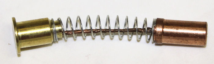

Harv wrote: Fri Oct 16, 2020 11:45 am https://www.ebay.com.au/itm/ORIGINAL-ST ... xyXDhSf~m6
:wtf:
I hate that thieving arsewipe and I have never met him .............. :evil: :evil: :evil: :evil: :evil:

Re: Horn contacts
Post by FJWALLY »
Cripes! It doesn't even look right - has a secondary spring inside the main one.

Out of curiosity, I got onto the Chevs of the 40s site and opened up the (FE) master parts catalog -
FE-EK horn ring mounting spacers, contact spring and horn switch spacer have 665xxxx part numbers: they are not designed by Holden.
Chevs of the 40s has a "horn ring insulator" kit (3 pcs) for 1950-1954 cars, which look exactly like the ones for FE-EK.
They also have the "horn pivot ring" for 1950-54 cars, which also looks exactly like its FE-EK equivalent.
They have a horn button contact (759037) for '47-'57 cars and trucks, which looks awfully like the FX-FJ horn button contact.
And finally, Chevs of the 40s has a horn button contact (270751) for '47-'53 trucks, which looks similar to the FE-EK horn button contact. If anything, the spring and wire are too long. Shortening to suit Holdens shouldn't be a problem. US$10 each. The only disadvantage with Chevs of the 40s is the shipping costs for low-cost orders.

Has anyone ever tried the kits? 55-58 impala - all looks same except the contactImage
gpi
Posts: 1131
Re: Horn contacts
Post by gpi »
that one is a solid rod...
this one looks closer...
https://www.ecklers.com/full-size-chevy ... 509-1.html
