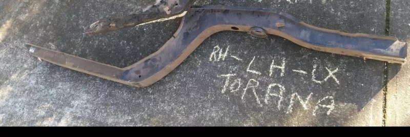

Torana chassis rail 002.jpg (94.57 KiB) Viewed 19811 times
Thanks for the replies Gents.......I've tracked down a Torana rail similar to the one above, it should provide the info I'm looking for.
