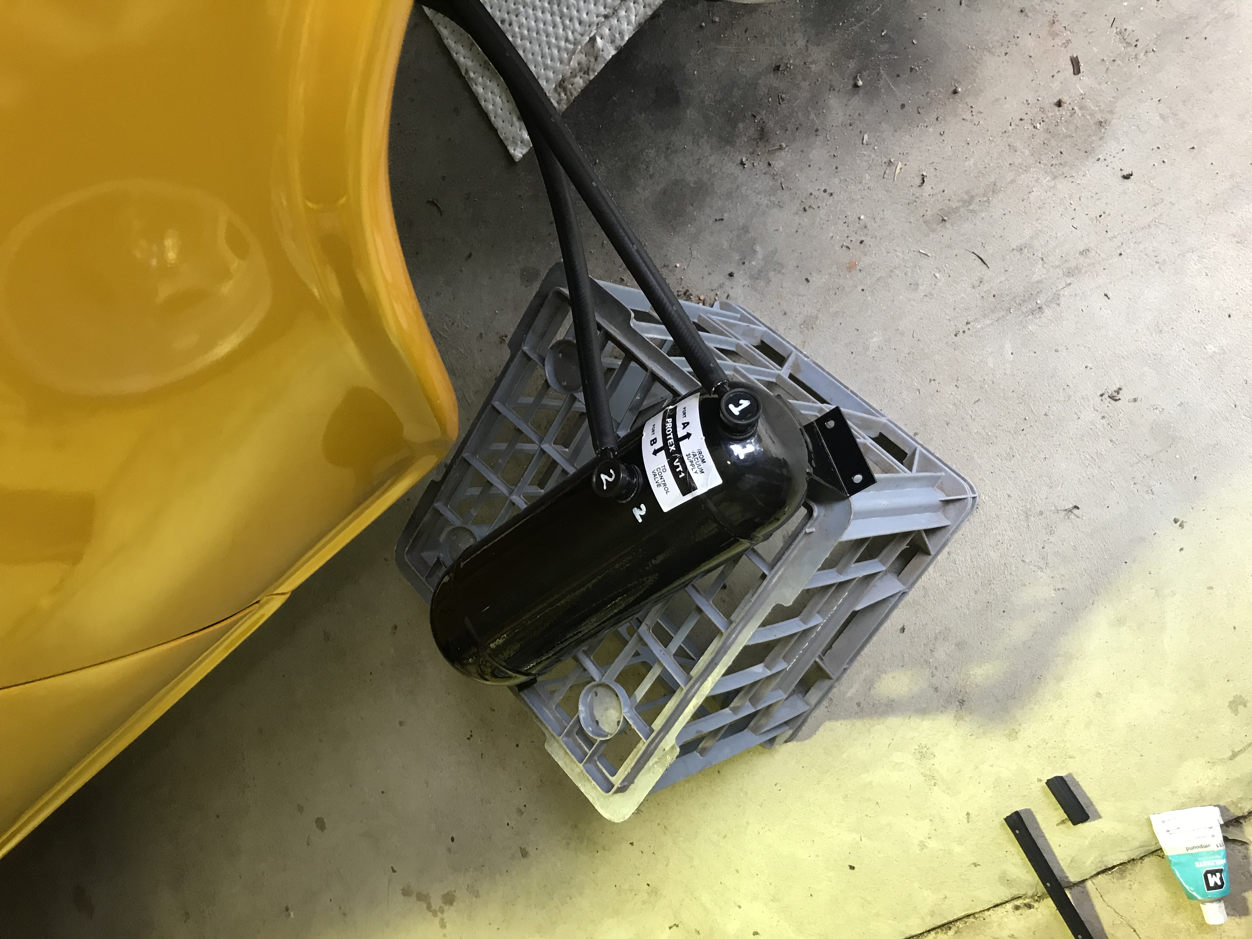

Yeh thanks Harv unfortunately my switch pushes in like the fitting in the tank shown in your photo so will just have to see what happens after I trial fit and test.
Thanks for the photo.

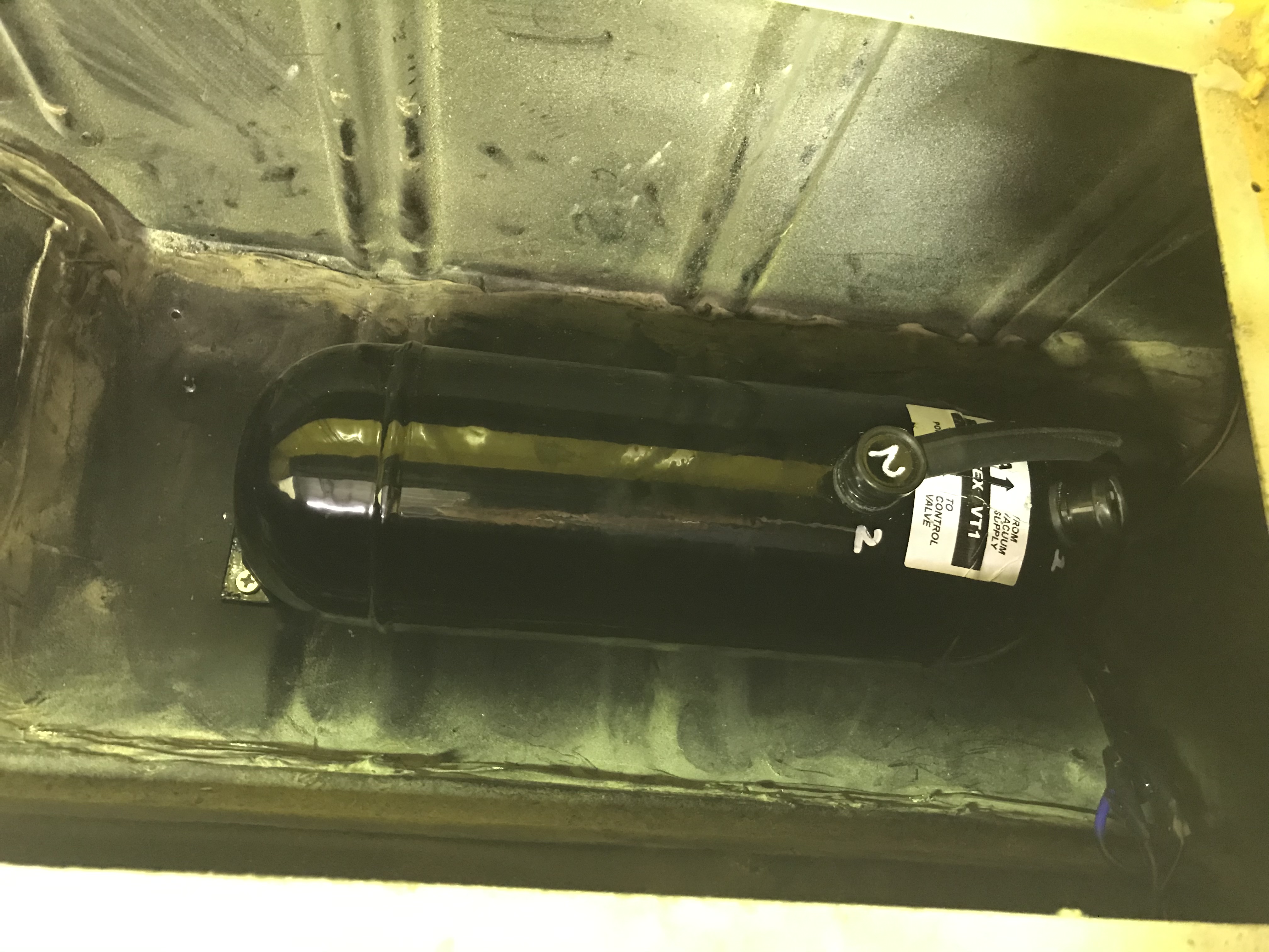

Trial fitted the Protek tank and it seemed to work quite well and maintained Vacuum pretty well with it just on the floor and in parallel with the little tank under the guard.
Moved the tank back to the tray behind driver and plumbed it in, the vacuum drops quicker with the tank back in the tray but the pedal does feel better I think will not know for sure until I take it out on the road again.
I don't think there is enough room under the guard for the bigger tank but if it is still not quite right I may have to squeeze it in, don't really want to put it in the engine bay.

Goes like this, Vac pump to large tank in tray, large tank to small tank under guard, small tank to Booster :esmile:
