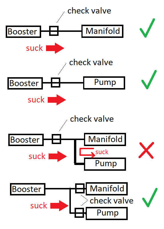

Need to think carefully about how you plumb that one. What worried me is the pump fighting the manifold vacuum, though perhaps I am wrong (?)
If you tee the vacuum line (one leg to the manifold, one leg to the pump, one leg to the booster) then this can happen:
a) the car is at idle. Butterflies shut, lots of manifold vacuum, booster is happy, pump is shut down.
b) Car is running at part or full throttle. Booster is not happy. Pump starts, but has to suck down both the booster and the manifold. The manifold is huuuuuuungryyyyyy.... the motor has an infinite ability to deplete vacuum. The poor old pump can't keep up.
The line that goes to the manifold needs a check valve. It will let the manifold suck down the booster, but if the vac pump tries to suck down the manifold then the check valve shuts.
So what you end up with is two check valves - one in the leg to the pump, and one in the leg to the manifold (i.e. you cannot rely on the single check valve that lives in the face of the booster).
booster check valve.png (26.65 KiB) Viewed 619 times

Your last diagram is how he said to connect it and your right the one time I did try to connect back to the manifold I didn't have a non return valve between the booster and the manifold just one between the pump and booster and the vac pump was just trying to suck down the manifold with no hope of doing it.
I will connect it up as he suggested and fit the larger vac tank to give me every chance of passing the brake test.
