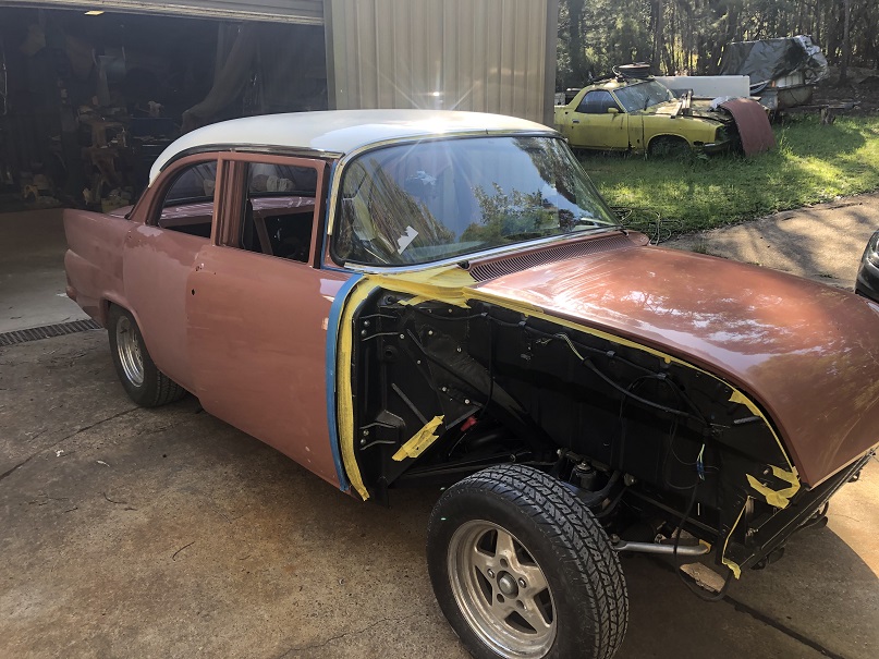

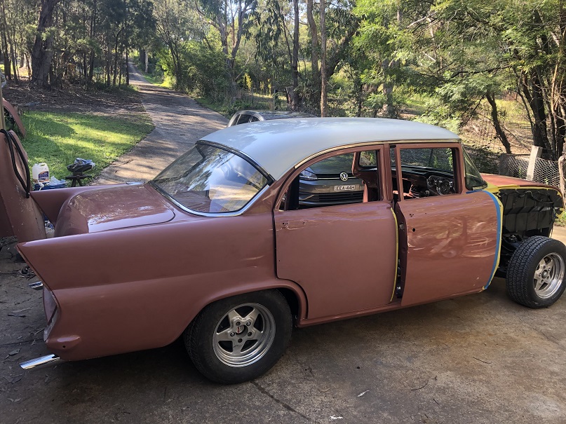

Thanks Dave,
Like Harv says more like a car when the windows are in.
Might have to rig up the hot water in the shed to finish rubbing back and buffing, Cold days I hate em !!!

Looks great Greg no long now.

The more that goes back on, the better that colour looks. The original colours are really beautiful on the body shape.
