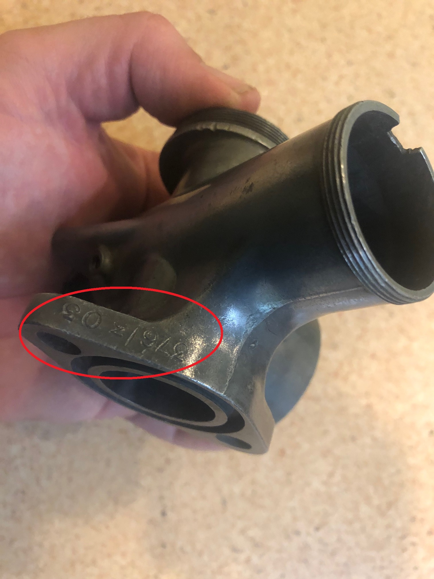

Monoblocks came in four series: 363, 375, 376 and 389 series. The easiest way to tell which series carb you have is to check the specification number stamped onto the manifold flange, as per the red circle in the photo below:
Specification number.jpg (544.92 KiB) Viewed 2506 times
The stamped number will start the series, followed by a few numbers (e.g. 376/303). You can then use the online Amal catalogue (https://issuu.com/burlenltd/docs/amal_catalogue_2013-8) to find more information on your carb.
Each series also came in a variety of bore diameters:
363: 0.475", 5/8", 11/16", 25/32" and 13/16".
375: 21/32”, 23/32”, 25/32”, 13/16” and 7/8”.
376: 15/16”, 1” and 1 1/16”.
389: 1 3/32”, 1 1/8”, 1 5/32” and 1 3/16”.

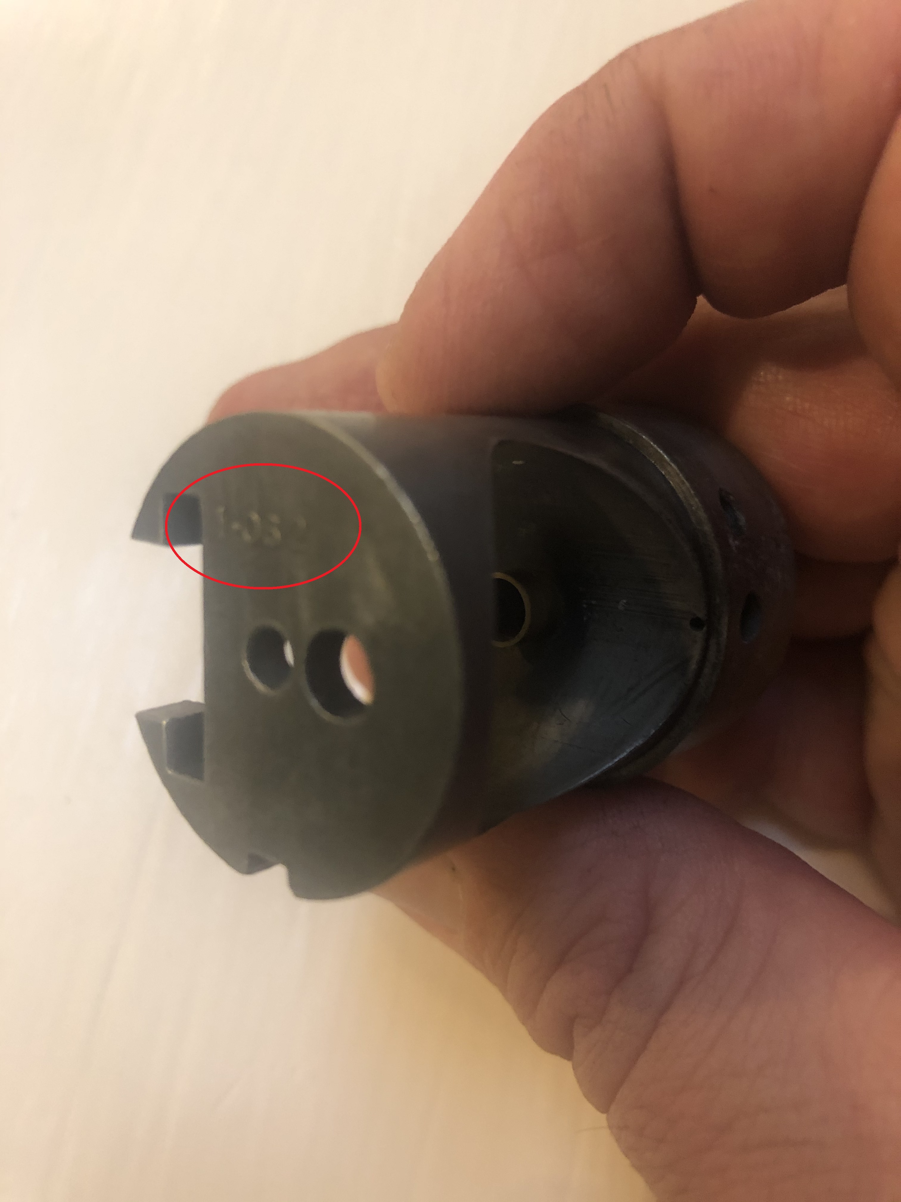

It can be difficult to measure the bore size, so the easiest way to confirm is to strip the carb down and read the numbers cast into the jet block. These are the bore size, in the nearest 1/1000”, For example in the photo below, the number cast in is 1.062 (11/16”).
jet block casting.jpg (1.55 MiB) Viewed 2506 times
The bore size should line up to the info in the Amal catalogue too.

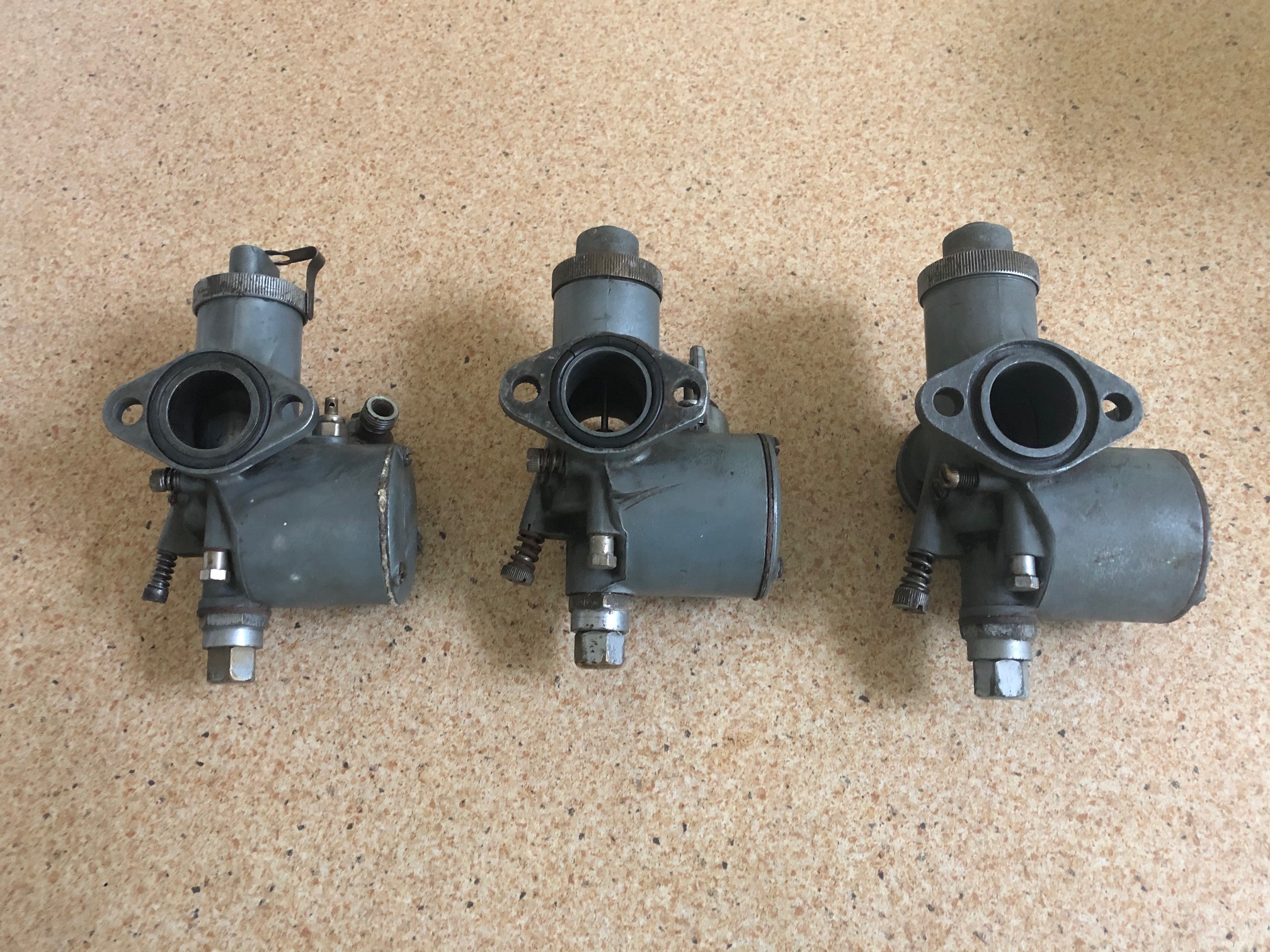

Now that you know what carbs you have, it’s time to pull them down. The Amals are pretty simple to strip down, with no fancy tools required and no special clips that go sprong! and fly across the shed at the speed of light. Take your time, and it should all unscrew. I found that the main body/tower bore can be manky with coke, and sometimes the throttle valve and jet block need some gentle persuasion to get them to come out. Go easy… this is all zinc alloy, and will bruise easily if you are heavy handed with a BFH. Once apart,give everything a birthday with some petrol and a toothbrush. Go easy with the probing tools… no oxy jet tip cleaners. There are a few very fine tolerance holes and machined surfaces that need gentle love, not flogging out until brass shavings appear.
Once everything is clean, there are five tuning parts to check to make sure are the same across all your carbs. These are the bits that could have been swapped out by a previous owner. The photo below (from left to right) shows the jet needle, the main jet, the needle jet and the pilot jet.

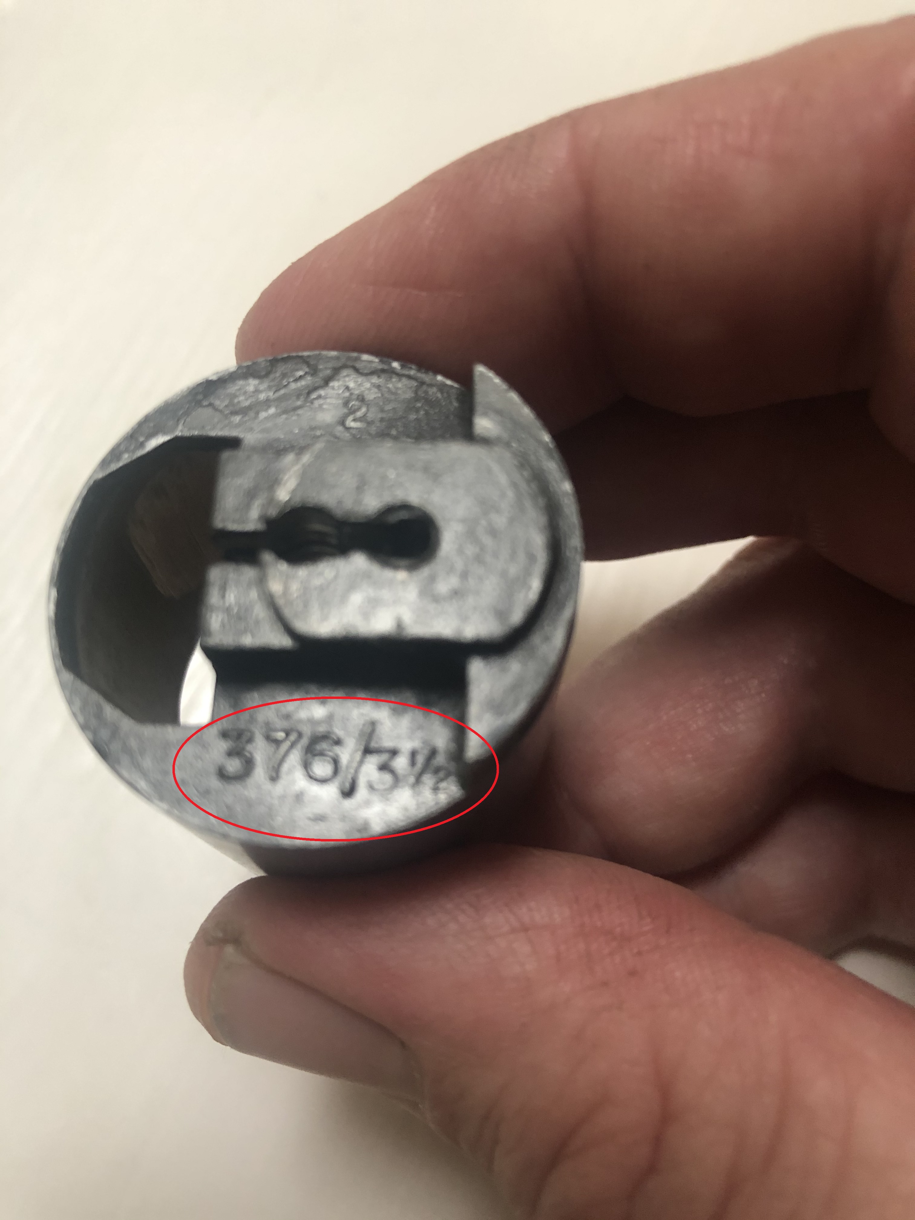

The photo below shows the throttle valve. Cast into the top of the throttle valve is the series number, followed by cutaway number. In the photo below the number is 376/3½.
throttle valve casting.jpg (1.58 MiB) Viewed 2506 times

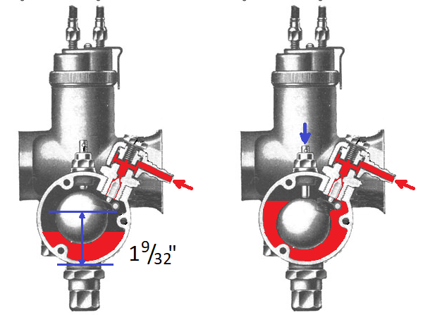

So how does this thing work? There is a fair amount of info out there about Monoblocs, but a lot of it describes how the parts work together, rather than how each part works. In the info below I’ll see if I can explain how they work circuit by circuit, similar to the other carb guides I have written.

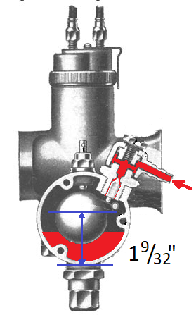

Lets start with the float system. Monoblocs have a simple float, needle and seat, very similar to the grey motor Stromberg carb (see image below).
Float system with red.png (67.52 KiB) Viewed 2474 times

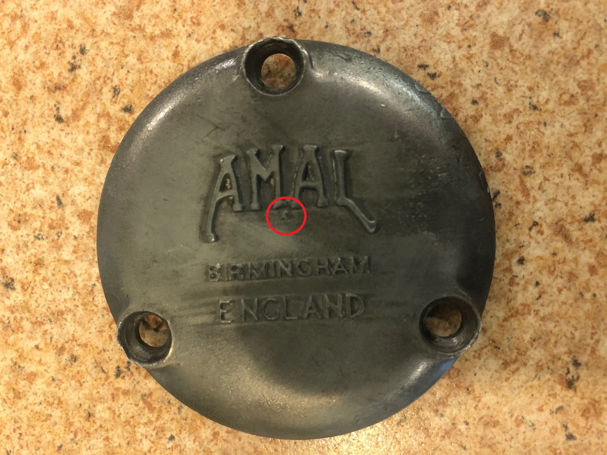

The floats were originally brass, though plastic versions are also available (often marketed as Stayupright floats). The original float needles were also brass, though plastic ones and Viton-tipped brass versions are also available. Fuel pressure (the red arrow in the diagram above) enters the carb via a banjo fitting, squeezes past the float needle and splashes down into the float bowl. The fuel level rises, the float pushes the float needle up into the float needle seat, and fuel flow stops. The float system is trying to maintain a level a 1 9/32” above the bottom of the float chamber housing, as shown by the blue arrow on the diagram above. On the early Monoblocs, the float chamber cover has a “dimple” cast into it at this level (see photo below).
float bowl cover with dimple marked.jpg (923.2 KiB) Viewed 2474 times
Monoblocs are set up to be simply gravity fed from a motorcycle fuel tank, with only about a foot or so of height difference. This leads to a very low fuel delivery pressure (around 0.3psi) that the float is try to fight… very much lower than the 4½psi that the grey motor pump will put out. If you try to bolt on a set of Amals and plumb in the factory fuel pump, you end up with badly flooded carbs because the float does not have enough grunt to close the needle and seat. More on this later.

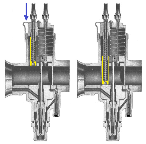

Amals are a slide carburettor. The bore of the carburettor has a throttle valve (a hollow piston shape), very similar to the SU. Where the SU uses vacuum to draw the valve upwards, Amals instead use a cable (the throttle cable), connected to the motorbike’s throttle bar. The more throttle, the higher the more cable pull and the more the throttle valve lifts. In the diagram below, the throttle valve is opened (lifted) more and more going from left to right:
Throttle opening and controlling circuit.png (86.83 KiB) Viewed 2474 times
The image above also indicates that at different throttle openings, different circuits take control of fueling. From idle up to 1/8 throttle opening, the pilot jet feeds the carb. From 1/8 to ¼ open, the throttle cutaway is controlling the carb. From ¼ to ¾ opening the needle position is dominant, and from ¾ to WOT the main jet is in control. We’ll look at each of these circuits below.

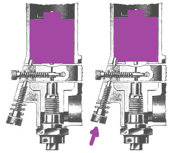

The idle speed on the Amals is set by a throttle adjusting screw (similar to the grey motor Strommie). Whereas the Strommie screw tilts the throttle butterfly open more, the Amal screw lifts the hollow throttle (shown in purple in the diagram below) valve higher in the carb throat.
Idle screw.png (43.4 KiB) Viewed 2467 times
The diagram above also shows the pilot adjusting screw we mentioned above, those this time around is it shown horizontally instead of end-on.

The diagram we used above showed which system is dominant at different throttle openings:
From idle up to 1/8 throttle opening, the pilot jet is controlling,
From 1/8 to ¼ open, the throttle cutaway controls transition from pilot to needle jets,
From ¼ to ¾ opening the needle jet is controlling, and
From ¾ to WOT the main jet is in control.
In reality, there is overlap between all these circuits. The diagram below gives a good idea of the overlap, through this changes which each carb.
Circuit overlap.jpg (94.73 KiB) Viewed 2467 times

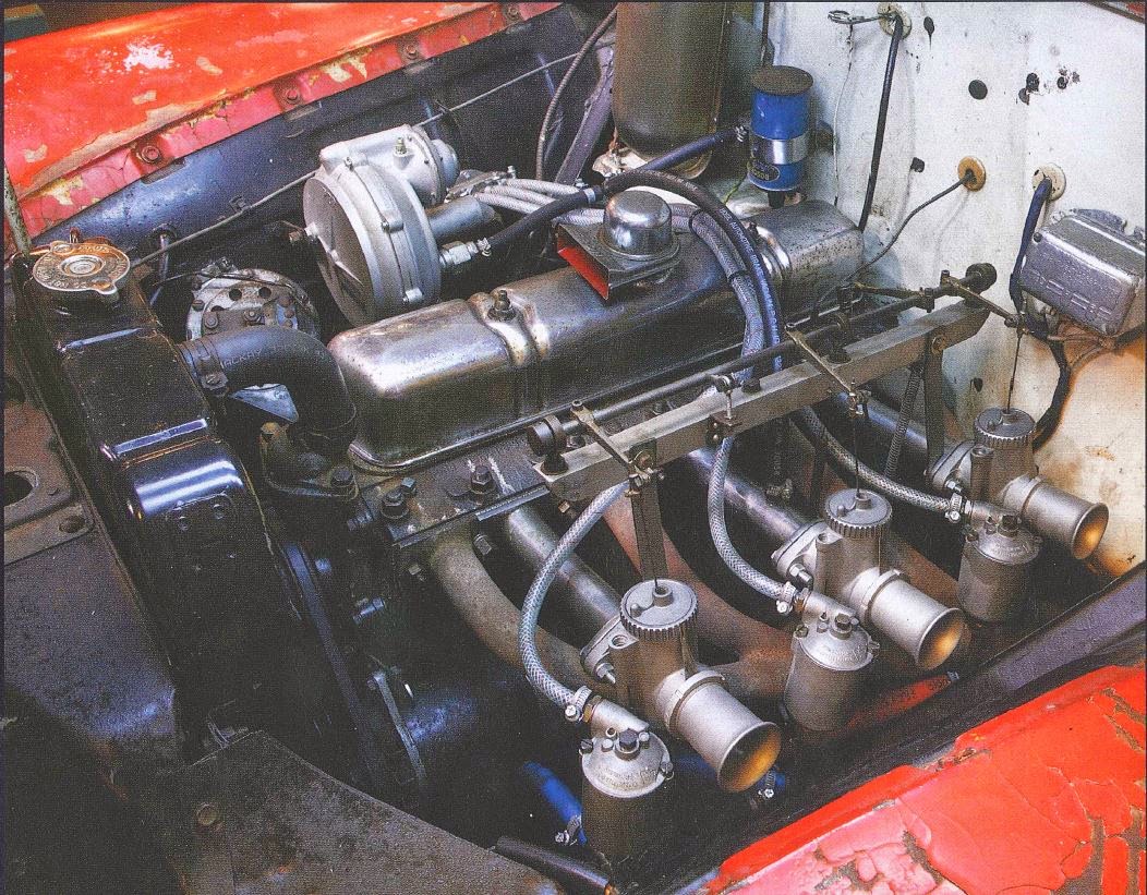

Some Amal photos on early Holdens to lighten things up a little.

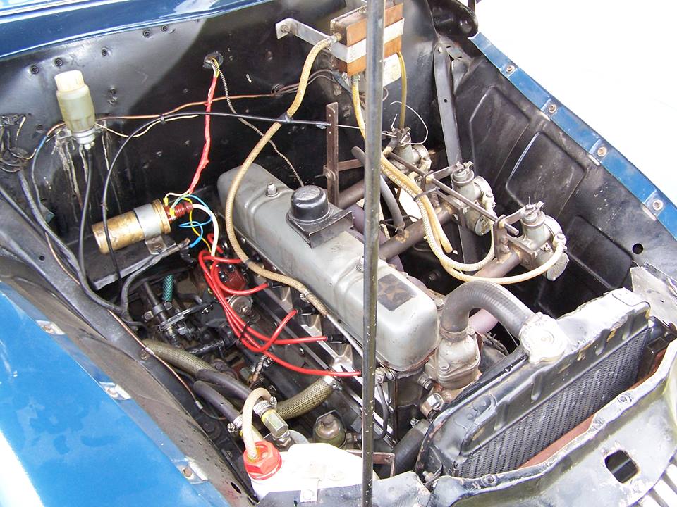

The first lot are of Des West’s FX Holden, with what looks like GP Amals. This beastie competed in the first Australian Touring Car Championships in 1960 (Gnoo Blas, near Orange, NSW), coming 11th:
https://en.wikipedia.org/wiki/1960_Aust ... ampionship
Des West GP Amals 2.jpg (89.38 KiB) Viewed 2439 times
Des West GP Amals.JPG (264.46 KiB) Viewed 2439 times
Note the plastic fuel lines for each carb, running across to the passenger side. There appears to be a fuel distribution block on the inner guard, being fed from the vertical steel bottle mounted to the firewall. My guess is that the humpy fuel pump feeds the bottle (with some sort of float), then the bottle feeds the Amals at low pressure (just like a motorboke fuel tank). The top of the carbs have pull cables, operated by a simple lever system.

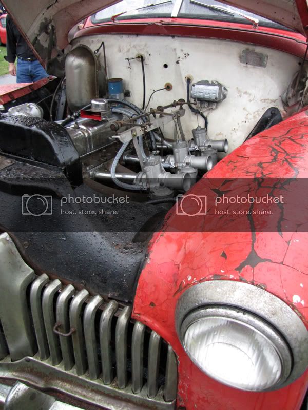

The next lot are Trevor Grace’s FX racer, still doing the rounds. These look to be Monoblocks. Another tank on the firewall (this one definitely fed from the grey fuel pump), and again some simple cable pulls to actuate the carbs.
Trevor Grace Amals 1.jpg (47.76 KiB) Viewed 2439 times
Trevor Grace Amals 2.jpg (127.34 KiB) Viewed 2439 times

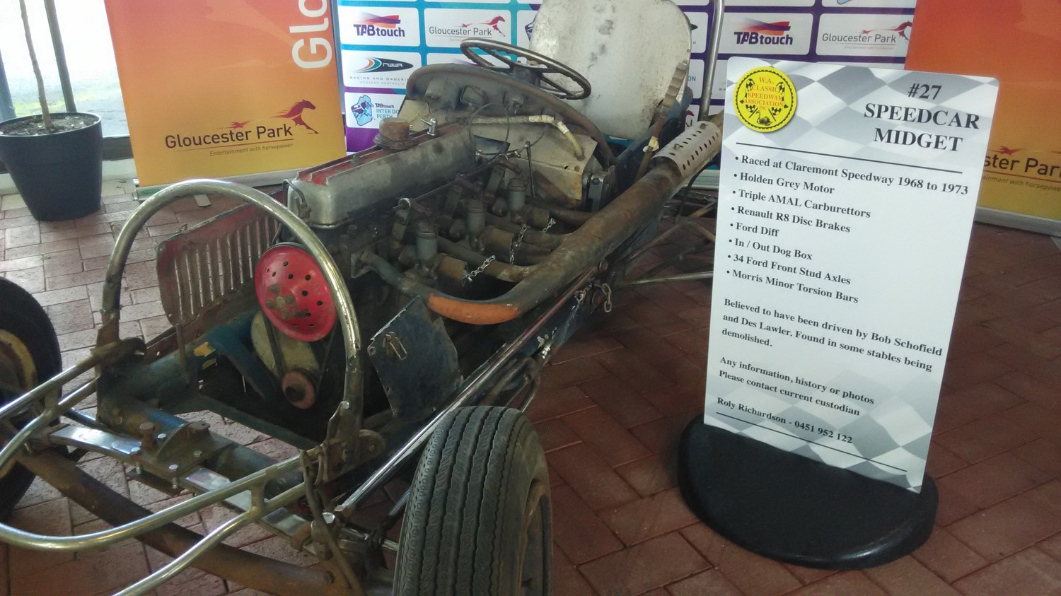

Speedcars is cool 8)
#27 Speedcar Amals 2.jpg (270.13 KiB) Viewed 2431 times
#27 Speedcar Amals.jpg (278.89 KiB) Viewed 2431 times
Posts: 11576
Re: Harv's AMAL thread
Gee the water pump drive on that speedway motor, underdriven or what?
The Trevor Grace humpy looks cool. Love a racing humpy.
