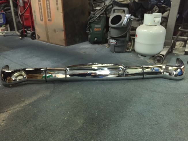

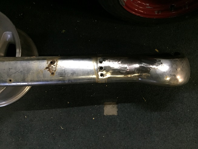

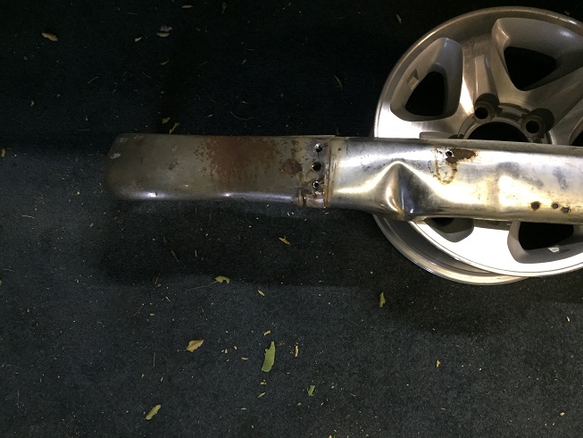

Purchased this one from Cary, one of our club members and straightened it.
FC Bumper 1.JPG (115.46 KiB) Viewed 1396 times
FC Bumper 2.JPG (102.12 KiB) Viewed 1396 times

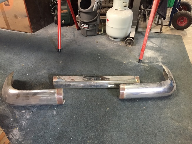

I did consider a single piece bumper but the re-chrome cost sky rocketed to a quote of $1,300 +
Straighten and narrowed it, to tuck the ends in closer to the body and then chromed.
I lowered the number plate surround, to remove the gap between the top of the bumper and the bottom on the surround. Normally you would see the body but as I intend to use the narrow number plates I wanted to clean this up.
rear bumper.JPG (106.22 KiB) Viewed 1396 times
I will still use the domed bolts to attach the bumper and Anne-Marie like’s bling and the chrome bumpers hits to spot.

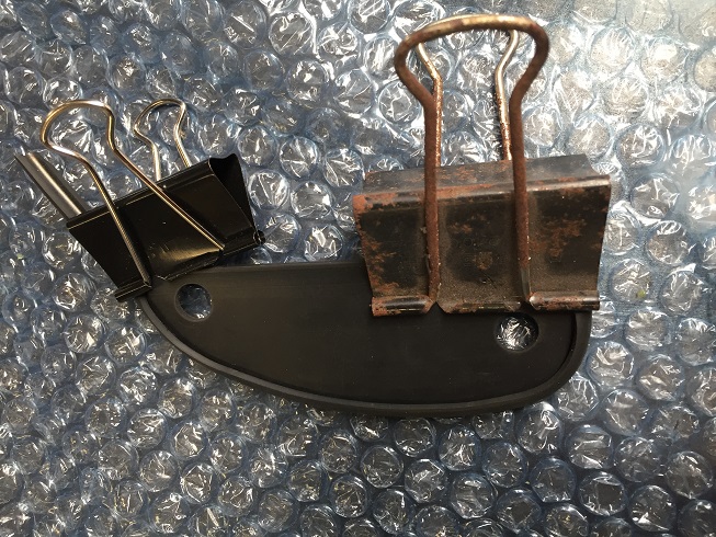

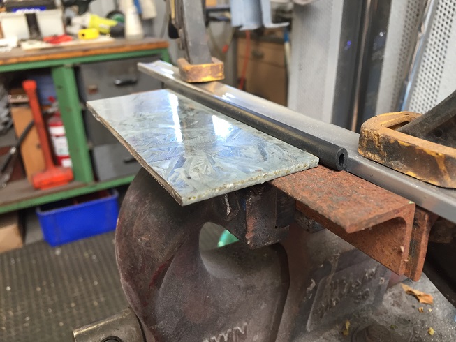

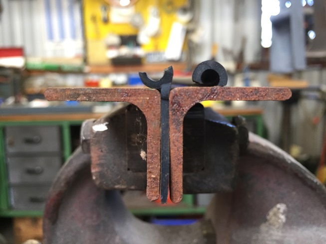

Did not like the joining faces on the rear bumper so made a couple of gaskets.
Needed to slice the rubber from one section into a ¾ curve and glue to the flat section.
Needs a little tweaking but happy so far.

Lots more time spent that I anticipate to modify the bumpers. A lot of weld, grind, re-weld, file and hand sanding.
But as we know with chrome you only get a good result if the substrate is smooth.

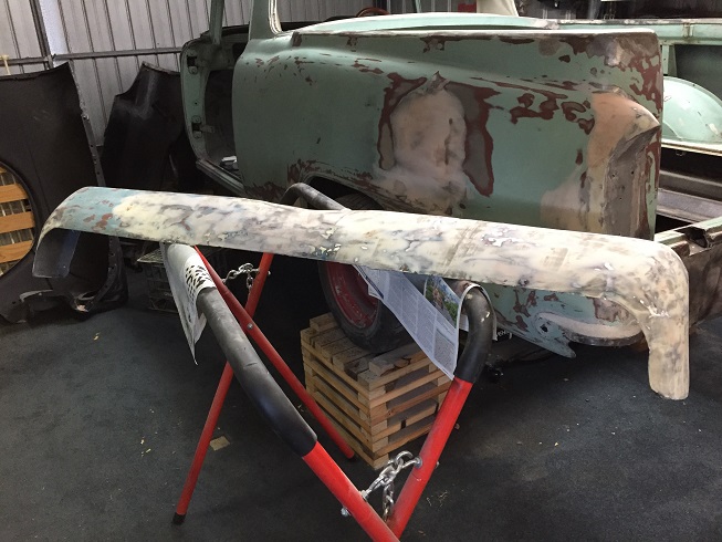

I have modified a HR front pan which again seemed a simple task but they are much wider and have substantially different corners.
Once I had cut it in half and started working the metal, I did enjoy shaping, cutting and welding to achieve the desired curves. My bottom lip dropped somewhat when I looked at the other un-started piece and realised, I had to repeat the curve but in the opposite direction.
Currently sitting in rough fill.
front pan 1.JPG (164.99 KiB) Viewed 1366 times
front pan 2.JPG (133.46 KiB) Viewed 1366 times
Second fill and sand completed.
front pan 3.JPG (126.39 KiB) Viewed 1366 times

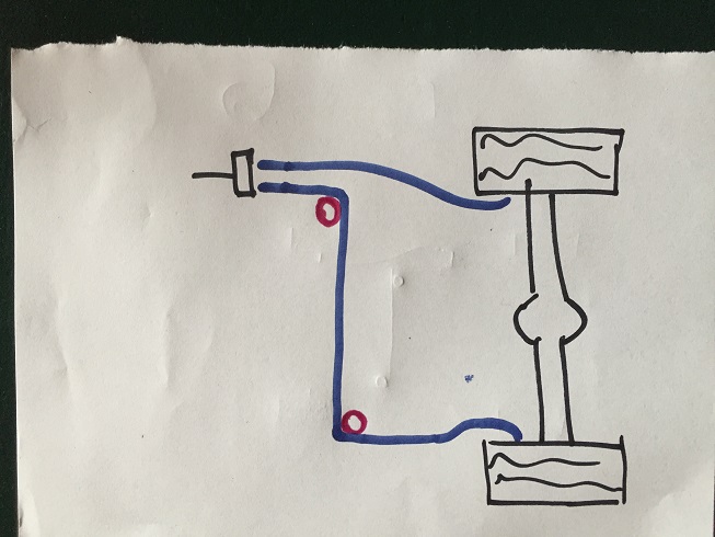

I do not like to look of the standard diagonal cross wire for the hand brake so this is what I’m currently working on.
Transfer the chalk drawing on the bench to paper.
I will use a pair of the pivot wheels from the firewall and mount these through the floor in the tub.

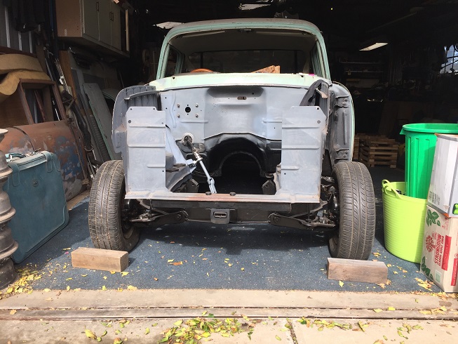

Nice work Roger...mmm...a heater (mmm...a roof). I should have thought about it before filling the garage with a pool table and working on cars in the driveway. Did you bring that dented bumper back to life yourself or did you outsource that? Patrick
Wrongway Roger
Posts: 748
Re: Ammo's Ute
Post by Wrongway Roger »
Hi Patrick,
With the help of my son holding the bumper and I with BFH and oxy torch, we were able to save the bumper.
Pounded out the biggest dents then put it aside to consider further action. If I stay with one thing for too long, I give a little pissed that the progress in slow and this gives me time to look to ensure I'm going in the right direction.
A lot of welding and filing to get the shape back. There were a lot of small dents that don't show in the photo's.
I'm a tight arse so don't out source unless it can't be done in the shed, like chrome plating or panel dripping.
Too cold to do a lot today but did spend time measuring the diff and the wheel arches for new wheels.

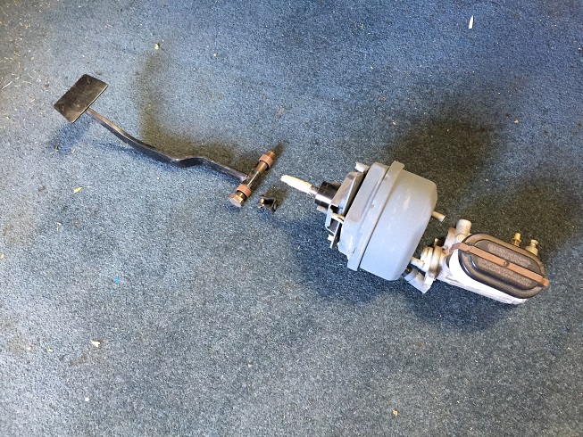

For the brake system, I’m using Gemini booster on the PBR dual master cylinder.
Modified a HQ brake pedal to clear the steering column as I moved the booster across and had the front calipers rebuilt.

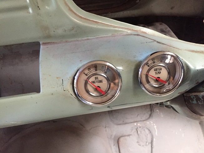

Replacing the switches on the dash with gauges

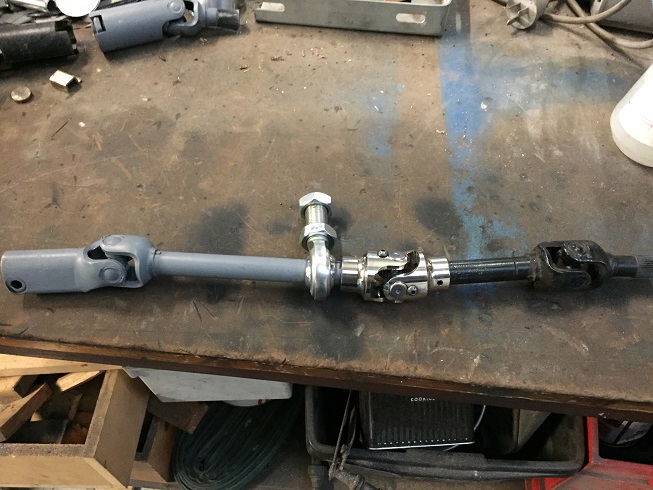

The steering linkages are VL top to VK bottom with Borgrson style uni joint for support.
Steering 3.JPG (144.45 KiB) Viewed 1297 times
Steering 4.JPG (130.16 KiB) Viewed 1297 times
